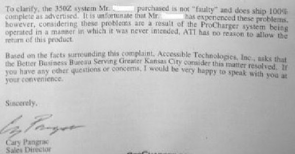

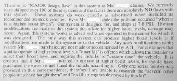

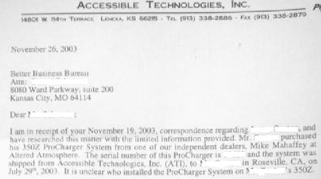

I think the BBB is going to very interested in the stuff that ATI has been doing........check out the letter that ATI sent them.......apparently ATI tells the public one thing, and us something entirely different......the letter and the "technical notice" they posted here don't really match up......here's the link to the letter:
Letter from ATI to the BBB about me and their Procharger
I couldn't get the letter to post here for some reason.......but it posted there pretty easily........notice that it's dated 11/26/03, and written by their Sales Director........also take notice that he has no idea what the differences are between the "complete kit" and the "tuner kit".......for some reason, he thinks the "tuner kit" comes with a variable boost option......last time i checked, both kits were 7psi.......and this is one of their top guys writing this stuff!

Old Dec 8, 2003 | 12:42 AM
elektrik_juggernaut's Avatar
elektrik_juggernaut
Posts: 1,962
zoom
Attached Thumbnails Attention all ATI owners who have had problems-piece-1.jpg
Old Dec 8, 2003 | 12:45 AM
elektrik_juggernaut
Posts: 1,962
zoom #2
Attached Thumbnails Attention all ATI owners who have had problems-piece-2.jpg
Old Dec 8, 2003 | 12:47 AM
elektrik_juggernaut
Posts: 1,962
zoom #3
Attached Thumbnails Attention all ATI owners who have had problems-piece-3.jpg
