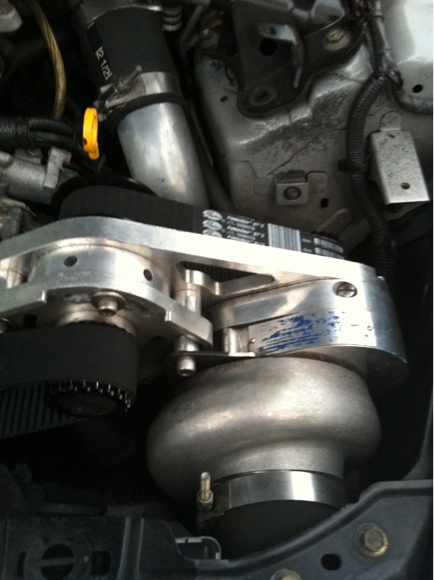

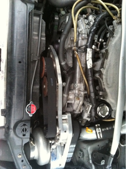

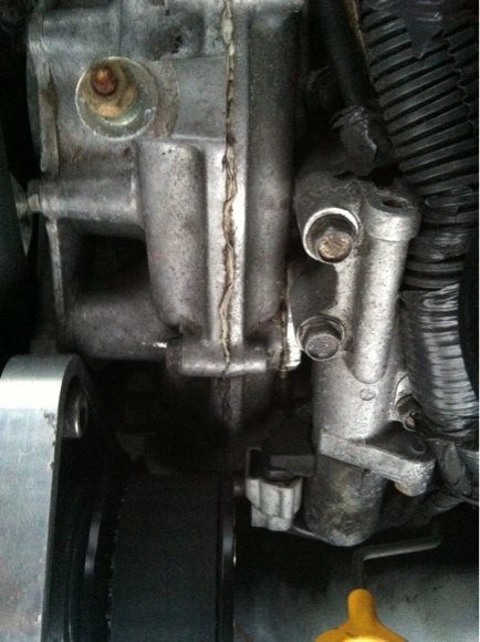

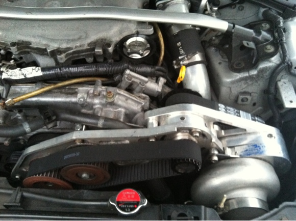

where do you solid mounts? i have never heard of the idea for a 350z. i would be very interested, especially to fix my g-damn bracket flexing issue. i really dont want to drop another 5000 on a turbo kit, but i might have to do it just to run higher boost and be happy, finally... i'd love to hear where to get solid mounts and how easy they are to install! thanks, i'm sending you some pics

ok as soon as i get done with work i will both post and email you some pictures. If i had the solid mount set up there would be a perfect area to mount a turnbuckle, however i have oem mounts. Thank you

please don't mind my rusty steel gates pullies... several years ago down in Arizona i tried taking matters into my own hands. i made a custom pulley set up with wider belts (36mm vs. 30mm) and custom machined pullies with guides. i thought the wider belt would combat flexing, but they shread just the same, and are much costlier!

Thank you for the reply. Well back when i ran 7psi in 2006 i tried routinh my belt under the tensioner pulley. With 7 psi i never had a belt shredding issue. I have only had issues with my 12 psi kit. The pullies currently on my car are Gates cog drive steel pullies. They have been custom machinef to work on the procharger bracket. They are heavy, they rust, and they werent cheap when it was all said and done. With custom pullies im at 10 psi but im murdering belts still. My new custom tensioner pulley has teeth on it unlike the procharger smooth one. So that option is out. My current belt is also a custom width at 36mm vs the 30mm procharger one.
As of right now im buying solid motor mounts from revshift and im going to build a turnbuckle to hold my procharger bracket from flexing. Im hoping this works. Then i can up the boost! Wish me luck

Its not engine movement, the bracket flexes when hitting high rpms. What you need is a modified radius rod from OldManZ350.
