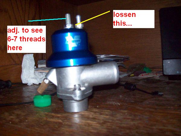

Alright, i didnt think about the belt slipping... ill check that when i get some time. As for the BPV, The nut on the top is tightened all the way to the BPV. I can loosen it, but its just like a nut on anything else, it will spin freely... has my BPV been tampered with? Another question too, I have some oil at the front intake of the blower, its enough to wipe off with a paper towell. It isnt dripping, but looks like it could be enough to if i didnt clean it every few days... what up with that?
see attached photo...
as for the oil on the intake of the blower, this may cause some belt slip issues, i would look into to doing the Tim Rod or GTM belt mods to get rid of it...
