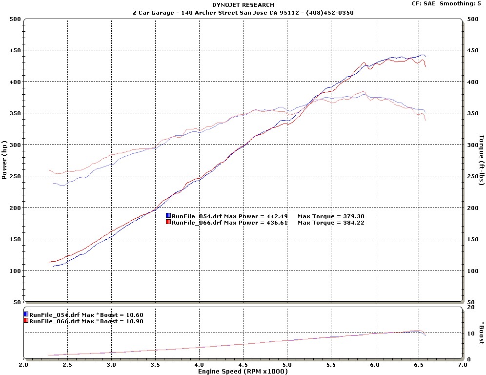

I decided to swap my Ark Grip exhaust for a MD TDX2 Shockwave. Wow, what a difference! I should have just gone with Motordyne in the first place. The Art tp's and TDX2 are a great combo. I no longer have the pesky rasp and hissing noise I was getting from the Ark pos X-pipe. You can tell they put alot R&D into this exhaust. The built of this thing is amazing all way up to the V band clamp. The sound is ecstasy to my ears and piercing at WOT, lol. I decided to retune to maximize output potential. See last dyno chart below. My tuner pull it down about 5800rpm becuase it wanted to keep my tq below 390. At my next tune I will have Rob keep climbing as long as it safe and there is no knock all the way to redline.

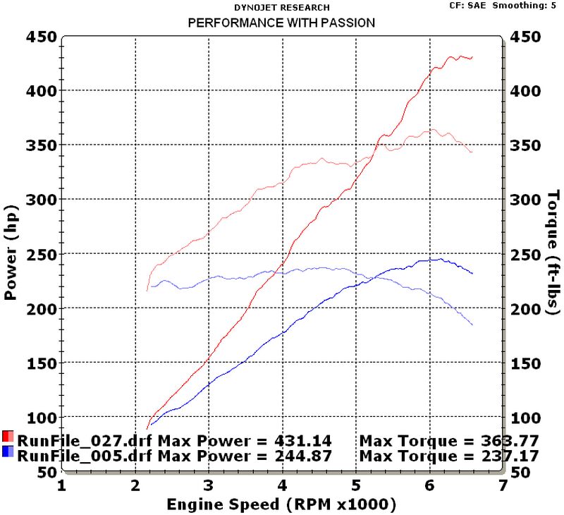

I blew out my Fast Intentions HFC's, so I decided to install ART test pipes and go from a 3.33 pulley to a 3.25 pulley. The Art tp's are freaking amazing. I was surprised that the sound was slightly louder but more menacing than my HFC's. The gas fumes are almost non-existent, a big plus for my family. I highly recommend these to anyone going this route.
Rob @ ZCG did a great job on the tune. I did loose 1psi of boost with the arts. Here is my before/after Dyno chart.
Your thoughts on my Vortech build...
Installing on a stock engine that was replaced because of the OC issue in 2009. New engine currently @ 25k miles stock dyno from ZCGarage @ 227HP/219TQ
After dyno, I installed the MD 5/16 spacer and ARK v2 TD exhaust. I will know what kind of numbers I got from these two mods on the before and after dyno run.

1st dyno: install of vortech with 3.33 pulley
2nd dyno: install of art's with 3.25 pulley
3rd dyno: exhaust swap from Ark Grip to MD TDX2 Shockwave
