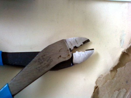

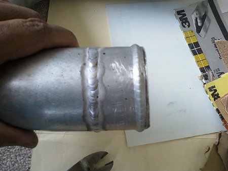

What crimping tool did you use to bead the charge pipes? I don't want to do a welded bead and real bead rollers are $500.
Old Nov 23, 2011 | 04:24 PM
  #43
- bigc -'s Avatar
- bigc -
Posts: 1,014
Likes: 6
i followed the thread below:
How To Beading Intercooler Piping
these are the crimpers i used...picked up from home depot
result
