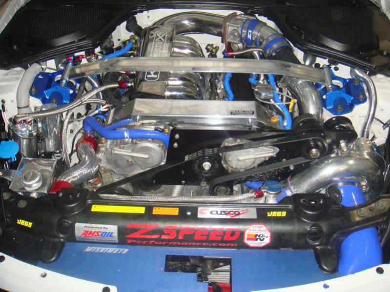

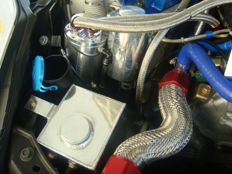

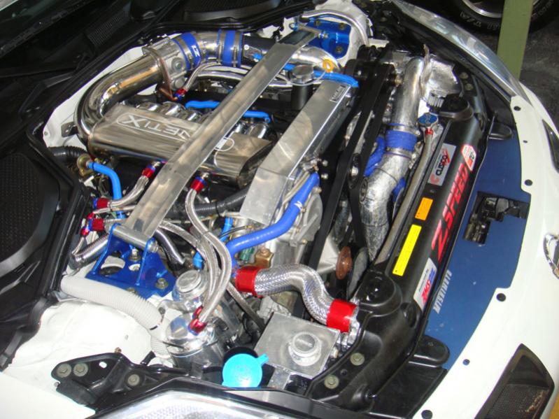

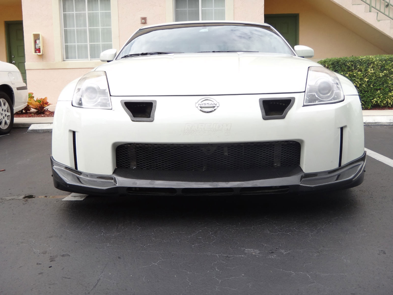

Smile Photos finally!!!
see attached files.

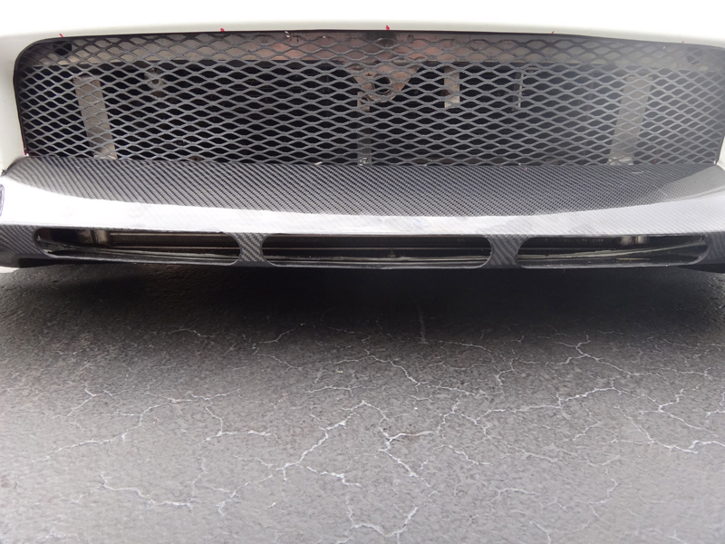

more photos! The 2 rear tow hooks were added my me since the GTM TT it eliminates the std hook placement/crash bar.
