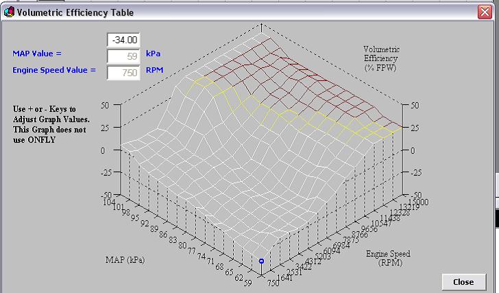

You are on the right track. What the ECU tries to do is keep a given Air/Fuel ratio (AFR) depending on the load on the engine. For cruise conditions this is generally around 14.7 to 1. Under heavy load/boost that will drop to somewhere around 12 or 11 to 1, so less air more fuel. In order to keep that ratio the ECU looks at the amount of air entering the system in pounds/min. So when it sees heavier (compressed air and/or colder denser air) it adds more fuel to keep the requested AFR.
Now things get a little more complicated than that as the main table generally used in engine tuning is the volumetric efficiency table or VE table. Volumetric efficiency is a measure of how much air enters the engine compared to the maximum volume of air that can fit into a cylinder when the piston is at bottom dead center. The ideal would be 100% but that cannot be reached without a pump to force more air into the cylinder (turbocharger or supercharger). When the air is colder and therefore denser the volumetric efficiency is increased because there are more molecules of air per area (it’s compressed). The volumetric efficiency table represents the engine’s intake efficiency under different conditions.
I/C Discussion-ve-table.jpg
On the graph kPa is metric for pressure which in the imperial system would be psi.

not completely true on the VE portion, you can achieve 100% or greater ve without forced induction. Prostock engines are around 106% volumetric effecient at peak power, the velocity is so great moving through the engine that the air actually compresses itself slightly when it slams into the cylinder, then the intake valve closes before it can fully escape and equalize. iirc the DE is about 102% VE at peak power which is why bolt ons dont do much. dont remember the source for the de engine ve so i can be wrong on that. the source for the pro stock engines is the rediculous number of articles done interviewing pro stock engine builders, i used to have like 6 different ones interviewing different engine builders before i had to throw them out when i moved to hawaii. my wife wouldnt let me bring a file cabnet full of magazines.
also volumetric effeciency is constant regardless of temp, the volume entering the engine is not changing its just the denisty which are both very different things that people often confuse as the same thing. for instance a 1 square inch block of steel and a 1 square block of mallory metal(what they use to add weight to crankshafts during balancing) both have the same volume(one cubic inch) however since the mallory metals molecules are much closer togeather it weighs about twice as much, hence it is twice as dense. density is just a correlation of volume vs mass.

Yep - you are right on both counts. I'm more embarrassed about the temperature item as that was where the confusion was to start with. The issue is converting MAF readings to volume which does require a temperature conversion. Thanks.
