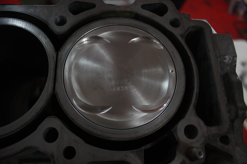

i dont think its about low comp pistons.. cause mine was low comp but the gap was not that big..
pic of my piston ( wiseco pistons )

Look at how much machining the Wiseco has done to its surface VS the CP.
The CR is determined by the volume of the combustion chamber. The volume can be changed by taking material out of the piston top( relief for valve clearance as well as additional material) or lowering the top of the piston.
If the CP's have less machine work done then they must use an alternative method to lower the CR. Either lower the wrist pin centers or shorten the piston height from the wrist pin center..
Old Dec 28, 2011 | 04:35 AM
nightcrawler_8's Avatar
nightcrawler_8
Posts: 800
From: UAE
aha.. so you mean that CP is keeping the material more and lowering the piston level in order to lower the compression !!!!
is there anyone who installed a CP piston who can confirm if thier engine looked the same ?!??!

Possibly. After looking at the pictures again the CP still has a decent amount of machine work done to the surface.
It would be nice to know the piston heights for stock hr vs de ( height from pin centers) to know whether the pistons are 1 to 1.

I actually had to ask this same question to Wiseco on a set of custom pistons I had mad for a DE and this was their response
"Using a DE piston in a HR engine will not affect compression at all. They sit farther down in the bore on the HR but the HR also has a smaller combustion chamber so those 2 equal each other out. So whatever compression they use in the DE’s will be the same in the HR. The valve pockets are all the same and everything so they are good to go."
This is on a set of Wiseco's so I would assume CP would be the same but i would still confirm with them.
