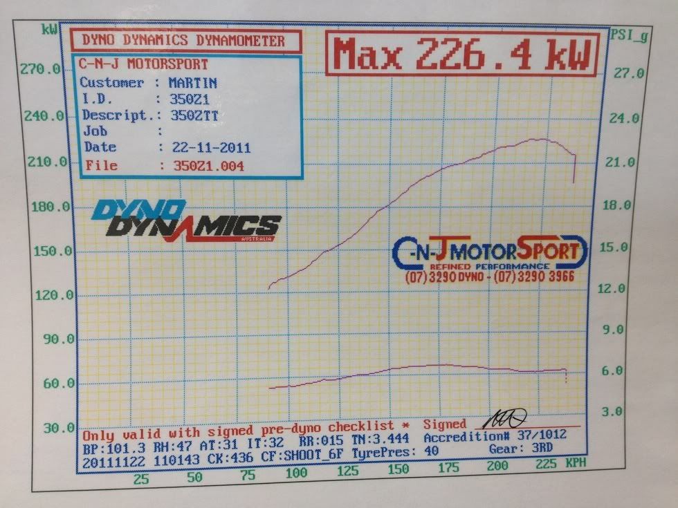

Hi Guys, I have a 2003 350Z Auto Transmission and have just recently installed GTM TT kit and transmission valve body upgrade. On the dyno I'm getting 226kW which is about 303hp. Does this sound right? I thought it sounded a bit low. I realise manual transmission would get more, but still. Thoughts?
Note that I have not done any other mods as of yet.

Sounds low but many things could be the cause of that. At what boost are you running? Other supporting mods? Also, what dyno are you on?
whateva the stock boost of the kit is, not sure exactly, maybe 6psi?
no other mods at present, waiting for exhaust from fast intentions though.
see dyno chart below:

If you're still running stock everything other than the mods you posted (TT and valvebody upgrade- which contributes nothing to the result) then I'd say it's about right. You'll have a constipated exhaust that isn't contributing anything to the generation of power, a generic "custom mapped plug-in and play engine management" EMS... At 6 psi.
Good baseline though- once you get that new exhaust in there (Test Pipes included I hope) then that will give the turbos the opportunity they need to benefit from the exhaust gas.

Should be at least +50 more hp IMO get some tuning done
The dyno numbers look about right for the stock exhaust, 6psi of boost and 90 degree day on that type of dyno.
The stock exhaust is holding back anywhere from 50 - 80whp.
If that still isn't enough power for you, then a boost controller will help you get more. Just don't go crazy with it. Keep it at or under 8 - 9psi.

ah didn't realize stock exhaust + cats... not gonna make much more than this

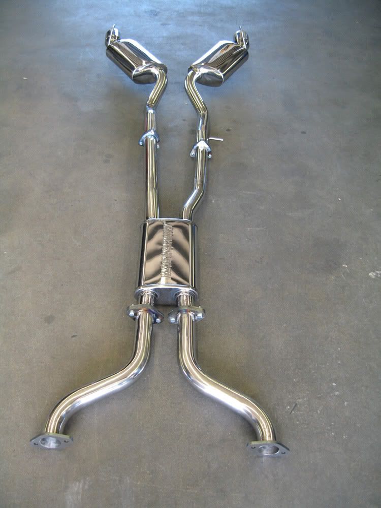

I have already on order a fast intentions exhaust with a custom straight through x-pipe (replacing a muffler). And now I'm considering high flow cats as I would probably get done for test pipes. I spoke to fast intentions and they recommended me they're 100 cell HFC as anything less (eg more than 100 cell count) will not handle heat from FI setup:
http://www.fastintentions.com/produc...roducts_id=136
The product in link is for 370Z but they also make for 350Z.
What are your thoughts on this guys?

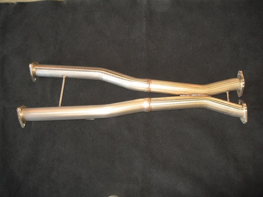

this is the exhaust:
This replaces middle muffler:

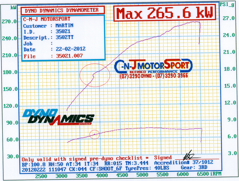

Ok finally got the exhaust on (stock cats) and went on the dyno:
My concern is that bump I have circled. The shop said this is the converter kicking in, I wasn't sure what he meant by that but something to do with the auto transmission.. thoughts?
Old Feb 27, 2012 | 03:23 AM
joekool's Avatar
joekool
Joined: Feb 2006
Posts: 486
From: Australia
Also I never realised how much a difference an exhaust can make :O

Old Feb 27, 2012 | 05:33 AM
djamps's Avatar
djamps
Joined: Dec 2008
Posts: 4,492
Likes: 10
From: MD
Also I never realised how much a difference an exhaust can make it :O
For a turbo setup it can be huge. You want as little back pressure as possible after the turbo (which is kind of opposite of SC and many NA setups).
As for the loop in the chart, yes that is normal to happen but it seems to be happening a bit late... they may need to adjust the calculated load so it locks up sooner on pulls. If it is locking too late, you can end up overheating/destroying the auto tranny.
Old Feb 27, 2012 | 03:04 PM
joekool's Avatar
joekool
Joined: Feb 2006
Posts: 486
From: Australia
spoke to the shop again and said that driving on a road vs. dyno is different and the loop would happen earlier if on road. He explained it in more detail to me but it was all jibberish to me lol.
