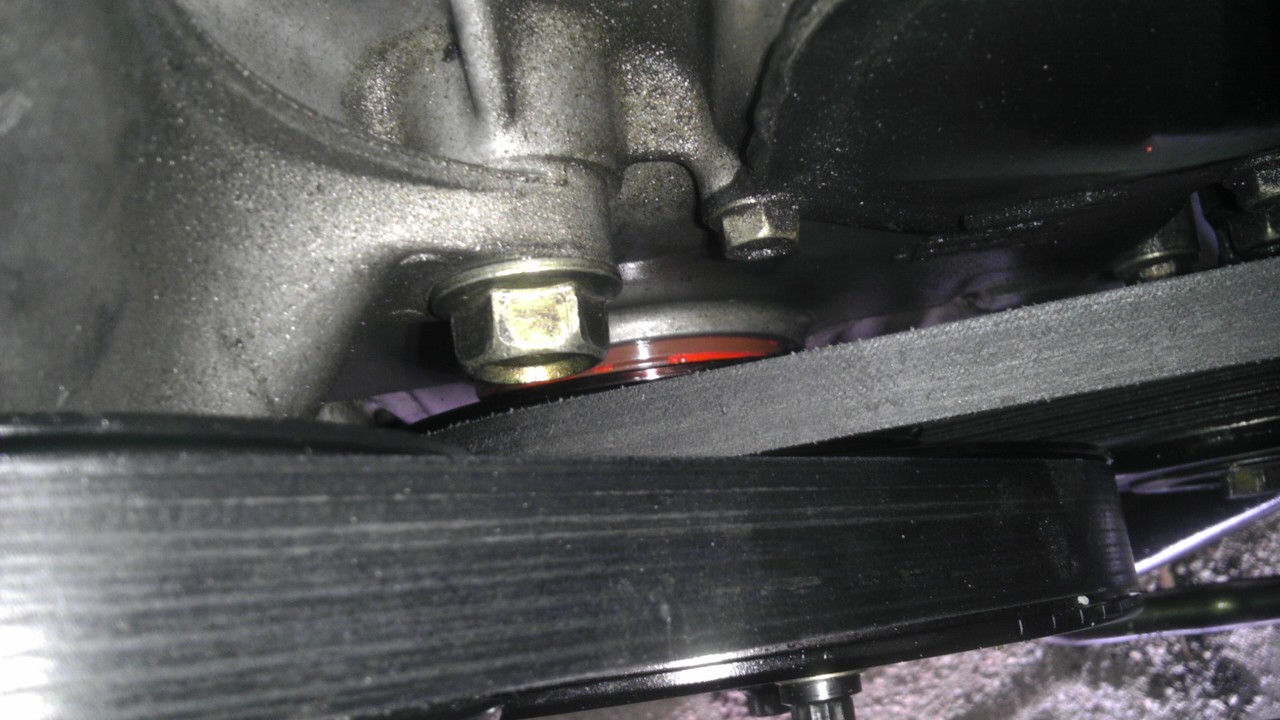

Ok, tried top take the pulley of to replace the seal today with no luck. While I was messing around I saw that the seal blew out of the timing cover so it definitely was a pressure issue. I put it back into place and no more leak. Tomorrow I'll test it under boost before I replace the seal. I opened my breathers back up.
I'll post pics of it later when I'm on the computer.

Front crank seal. It's just pressed in the timing cover.

So after giving it 16psi the seal isn't leaking and it stayed in place. Hopefully i won't have to change it out because getting that crank pulley off is a nightmare.
here is a pic of the seal before i pressed it back into the timing cover.

Originally Posted by binder
I have a 1000ftlb snap on impact gun but that requires me to remove the whole front end and radiator. At this point i'm not really wanting to do that. Once i get a second hand over to the house I'm going to just redneck it by using a breaker bar and the cars starter. Done it quite a few times but someone has to hold the breaker bar steady against the floor.
That is IF i need to replace the seal. So far it's holding oil no problem.
Unless there is actual damage to the seal, there is no reason for it to let go, provided there is no pressure build up back there. I think you will be fine.
ya, i think so too. I think it coming out of the timing cover is a good indication that it has a proper seal with the crank pulley.
If i would have thought twice before i pressed it back into place i would have put rtv on the outside of the seal like I did when i installed it to give it just a little more hold. Either way it held 16psi last night with no issues.
