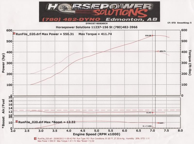

No boost controller:
With a manual BC (hence the curved boost curve), and you can see the boost came on rather quick. The torque was kept down to prolong the life of the stock block, 10psi by 3700rpm:
You can see that when the max power of 550 was made, the boost was below 9psi. Again, the torque was kept down because it is a stock block.
This was on pump gas of course.
