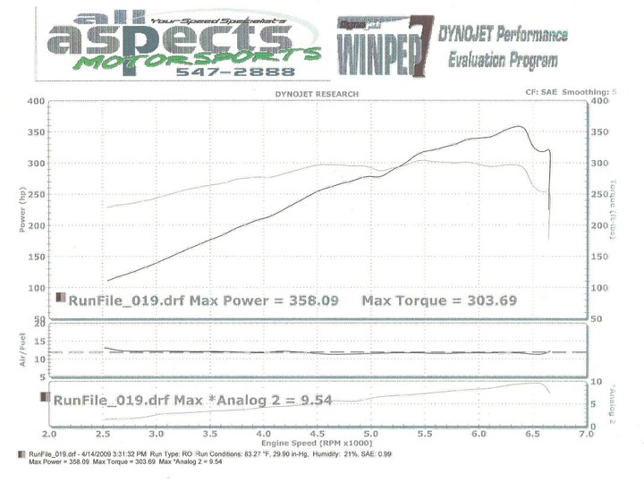

This is the graph of my 03 with a Vortech, 3.13 pully, 440 injectors and UTEC. Gets you were you want to be, and you can actually probably make a little more TQ then i made, I stayed VERY conservitive with my timing.
