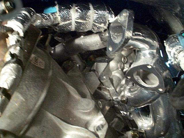

Here you can see how I feed the fuel and evap lines... I gained lots of space between the fuel line (smaller one), and the evap line (fatter one) is inbetween the hot stuff and the fuel connector. I am considering putting a hose clamp on the fuel connector as added insurance that it could never pop off, but its wedged pretty hard on the evap line as is. the evap line is double wrapped and has adequate clearance from the manifold. I feel ok with this setup, but in the future I will be completely relocating these lines.
Here you can see that I moved the blue plug to a completely different area, and then double wrapped the wiring harness to help insulate it from wastegate heat.
Here is a real crappy shot from the top of the passenger side.
Overall shot of passenger side.
Dark and blurry overall of the driver side.
Now I need to install my oil line kit, do the pipes, injectors, and wiring. It will be a few days before any updates. We are leaving this as is to take measurements for future developments and ordering some different parts for the oil lines that I feel will fit better then I already had.

OK... well I went and mounted the passenger side downpipe adapter... due to placement of the O2 sensor I need to re-do all my fuel and evap line stuff.
crap!!!
crap!!!
I think that is my fault
You saw my earlier post picture on the fuel line, and how I did the same. It looked like a real good idea when I was looking up, reversing the lines, but when I got further along, it didn't work out.
I should of posted, I'm sorry.
On the picture above with the wiring harness running up the tranny. I found if I removed the braket, and pulled back the wiring harness behind the bolt (towards the rear of the car) and zip tied it to the bolts, it kept it out of the way better.
I will post a picture for you of my front, as it will help in the placement of stock steering cooler, horn, wiper, and came up with a great place for the rad. overflow.
I am sure you can figure it out on your own, just trying to help. I know I wish I had it, when doing the install...

Charles
You want to install the oil lines on the turbos, Before mounting the turbo.
Check your passenger side turbo. Mine came clocked in the wrong direction (slightly off) It was to close to the manifold.
(I sent a picture to Matt to confirm it) I have to remove the turbo strap, and c-clip, to get it in the correct place. I am sure yours is fine, but you might want to check. The inlet should be inbewteen the firewall and manifold. Not favoring one side.
I can't tell by your pictures, but I highly recommend putting on the hose tubing on the turbo NOW.
If only someone shared that will me, It would of saved me hours, and alot less blood (literally blood on my turbo) sweat and tears.
Even if it means taking the turbos off now.
Oh, and on the passenger side turbo, where the inlet runs close to the manifold, put some heat sheild wrap around the hose.

"I think that is my fault You saw my earlier post picture on the fuel line, and how I did the same. It looked like a real good idea when I was looking up, reversing the lines, but when I got further along, it didn't work out.
I should of posted, I'm sorry."
Its no problem. I actually had my lines how you tried it, but then i came up with how i had it and finally found something i like... and now thats all gone to waste... haha, no big deal.
What I did was just cut the zip tie already holding it, and pull it about a half inch back and zip tie it there. This gave me space that I am comfortable with... I have done test fitting with the gates and adapter pipes and its clear to go.
Check your passenger side turbo. Mine came clocked in the wrong direction (slightly off) It was to close to the manifold. (I sent a picture to Matt to confirm it) I have to remove the turbo strap, and c-clip, to get it in the correct place. I am sure yours is fine, but you might want to check. The inlet should be inbewteen the firewall and manifold. Not favoring one side.
Actually at the moment both my clamps are loose, and the turbos are free to clock. I did not plan on tightening them until I had test fitted everything how I want it. Both the clamps are in position where I can get to them to tighten them even with the turbos on. I noticed that both were clocked poorly, so that is why I put them on like this. Figured the only way to get it perfect was to just install them and go from there.
Both are already on. The passenger side we did before putting the turbo on, the driver side we did with the turbo mounted, because it was too friggen hard to get the turbo in/out with the coupler already on it. they are both on now and clamped. Definatly a big pain in the *** tho.
Are you speaking of the water pipe above the turbo/manifold? I have not yet got as far as to put those back in yet.
I really appreciate your help. I used yours and the other guys photos while installing just as a comparison to see how other people did it. Definatly the hardest part is just getting the turbos in and out of the car.
I have not done this yet because we are building an oil line kit to replace the greddy stuff. Doing it with earls fittings and a oil filter adapter to supply the oil, rather then the brass Tees. I personally know of 2 cars that burned to the ground from a failed Greddy oil line that broke at the fitting, and I also know of a friend that lost his fully built motor after about 2 years when his Brass Tee finally cracked. I dont want any of this, which is why I am building the kit... its pretty inexpensive so I planned on offering it to the public for anyone who cares to indulge.
Thanks again man... BTW.. how is your car doing anyway?
