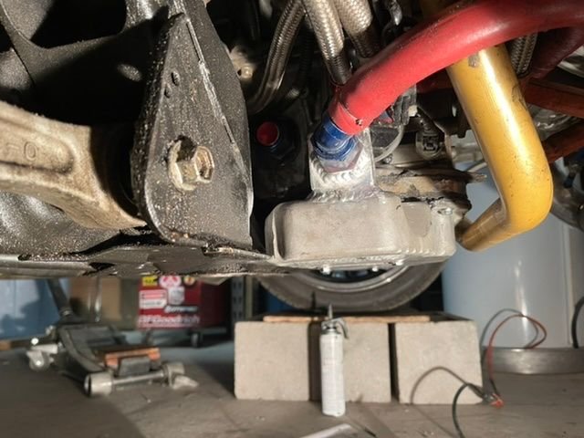

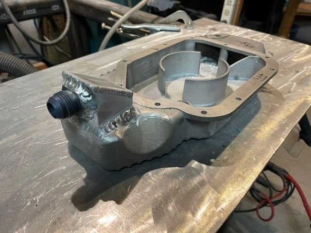

Been hacking up that APS expanded oil pan ... trying to install a AN -12 fitting on a mini-sump box and it's going like all hell ... welding the cast is going the opposite of good ... have come within a coot-hair of giving up multiple times ...

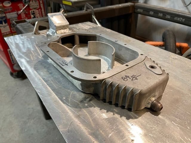

I picked up an old APS expanded oil pan and have been playing with it ... did some joan rivers reconstructive surgery to install a mini-sump-box and -12 fitting, removed all the heat-dissipation fins, and installed an alternate drain plug. Wasnt sure if I would be able to run this expanded oil pan with the Z1 spacer but it appears that I can run both and have the oil pan above the floor of the car. In doing so, I needed to further extend down the oil pump pick-up strainer ... I've already modified the pickup tube and replaced the OEM tube with 1/2" stainless steel and bolstered up the welds on the flange side and the strainer side ...

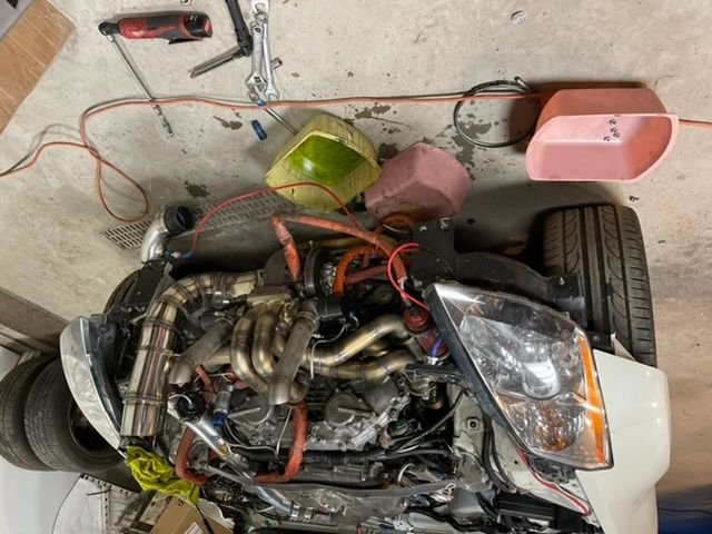

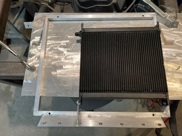

Been in the garage the past few evenings pecking away at a turbo kit for a 370z and taking care of some small tasks in anticipation of the Kansas Airstrip Attack next month.

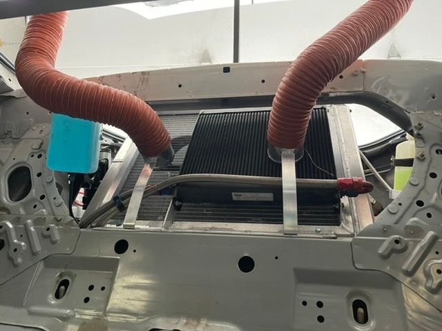

One big item has been getting an oil cooler on the car and with the 19row cooler in-hand I figure I should make some steps on it. I dont really have room to mount it on the front of the car and as best I can I'm trying to get things in the trunk. Had a few other options but decided on mounting it right on top of the radiator. I would have to dismount the radiator and remove the bracket but it wasnt anything horribly horribly difficult. Figured I do it over a few days but ended up only needing tonight to knock it out.
I figured put it inline with the large fan - made some brackets, welded them to the frame and everything bolted up just fine. Decided to only run three brackets (as pictured) and I can always add the forth if needed. Had the energy and with daylight savings I was not tired and decided to get it back in the car.
M16xAN-8 fittings are coming in this next week (weather permitting - we just got hit with three feet of snow), I need to order hose, fabricate the hose, the AN 8 fittings, the M16 fittings and install. I will be splicing this into the oil filter relocation kit that is currently on the car. The filter has been relocated to the side of the transmission and I may take this opportunity to put the oil filter in the trunk as well. I may swap out the filter assembly and find a filter assembly that will accommodate a larger one-time use filter or find an inline reusable filter.

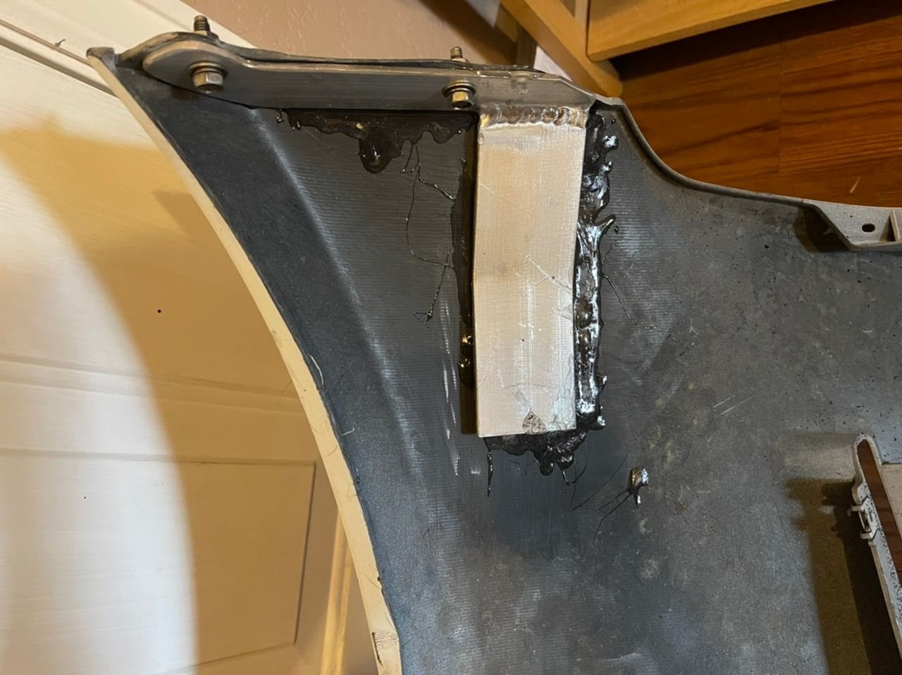

Been pecking away at the small to-do list for the car ... one of which has been get a front bumper on the car ... I found a guy selling a PPW bumper and struck a deal with him and picked it up. I really only have the two bolts under the fender so I decided to fabricate a brace that will hold the 6 plastic snap-in clips right above the radiator. Wasnt terribly difficult but I did drill one hole wrong (just welded it closed and redrilled it.
Also, I dont have great faith in the two mounting holes under the fender - so I fabricated a reinforcment plate for the bumper ... not 100% sure how I'm gonna attach it to the bumper (epoxy? rivits? etc) but I'll figure it out.
Had some rear bumper sag that was bothering me so I removed the rear bumper, drilled two new holes in the bumper, matching holes in the chassis of the car and threaded a 10mm bolt through to snug it up. I also drilled 8 small holes in the bumper and the metal reinforcing plate below the bumper and rivet'd that plate to the bumper (it's unexposed so no one will see it).

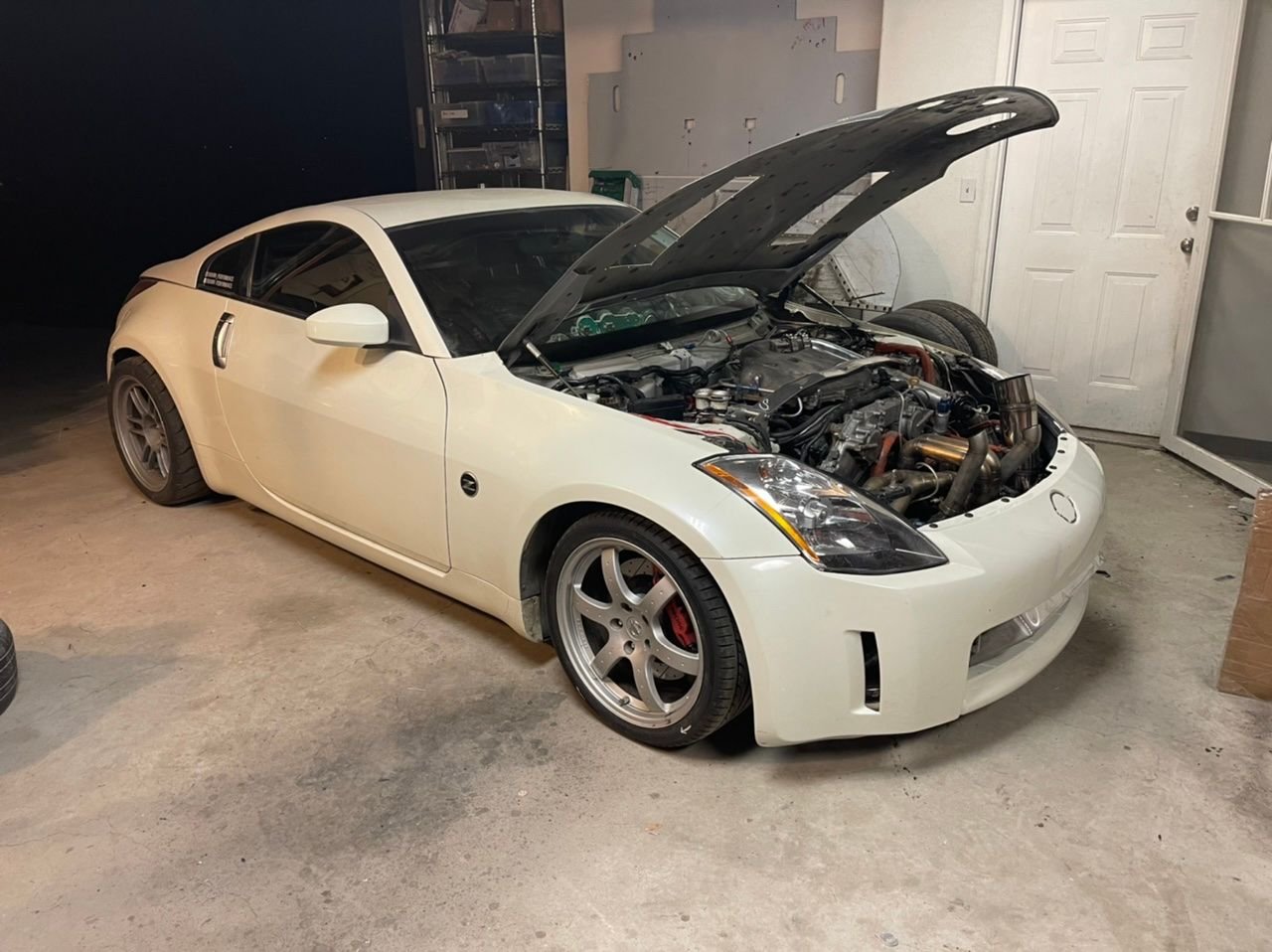

Kansas is one week away and I have made some great progress getting the car up and going...
My fire suppression bottle was accidently activated back in Oct 2018 and I told myself I'd get a new tank for the next event ... I bought it locally and it took a week to get in it has a revised design using a 10mm hose which branches off to 8mm. I didnt want to revise my cabin & engine bay 4mm nozzles so I kept that plumbing and installed a 10mm aluminum tube utilizing a AN -6 female nut and sleeve and bought a AN -6 to AN -4 reducer fitting and it should work fine. I'm not impressed with the hose kit that was included with the kit and I think the 4mm aluminum is higher quality and a better product.
Picked up 10gallons of C16 (as recommended by OMZ) ... will probably run low boost on Saturday and push the car a little harder on Sunday ...
I can die a happy man as I FINALLY picked up a set of OEM Track wheels - not sure why I have such a boner for them but finally got a set. Funny, I'm likely going to be a f'd out track model z and I'll have another set to add to the stable. I picked up a set of Hankook Ventus 245x30x18 for the front wheels ... was happy to see they weighed in at 40.8lbs. So new front rubber is taken care of.
I also got the oil cooler fully installed and plumbed in ... Needed about 30 feet of steel braided hose and I had all the fittings and it was just a matter of getting things run under the car.
Also picked up some spare / replacement parts ... picked up a few O2 sensors, Mac Boost Control Solenoid, A GM temps sensor, A few sets of spark plugs. A buddy has an extra starter and alternator that I'm going to take too.
Been working on revamping the heim joints on the front splitter for the new intercooler setup. The front splitter is installed and I will likely have to remove it to load/unload the car onto the trailer.
Finalized the front bumper / splitter and will need to put a front face (air dam) on the splitter.
Got my fake headlights painted and cleared
Re-mounted my bumper with supports and an additional bolt to hold it snug to the body.
Did a cars & coffee this morning and the car ran well ... I did experience a dead battery (despite the car being on the trickle charger the last few weeks) and I think the radiator/fans are cooking the battery and evaporating the water out of the battery. I did refill the battery with distilled water and we'll see if it bounces back.
The car also overheated and without outside air and only an open driver's side window the fans can't pull enough heat off the radiator to keep the car temps below 225degrees. So naca ducts will be installed and I need a way to evacuate hot air from the trunk ... was thinking the reversed naca duct strategy installed down by the turn signals in the bumper.

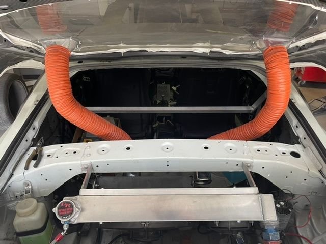

I had a feeling you would eventually need ducts of some sort of ducts to help move the air through the radiator. Go with rally style roof scoops and some holes beside the rear licenses plate. I THINK if you exhaust the air their it should help clean up the air behind the car and I believe that is a natural low pressure zone helping pull air out of the trunk area.

Nacas will be next and, yea, Conway - Gonna use the OEM vents in the trunk area to pull air out from. Might try to cut a tear-drop out of 3" IC charge pipe and splice it into the rear bumper (it'll make sense when I show some pics).

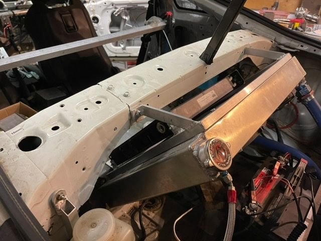

really happy I revised my front setup - I can get to the turbo in about 10minutes... got the coolant hoses off the car, cut, and rebuilt. Everything is reassembled but gotta put the front clip back on.
Gonna get the NACA ducts cut-in tonight too ... printed out my template and should be just a matter of making some cuts, smooth edges/corners, drilling holes, and riveting in the ducts. I placed them originally and revised them (to push them further outboard) hence the revision in location.

are you going to try to direct the air to the radiator or just the "radiator compartment"?

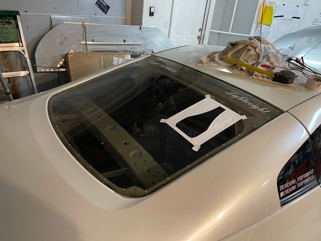

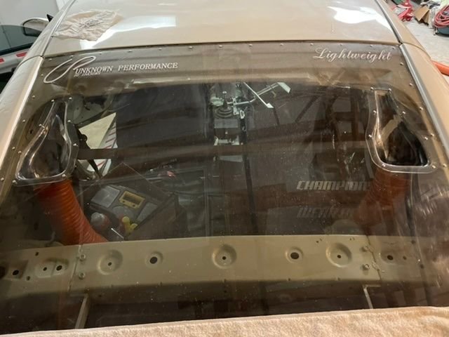

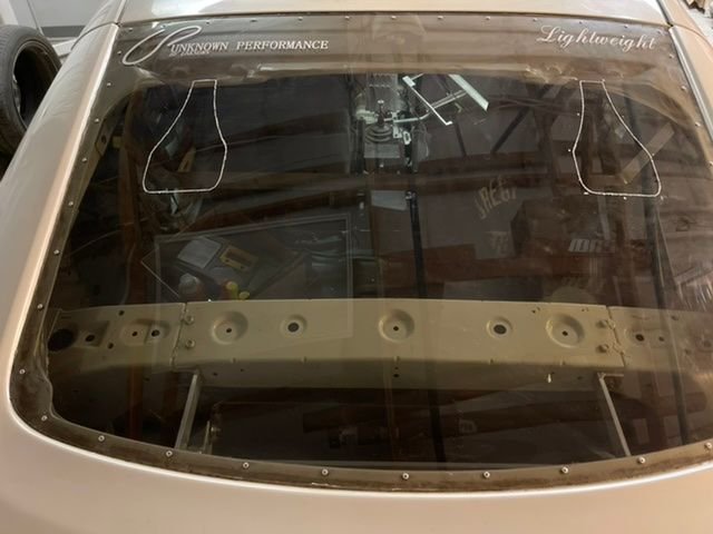

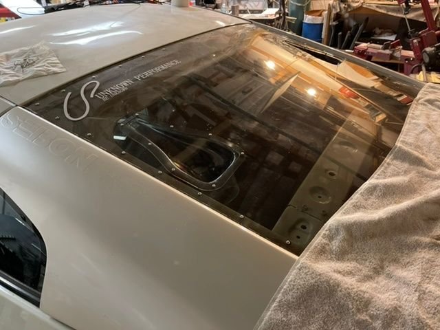

What material to you use for your rear window? How thick? Lexan?
Is is waterproof?
Looking Good!

Yea, got some 3" hose and its pointed at the oil cooler and the radiator. Im hopeful but I think this will be ultimately insufficient and I will need a way to bring more air in and get more air out.

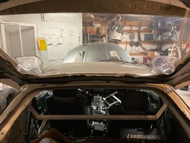

What material to you use for your rear window? How think? Lexan?
Is is waterproof?
Looking Good!
Thank you OMZ - 1/8" lexan riveted in - nope, not waterproof. Basically I wrapped the cf hatch and then riveted in. I didnt reinstall the weather seal nor did I install a sealant under the lexan - I'm not too worried about it - it's air-tight and I dont drive the car in weather so it's not a huge thing.
