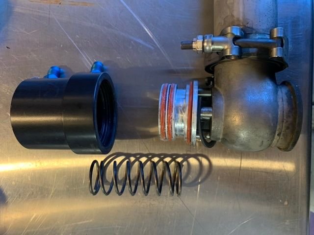

Originally Posted by bealljk
I had my boost reference hooked up to my to the top chamber of my waste gates plumbed through my boost control solenoid and the bottom chambers opened to atmosphere. Essentially - my waste gates use a pretty soft springs (like 4psi springs) and I was pushing 100% (or whatever duty cycle the solenoid dictates) of my boost reference to the top chamber to keep them closed at higher than spring pressure. Well, they want them plumbed in the traditional sense.
That harness looks so much better.
With your WG like that it seems that you are relying on the exhaust back pressure as the only method of opening them. That is an interesting setup. I definitely agree with the shop that you need reference to the bottom chambers of the WG. I look forward to seeing this thing put down some numbers.
I wonder if you have been running on 5 cylinders basically this entire time. That's almost 20% right there.

Yea - relying solely on back pressure … I was opening them around 4psi before … so I don't know. But they are fixed - it's a better plumbing. I also dropped in the bigger (8psi to 10psi) waste gate springs yesterday
Finalized the harness and did a few rounds of checking/double checking the harness to injector connections and then bolted everything back up.
The anatomy of the JGS waste gate:
I have the 40mm waste gates
http://jgsturbo.com/wgpg.html

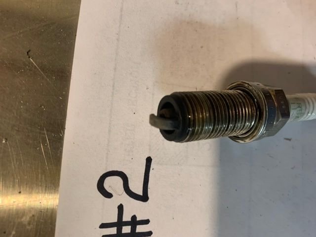

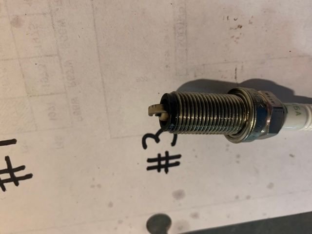

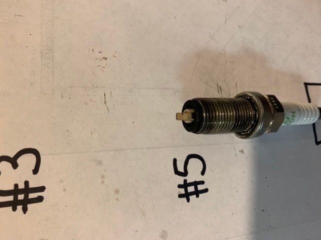

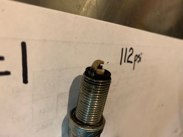

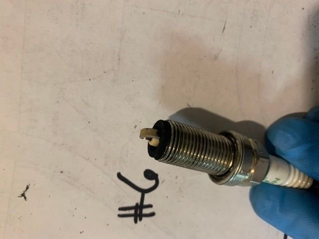

I did the oil fill cap check the late last week and I had the freak-out moment and had a light but definitely present white milky'ness on the oil cap...I didnt want to immediately freak-out without reason (it could just be condensation) ... With my tune coming up next week I bit the emotional bullet and did a compression test and a spark plug inspection to ensure cylinder #4 was getting fuel ...
well all good news ... compression came in
#1 - 112psi
#3 - 115psi
#5 - 120psi
#2 - 120psi
#4 - 120psi
#6 - 120psi
and all the spark plugs came in a little bit on the hot / lean side but nothing I am freaking out about ...
I ran the engine for about 20minutes and got it up to 225degrees and checked the oil cap again and it didnt show any signs of milky'ness.
I ordered supplies to rebuild the ignition coil connectors and VTC connectors and harnesses (will likely do this over the winter). Wont be an easy task like the injector subharness is but I can't stand the look of the OEM harness wrapping around the front of the engine ... one step at a time.
