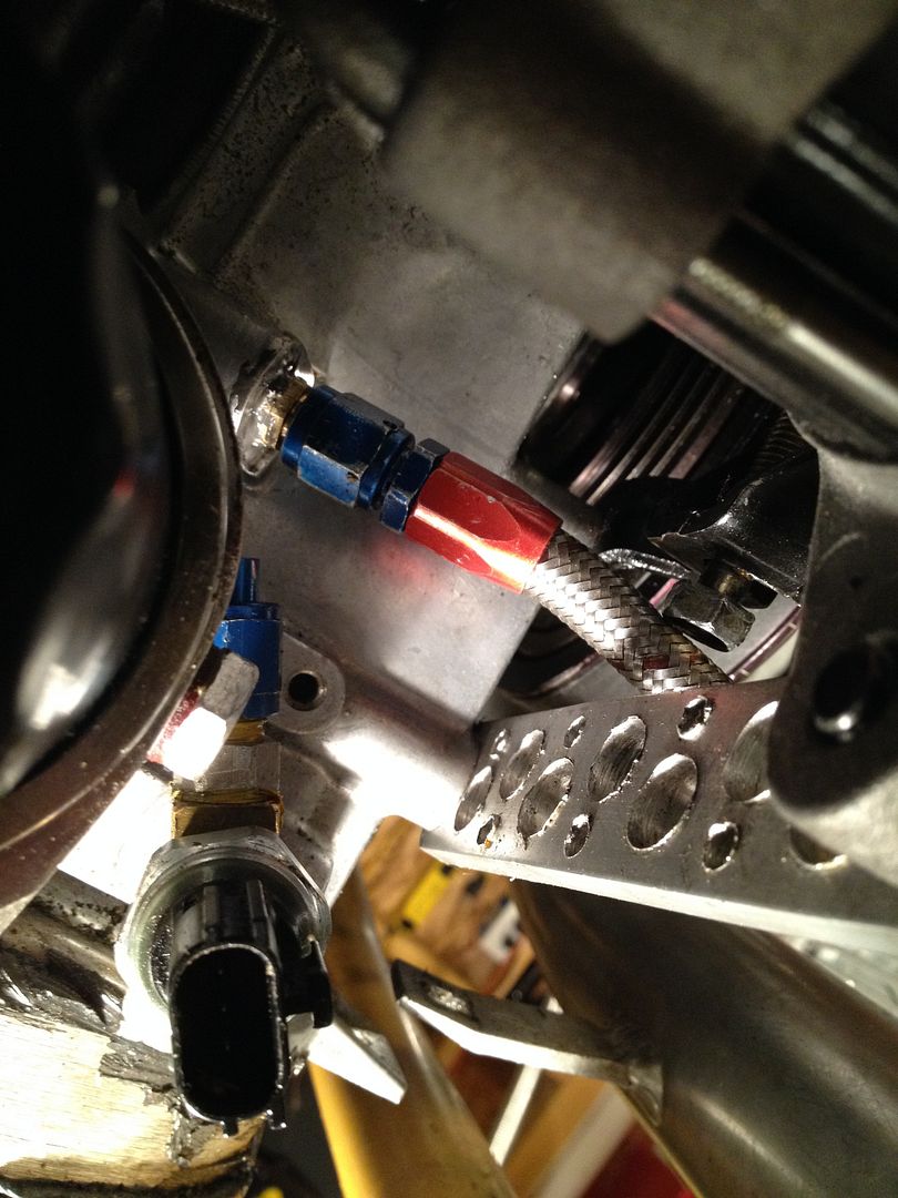

despite the weekend full of stuff to do I had a chance to relocate the pre-turbo oil cooler. Found a deal on some AN-4 earls steel braided line and some earls fittings to complete the task. Been meaning to do this for a while now.
Dont know if this is played out but I'm gonna roll with it for the time being. At the end of the day I am still one fitting short...I need a 45* bend to avoid the serpentine belt tensioning bolt...it's hitting the feedline. ****!

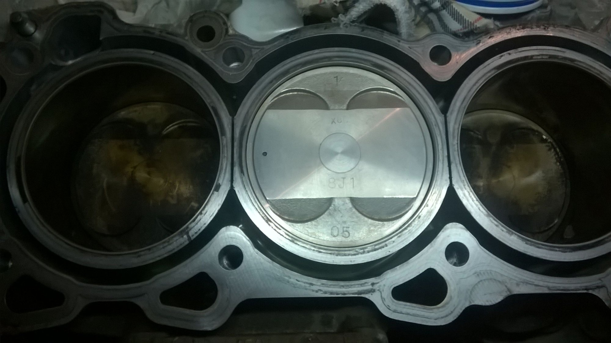

I tried many things to get rid of my knock... and few days ago I decided to dismantle my engine and remove carbon deposits from combustion chamber and pistons... Have some pictures. This "bad one" is after chemical cleaning without removing header... Just imagine what was inside before cleaning... I only have a picture from endoscope camera but on another computer.
I found that I need to replace my con rod bearings as well. Anyway... I think or I hope that was the reason of my knock... What do you guys think?

Damn that looks almost like new.

The fitting came in...I decided to put the 90* fitting off the engine and the 45* off my tee...
