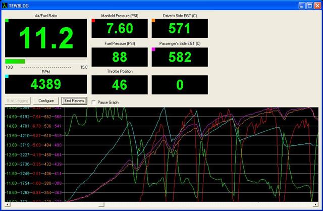

sorry it took so long... here is a screenshot of a moderately hard run... took off easy in first, then got on it starting on second... boosted all the way to about 4000 in fourth.
boost was around 8lbs, egts never got to 600 C.

the highest line values for EGTs are 588 and 592... which are the max values reached, as these graphs are scaled.
and i meant 4000rpm in 6th!!!! doh!

SKiDaZZLe,
What is the highest fuel pressure you've seen?
Also, what system is that?
Thanks.

That's some awesome sotware, I see 300=400 around town and 700 when on it not even as high as just before 800 but the alarm is set for 825 and hasn't went off since dropping to 9 PSI and the probe is post header pre car driver side bank on a stocjk fuel pump for now. My A/F on a WOT Duno run was from 11.2 to 12 max at 6600 rpm's.

Originally posted by IceY2K1Max
SKiDaZZLe,
Thanks.
That's the software from the Techedge Wideband O2 sensor. Not only is it a wideband O2 sensor, but it can graph and log lots of other different things. SKiDaZZLe put together a group buy on the kit here on my350z.com. I've been running that unit and software for about 6 months now. Nothing but good stuff to say about it.
