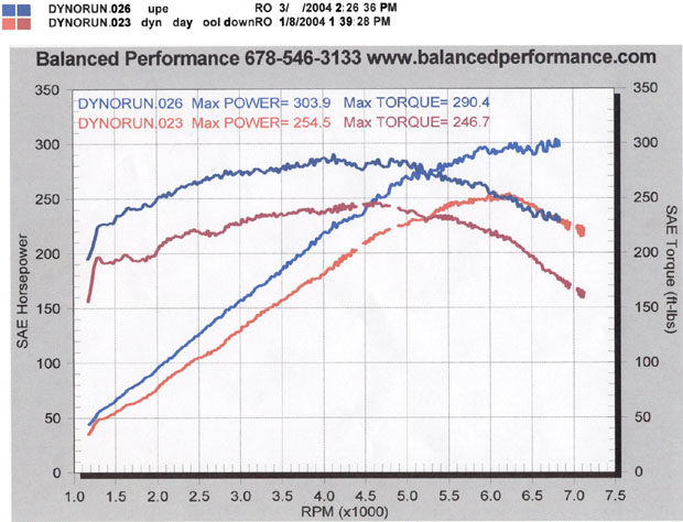

To bring this one back from the dead. Here is the dyno from before I had the intercooler hooked up. Notice the entire torque and hp curves shifted up by approximately 50 hp/lb.ft. The intercooler is now working and time slips will be posted sunday night.

it actually appears to have a 70hp gain at redline.

How much PSI was that with?

7lbs. I wish I would have gotten back to you earlier. I logged on tonite to say I wanted to buy your wideband, but its sold

Ahh sorry I might do a group buy on them, seems like a few people are interested and I know I can have the retail beat by alot.. Do you have any dyno sheets with the intercooler? Looks good.

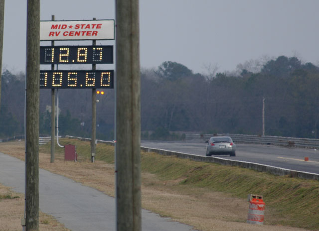

The cookout was great! As for the supercharger, check this out!

let me guess .......your 60' time was 1.84????????..Nice run Bro!

nice run. going to commerce this friday night. let's try to get the z guys out for some fun. my car is running and i am interested in seeing what stock guys are getting. once again, great job. i am impressed.

Nice run! What yas your 60'??? Where you on your et streets? Also, I'm guessing you got your intercooler hooked up and cats replaced? I'm considering the stillen myself and those 1/4 times make a good case for that setup.

60' was 1.802
et streets, intercooler running, hollow cats.

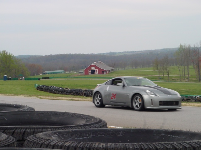

2003Z do you have any pics with the new hood? I wonder what this kit would look like poking out of the hood. It would kind of remind me of the old muscle cars with tunnel rams. Either way impressive run, congrats. I like the Stillen kit more and more everday, this kit would also allow me to keep my custom Gruppe M intake.

here is one. I think I'm gonna get the full hood though, and paint it all silverstone.

the hood ..............thats all I can say...... the hood..........

Please post the results, great time, but the trap speed is very low for that much whp. That is only 1 mph above my NA trap and I dont even have cams or headers! I'm guessing the midrange is nice with the Stillen roots type s/c, but the top-end isnt all that great. Enjoy it...

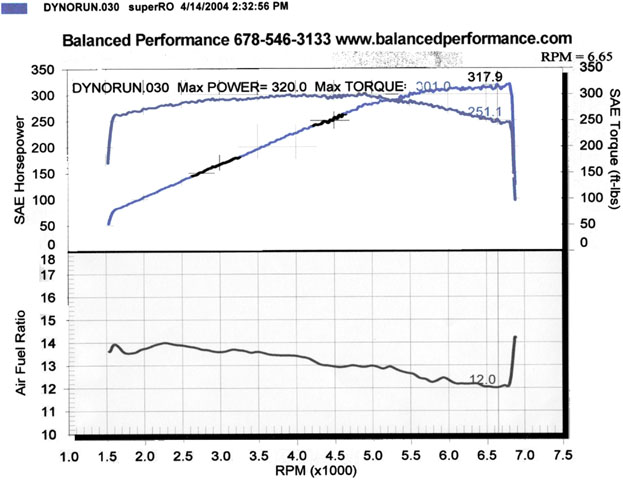

Not as high as I thought. It's running pretty lean too. Stillen says its because of my hollowed out cats, and that it should make more if I put the stock ones back on. They are coming out with a new black box for this soon, and I am talking with technosquare to see if they can give me some fuel enrichment without changing the timing. The torque curve is awesome though, 270ftlbs @ 1700 rpm!

Nice results....I think that is the highest I have seen for a Stillen kit. How does this kit manage timing and fuel?
