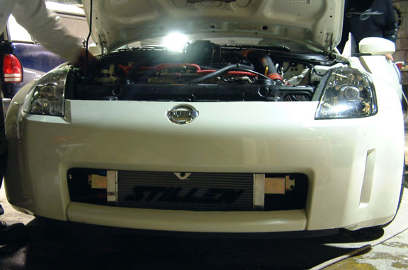

Default Intercooler
Here's some intercooler pictures.

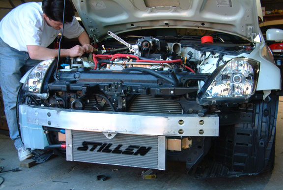

Default intercooler2
Intercooler2

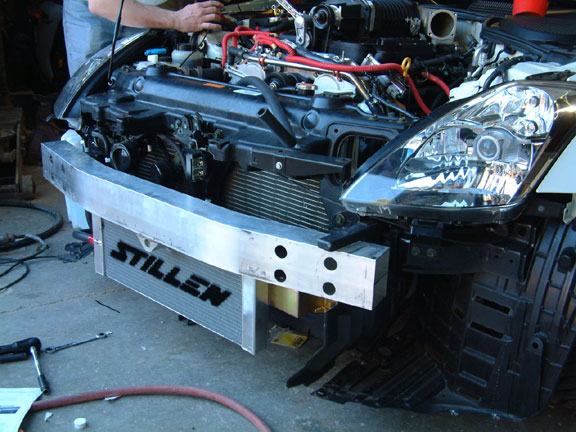

Default Intercooler3
Incooler3

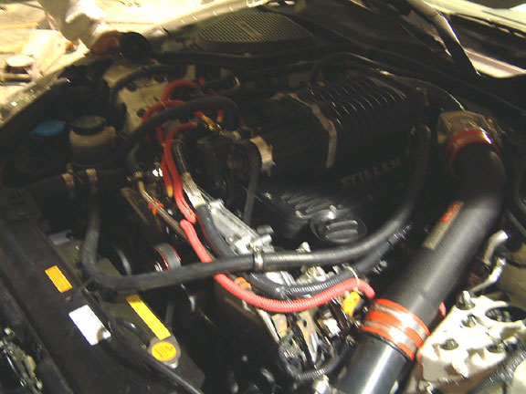

Default Incooler4
Intercooler4

One of the main reasons that I visually dislike the Stillen intercooler is the black hoses that just seem to be laying in the engine compartment. Is there a better way to route the hoses. Also, would it be possible to use braided line with AN fittings to connect to the IC and the intake?

We will be doing that braided line soon.

How does that intercooler work??I am not familiar with the function of an Air to water intercooler..

There are 2 heat exchangers and a water pump. One heat exchanger in front of the car and the other one is under the upper plenum. Water pumps through the front heat exchanger and cool water circulates through the heat exchanger under the upper plenum. When the air passes through it, it exchanges heat and the hot water is carried to the front of the car to get cooled again.

Default Air to air better?
Wouldnt that limit the cooling to the temperature of the water? Since air flowing in from the front could be 50 to worse case in Texas 100 degrees outside, wouldnt a air to air be more effective?
I doubt the water ever gets any cooler than 100 after the car is running.

You are not using the water from the engine. It's a different water storage.
