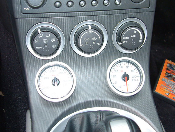

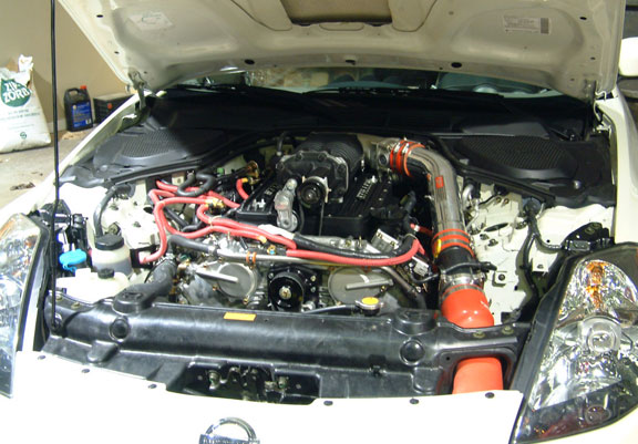

Old Jan 24, 2004 | 07:09 AM
m3powerrr's Avatar
m3powerrr
Posts: 165
From: atlanta

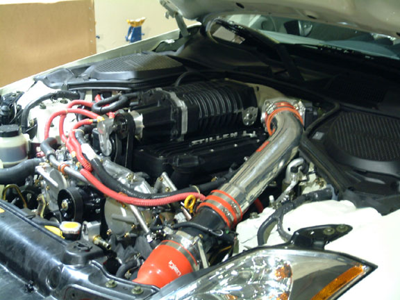

Default After
After

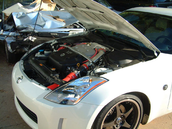

Old Jan 24, 2004 | 07:10 AM
m3powerrr's Avatar
m3powerrr
Posts: 165
From: atlanta
Default After2
After2

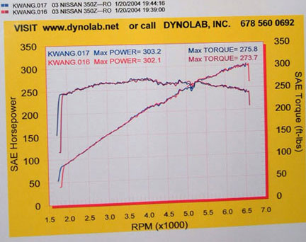

Default Dyno Sheet
Dyno Sheet
OK, here we're looking for the gain. Please just dont' post your numbers. I'm trying to compare and troubleshoot.
Before supercharger = 226hp
After Supercharger = 303hp
Conditions were identical.
We ran a base run on Fri. Installed the unit, then dynoed on Sunday.
Please don't post 'so and so's car with the same unit did 350hp'. I'm looking for the gain. Before and after.

Default Overall
Overall
Overall, I have to say this is the easiest bolt on I ever worked on. 2 People working on the car with 1 goofing off half the time, we knocked this baby out in less than 6 hours.

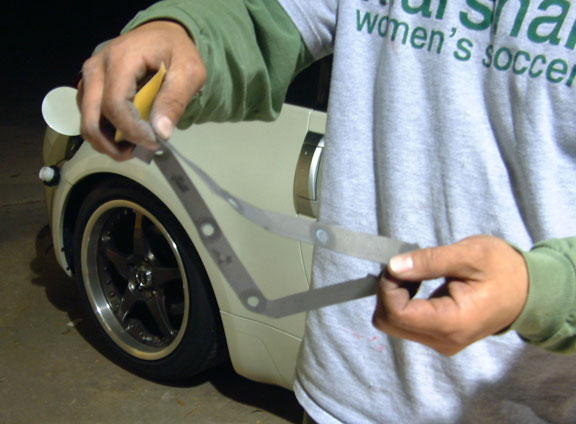

Heres the problem. At first start up, it ran good for 10seconds and a loud pitch noise was present. We called Stillen and they said it was a vacuum leak. There aren't that many hoses that we had to fool with so it was easy to check for leaks. Here's what we found. The leak was coming from the seal between the supercharger and the upper plennum cover. These two parts come preassembled from Stillen.
So, we took it apart and noticed the bolts that hold these two parts together were loose and didn't have locktight on them. Well since there were no torque specs on these bolts, we tightened them to our discression.
Put the thing back together and the noise was still pressent. It's almost like when you stretch a mouth of a baloon.
Took it apart and RTV the damn thing. Problem solved.
Here's the picture of the gasket Stillen used. Piece of **** if you ask me.

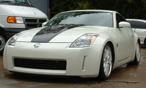

Old Jan 24, 2004 | 09:59 AM
m3powerrr's Avatar
m3powerrr
Posts: 165
From: atlanta
Default Hood Pic
Parts + Labor = $6000

Old Jan 24, 2004 | 11:33 AM
m3powerrr's Avatar
m3powerrr
Posts: 165
From: atlanta

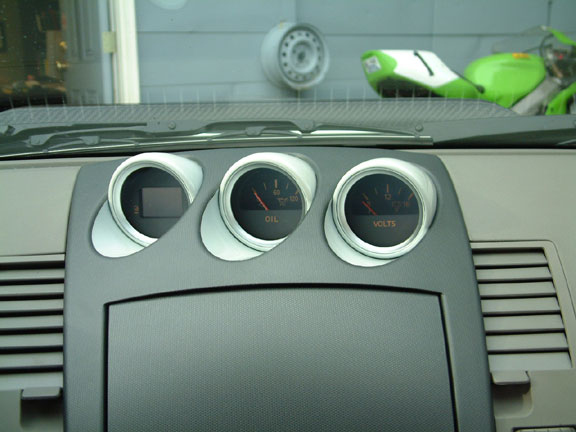

Default Some more pics
interior pic1

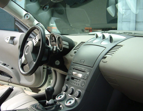

Default Interior pic2
pic2

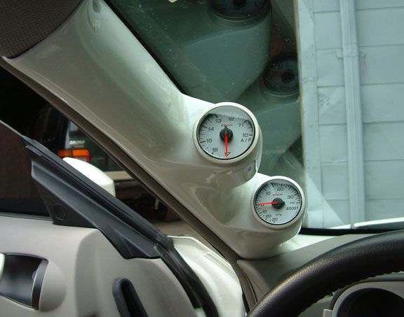

Default interior pic3
pic3

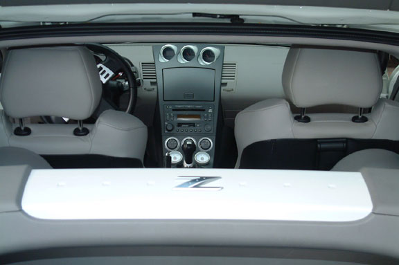

Old Jan 24, 2004 | 11:35 AM
m3powerrr's Avatar
m3powerrr
Posts: 165
From: atlanta
Default Another
another

ooohh! Very nice! Who sells that guage pod? Or did you have it painted?
It's all custom mold job. It was all done in-house.
