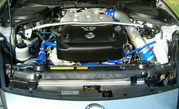

I'll go ahead and post mine:
2003 350 Z Touring 6MT
-- Greddy TT
-- FMIC
-- Greddy Type-S BOV
-- E01 Controller
-- Crawford Cats
-- EFI WB Sensor
-- JWT Clutch
-- JWT Flywheel
-- Hotchkis F/R Sways
-- Walbro 255
-- Aeromotive A1000-6 FPR
-- Fuel Return System
-- NX N-Tercooler
-- Wilwood 14" F/R
-- Timing Harness
-- WB Harness
-- OEM Track Wheels
-- Toyo T-1s
Stock internals, for now.
Engine Control: E-Manage
Fuel: 440 Injectors, Walbro 255lph, Aeromotive 1:1 FPR
Timing: Greddy Timing Harness
Boost Controller: E01
Exhaust: Crawford Cats, stock muffler
I am 406/397 to the wheels @ 8.5 PSI <-- we were rushed and could have tuned it a bit better.
A/F is barely under 12 full RPM range. Having it re-tuned and lowering A/F.
To be installed very soon:
Borla TD (Hoping for some gains here)
Crawford Plenum and Strut Bar
Pressure Sensor Harness
Re-Tuned using the pressure sensor harness
5k miles on the kit, I had a problem with an exhaust leak, had it fixed with Metal Turbonetic gaskets. Other than that I have been just enjoying the booooost....pssshhhhhhhh.
http://350tt.com/cars/creampuff/
