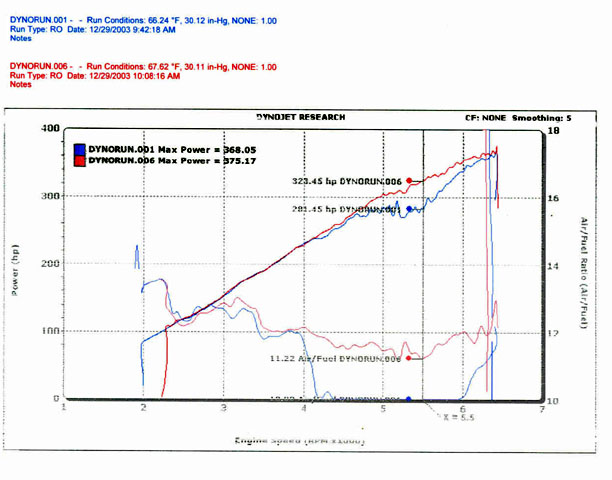

My car will be going in to the shop on Friday Feb 6th to be fitted with that piggyback we discussed.I decided to do a MAP for 9lbs for now utilizing the DFMU still for the time being..This should easily support 425 to the wheels..This unit is very versitile and can be added to in the future, Via Extra injectors or larger ones..The problem you face with the larger ones is at idle the fuel tends to Drip out, washing out the cylinder walls..I think the optimum setup will be a second set of staged injectors...I can get this ECU to you relatively cheap..It will however be tuned for 2 seperate maps @ 9lbs utilizing the DFMU (which will flow very adiquate amounts of fuel from what I was told by Aeromotive),which will later be replaced with Staged injectors running off of a larger or secondary fuel pump...PM me for pricing Robin..It might help you much more than a reflash at this point as you will be able to tune it up to the limits of the DFMU for now and still have the Fastest G35 in the USA right now!!..
Here is my initial DYNO @ 7lbs...https://my350z.com/forum/showthread....threadid=54140

Tadashi is a drifter and a racer, who says he is limited to 425hp? Did he himself say that? I highly doubt it.
Lots of wierd info here, he flashed my ECU at 11 pounds and it never even made the front page lol.
My only limiting factor was my stock internals, a larger fuel pump, and a FPR.

but yeah.....when the untested pulleys were on Max's car, he was making 11psi.......he's making 10psi right now with a mixture of the pulleys......ECM is handling the fueling and the timing.......no problems so far.......the thing's a beast
