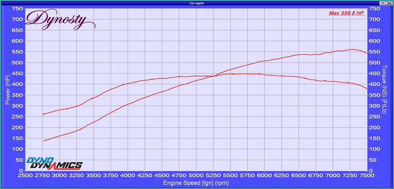

6766 T4 1.32 a/r dyno:
There is not much of a taper of HP at the top either, so maybe there was more left in this build with pump gas? Hard to say, as I am not the tuner.
I know the 6266 will do the job for what you are after, because I have customers making close to mid 600's (DJ) with a T4 .81 a/r housing and pump gas on simple short block builds. It has proven itself IMO, but the T4 housing is key.

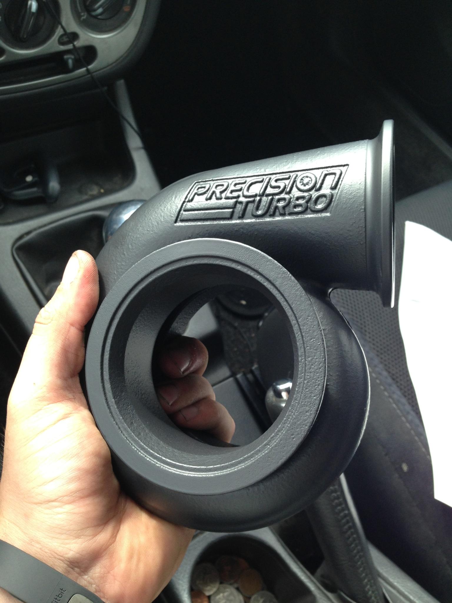

Here you go OP. A PowerLab kit with a PTE6266 and V-band turbine housing that made 527whp on pump gas and 650whp on Q16 race gas.
https://my350z.com/forum/exterior-an...50hp-z-21.html
Here's a pic of his ceramic coated V-band housing...

Hmm really thought it would be more impressive then that. I mean he made 527 at 18 psi pretty much what ppl are making on these gt35r's at simular/lower psi.
Considering the e85 option Aswell seeing as how I have 1k injectors and a large enough pump however not sure if my Walbro 400 is the e85 version. I know on overthinking all this. 500whp is more than enough to destroy a road course.

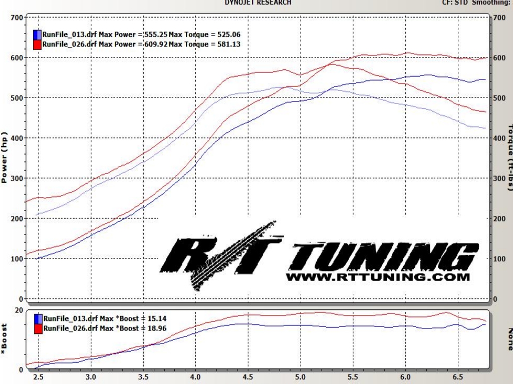

For comparison sakes, here is the same turbo with a T4 .81 a/r housing on 93 pum gas. Short block build..nothing else.
I know that Vince said there was another 20-30 whp left on the table with that particular setup/boost pressure, and the tune was more on the conservative side as the customer wanted 600whp...there was no desire to push it any further.
