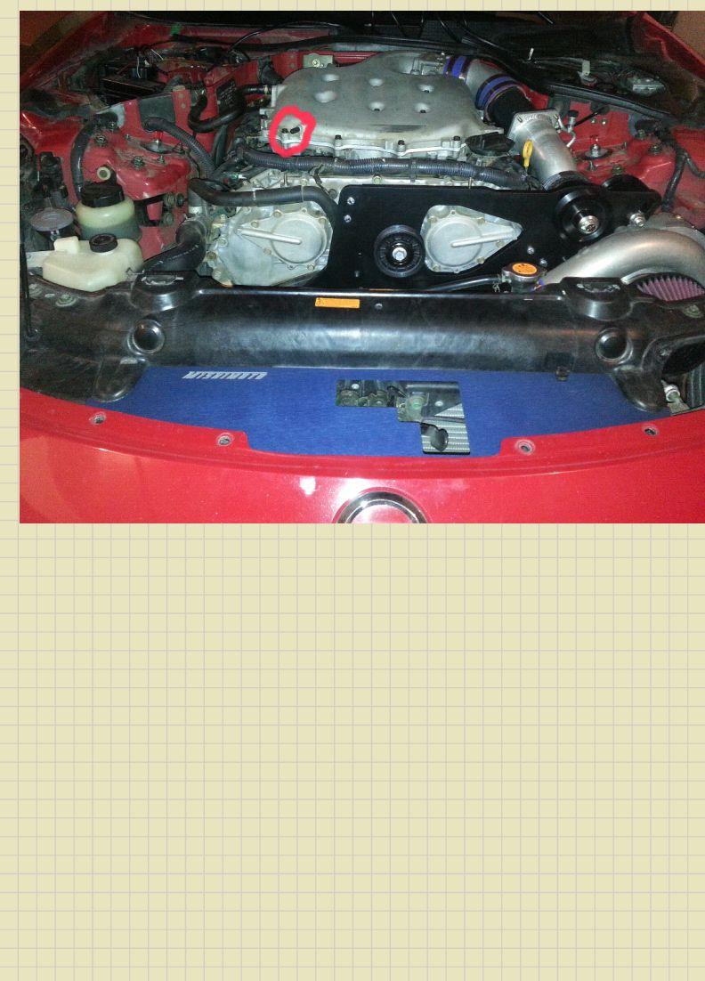

1- I have researched and it looks like most people run the Vortech bypass valve "manifold vacuum port" up to the front little stub on the upper plenum. Is this correct?

1. Anywhere you pick up Intake Vacuum is fine.
