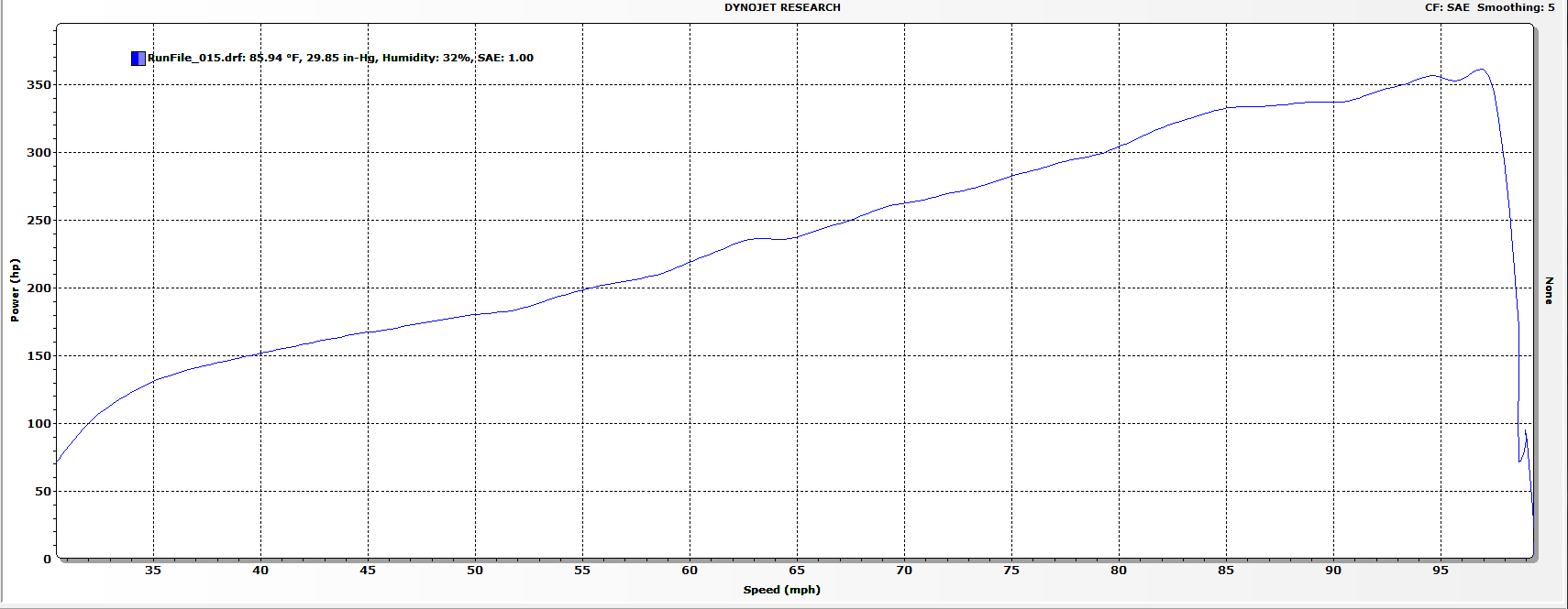

just figured id share my dyno results today. finally had time and was able to get properly tuned. switched from cobb to uprev due to a few more features such as starting enrichment and better support. peak hp was 369
