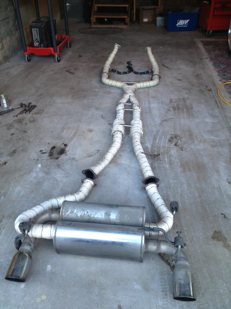

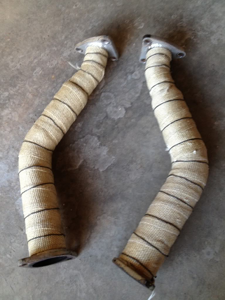

I dont know the power labs kit that well but I would think 100ft of 2" would be enough. I would get a 1" roll of 50' to wrap your headers. A thinner wrap will contour the curved pipes better than a 2". I would use whatever you have left over to wrap your headers/exhaust as far as it'll go back. I got 6 rolls and had about 2 rolls leftover, so I did my bikes headers/exhaust.
I would also ditch the metal ties that DEI provides and use a thick bailing wire or rebar tie wire, just make sure its not coated!!!
