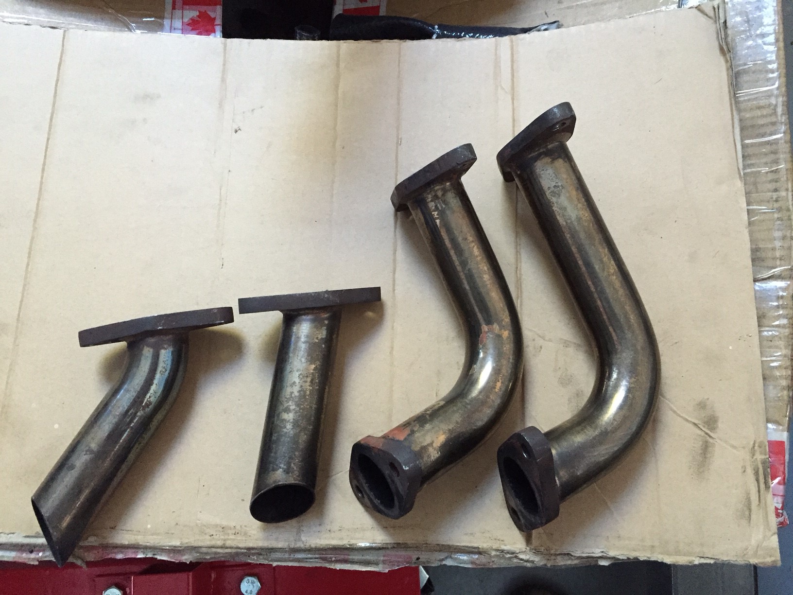

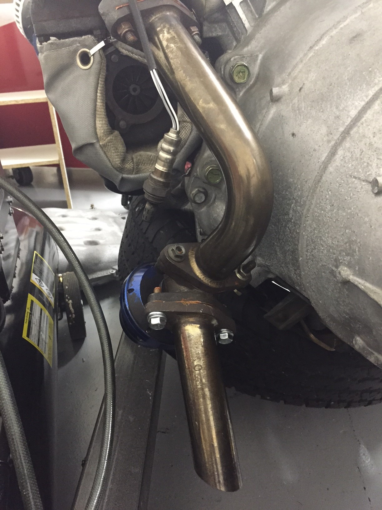

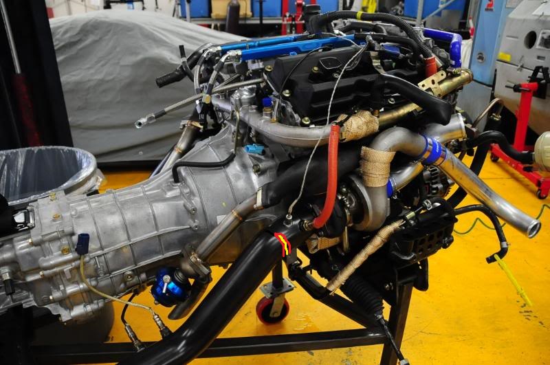

hello, I for the life of me cant figure out how these will work. I have spent a few hrs trying them every which way possible. They came with my aam 3" downpipes but I dont know if they were a kit or what, it was a trade and the guy never installed them...Im wondering if they just wont work with my downpipes?? Anyone have any ideas I'd appreciate it...this is the last thing I have to do until I re install the engine and tranny back in the Z. As you can see in the pic,. there is no way to install the wastegate without it hitting the downpipe.

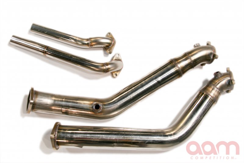

from the looks of it, I have aam downpipes, but my wastegate relocation kit doesnt match up. I wonder if my wastegate relocation kit is svrt or something else? Thats why they wont work

Even the AAM are tough. You have to install in the right order on the car to get them in. I had to clock my wastegate to get the ports facing the right way for plumbing the boost signals.
Those look like they locate the waste gates down low and out of the engine bay which would make them easier to service. The relocation pipes are not AAM.

yea they def. relocate them down which is nice, but they just wont fit at all. Im just trying to figure out what I have. What do you mean by clock them? I think the only way to make them fit is to cut and re weld them I guess. This sucks

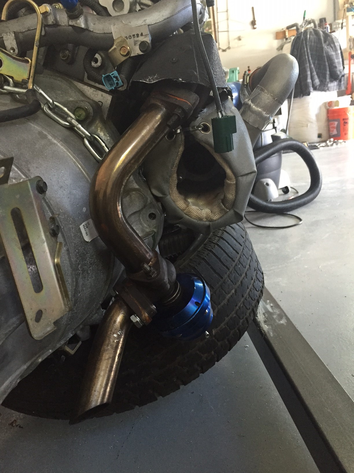

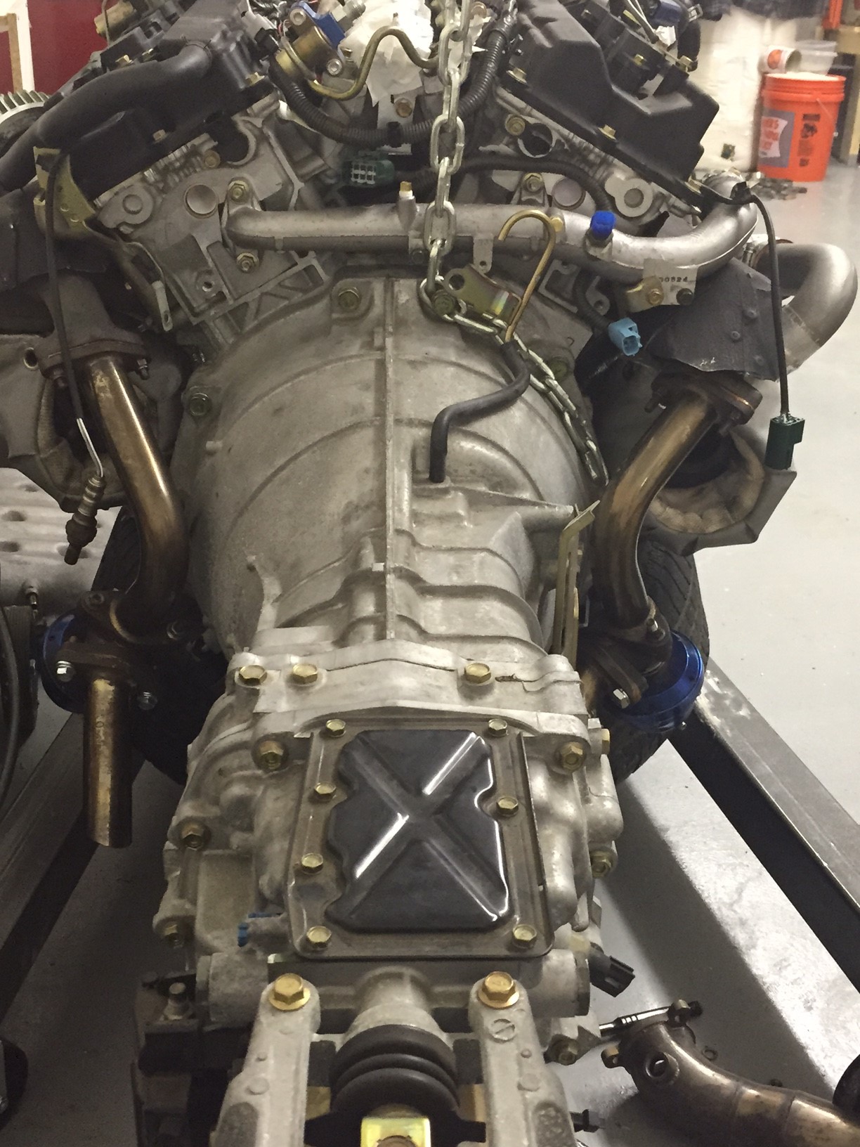

went ahead and mounted them, this is really the only way I see they can go...im just going to have to modify the downpipes, ie beat the **** out of them with a hammer to make room. I may get the torch out and try to bend them where they mate up with the turbo for some more room. Do you think denting the pipe will make a big difference in flow? I really dont see any other way.

that looks right. Have you test fit the downpipes?
I wouldnt hammer them much since it will affect flow but i doubt it will matter with open dumps.

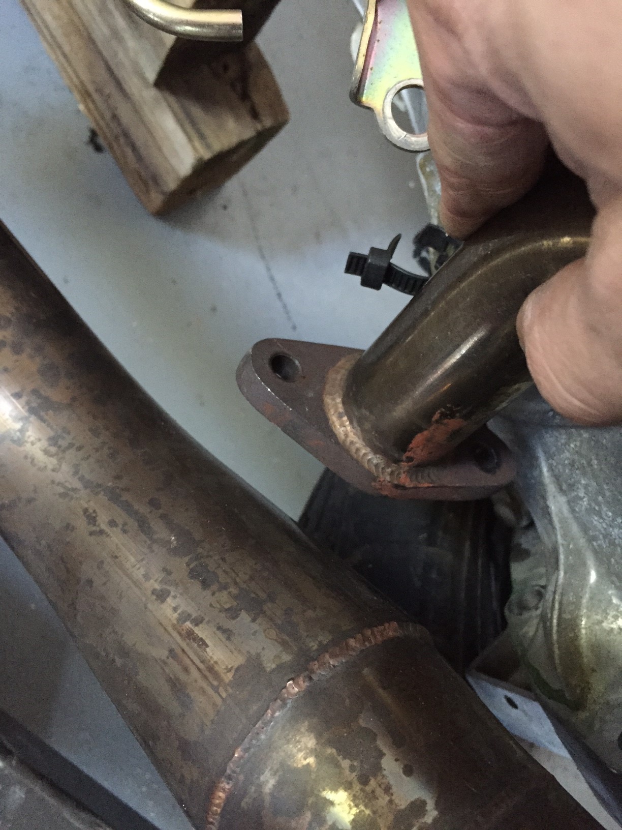

I test fit the passenger side, it def. wont make it. I will need to modify it in some way for sure. The driver side is having a bung welded in for my wideband, I should have it back tomorrow or so and I can check the driver but it honestly looks worse. Instead of hammering dents in it, do you think I should try to heat it up really hot and try to just bend them while they are bolted to the turbo? With the open dumps im hoping I can get by with the dents. this sucks its always something.

Too late! Took the grinder to them. Worked out pretty well, was able to bend them up and out away from the wastegate. Now just have to weld em back together The dump tubes really cant be moved anywhere except lengthened to be below the downpipes. That will be more difficult imo. I'll post some pics.
Cux, glad you said something about clocking the wastegate, I did that as well to keep the line from hitting the pipes.

I have these same dumps and I'm pretty sure they are meant for the greddy test pipes they are smaller then the aam

yea thats what I figured. I knew something was off. Do I have mine installed right? in post #9?

Looks right from this thread this guy puts them on
