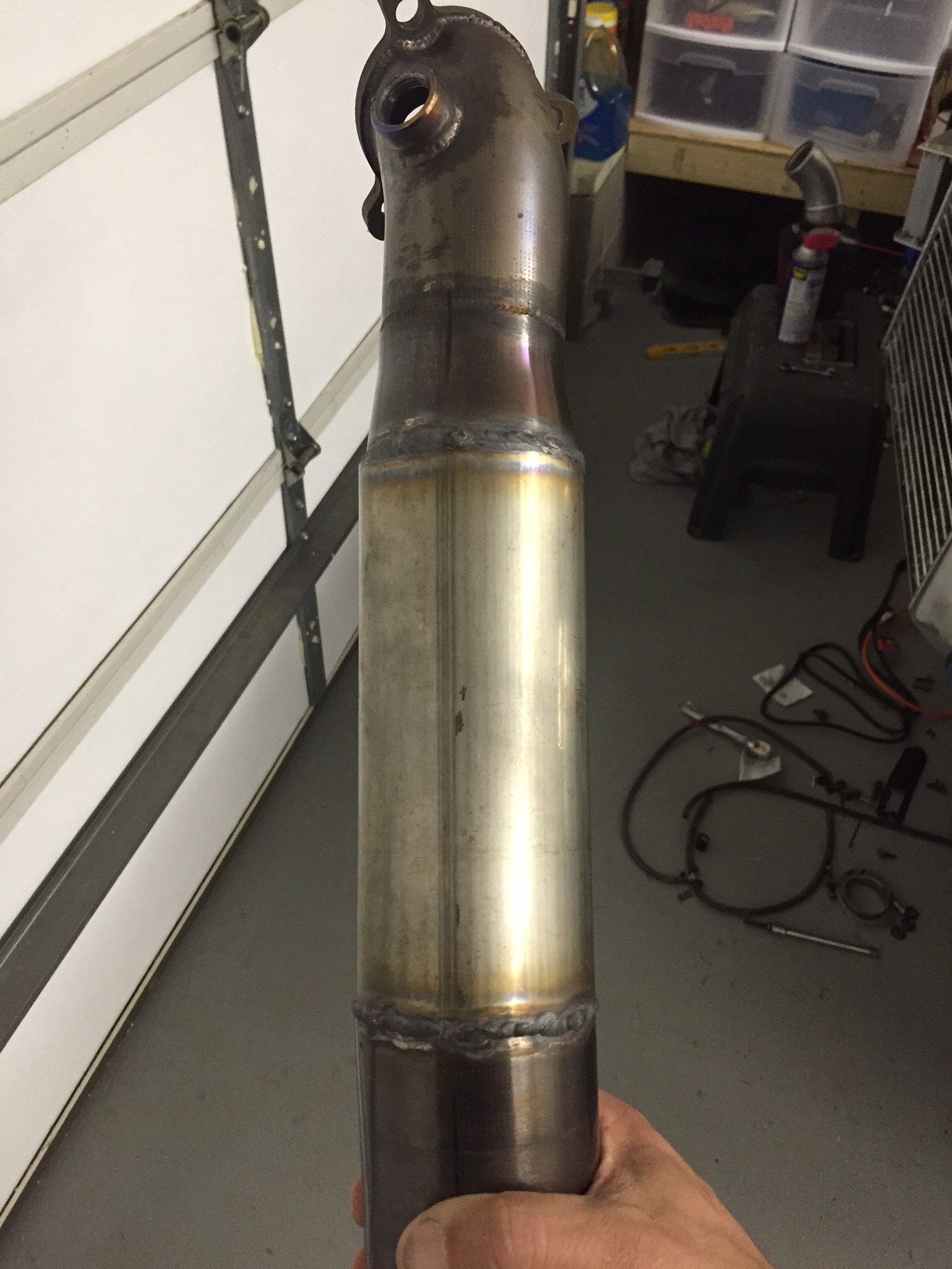

Update for you guys, im going to modify the wastegate relocation pipes. I was at a race shop in mooresville today and snagged a piece of 1.5" stainless exhaust pipe that is exactly what mine are made of. Worked out really well. From what I can tell if I add about an inch to lower the wastegates, it will clear the pipes. Im meeting with my welder saturday and I will post plenty of pic. If anyone else encounters this problem they will know how to fix it!

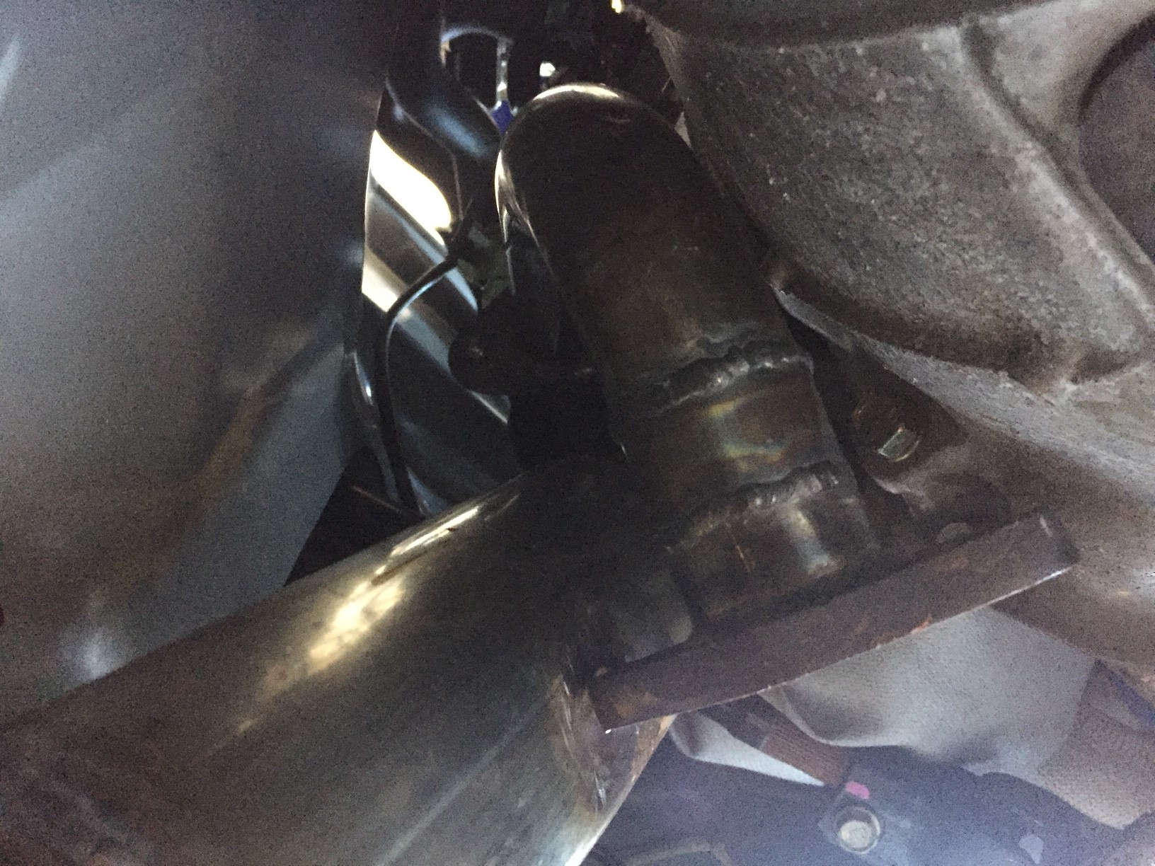

ok, so I got the driver side done finally. what a nightmare. Here are the pics of it mounted.

I added 1" to lower the wastegate down, but it still had a slight clearance issue, so I made some dimples with the hammer. The second pic is just a piece I welded in because I dented the original so bad. The passenger side is totally changing. I will post pics of that when I get them back.
