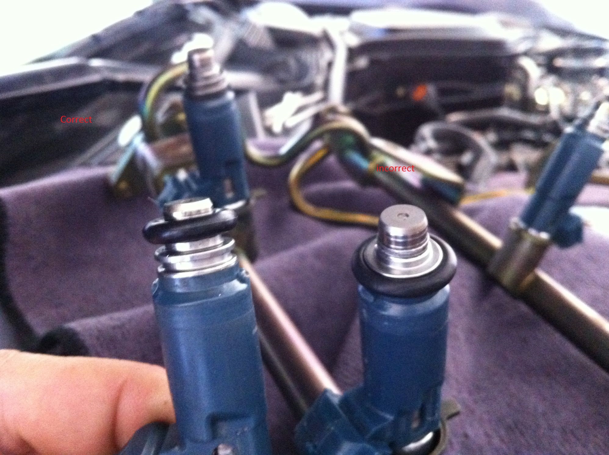

Procharger Project (4 months of hell)-image_a07a1f878706869a4c6f8b8197f37e23ce256e02.jpg
I had the same problem you are having, I had to make a phone call and ask about the grommet.
Click on the picture, F you Microsoft paint!

Well guys, the car is fixed. On the pic above, the left injector was the corrected way.
It turns out the problem I was having was my fuel rails (Thank you JDM & Conway for the info to check that). The passenger side fuel rail wasnt sitting flush like it should. For some reason cylinder 1 injector would not completely sit flush in the block but all the remaining injectors did. Causing the huge leak I was having (Bogging out the car on acceralation and rough idle).
The fuel rails sit on 4 plastic washers (bolts go thru them and hold the whole rail and injectors down). So I took out the plastic washer by cylinder 1 and bolted down the fuel rail. All the injectors sat flush after that and the car runs great!
