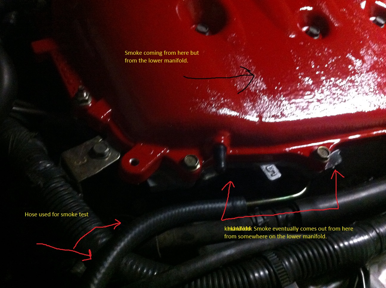

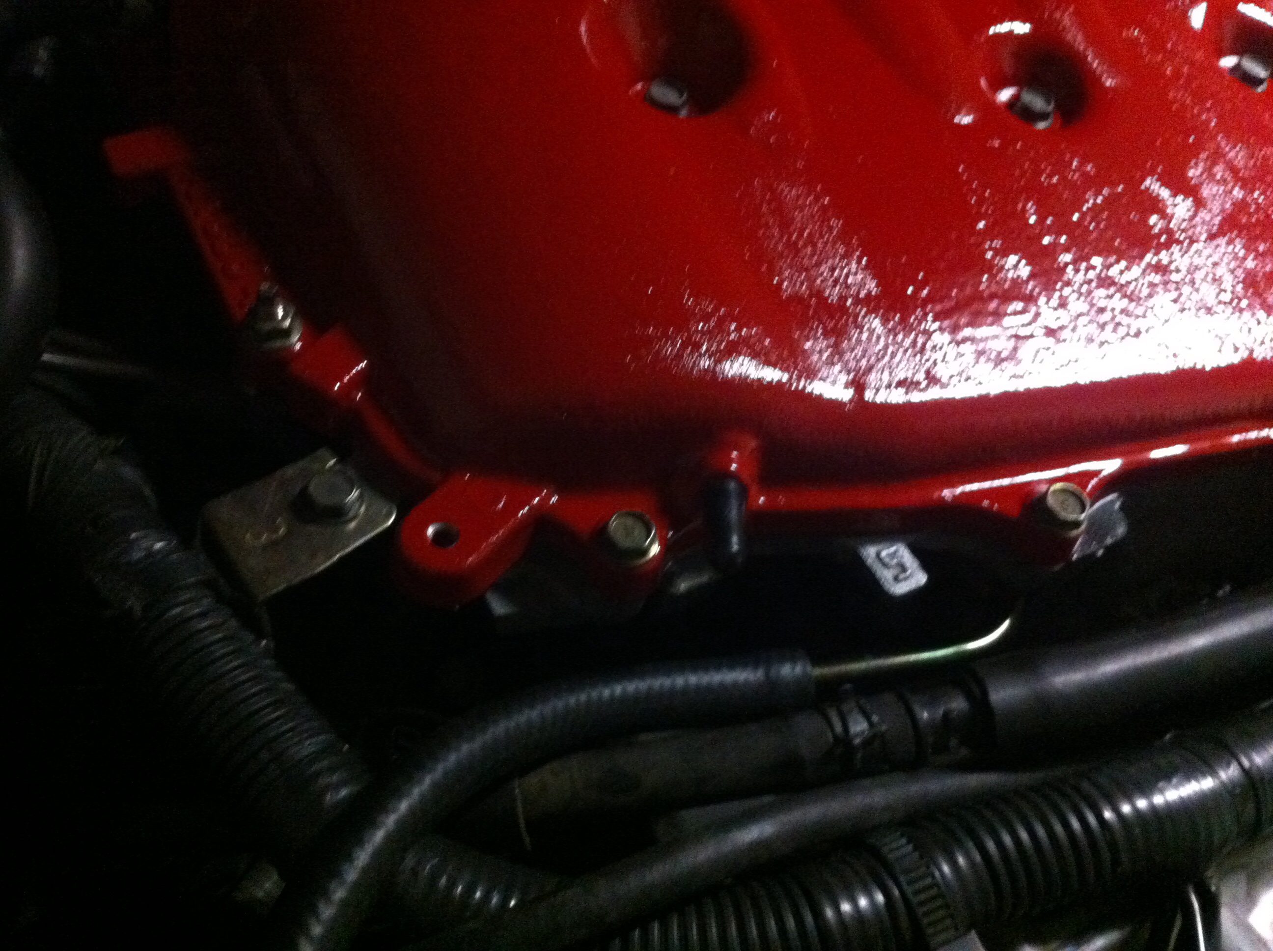

Hey guys, so I notice with the supercharger belt is disengaged the car idles rough but doesn't spudder when I accelerate. With the supercharge belt engaged. It idles rough and spudders when I accelerate. Keep in mind, I don't have a straight tune yet.
I did a smoke test with a cigar and a hose an saw smoke coming out somewhere by the lower manifold. Not by the lower manifold gasket tho. Like by the injectors somewhere.
Check out the picture..... It's coming from under that plenum by the injectors. I was blowing smoke thru that inlet as well. It that the right area to hook up the hose for a smoke test?
Where could smoke be coming from on the lower manifold if that gasket is brand new?
Cant really see anything from your picture, are you sure your lower plenum isnt hitting your fuel rail? I would take it all apart and make sure every thing is ok. I know I was having a problem getting my to seat right when I took it apart just had to mess with it for a little while.
seems like it would have to be either a warped plenum or you pinched something in there like a wire, or piece of insulation. The plenum could also be held up by the injectors but doubt that would happen with deatchwerks unless you didnt seat them correctly. I know for my RC750's I had to grind down a bit off the bottom of the plenum for it to sit all the way on.
jdm-v35 & Conway_160, thanks for the reply.
I know there's no debris between the gasket and the lower plenum. Cause I sprayed it down with carb cleaner and put some oil on the gasket. But it may be hitting on the injectors or fuel rail. Ill check that out again.
This may be a stupid question, could the smoke be coming from anywhere else down there besides the lower manifold?
Here's the same pic but with the smoke areas marked.
down there the only things that could be leaking would be injector O-ring(maybe you tore it on install) or the lower manifold/runners section could be not seated correctly(due to injectors/fuel rail) or the lower manifold is warped if you are definitely sure you didnt pinch anything in there.

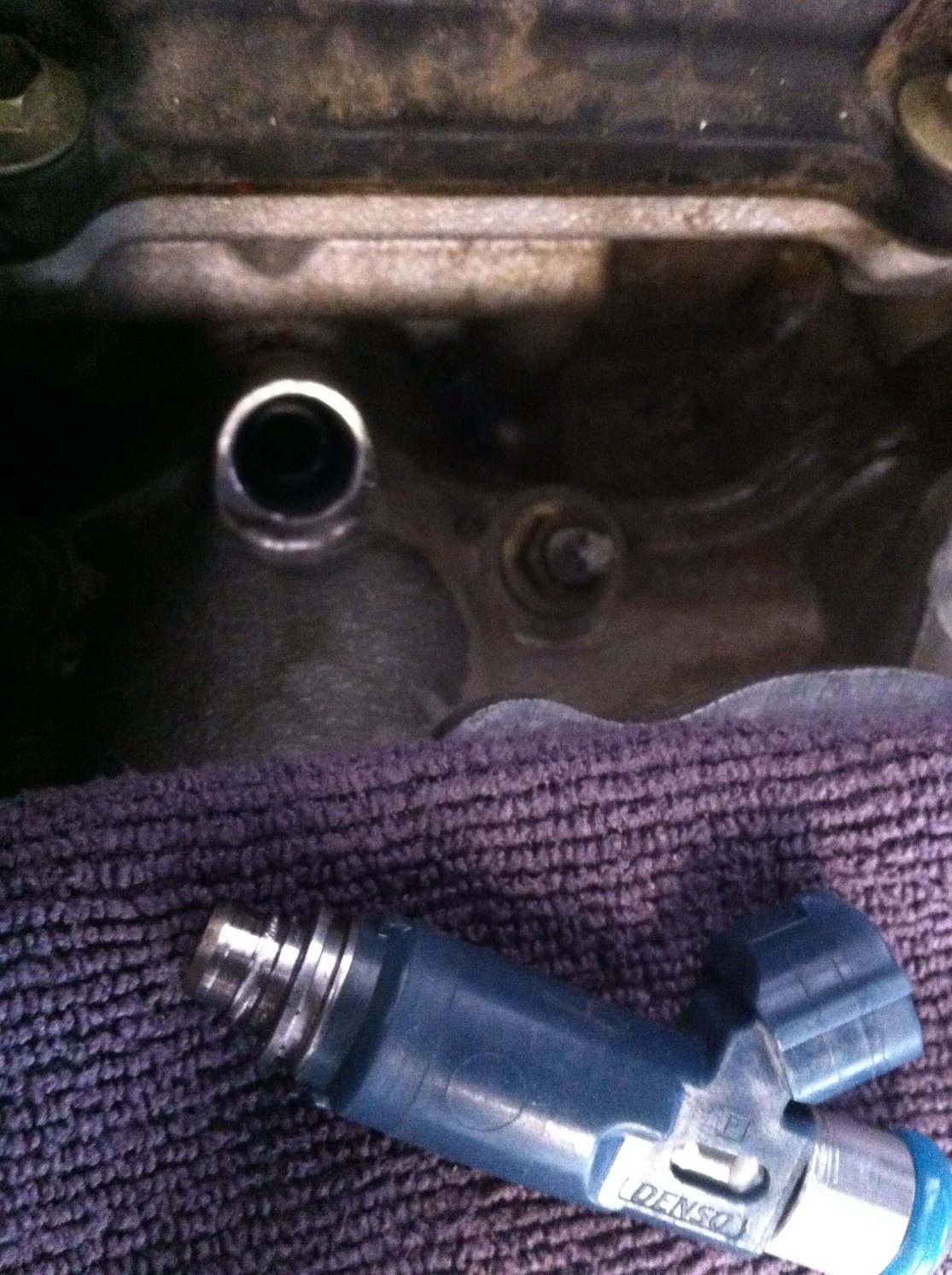

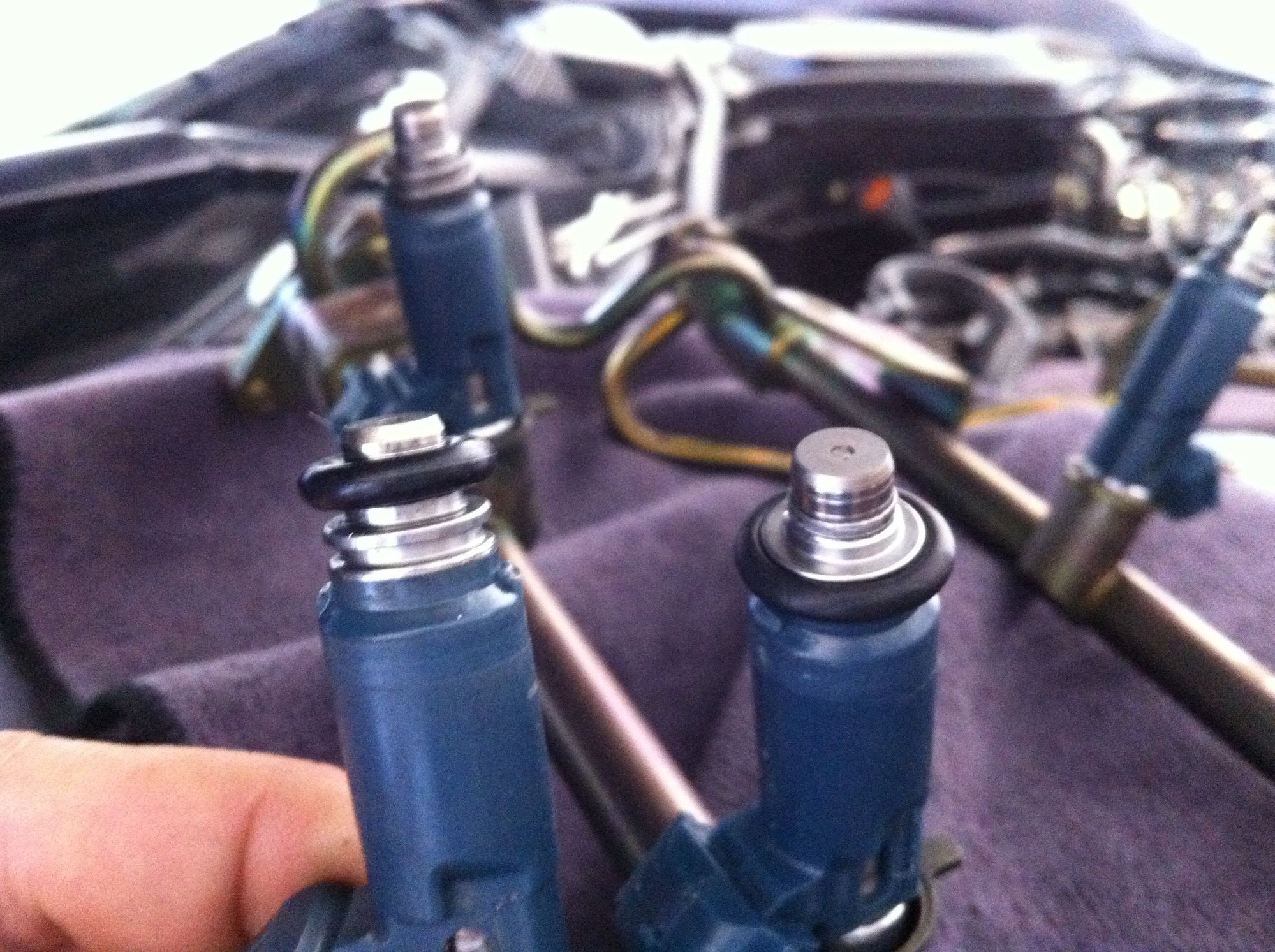

Hi guys so I popped out the fuel rail and Deatscherks injectors and noticed that the rubber grommets didn't come out with the injector. The stayed in the block. So I cleaned them an noticed that when I install 1 individually, it sat snug (kinda popped in) but was loose with out the rail. Is this normal for this brand injector?
I took 2 pics.....1 is with the grommet on how it came(with issue above). The other with the grommet pushed up further, but with it like that, it doesn't fit in the block cause pushing it up kinda expands the grommet. Did Deatschwerks sent me the Wrong injector or does it sit loose like that with out the fuel and pop out that easy?
