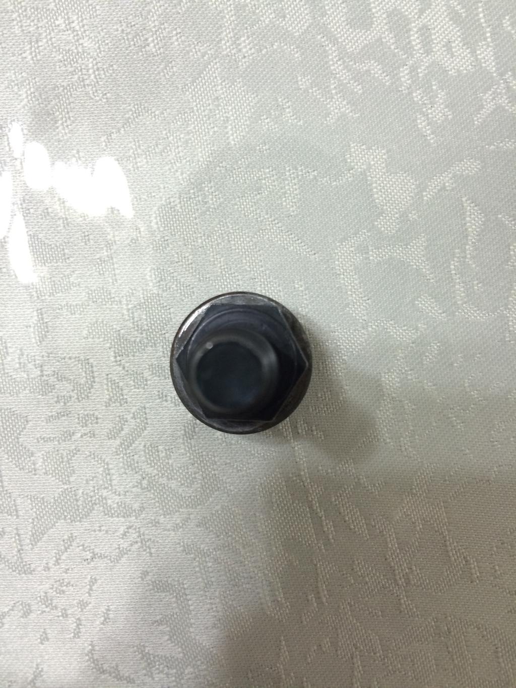

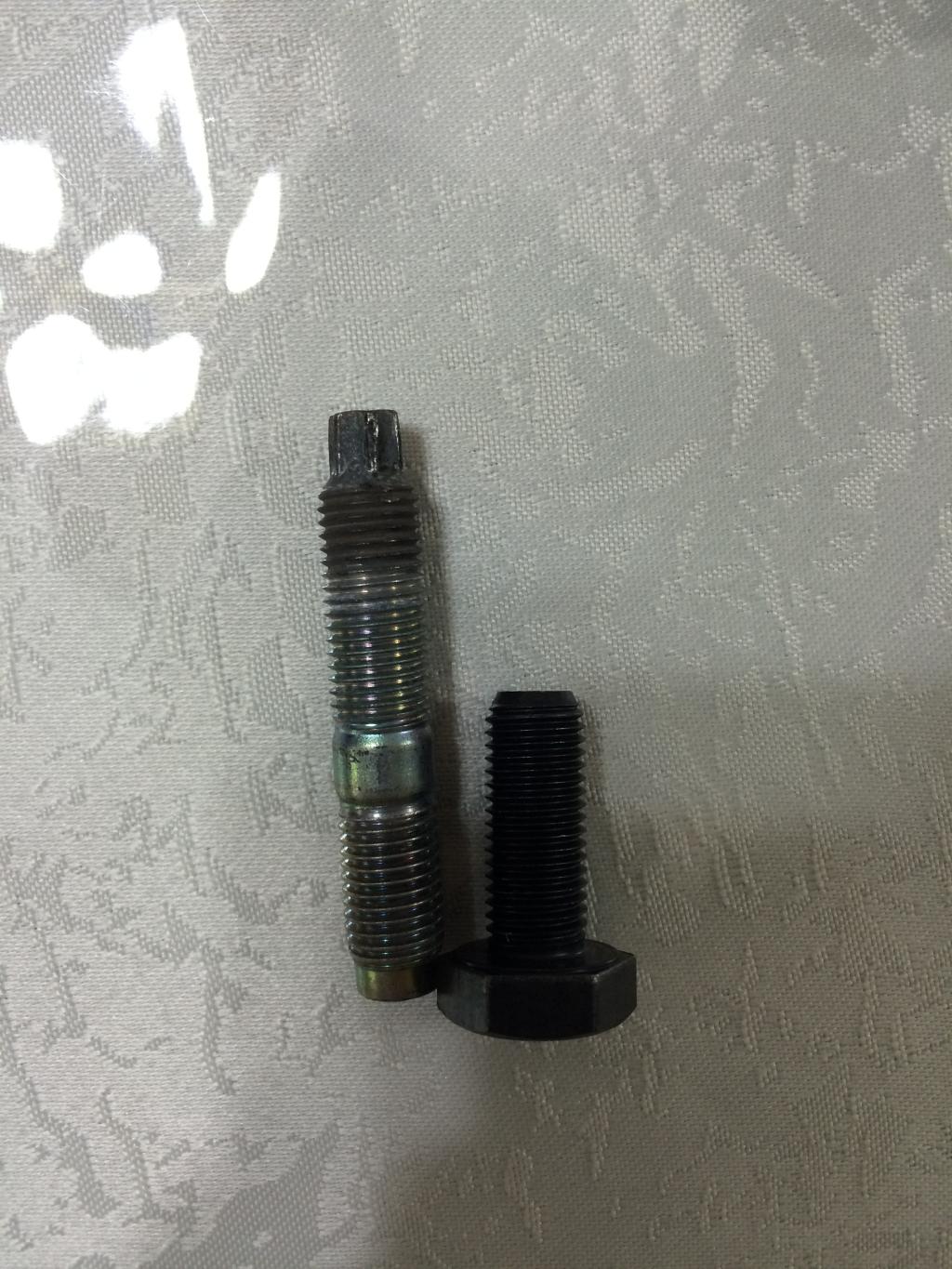

Thanks guys. I totally forgot about the double but. Good idea.
However I don't think it's worth my time cutting them for what it cost to replace them
I ended up buying these locally. Cost me 19 bucks for 15 of them. I'm gonna try them today
