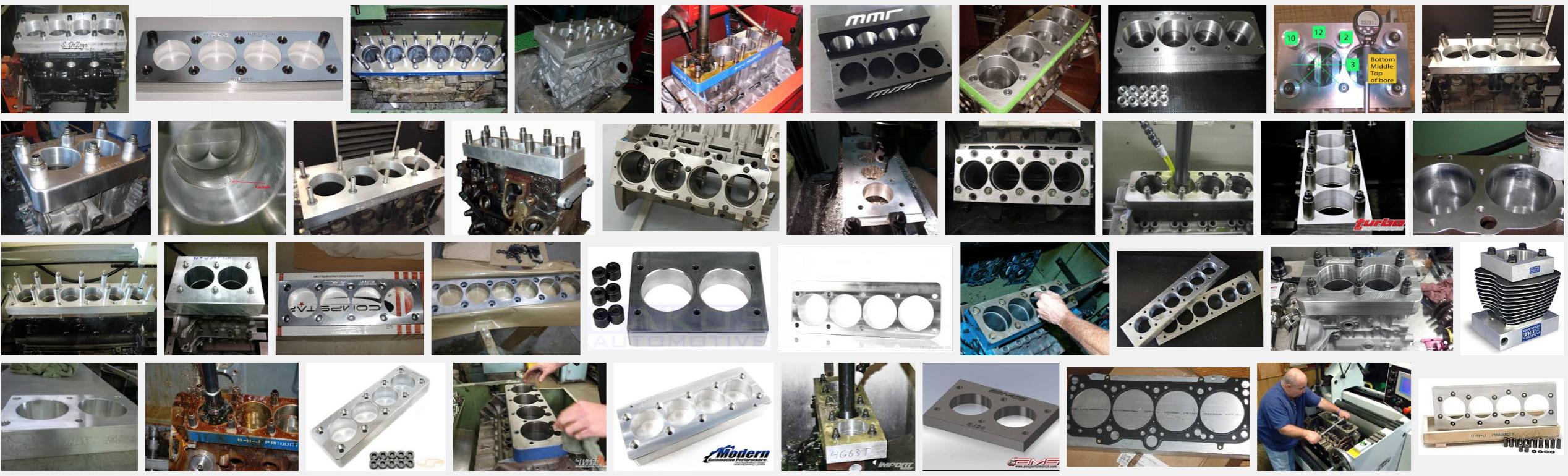

I'd google Torque Plate and learn about them.
Why do you think so many High Performance shops use them?
http://www.superstreetonline.com/how...#__federated=1
Attached Thumbnails Boring A Motor Without A Torque Plate.-screen-shot-2015-02-26-at-6.15.54-pm.jpg

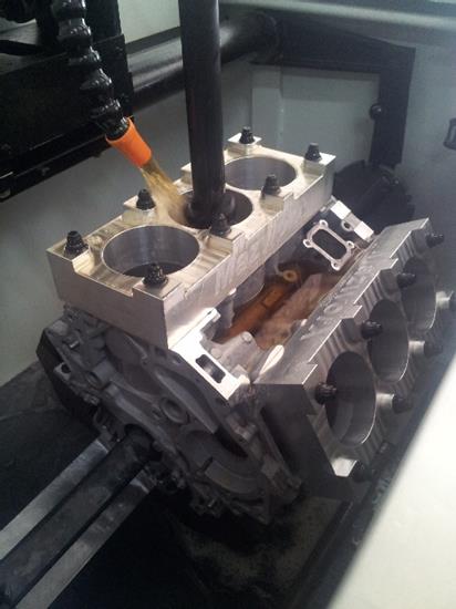

Old Feb 26, 2015 | 10:01 PM
OldManZ350's Avatar
OldManZ350
Posts: 2,429
Likes: 230
I did my best to help you.
Here is a VQ Block with Torque Plates.
