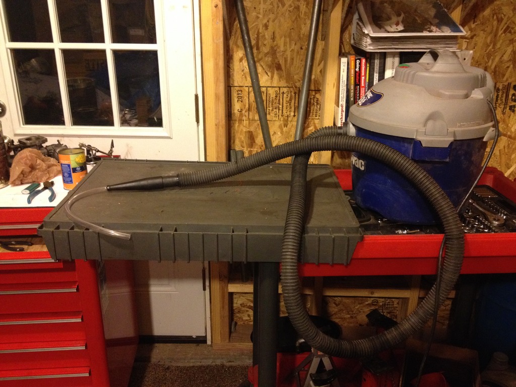

How big is this metal shaving? And assuming that they are (relatively) big they won't get to the oil filter because they wont get past the pickup screen...in which case they will fall out when you drain your oil next round...
Similar to what Cux says, can you get a shop vac and rig-up a small hose that would slide through the spark plug hole and into the cylinder and pull out any debris?
my thought...

Originally Posted by bealljk
my thought...
Exactly
Once I had a washer fall down into an open spark plug hole. Couple of Neodymium magnets from home depot later it was out.
Just be creative. Even your most elaborate ideas will cost less than the price they want
