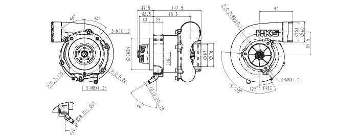

That blower looks very small, any idea of how much air it flows?
Old Aug 22, 2017 | 09:31 PM
DarkZ03's Avatar
DarkZ03
Posts: 2,820
Likes: 552
From: Des Plaines
HKS superchargers aka rotrex are smaller, quieteramd more efficient than any other out there. They are basically an engine driven turbo, they don't need to be big. That unit is good for over 550hp.

My power goal is 500whp. I think I can get close to that with this kit, supporting mods and ethanol. Here is the compressor map for the 8555. I guess I would have preferred the GTM c38-92 kit, but that is no longer available. CFM is 915, but it should still get me close to my goals. It's a track / drift / weekend car and I don't want to push it too far. Honestly the old kit felt fast enough at the track, but since the engine is now built and the old SC broke I thought this was the best way to go.
