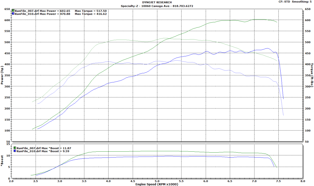

For reference, here is a 370z on Ethanol, 6266 T4 1.15 a/r:
The kit makes power effortlessly, and the tuner said the GTX BB TT kits when ovelayed on this chart are identical. He was very surprised, as he has never see a ST kit do that.
Thanks for that. And if that exact setup was used on a 350z how much less power does the 3.5L make. Is that built that 370?
