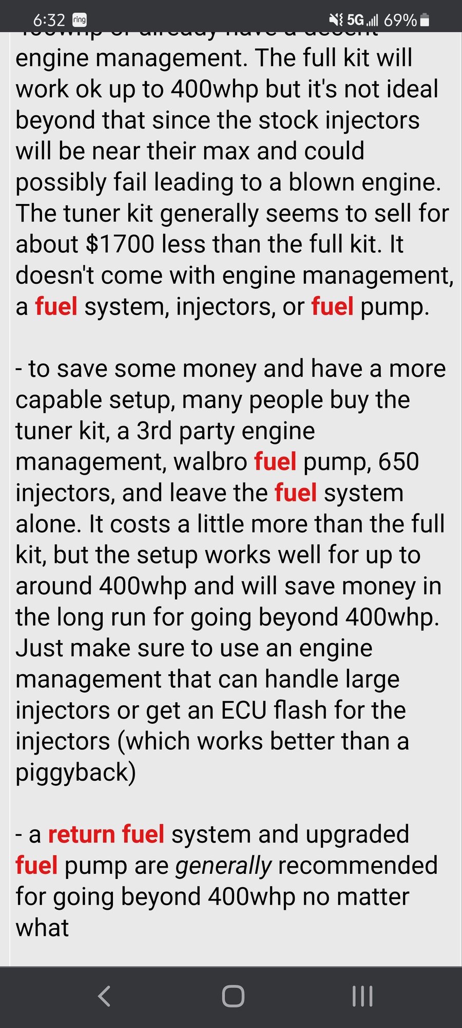

That is the plan regarding pump and injectors but you think a return system is needed? I know HKS doesn't write anything about that.

I was talking to several people and they recommended the return system for that level of power, so I guess it's needed.

Personally I would do 340 lph pump and at least 750 injectors. Remember you want to keep your injector duty cycle <85%.
Exactly, personally I don't trust Z1 on the matter. Most if not all the boosted guy with 500hp capability will run a return system there isn't a real overkill when it comes to fuel. You run lean at the wrong time and engine goes bye bye. Plus superchargers tend to be thirsty little devils.
I'm not arguing with y'all. Last time I did, DarkZ03 handed my *** to me.
Z1 sells their Vortec v3 and HKS kits with a 255 and 1000cc which is interesting. It's been awhile but I know they had 600cc previously for both. I got the 600cc from my old notes I gathered when researching 3 years ago.
They recommend 600 for the 110 and 1000 for the 100 now.
Still, I'm not coming across use of a return fuel system recommended for either. I don't recall the need for this back when I did all my research.

"We recommend using injectors about 20% larger than your HP goals (ex. 500hp use 600cc)."

I know CJ is working on a surge tank, maybe that'll eliminate the need for a return? I'm always going to say go for the max you need for a given kit. The price between buying 600 & 1000 is negligible, same with the pumps. So in my eyes it not even a question get the higher ones even if it is "overkill". It better to have it and not need it, than to need it and not have it. Message Beall and Tim, I'm sure both will confirm the need for a return system, tho they might just say go Vortech lol.
