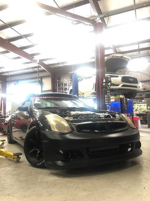

Heres the dyno with one of the last dyno pulls on the low boost pulley with the restrictor and a stock motor, and the new one with built motor, no restrictor, and the higher boost pulley.

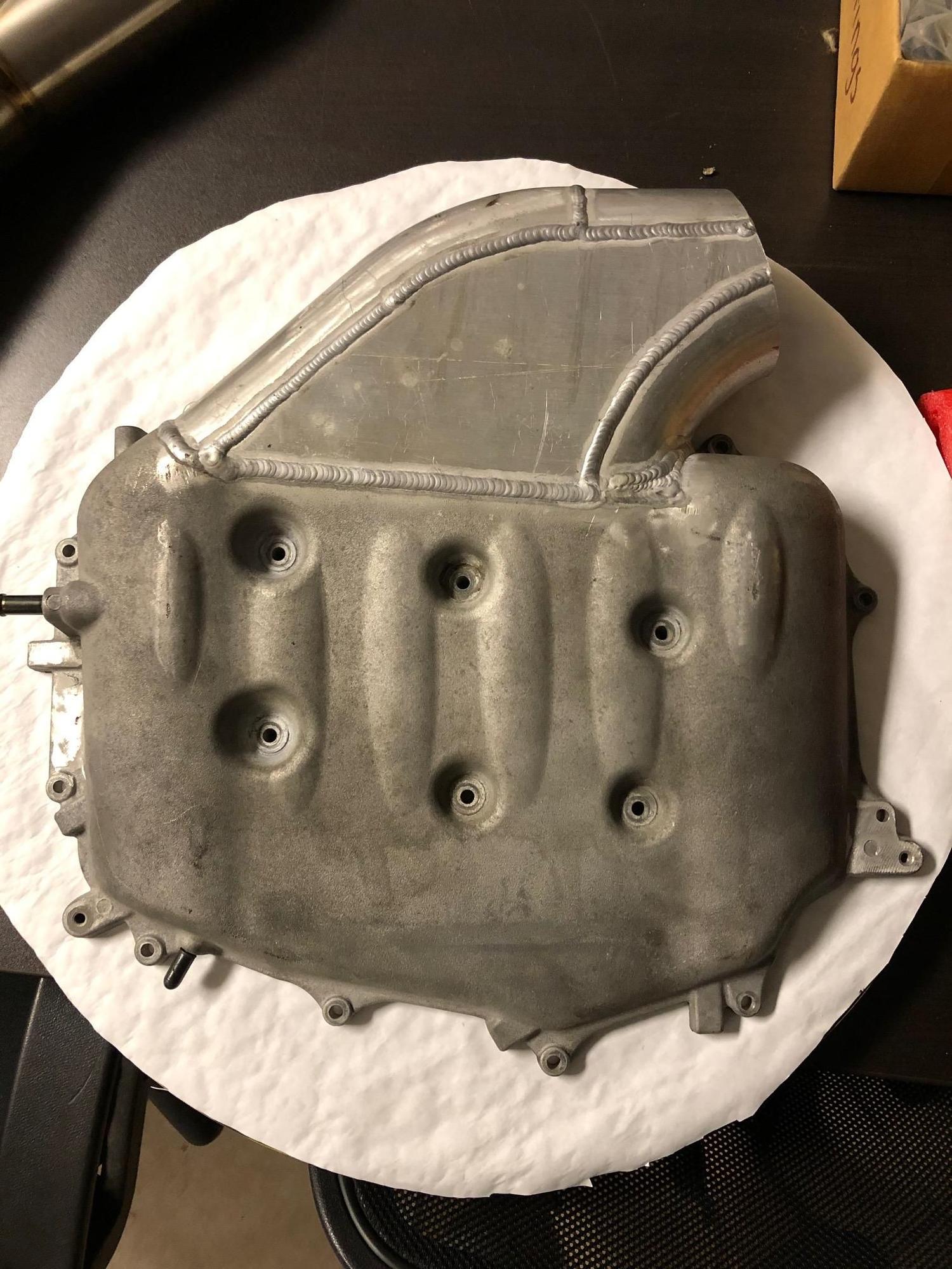

I dont think it is so much an issue with the throttle, as it is with the upper intake plenum. Others have tested it pretty thoroughly and found that to be a pretty sizeable bottle neck. If you take it off and look in behind the throttle body you can see it has a pretty sharp over 90 degree bend that also kinks down a fair bit. I've got a spare upper that I've got nearly finished up, I just need to find a decent Bosch or Hitachi throttle in the size I want, make an adapter harness, and finish welding up the plenum
that’ll take care of 1 nasty bend.
WTF? Is that an intake topped pizza?
