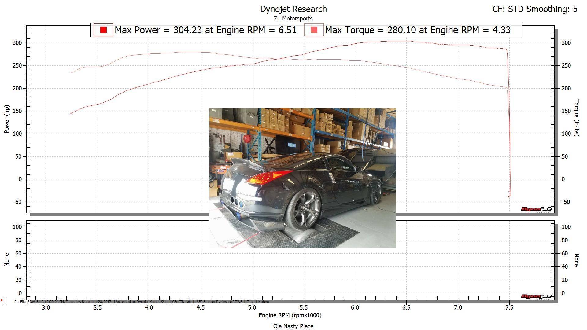

Yes, with the blower and my kinetix intake :-)
That was made with 13* of timing up top and a little bit of belt slip. So I have the potential to make a decent amount more power.
Originally Posted by bealljk
I agree with you Conway. And there are many variables to consider
(maybe you know where I'm going with this) Was your 540hp and 457tq with your supercharge … and … your kinetix intake? (see where I'm going with this?)
OMZ has brass ********* with the power, torque, and timing he was running on his car! But he too was suffering from parastatic losses of a supercharger(I speculate).
I will concede that the Kinetix makes more horsepower on the top end but due to its inefficient design(as previously discussed) it is costing your peak torque where max airflow isnt occuring and the engine relys on an efficient intake runner design to optimize torque.
If you have a little extra time on the dyno after your tune is complete you should swap the OEM intake back on and do a few pulls to see how it does as a near/direct comparison.
Yea 13 degrees seems soft ... you'll get it cleaned up! Excited to see how things play out after the break-in period.

Don't forget I already did that N/A. The kinetix actually made a bigger difference in the mid range torque than it did in the up top HP.
I don't have the plenum spacer anymore so the test wouldn't be worth it. We all know the stock plenum with out a spacer is dookie.

I am not a fan of the Kinetix - I have minimal engine/intake runner design experience but what I have learned early-on and of the basic principles is that the kinetixs breaks most those rules.
I don't believe they are better than stock (don't take that personally - I think the world of you and Conway). Especially when it comes to torque - your peak torque is where the engine is operating at it's highest efficiency (right? agree? disagree?) which means optimal volumetric efficiency? And you get there by filling the cylinder with the most air & fuel? Which is done with the ram-effect of airflow down a intake runner?
I'll go out on a limb here and say that the supercharger is further hiding and covering up the inefficiencies of the kinetixs intake.
Don't forget I already did that N/A. The kinetix actually made a bigger difference in the mid range torque than it did in the up top HP. I don't have the plenum spacer anymore so the test wouldn't be worth it. We all know the stock plenum with out a spacer is dookie.
You did it NA but you are supercharged now - two different ball games. Its hard for me to conceptualize why your torque is so low compared to your hp.

Up top it was marginal but down low it was substantial.
Here is the test I ran
https://my350z.com/forum/intake-exha...omparsion.html
Old Apr 16, 2020 | 08:21 AM
To this day I still can't explain the torque reading. I'm wondering if the speed at the bottom is wrong and that is causing the low torque rating. I'll have to go back and see if he has any sheets of the bottom axis being MPH and not RPM.
