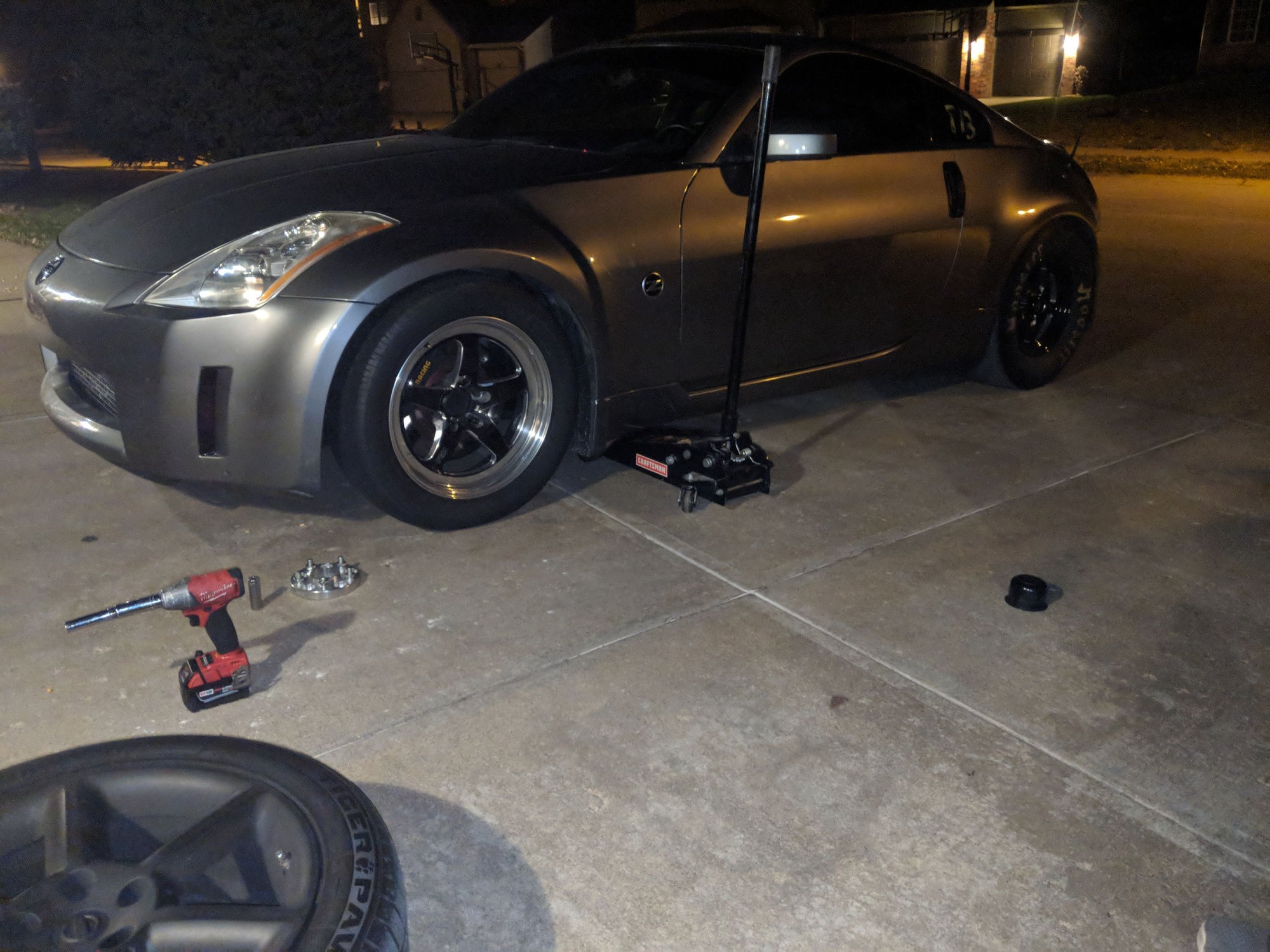

I ended up going with oldmans setup , i baught some jegs 15×4 with 1.75 bs and got 1/4 in spacers and i got 27x4.5 hoosier bias plys to match the rear.*
I didnt want to buy 15s either because i plan to do akebonos next season for the front but i needed somethin now so i went with cheapest option. When i do the brakes ill do a better wheel setup all around. I just dont know what i'll need to clear those calipers , I don't see anyone running skinnies over akebonos.*

By the way I didn't need to run the spacers for the skinnies they cleared just fine.

Rears:
Wheels are cheapies from Jegs 15x8 with 5.5bs
Tires are Hoosier QTP's 28x11.5
Fronts:
Wheels are Jegs 15x4 with 1.75bs
Tires are hoosier bias plys 27×4.5
This is over small base model brakes. Also get no rubbing!
