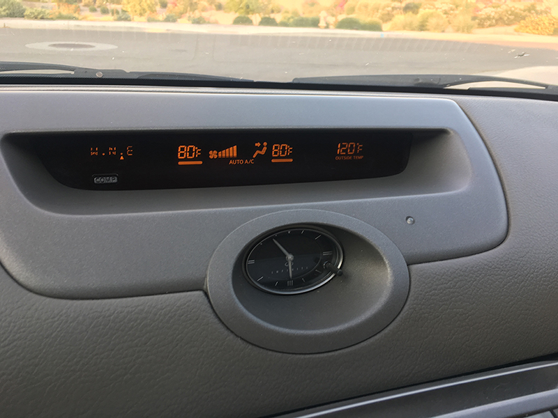

Wasn't at the track but the last couple days in Arizona have averaged just over 115, my car hasn't skipped a beat though.
Cooling system consists of a Mishimoto radiator, stock radiator fans, and Evans water-less coolant.
The rest of the setup includes a built motor (block was previously machined for HR head gaskets but running HKS gaskets), PowerLab single GT35R, CJM return fuel system, E54 for fuel, etc.

So hard, My car never has an issue on the road. Just like that. Oil is around 100-105C and coolant around 200F max. On track is a different ball game!
