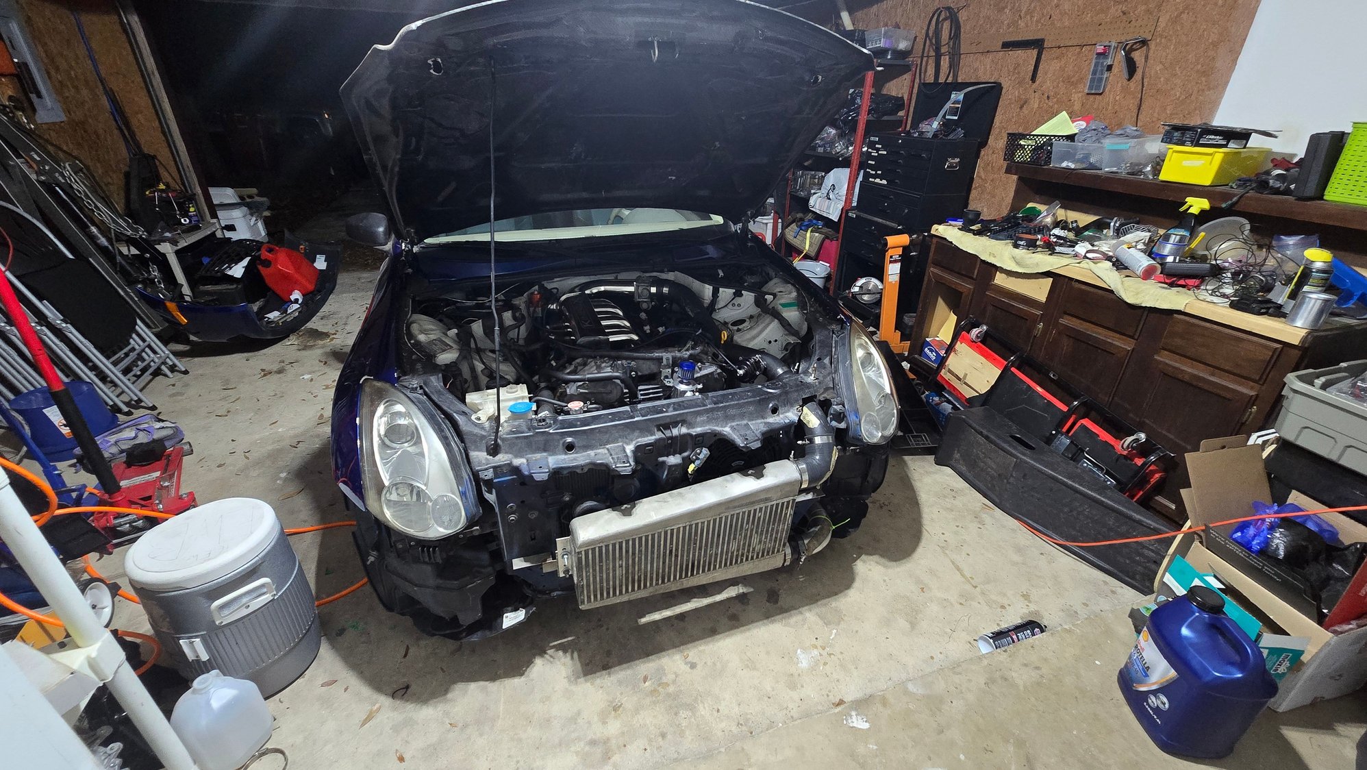

This is where the boost leak was. Since I had to raise the FMIC up about 2" the piping doesn't quite align all the way up anymore.
OMG the garage is complete mess...
Once the car is running fully I'll put the bumper back on, until then it stays off to check things over.
Quick Video me and the oldest made. We had to do a log for Admin and record the widebands. The top number is Pre Turbo and bottom number is Post Turbo.
This is 3rd gear from roughly 3k to 5.5K at maybe 1/4 throttle. I was trying to stay around 5psi. That was way harder than I expected, the beeping was the boost controller telling me I hit/exceeded my 5psi limit.
You can hear the wastegate starting to flutter, I think I have a 7psi spring in the gate.

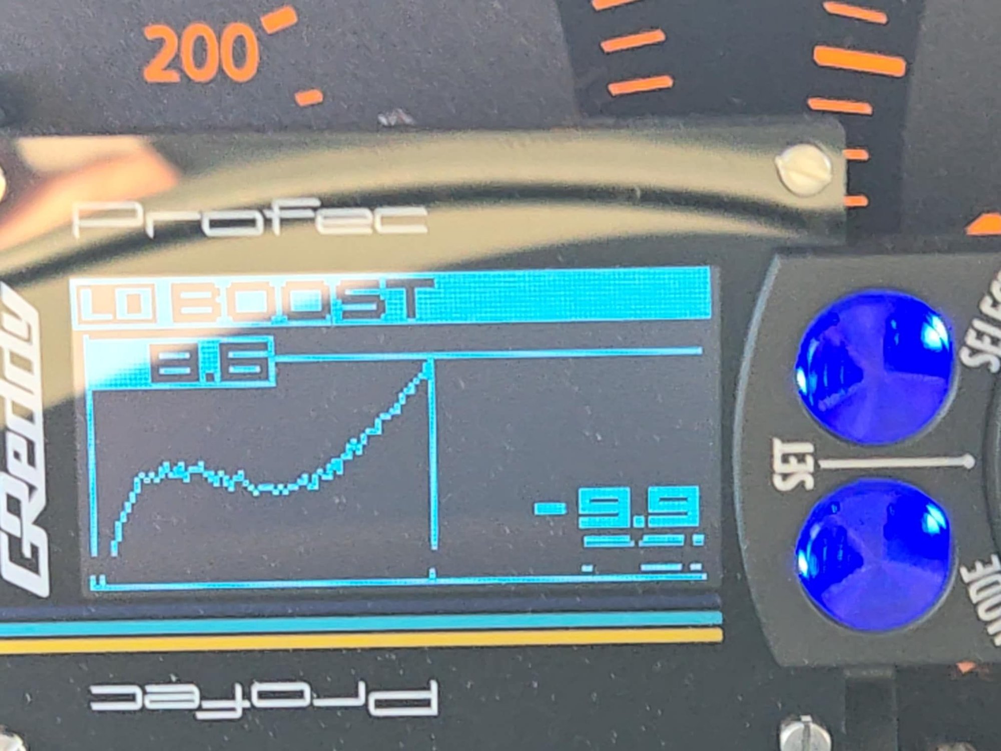

Did some testing last weekend to try to fine tune my boost before getting back on the dyno. What i figured out is with 0% Gain and 0% duty cycle my baby 38mm wastegate with its 4psi spring will hold 6-6.5psi from 3K - 6k after that it climbs steadily until i shift at 7K roughly hitting 8.6-9psi. . I went to my high boost map and set my gain to -20% and I can see the boost fall off once it hits 8psi around 4k rpms but once it hits 6K it takes off again. I have a limiter set at 11psi but that doesn't help at all.
This was the low boost pull.
So, I ordered a second wastegate and hopefully will get it installed this week or early next week. Then we'll test and see if that resolves my boost issue and I can have a true low and high boost map that I can rev out past 6K with out fear.

Had the new wastgate installed and changed from Open to Recirc. OMG it's so much better when hitting boost!
I had to change some wastegate springs around. The 4psi spring I had in there was like 3 psi. Put in my 7psi spring and its opening up around 6psi.
I've play a TON with the boost controller and have Low boost set at 6psi climbing up to 8psi. High boost is set at 10psi climbing to 12 psi.
I need to get under the car I feel like I have either a slight boost leak or a exhaust leak. I feel like the BOV isn't making the same Woosh it was with the other WG. I think I have an exhaust leak due to passing a car and hearing some odd noises from under the car.
I've also noticed my AFR's are richer than what they were before the wastegate change.
More to come once I can get the car to a lift and actually get under it and check the exhaust and intercooler piping. The quick jack is amazing but not so much when you have a messed up shoulder.
Nice. All good news. I used to struggle with the header to flange joint. Also I have always felt recirc sounds better
