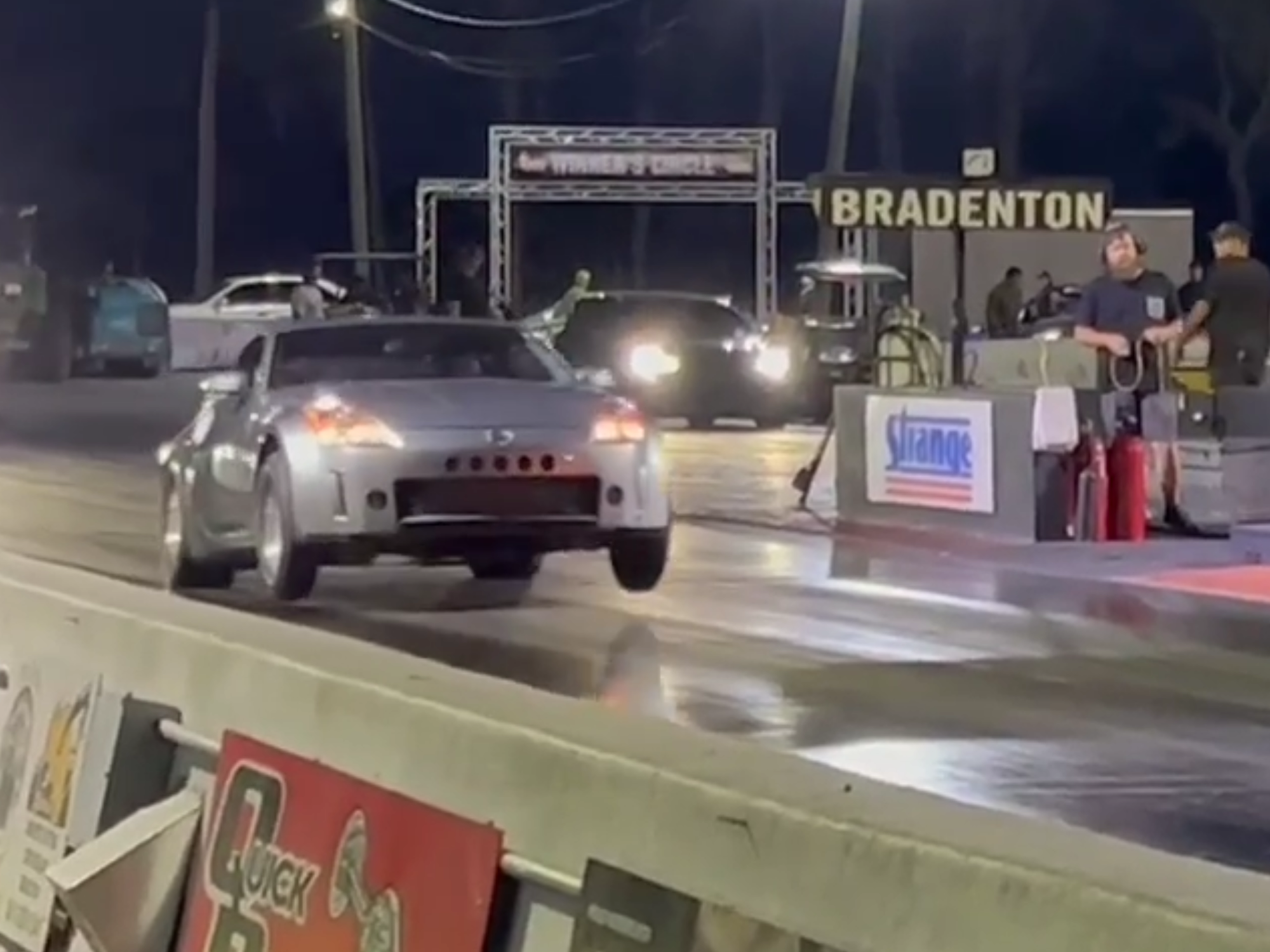

This is how you Launch...... 1.42 60 Ft
I wish!
