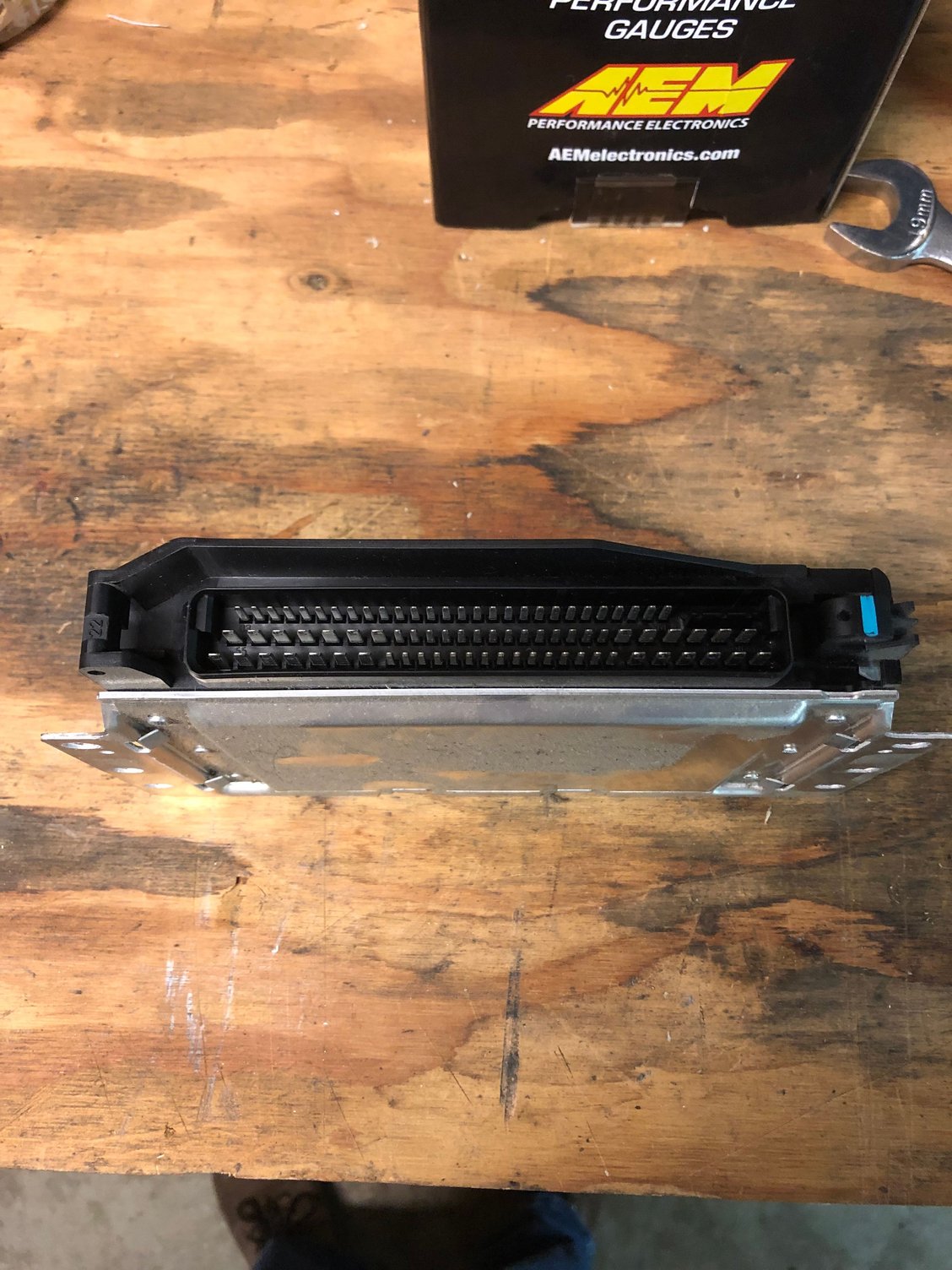

Originally Posted by 0taku
You can use it, I am and I know another person with a revup running one as well. I’m running a very aggressive setup as well so uprev isn’t an option. (Mostly sick of the client crashing)
Good to know. So my ecu plug is compatible? I sent this picture to the tuner about a year ago and was told it wouldn't work. Maybe something changed or he didn't really know?

Originally Posted by THIRZTY
I have a Revup and don't believe I can use the Link G4+ ecu... a tuner I was talking to wanted me to go that route and he checked into it.
I believe you can as well but be very very careful which ECU you use as I believe you are in california? And I highly doubt a standalone will pass smog/emissions testing there.
I live in a smog exempt county, so no yearly checks. Only triggers would be sale of vehicle or citation by the commies sending the vehicle for ref inspection.
