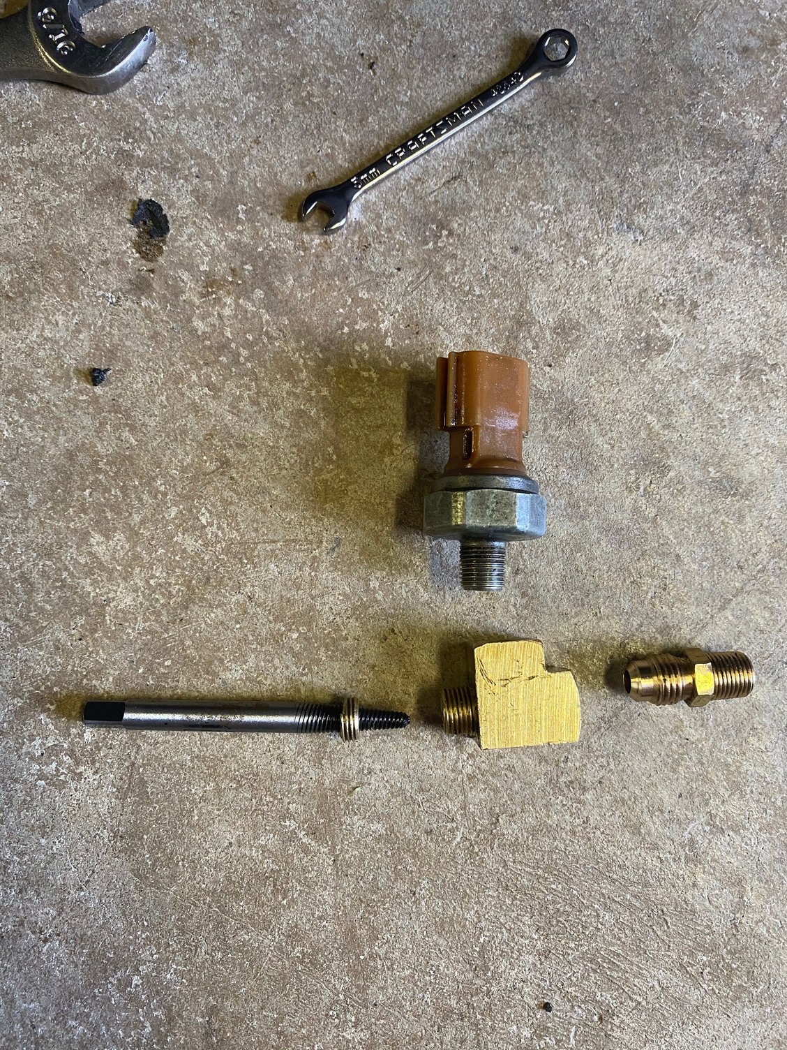

So I went out to flash a new tune and run the car again last night. Noticed an oil leak... investigate it further and the brass tee for the oil feed/sensor cracked and basically broke off when I touched it. I was super cautious when I installed this, started loose and tightened it in small increments until each fitting stopped leaking. It's been fine for weeks and all of the sudden this... wtf? Fortunately I caught this before going out and running the car hard... that could have been all bad! Anyways, going to get a replacement today hopefully so I can keep logging runs. But is there a better way to tap for an oil feed and oil sensor than this?
If the port is BSPT and you're using an NPT adapter, this can be the result.
HTH
HTH
I don't think it has different threads. That tee fitting came from Vortech... the best I can tell, it was the same thread as the oil pressure sensor and 1/8 npt.
I didn't like that tee when I installed it and was skeptical of it. I searched around and found where others were getting their oil feed from the port above the oil filter. So I cut/drilled/tapped out my oil temp sensor to get oil from there. But I didn't know the car would back timing way off without it so now I've got to relocate my oil temp sensor somewhere... Does anyone know what the thread pitch is on the oil temp sensor? I had to order one and uh ruined mine already.

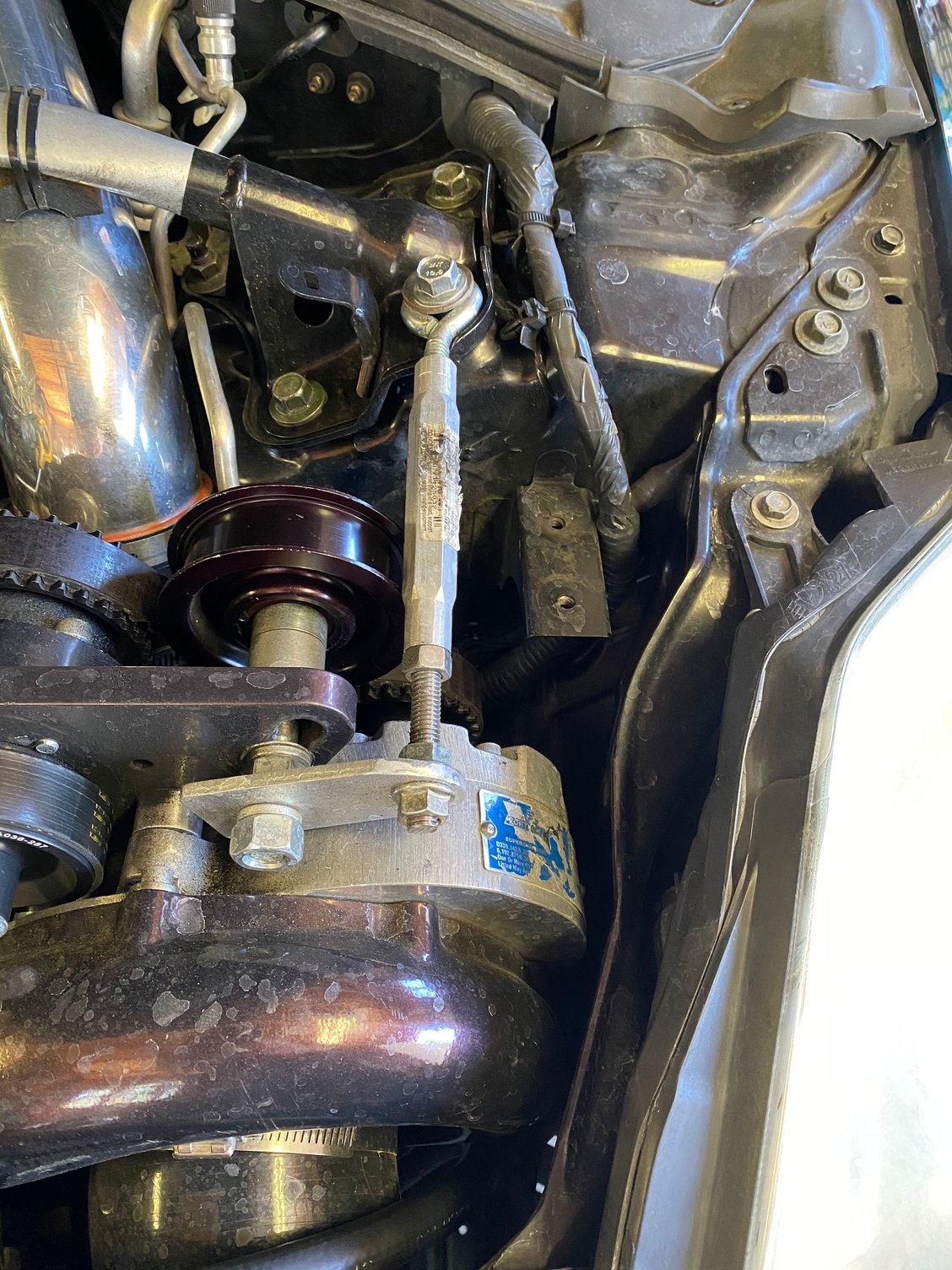

I removed my 'Nim-rod' setup and installed a 'Tim-Rod'. Very nice setup and my hood closes properly now! lol
Few days ago my tuner was done with fueling adjustments and we had started on timing. Car had been running great and then during one of my runs the car fell on it's face and I was confused about what was wrong for a min. After some messing around I figured out the car all of the sudden was running lean. Loaded a fat tune back on the car and babied it home. Checking codes and the logs showed bank 1 was lean. Checked for some obvious stuff and determined the issue must be with the injectors. I had just had the oil BS so I was suspicious about oil in the connections creating an issue and I was right it seems. I disassembled the fuel injector connections and cleaned them. I also found a few bare wires and one connector with both wires exposed right next to each other. I repaired everything best I could and ran the car again, all good... wheew. James is sending me another fuel injector harness I'm going to cut and install the injector dynamics connections onto and eliminate my adapter harnesses'. Hopefully that cleans things up for good. Also posed for a couple photos during one of my 'drives'.

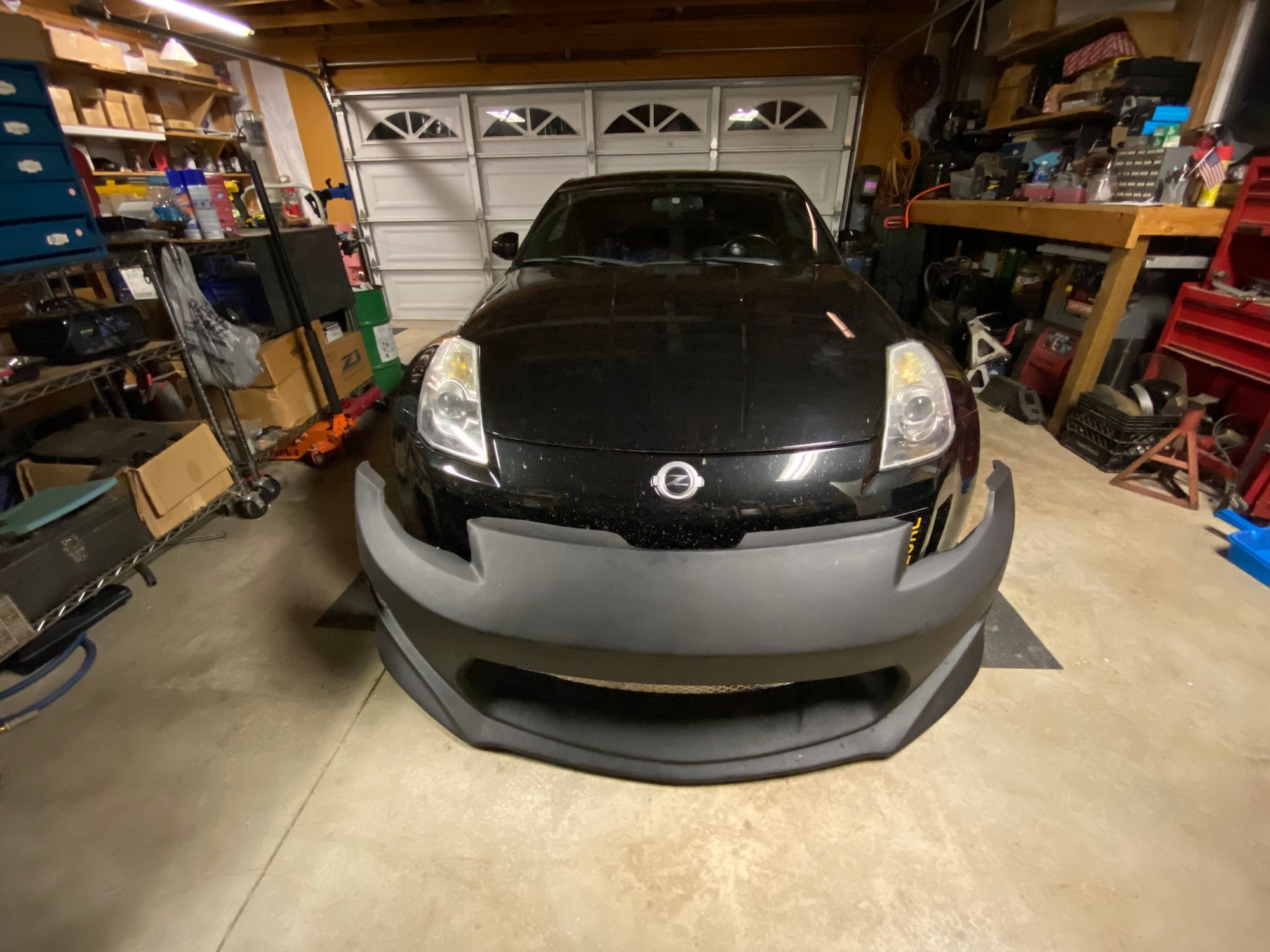

Picked up a new/never installed bumper cover. It's not exactly what I want.. but it'll work for now.

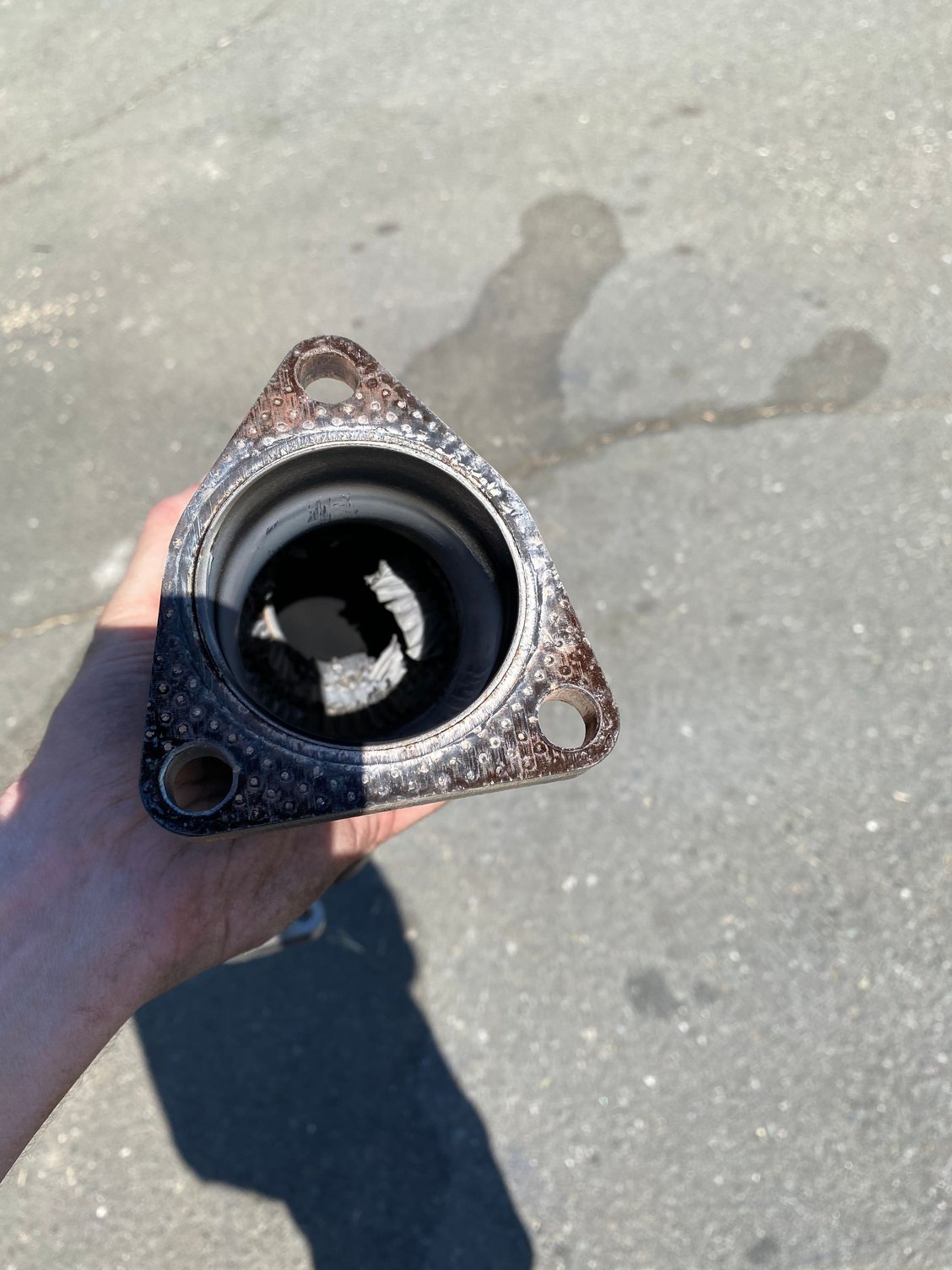

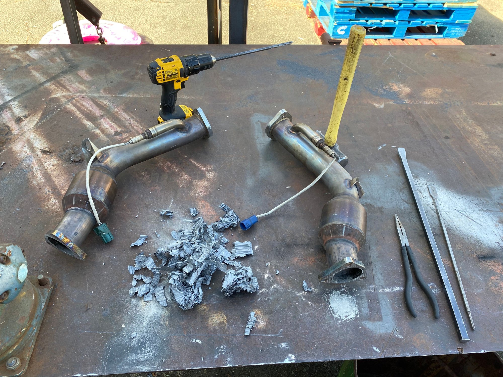

Weeks and weeks later... after chasing my tail with this car, I finally figured out what in the hell was going on. One plugged cat and one already burnt out. These were Z1 HFC's I had put on when I got the car running after the engine build. I put about 25k mi (n/a) on them and I never expected them to be the cause of my problems. I punched em out all the way, re-installed and drove the car to confirm. Ordered test pipes to replace them so I don't have to deal with this again. I have a Tanabe exhaust system with the big muffler so rasp shouldn't be an issue.
