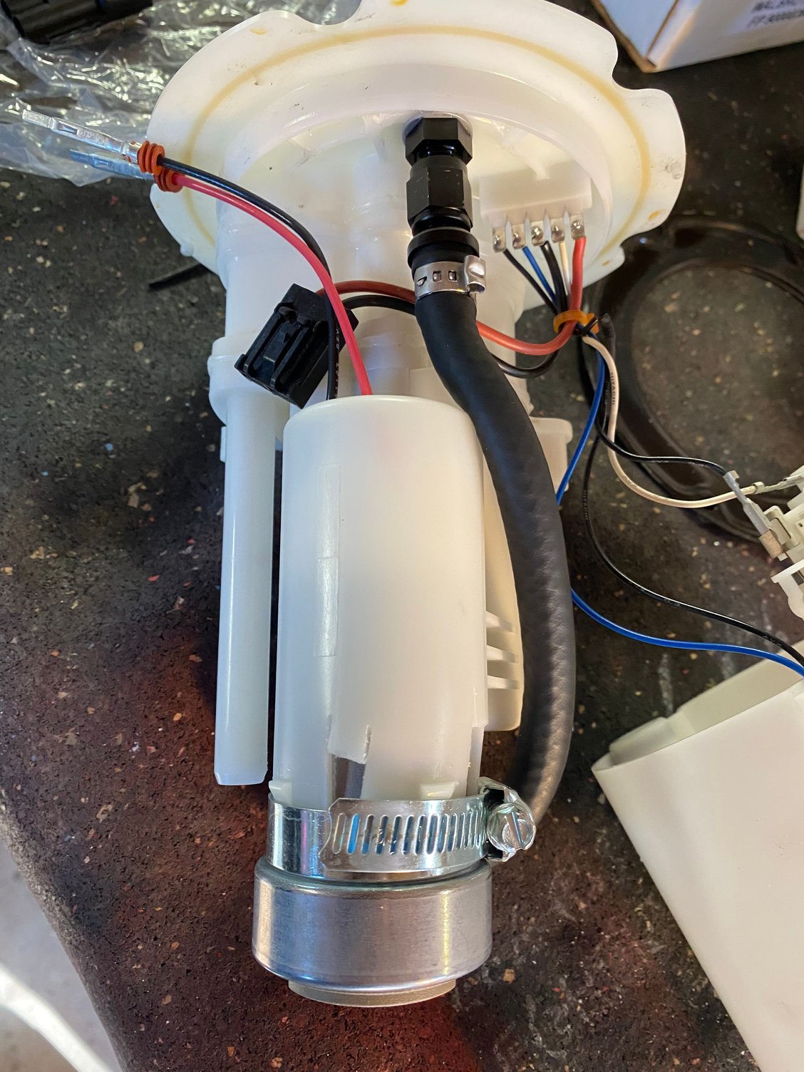

I've already had the basket apart myself installing the 340 pump and return setup... but yeah it seemed pretty fragile. The 450 and 525 look the same externally... looks like they're secured with a hose clamp because of the larger base?

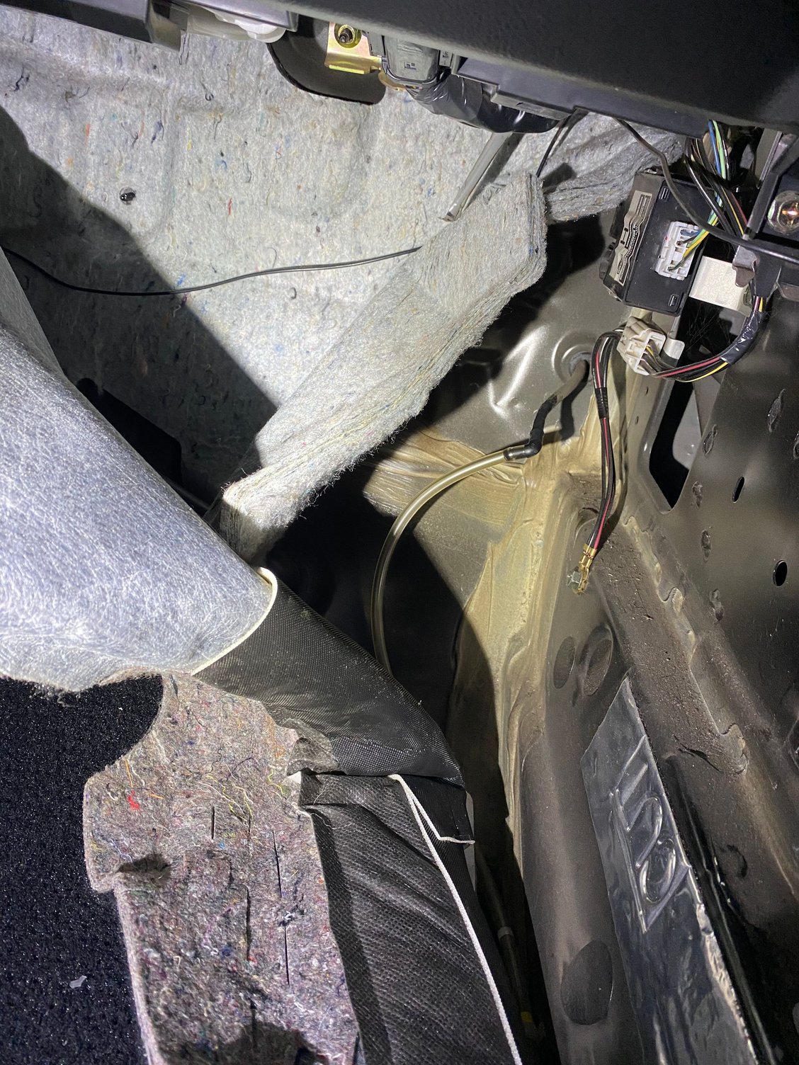

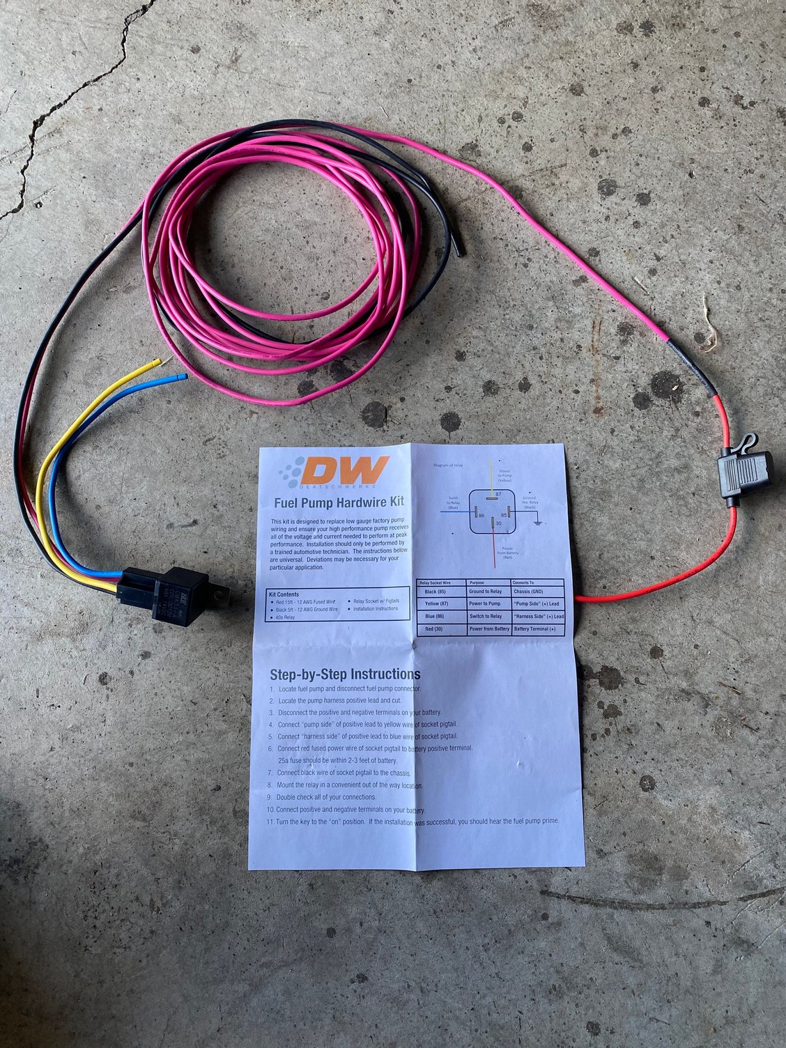

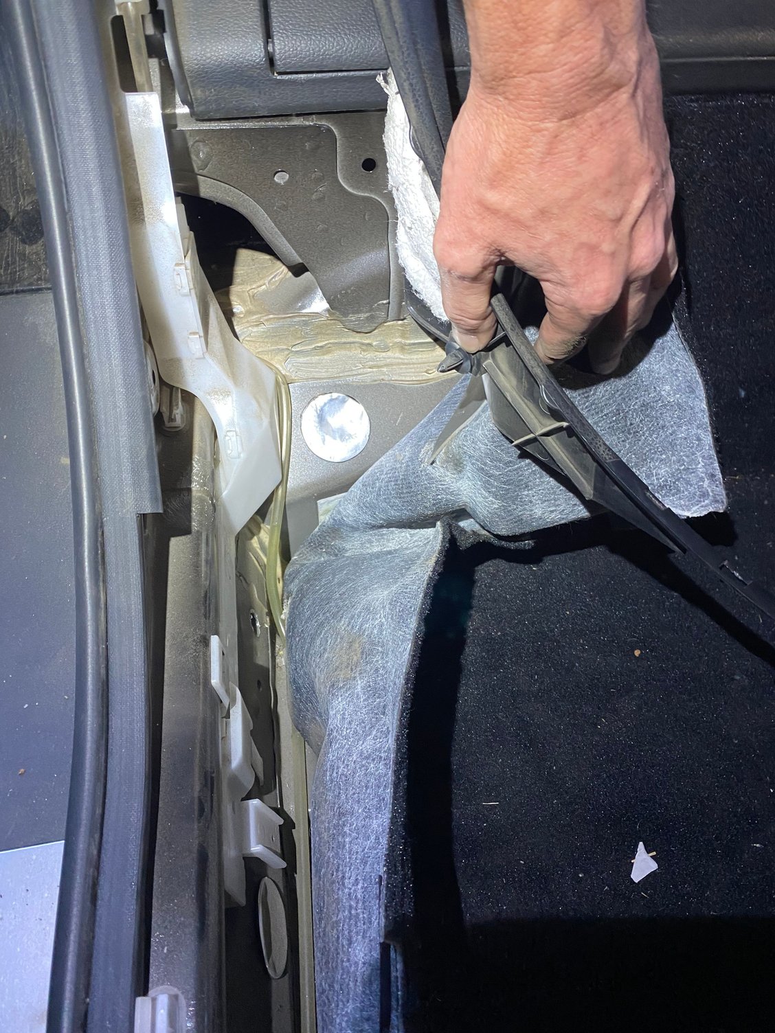

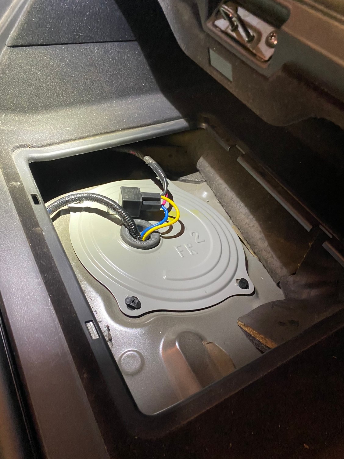

So I found a Walbro 525 new from a seller on ebay. Ordered the wiring from CJM. I started the wiring install last night and finished with installing the fuel pump this morning. I tried to get pics of everything... hope I did this right. Fitting that Walbro in there was kinda tedious but it's done. Took it for a test drive and the old tune was fawked... We just revised the tune and I just did another test drive and it's way better. wheew. I'm gonna need some new tires soon... is my car supposed to spin the tires in 3rd at 50mph+??? lmao

iffffffffff it was me ... I would locate your relay outside and multiple layers away from your fuel tank ... mine is located up near the passenger side seatbelt top-bolt ... I dont know much but I know that gas fumes and high voltages/high amperage relays dont mix ... well.
But otherwise looks good!
