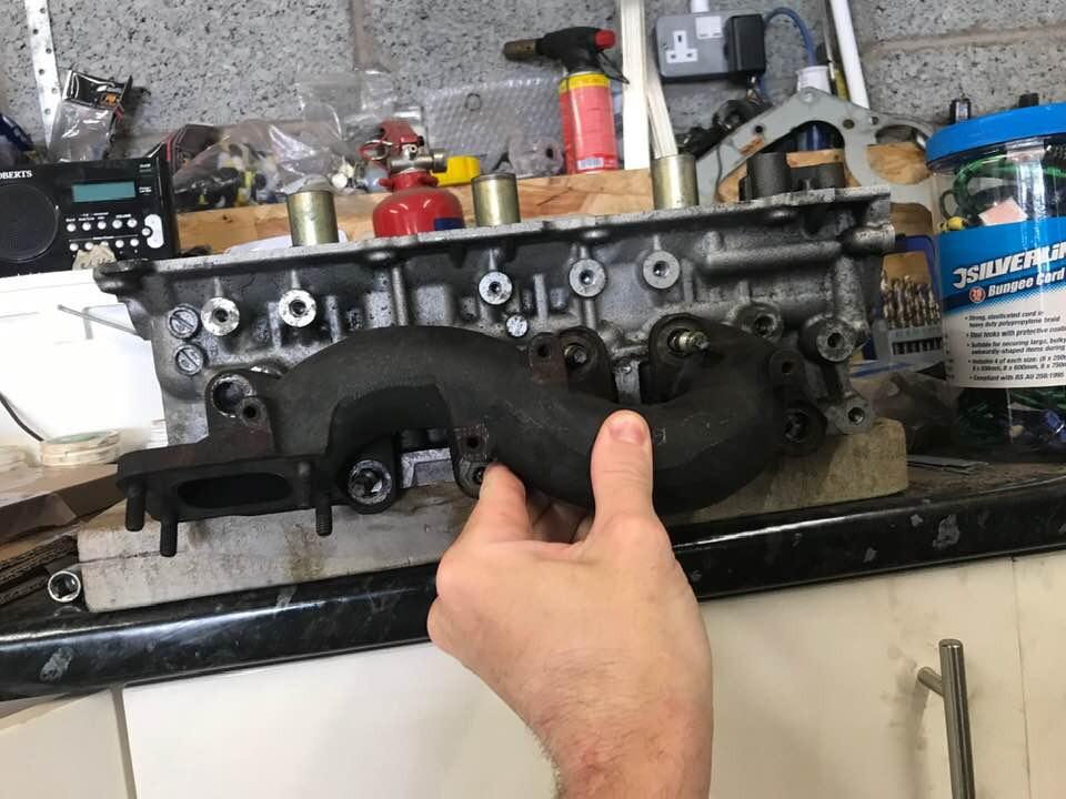

I've tried searching and all I could find was one small thread about a guy that got as far as mounting the manifolds and turbos onto the engine.

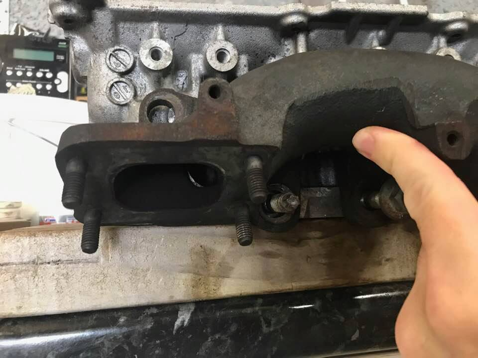

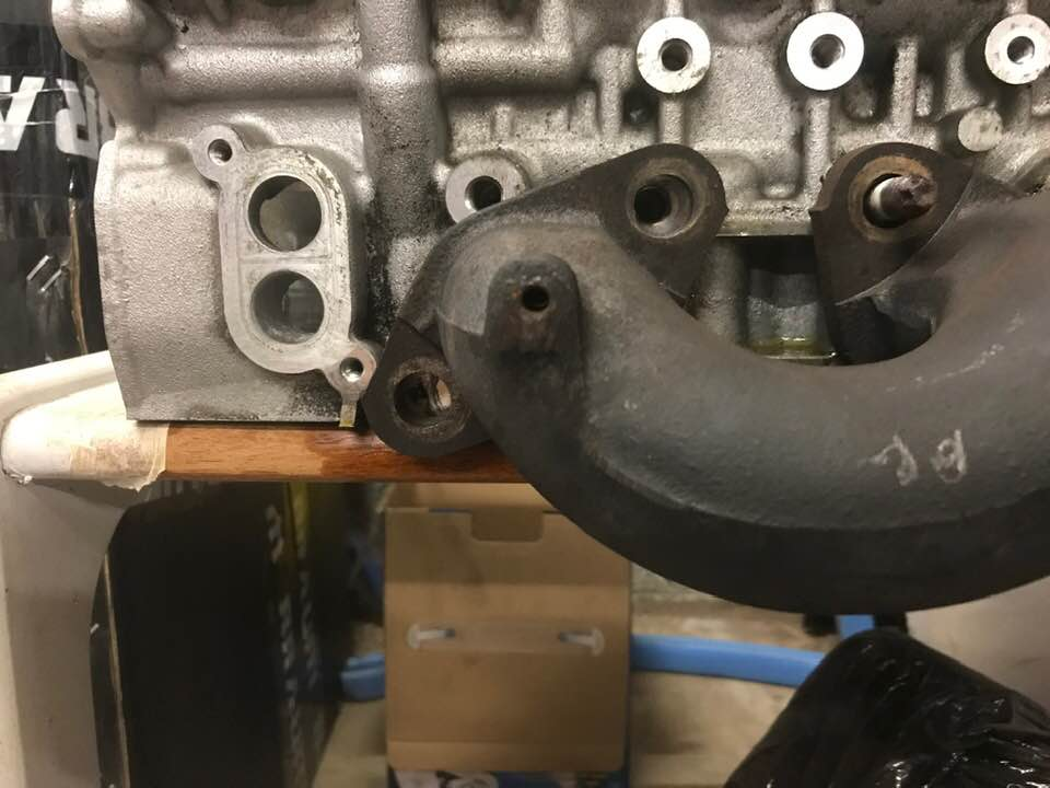

So for £70 I bought some 300zx twin turbo manifolds VG30dett, they share the same port sizes and spacing as VQ35de exhaust gaskets, the VQ heads can have the exhaust studs in two different layouts so can match the VG manifolds.
The only issue is one stud front and back don't line up and the manifolds will require the holes elongated to fit most likely with a cap head bolt rather than a stud and nut.

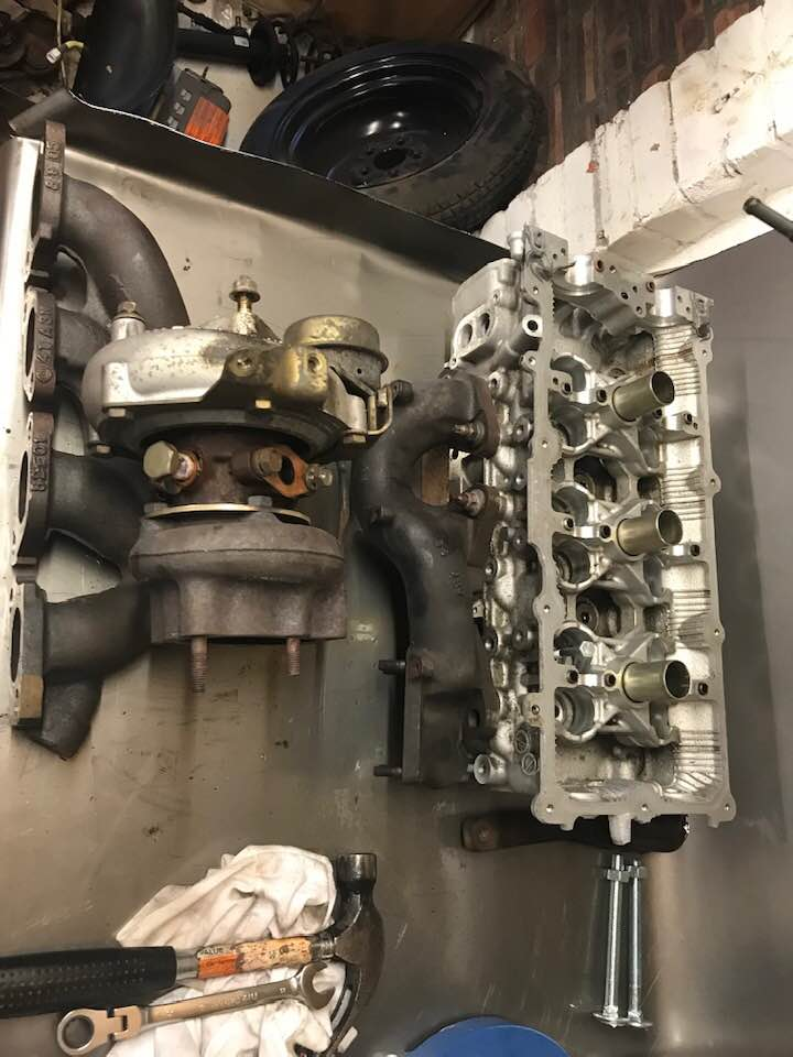

Just some pictures, not done any work yet, might not get round to doing it ever as I have lots of things I should be doing with my Z and SX but if someone wants to take note and have a play also then hope this helps.

Old Aug 15, 2019 | 11:43 AM
evilscorp's Avatar
evilscorp
Joined: Jun 2012
Posts: 75
From: Scotland
The t28 s14 garrett turbos should fit (well one side so far) Just might need to shave some spots off the compressor housing depending on rotation (should be fine if the outlet is facing down) and the exhaust housing slightly touches the gearbox mounting point, not sure if gaskets on the turbo will space it out enough or if it will need a couple of mm shaved off the block gearbox mounting point(you can see the shiny part it was touching).
Unfortunately as i was doing it myself and have removed the head studs i had to hold the turbo+manifold+cylinder head on the block so not ideal for getting measurements or fouling points.
Bottom right part was the issue, standard engine mounts wont work either (probably).
dirty turbo, I want a new seal but can't find them on their own yet.
used a brass wire wheel on the outer area to clean up the oxidation,
