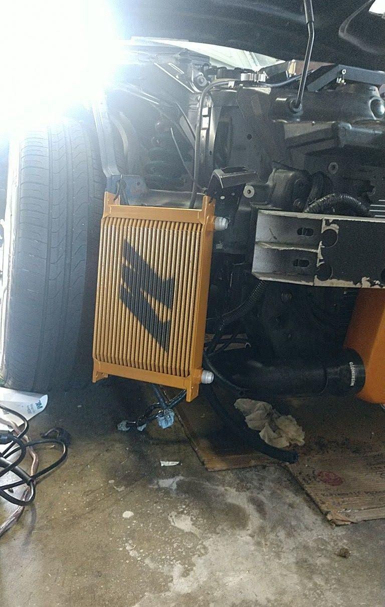

Found a mounting spot for the oil cooler. Thanks for the help James. Sitting right behind the fog light vent.
Mounted with brackets. Checking for clearance.

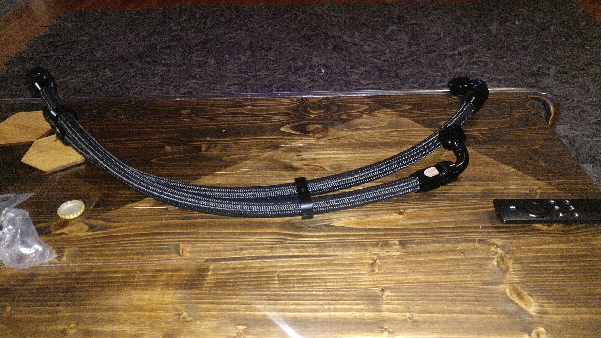

Decided to upgrade the PS cooler while I was mounting the intercooler.
PS cooler lines.

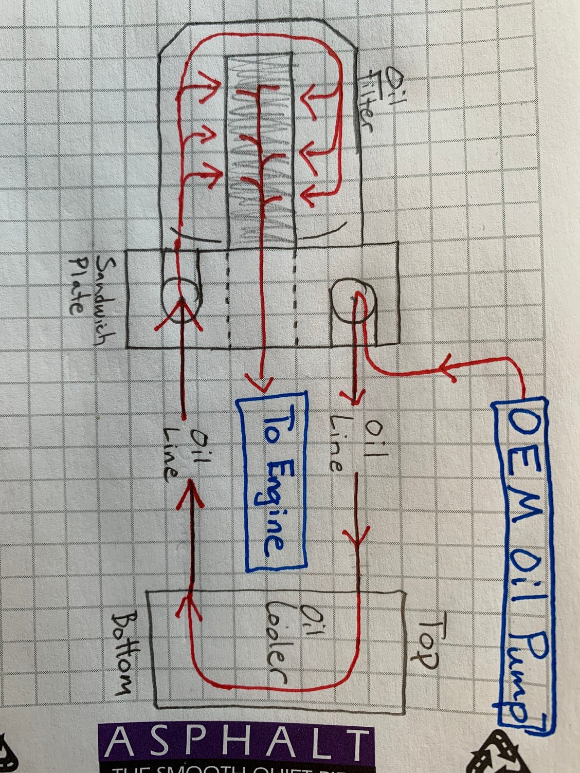

Need some quick help here please if anyone can...
I made some AN lines last night for the oil cooler.
This is what my sandwich plate looks like.
Can someone tell me which port should go to the port on the top of the cooler. Keep in mind I am mounting it vertically. (see pic above)

Double check me but this is how I believe it should be routed -

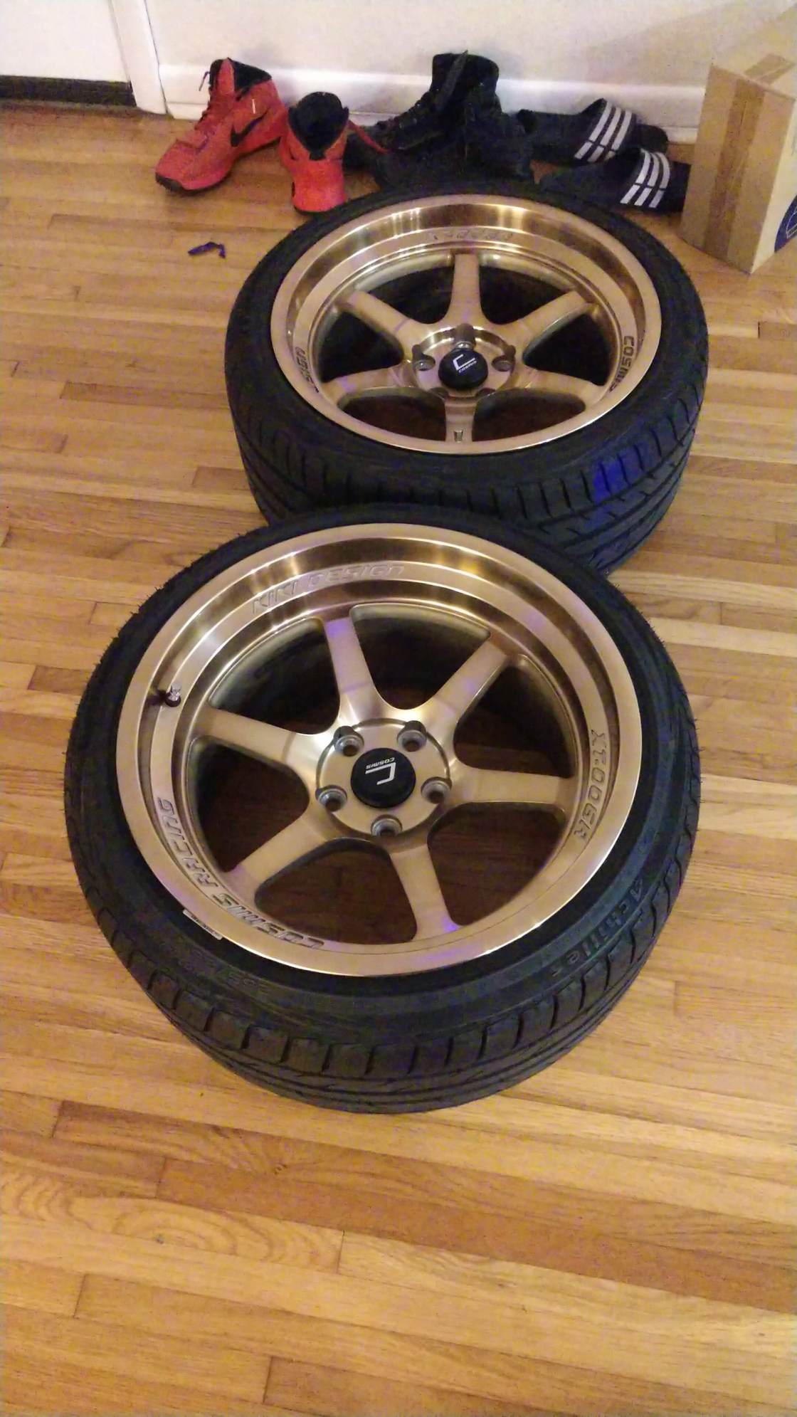

Got a SICK deal on some rims that are perfect fitment. Had to drive a bit to go get em but well worth it.

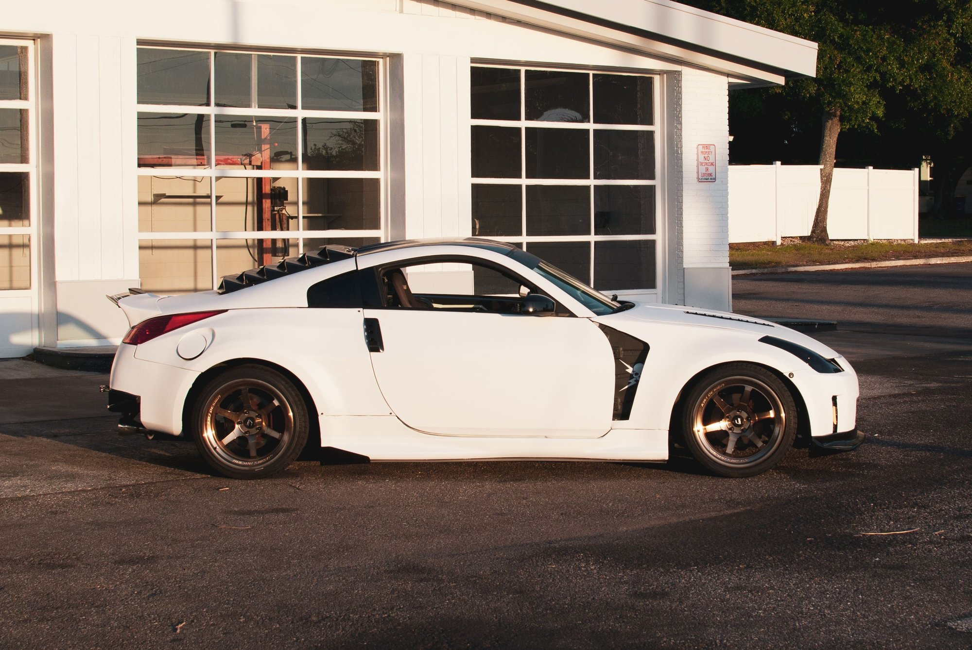

Haven't posted in a while. But the car is up and running and pretty buttoned up. Have a look...
