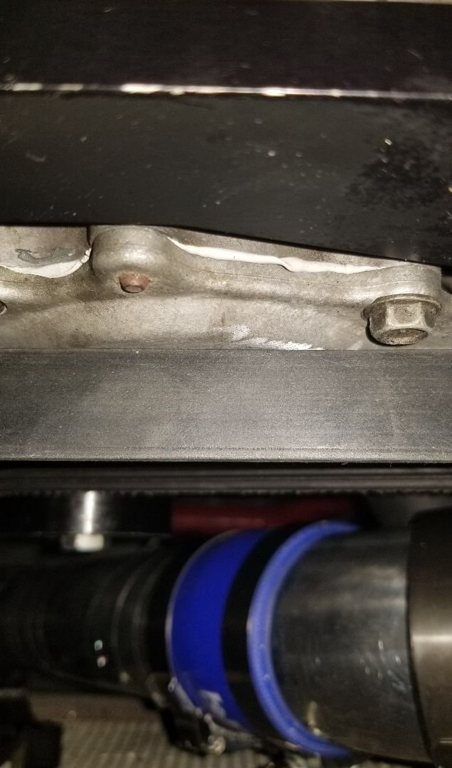

I'm concerned with how close the belt is to the cam cover.
Whats a better solve? Moving the jackshaft our a hair with a spacer? Filing down the cam cover? Or spacing the whole SC bracket out with a few washers? Any advice?

If these are the same distances then just file down the cover a little. K.I.S.S.

I think Conway had this issue too … I think he ground-down the cover a bit.

I had to ground down my cover a bit and it still hits a little bit. I haven't have any problems yet but I need trim some more but as far as i know that's all you can do. Once i get home in a few days ill take a pic of mine or hell i may have sent one to Bealljk for guidance that he may still have.
