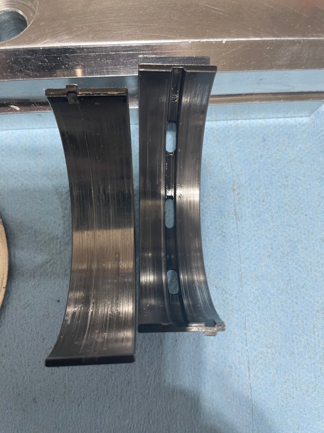

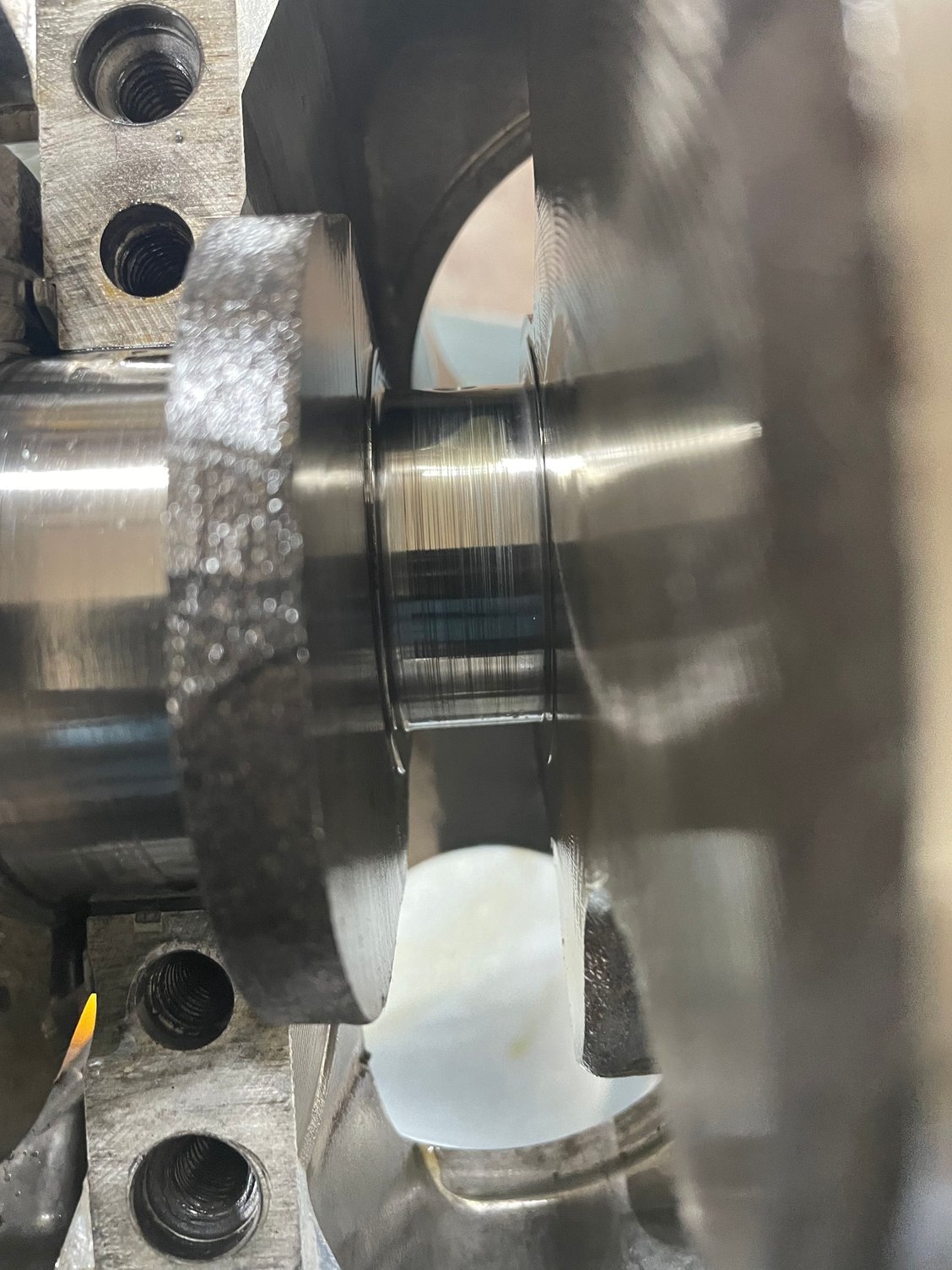

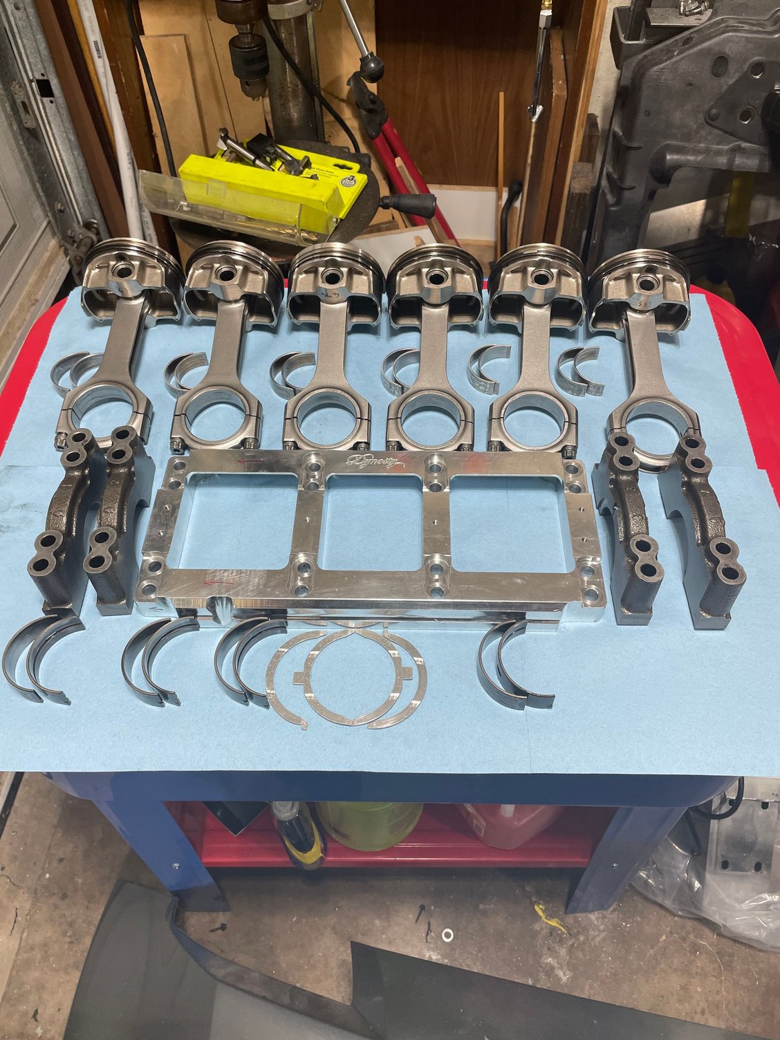

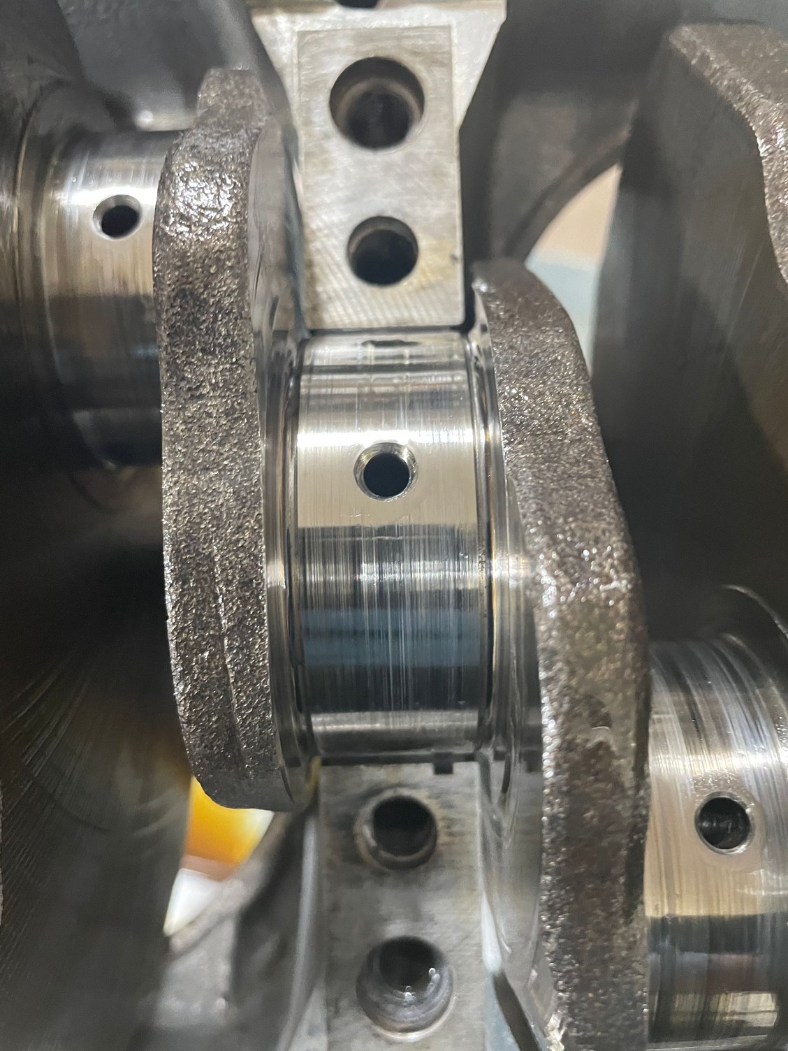

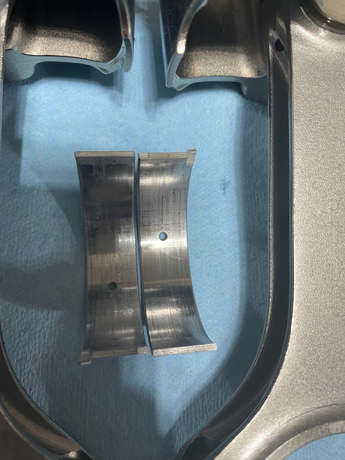

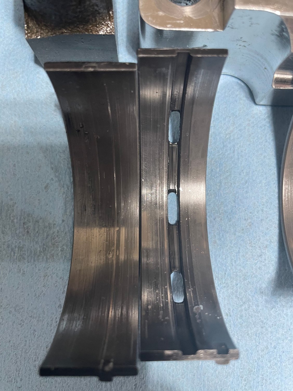

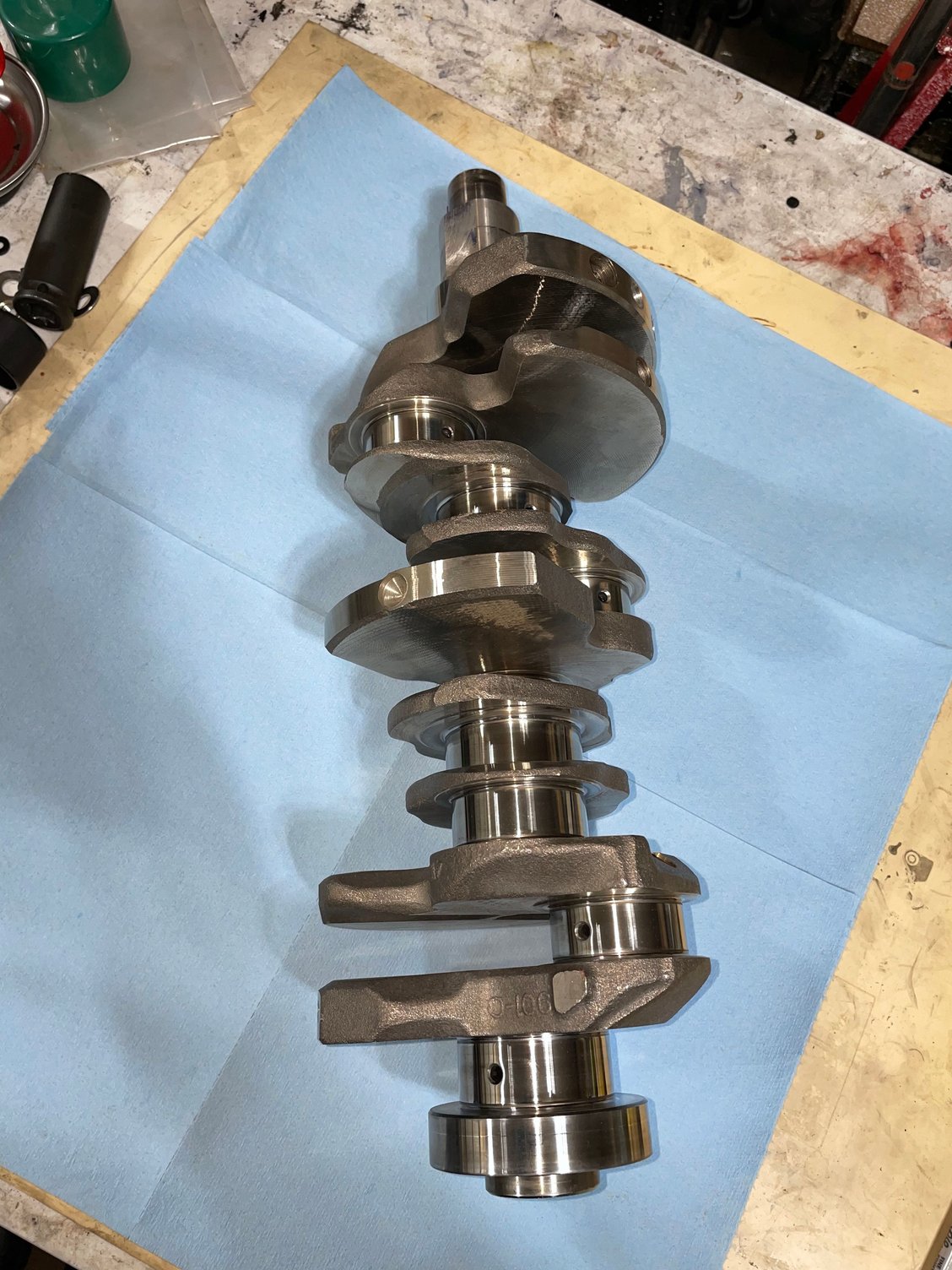

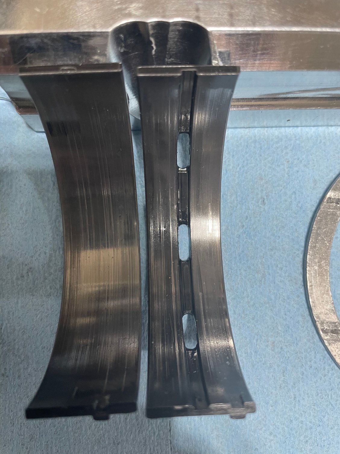

Likes: 158

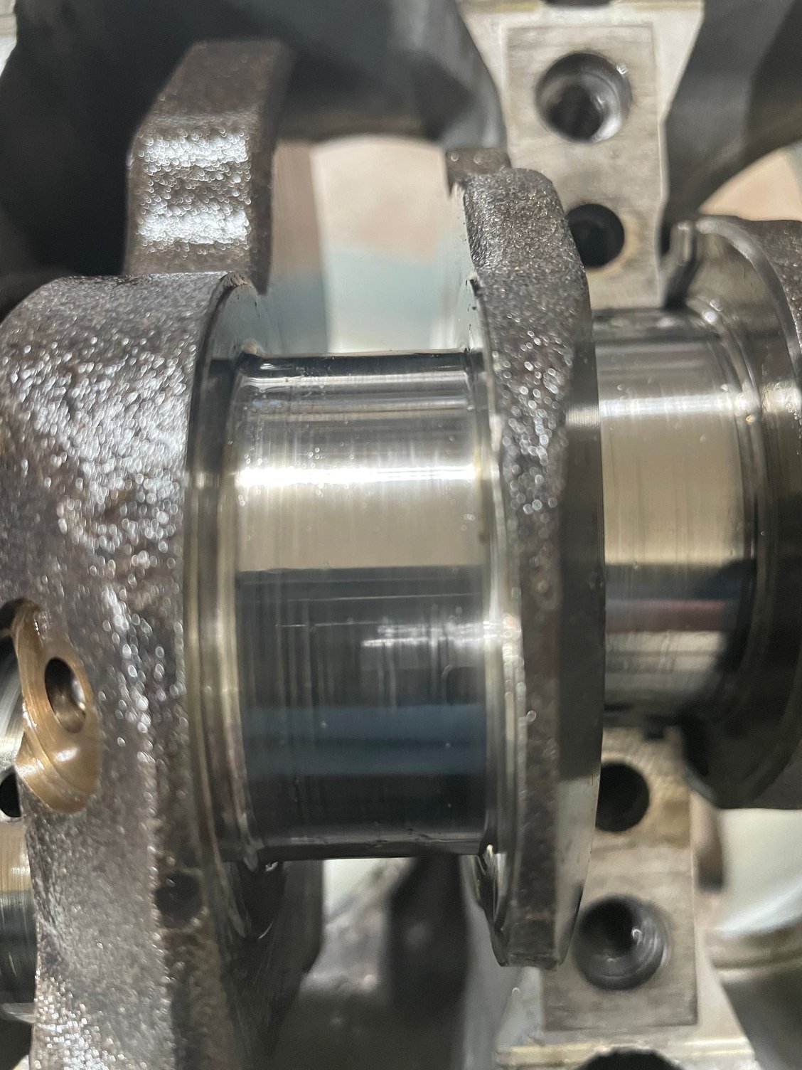

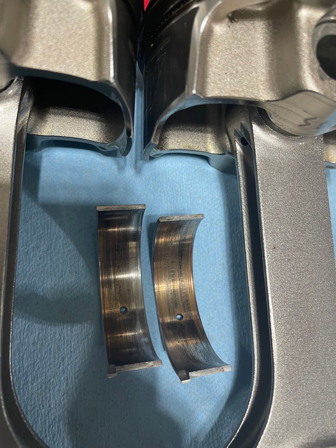

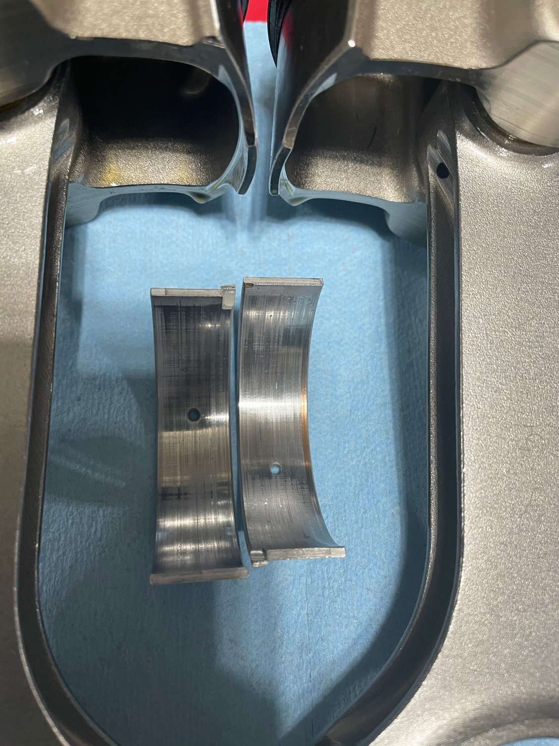

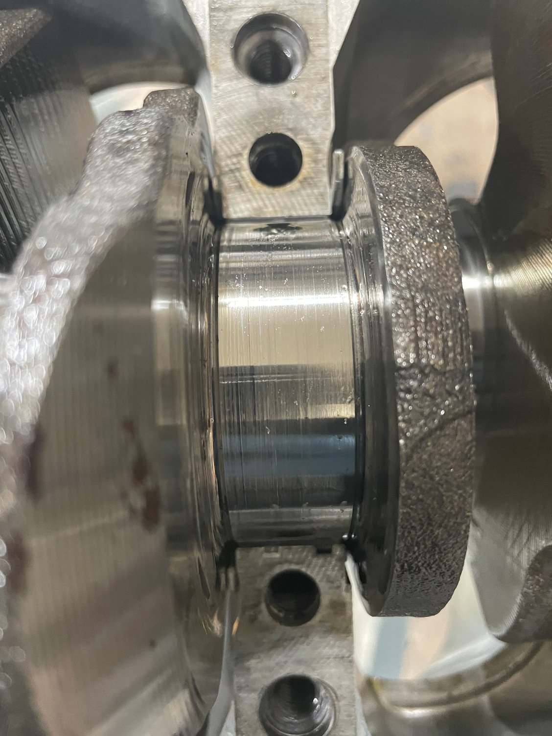

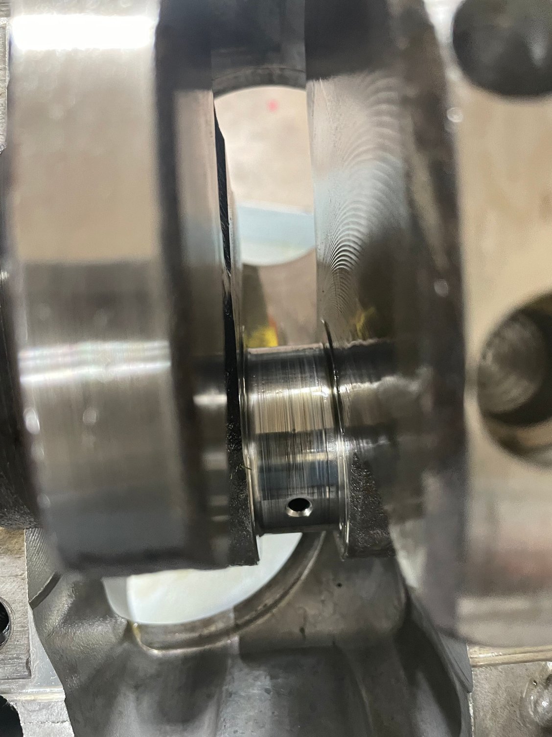

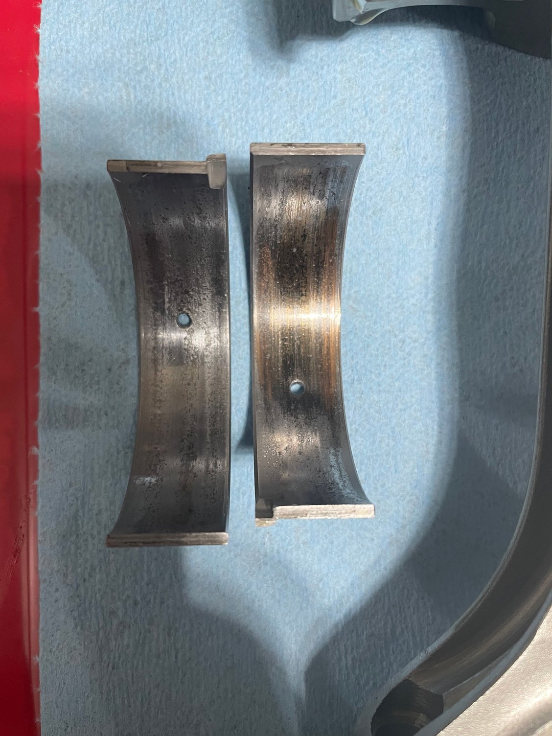

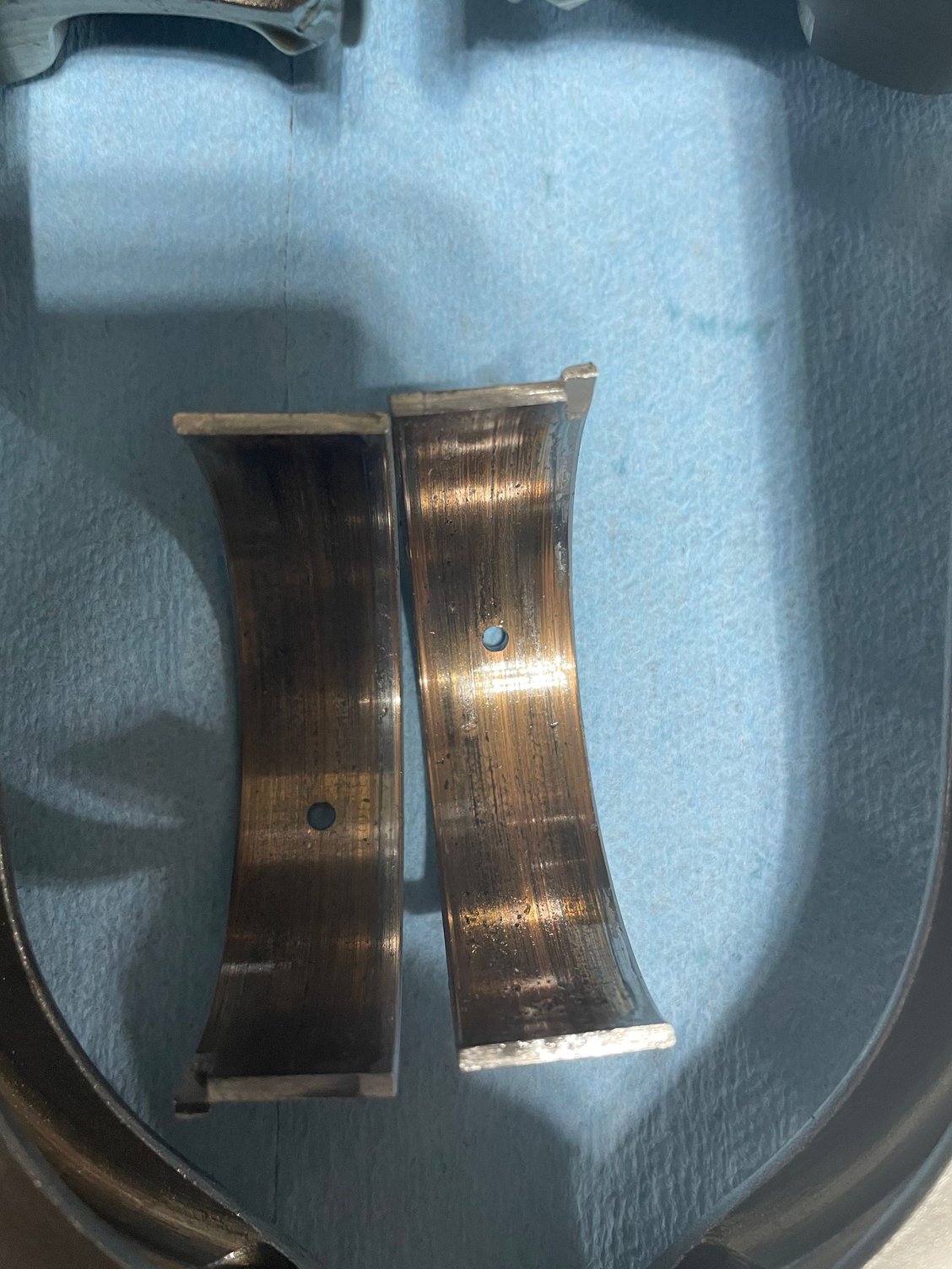

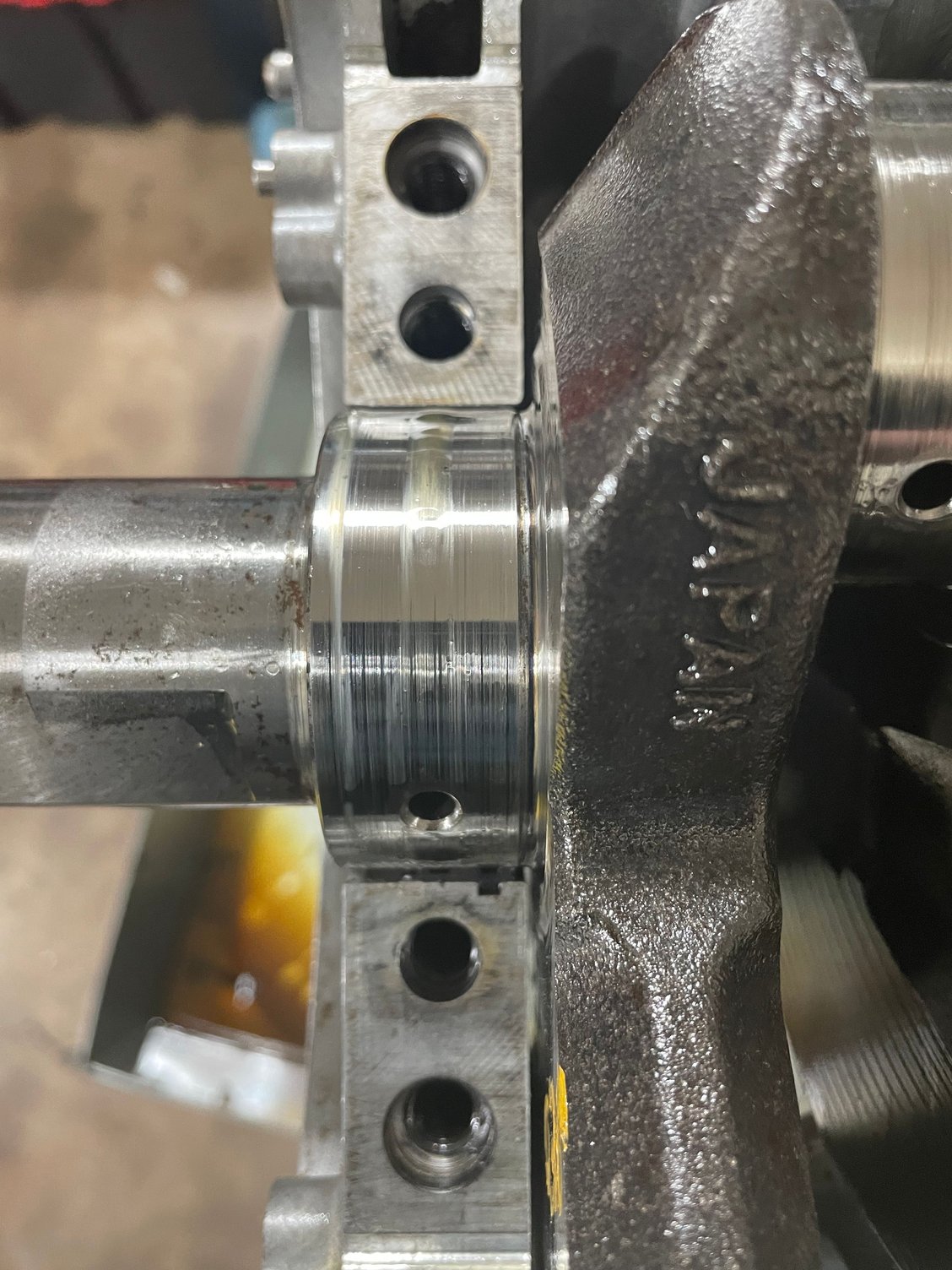

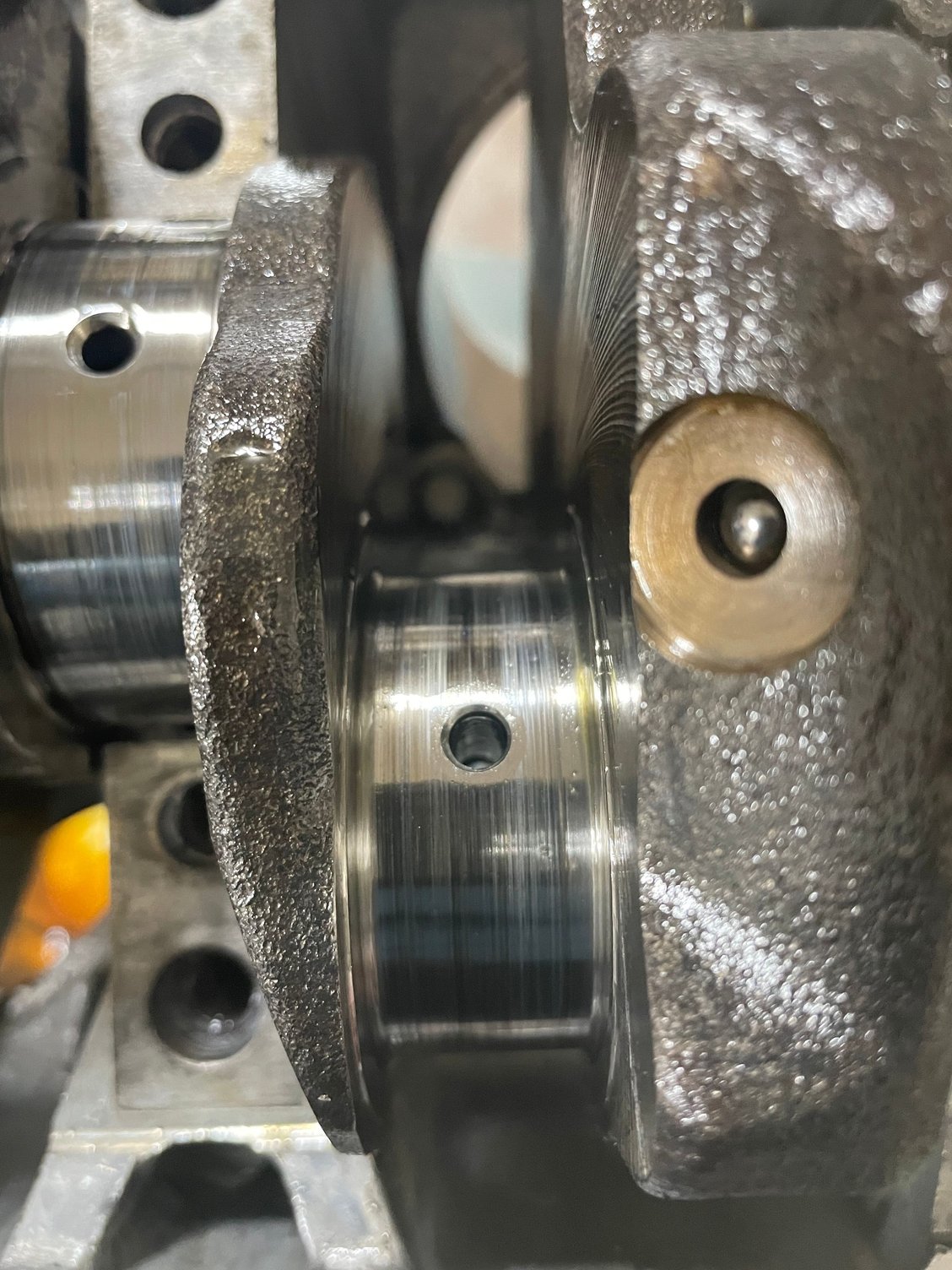

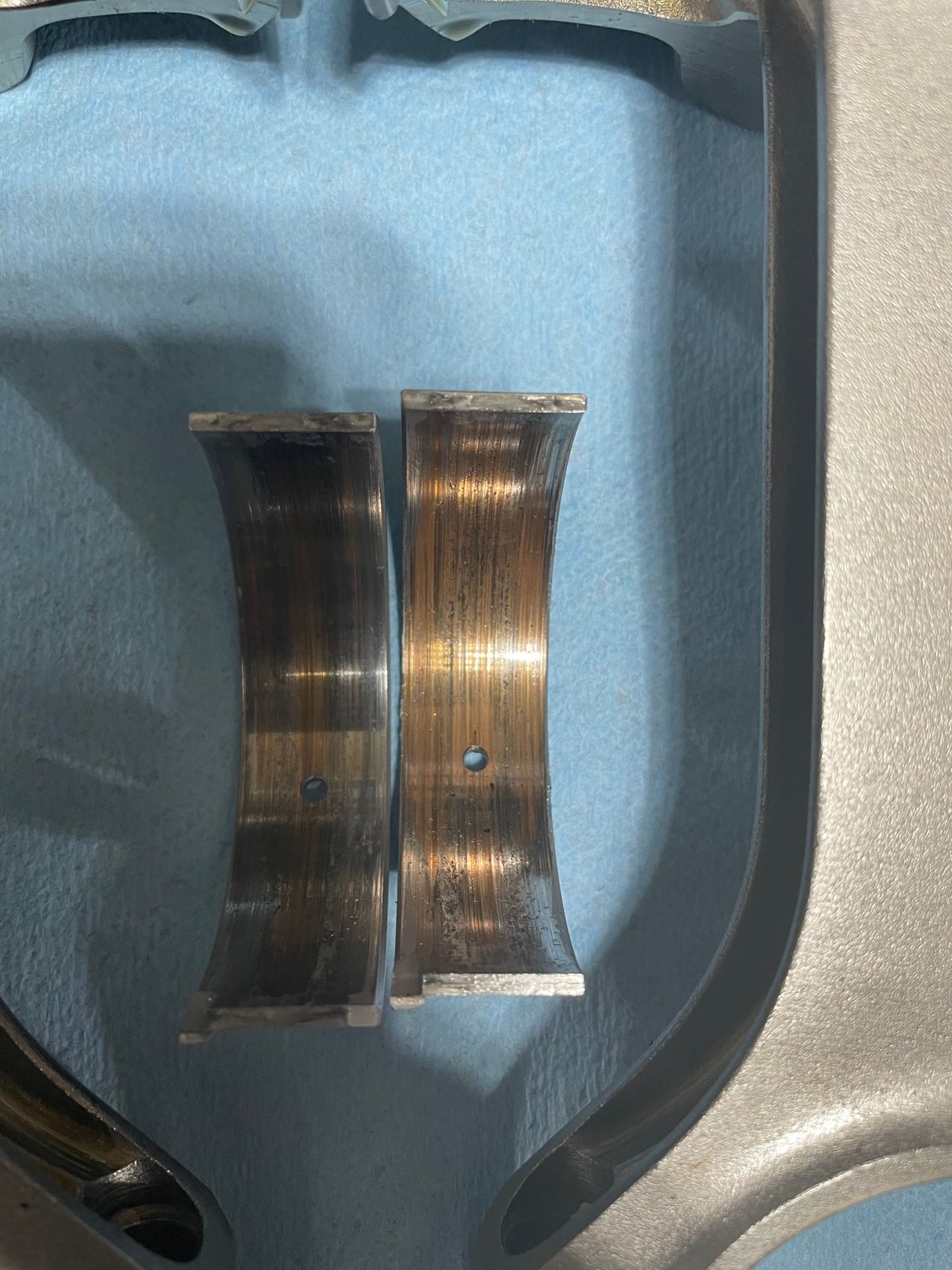

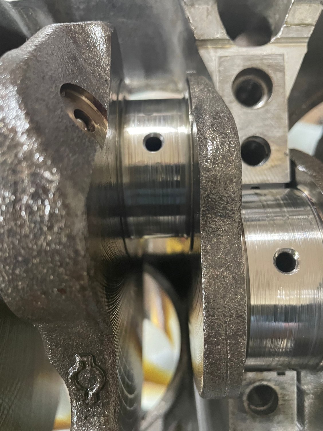

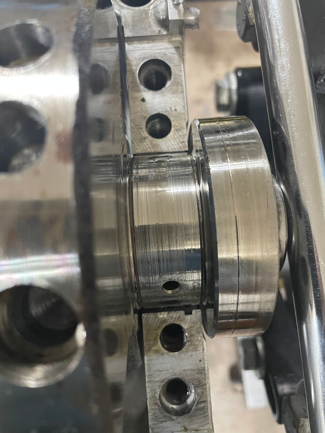

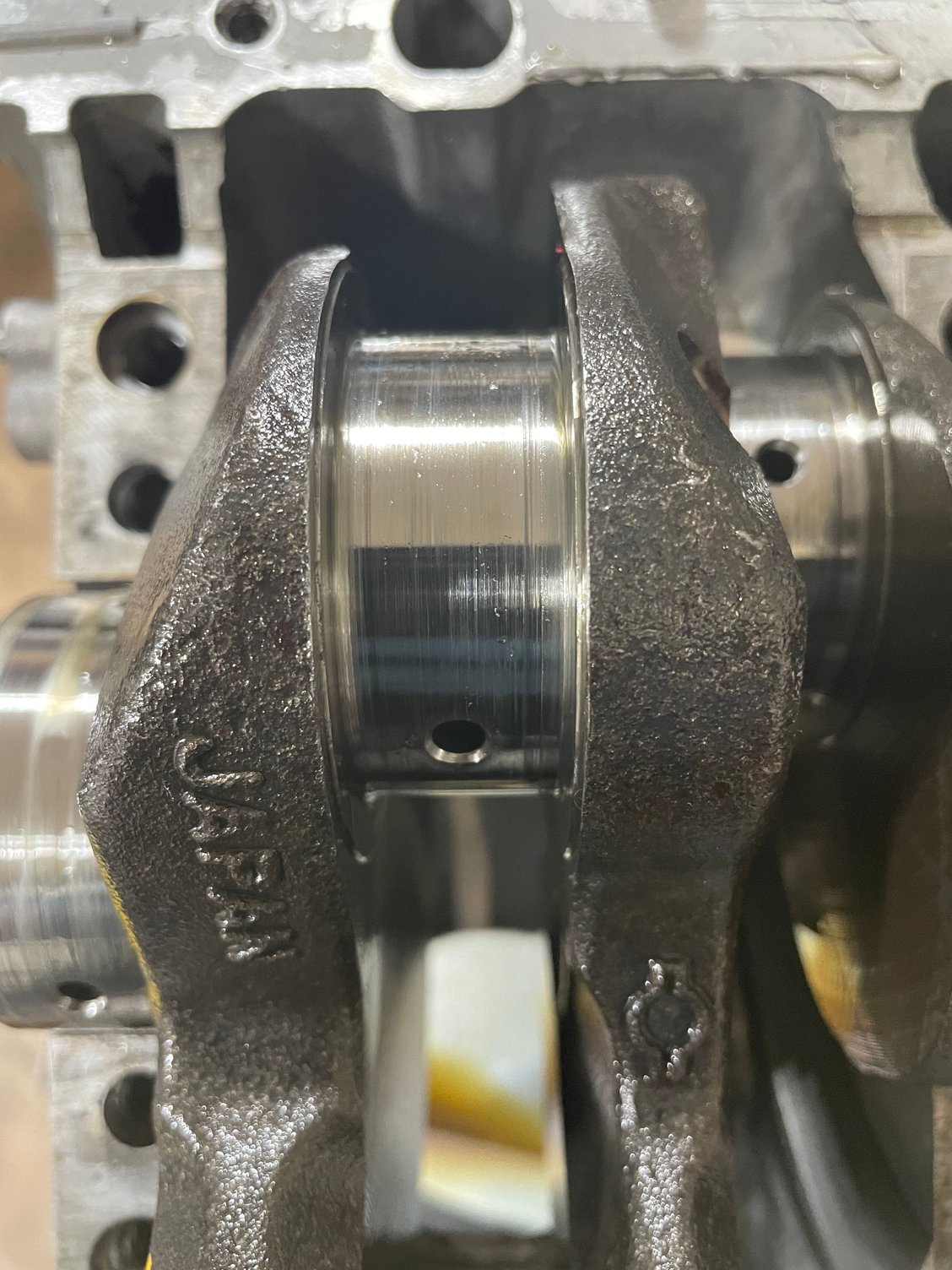

Finally finished tare down of the engine, both heads are going to be retired along with the crankshaft, I’ll begin port and polishing and blueprinting a new set of heads, at least this time I know what not to do. Any who here are a few pictures from the tare down. All the bearings have damage, the rod bearings being the worst
Main #1
Rod journal #1
Rod journal #2
Main journal #2
Rod journal #3
Rod journal #4
Main journal #3
Rod journal #5
Rod journal #6
Main journal #4
Piston and bearings
Main journal 1 bearings
Main journal 2 bearings
Main journal 3 bearings
Main journal 4 bearings
Rod 1 bearings
Rod 2 bearings
Rod 3 bearings
Rod 4 bearings
Rod 5 bearings
Rod 6 bearings

Why are you retiring the heads?
Can the crank be cleaned/polished? It doesnt look bad/ I’ve sent cranks to the machine shop worse than that and they were able to clean them up?
Where are you going to source a new crank from?
Mains look alright
any root-cause-analysis on why the rod bearings look bad?

Originally Posted by bealljk;[url=tel:11071286
11071286]Why are you retiring the heads?
Mains look alright
the cam journals are enlarged to almost double maximum allowance there is no way to fix this and ultimately the cause of my low oil pressure issue. This was my fault as I used scuff wheels on the cam journals without thinking about the effects it would have on cam tolerance and oil pressure, rookie mistake but now I know. I will also replace the camshaft as one is a little bowed. I decided to replace the crank because it’s already been ground down 1 size on the mains and 3 sizes on the rod journals. I have a healthy crank that I can use standard bearing sizes with so I decided several weeks ago to have the machine shop go ahead and polish and balance it to the bob weight numbers of the rotating assembly. I’ve started working on a new set of heads and that were in good condition to begin with. I’m going to take my time and enjoy porting the heads. I’ll buy a new set of Brian crowler valves for the new heads and have the machine shop trim them to size when they do the valve job and surface the heads

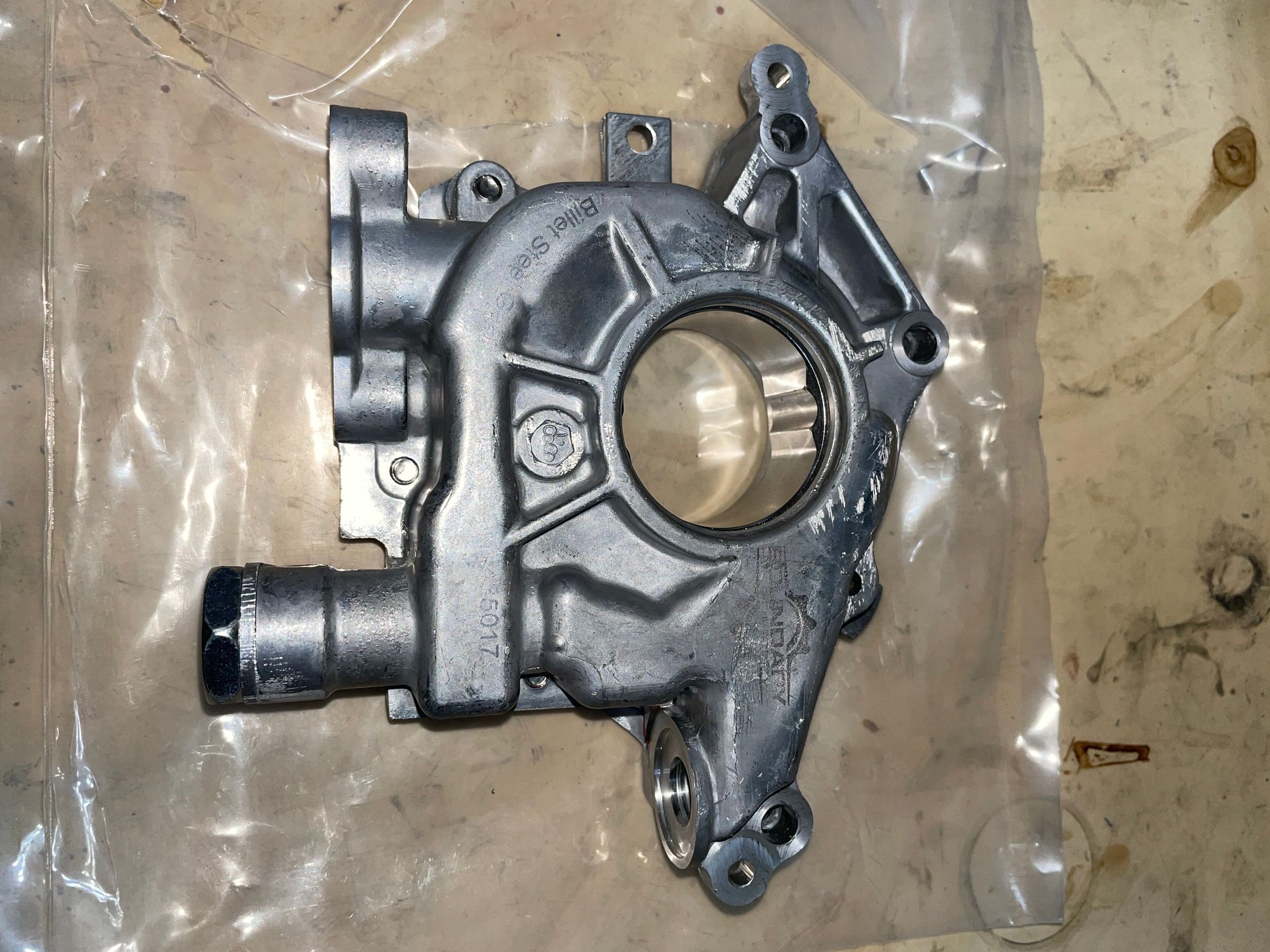

I decided to make the plunge and purchase a boundary pumps VQ DE High Flow Oil Pump Assembly with the MartenWear Treatment, it’s a fully blueprinted oil pump for the VQ35DE with higher flow and I’m having them spec it for higher oil pressure for the larger bearing tolerances required for high HP applications, should be able to support +1000hp and 13000rpm, so more then sufficient for my power goals. And it comes with the blueprinting documentation.

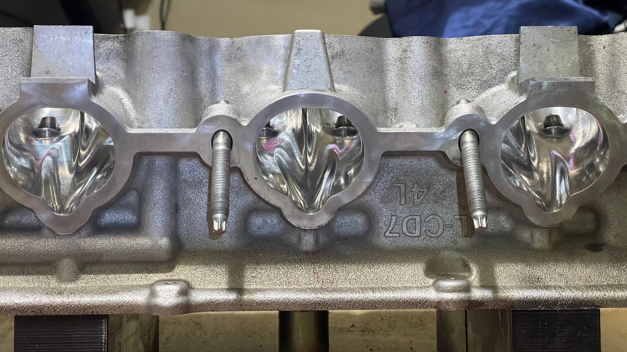

as for the new heads I’ve finished porting the intake and exhaust of the drivers side head, just need to finish final polish out, then I’ll move on to enlarging the head stud holes for the GTR studs I’m using and final cleanup then I’ll start on the passenger head and then they will both go to the machine shop for a surfacing and valve job with the new valves. I also decided I will be switching from the oem hardware in the head and block to ARP stainless bolts for cam caps, oil pump mounting, and for timing brackets. Not Sure if I’m going to do this but I’ve been in talks with getting the crankshaft and main timing gear cryo-treated but I’m not really sure if I want to ship the crankshaft. Any who that’s all for now I’ll continue to update as I make more progress, I’ll probably post pics of the port job later when I’m done

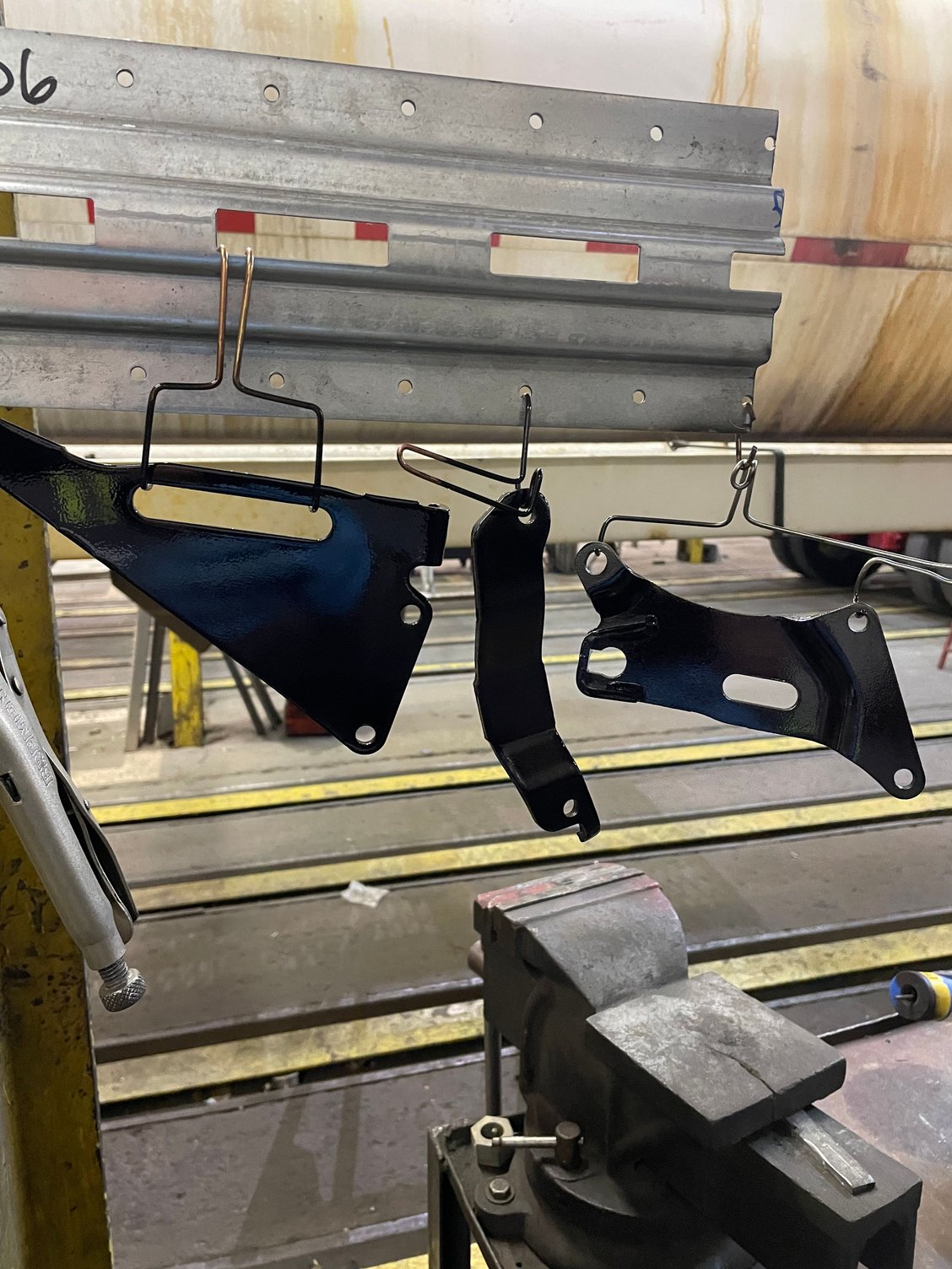

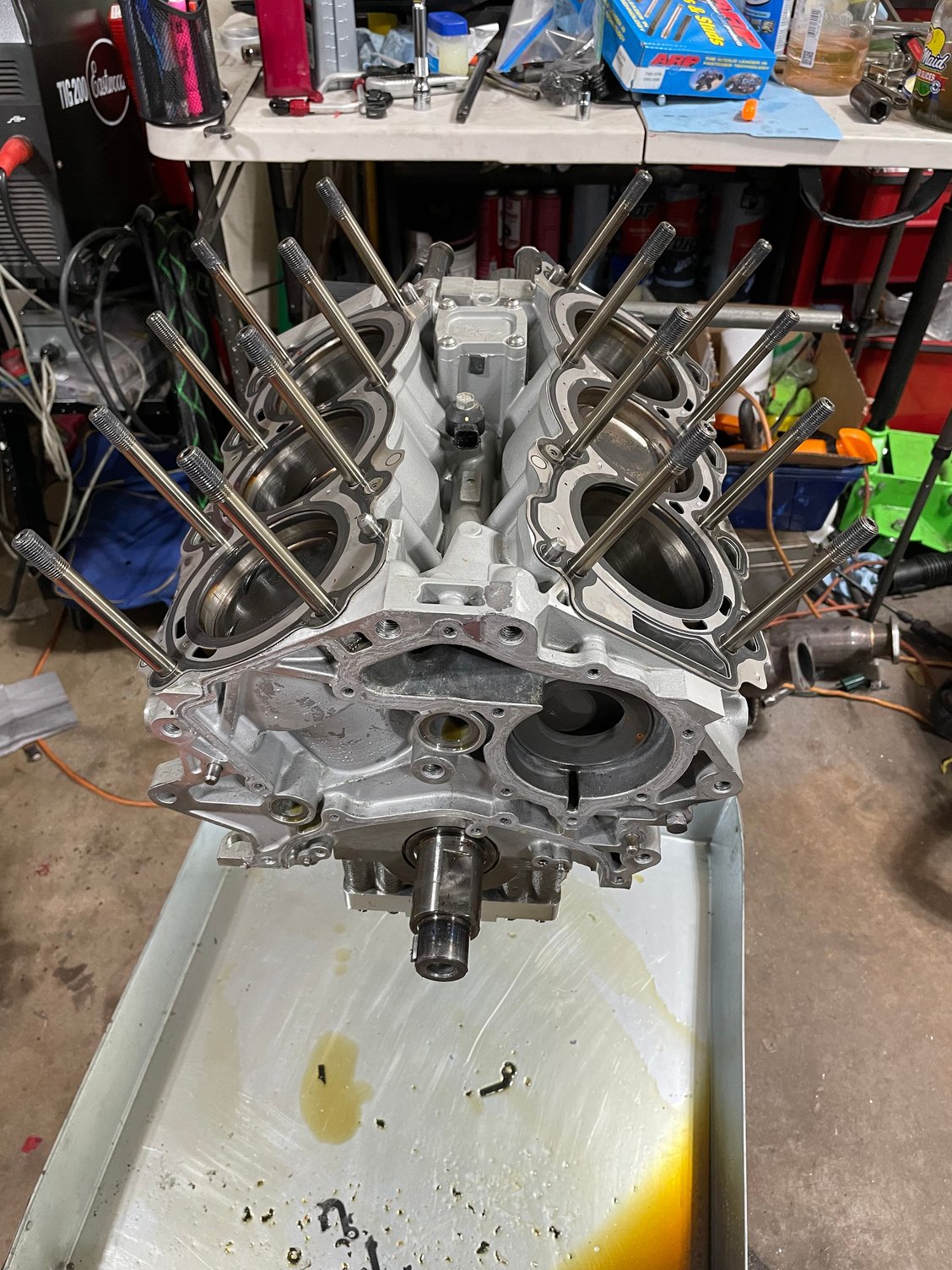

Little update: dropped off the heads at the machine shop they said they were backlogged 3-4 weeks so I’ve got time to burn getting everything cleaned and ready for assembly. Picked up the crankshaft and all the tolerance were good which I confirmed letter with a micrometer at home
boundary blueprinted pump came in this week

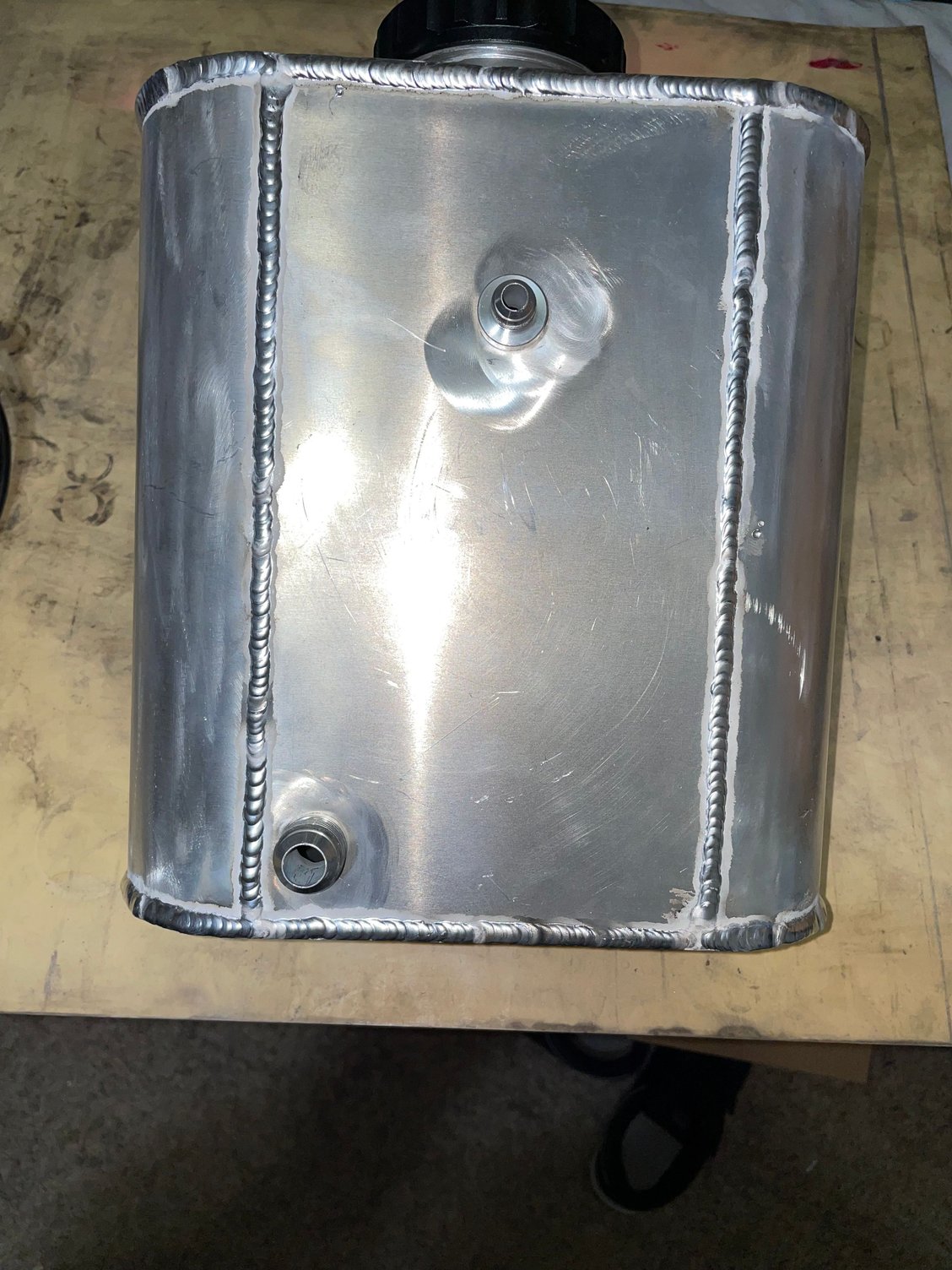

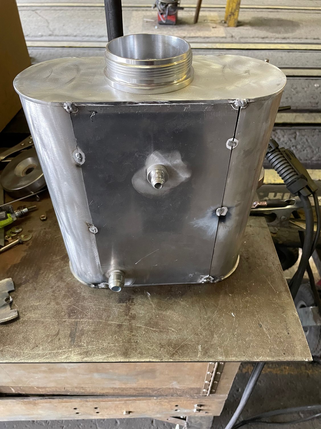

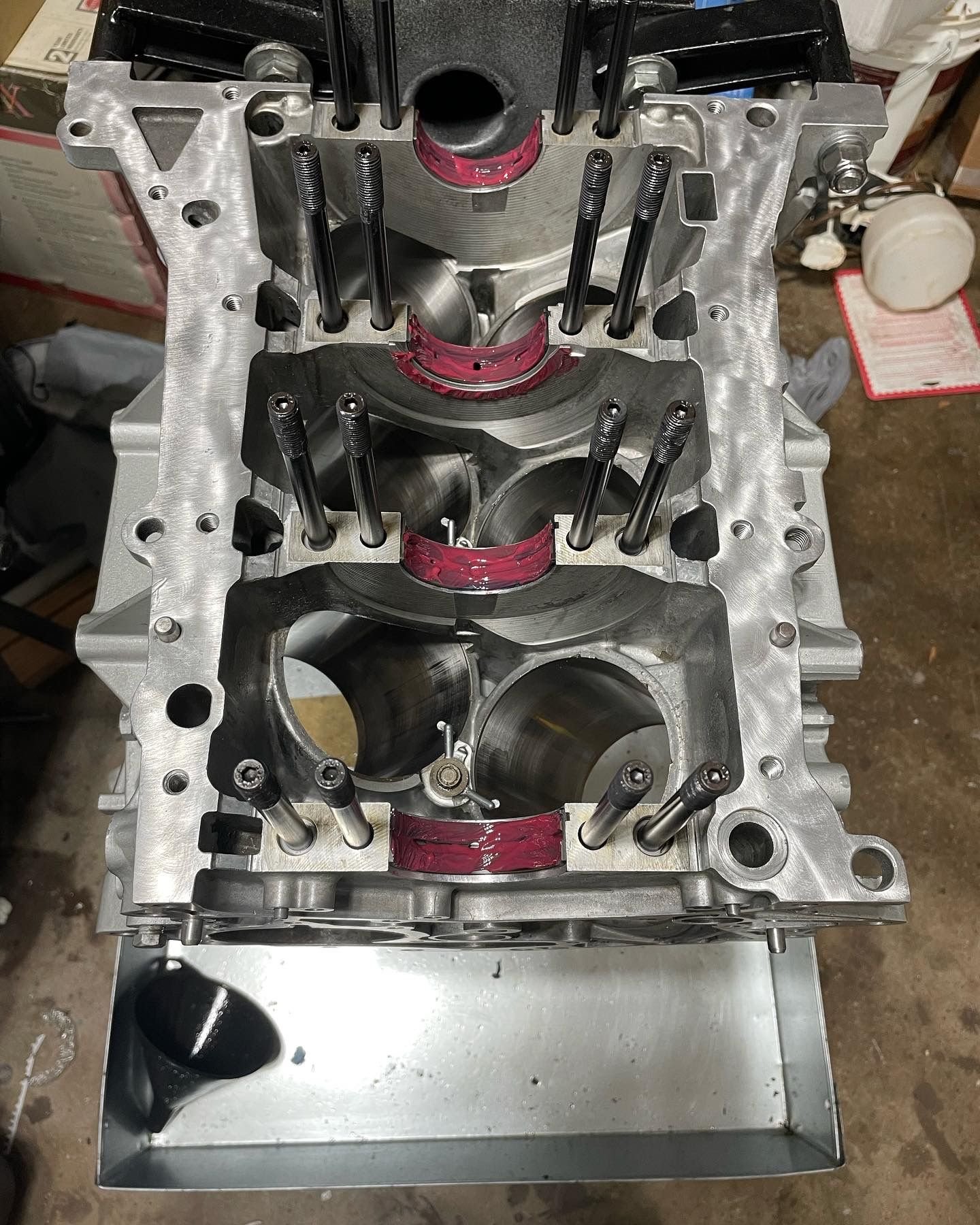

did some fabrication to make an aluminum pre-oiling tank for the engine stand, the idea is to cycle break-in oil through the engine on the stand without rotating the assembly. That way I can prime the pump and oil passages before starting the engine, it will also help me get any dirt or other contaminants out of the engine before startup.
the idea is to put 5gt in to the tank and have the exa pump pump it through a 30micron filter, into the engine, collect the oil from the oil pan and repeat process until I gave good oil pressure, then I will use fresh break-in oil for actual startup

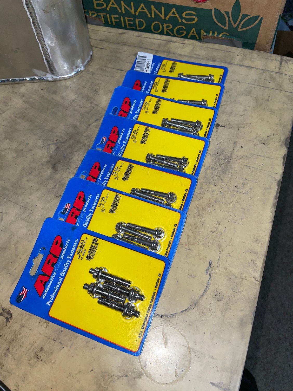

Got some of the ARP bolts in for the cam caps, oil pump, and some accessorie studs for the rear coolant pipe
still a lot I need but ARP has a lot of things on back order till April so I get them as I get them.
I did start getting the rear coolant pipe ready for the turbo setup, this will include cleaning up a lot of the casting flash, adding -6AN ports for the wastegate coolant line and I will eventually ceramic coat it as well, I’m going to need the added protection of the ceramic coat and you guys will see why later

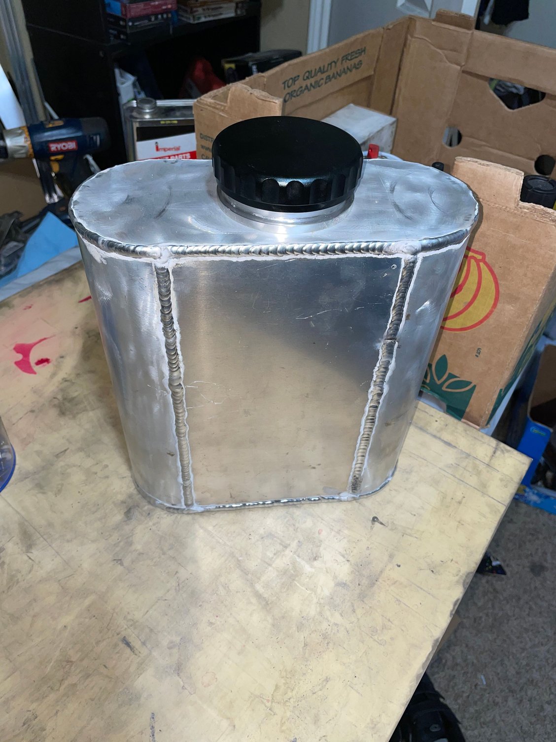

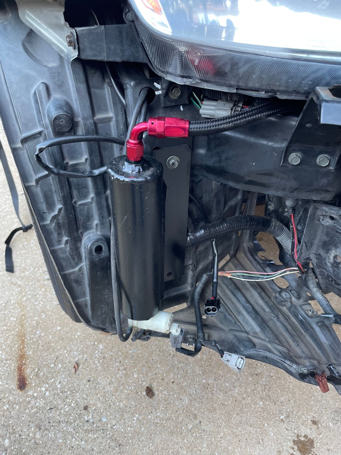

Also not sure if I have posted this yet but since I have a good bit of downtime that I can’t really expedite due to the machine shop, I’ve been going back and powder coating a lot of the engine brackets with a gloss black w/red flake coating. I think it will compliment the red metallic of the front cover and such nicely

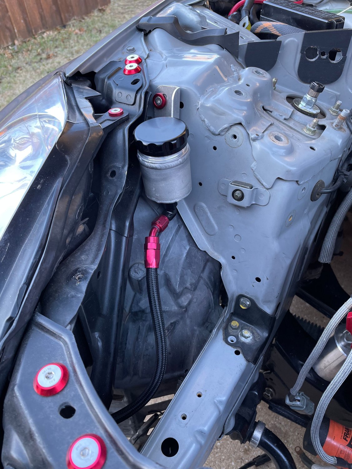

also as I’m going through all this stuff to upload I found some things I don’t think I ever showed you guys, here is what I did for a windshield washer reservoir, it runs the front sprayers with the oem pump
it needs some work to clean up the remote fill reservoir but here it is

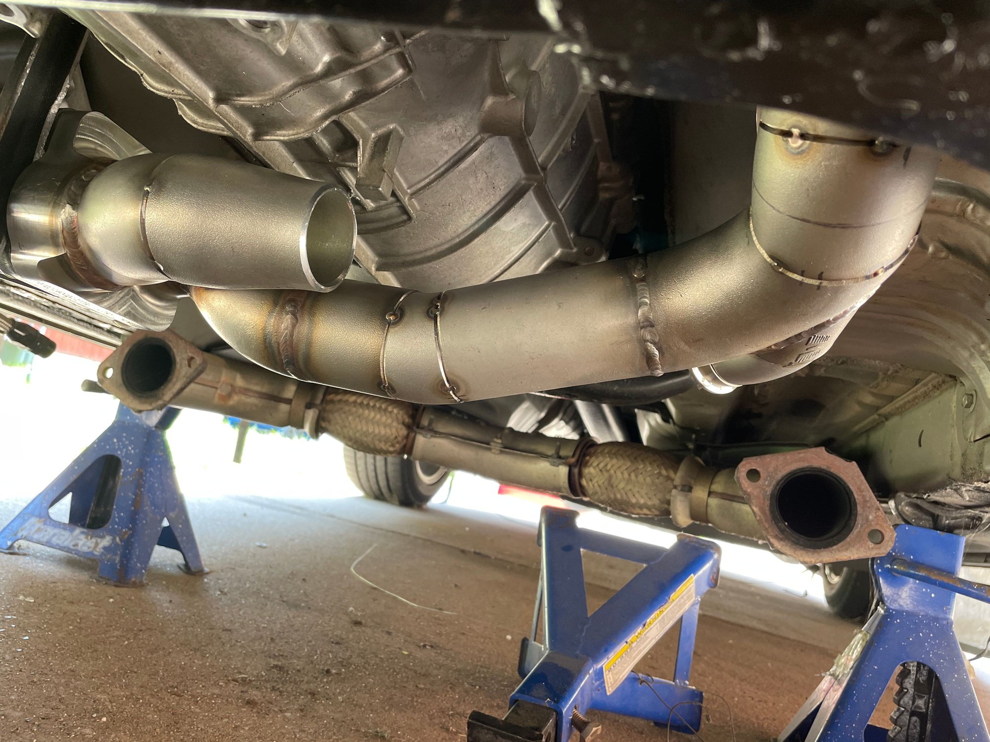

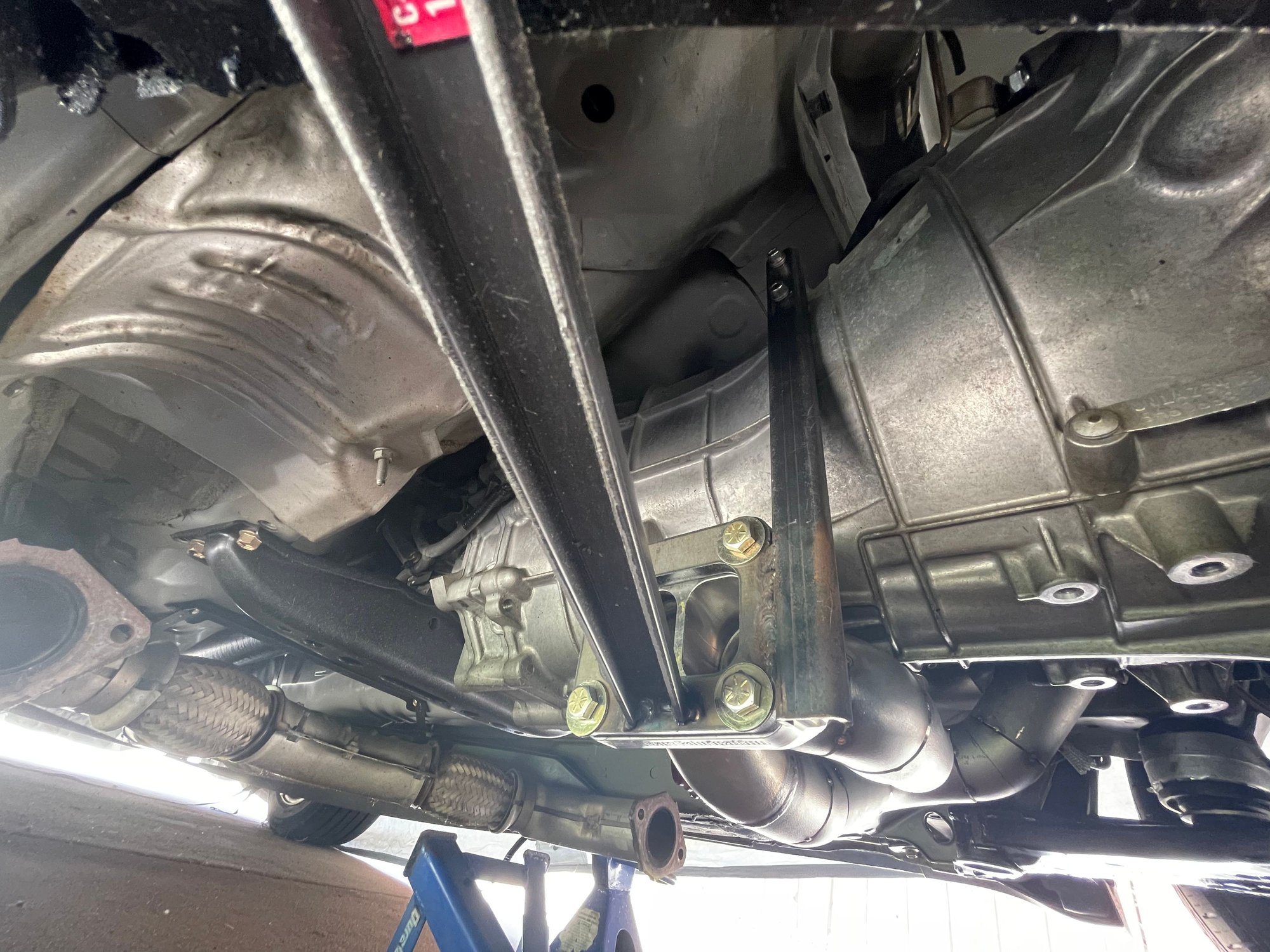

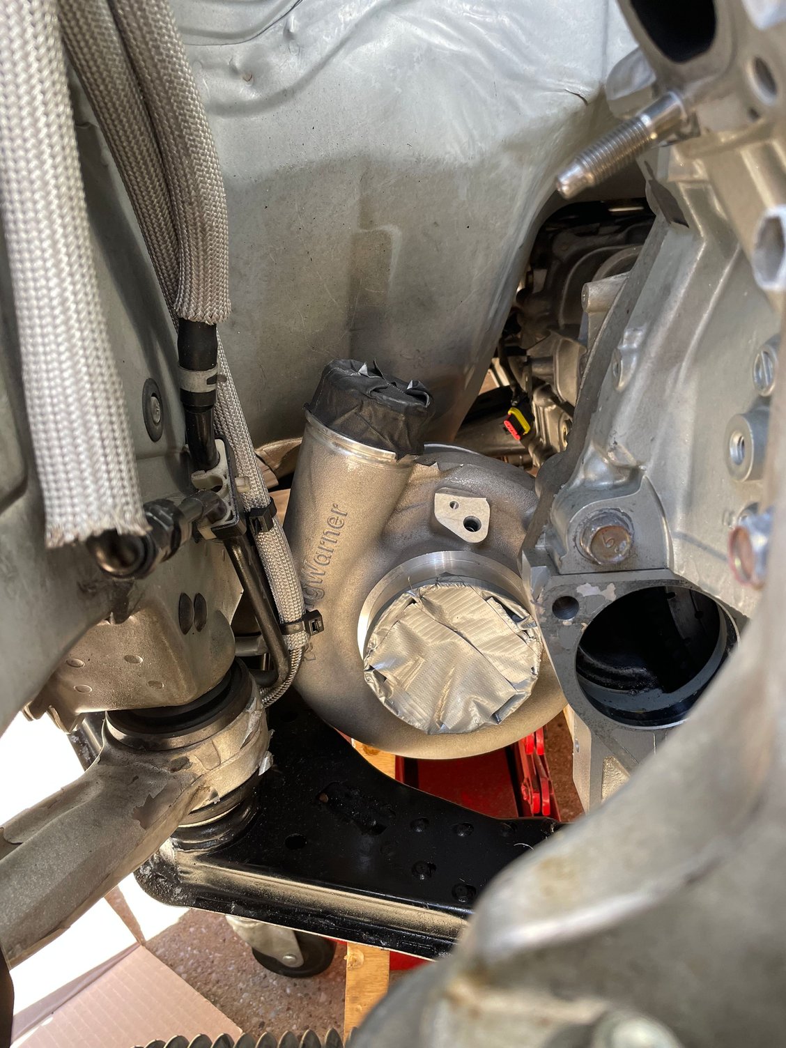

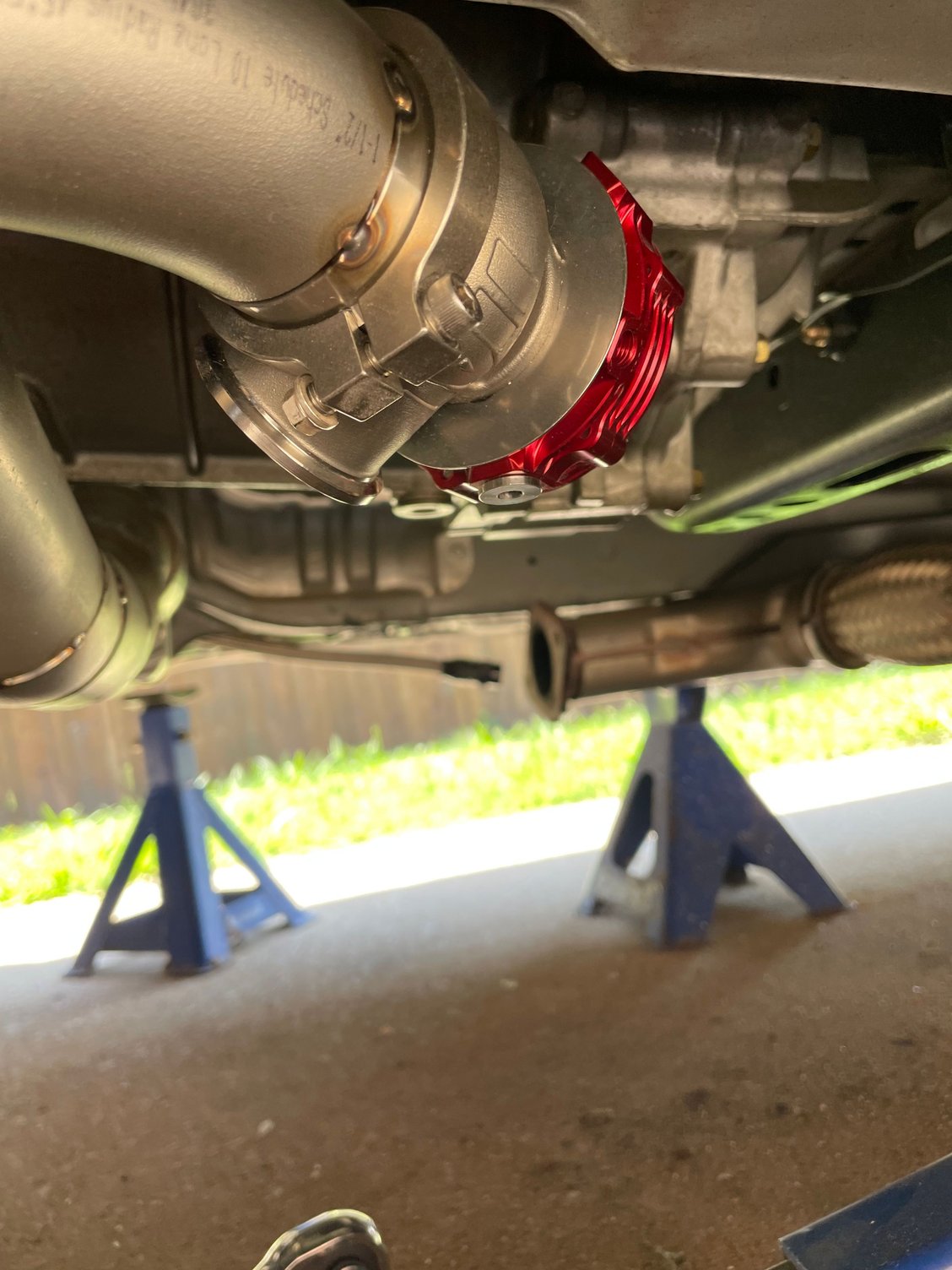

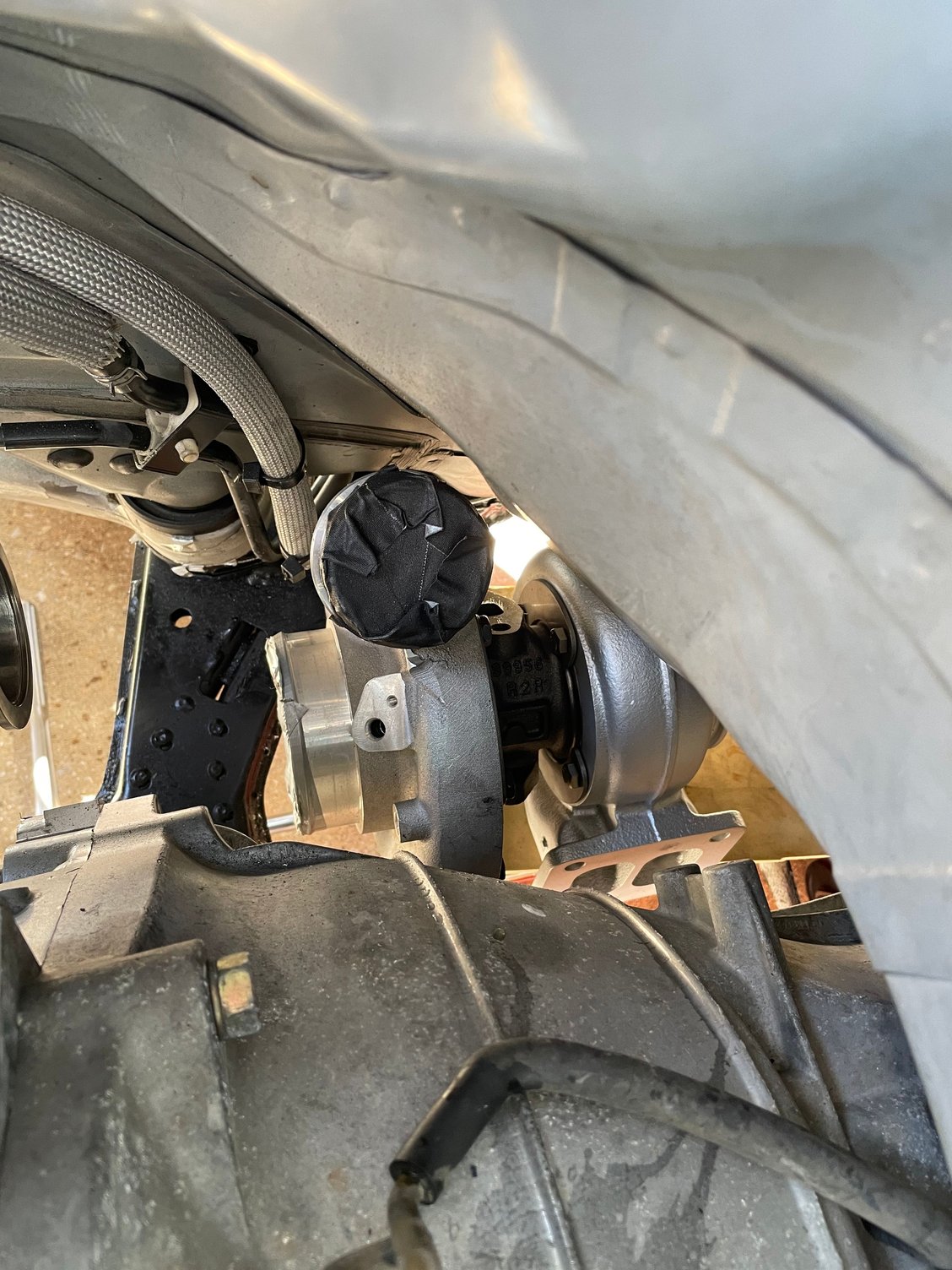

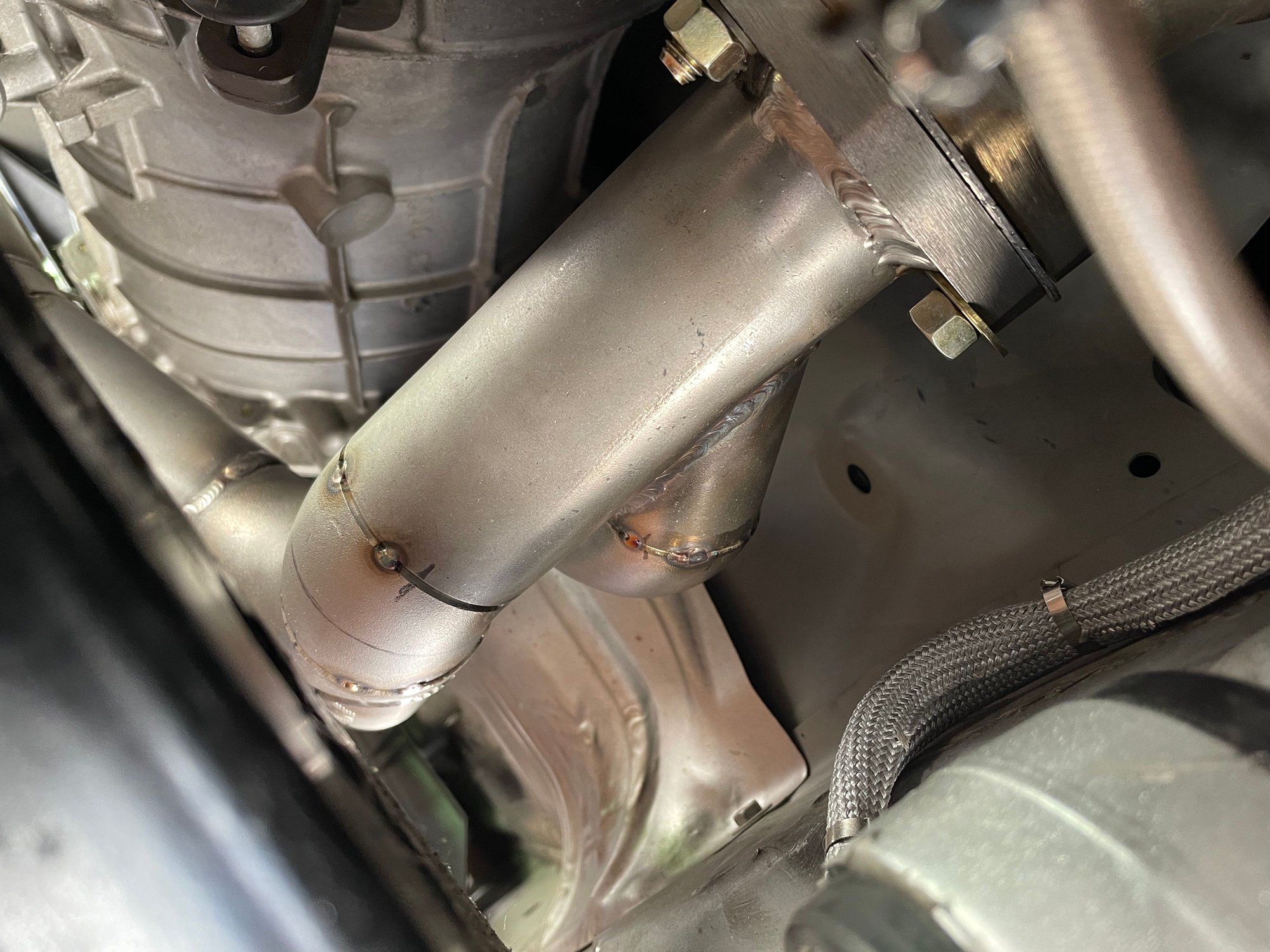

Quite an update today, all turbo and fabrication related. I apologize in advance if I post a picture I’ve already posted before but I wanted to do a good detailed update on the fabrication side of things

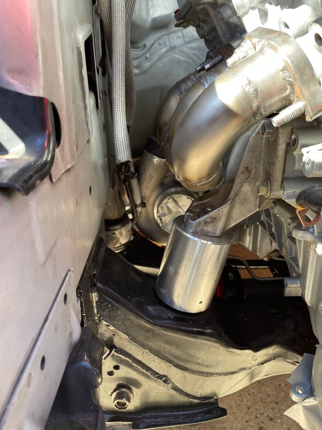

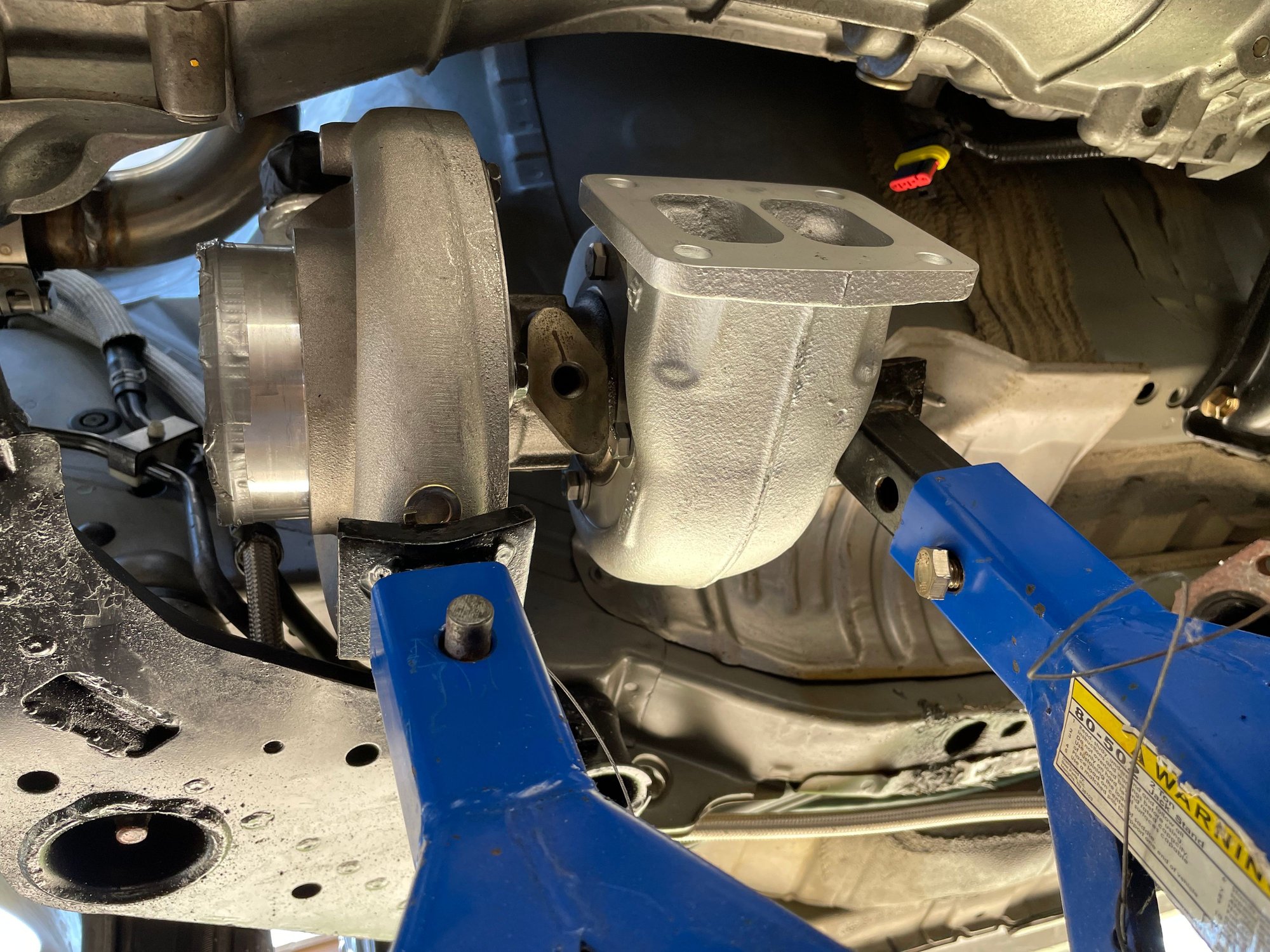

first off I’ve officially given up on having the turbo where the A/C compressor was, I’ve now opted for a trans mount turbo setup. Over all I just wasn’t happy with the progress and quality of fitment I was getting from trying to cram everything right next to the engine. There is a lot more to it than that such as heat issues and such but I have a lot to post so we will leave it at that.
This is the new location for the turbo, passenger side of the transmission. The camera angle is a little weird so it looks like it’s sitting lower than it really is
i ended up playing around with this position on a few separate occasions so there is slight positioning differences between some of the photos

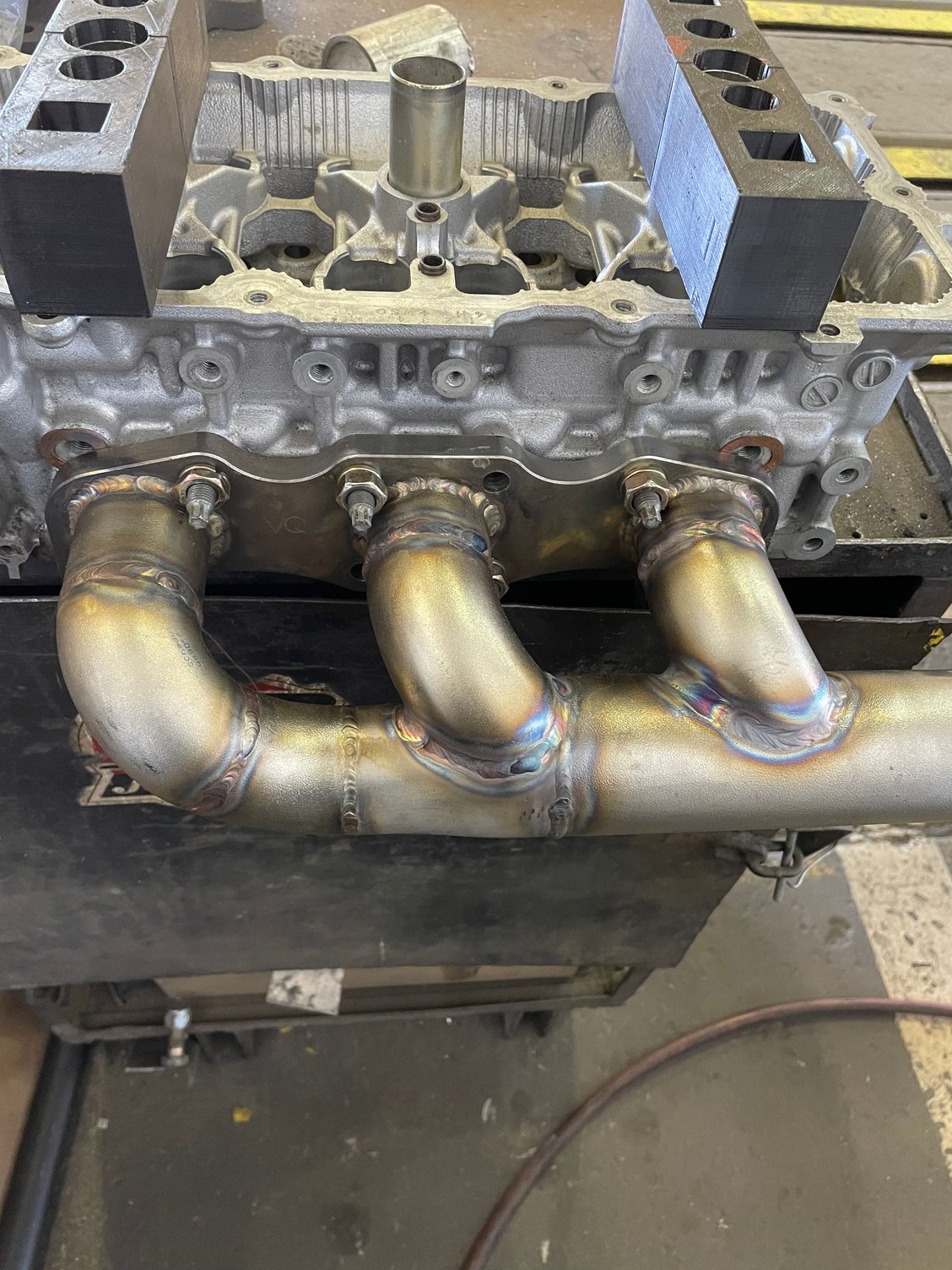

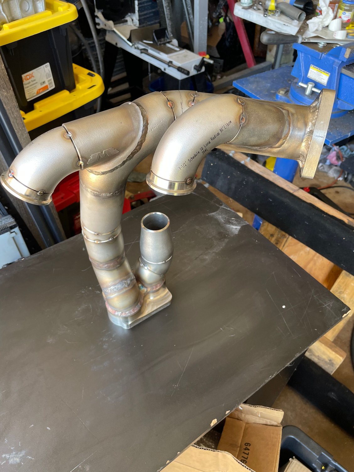

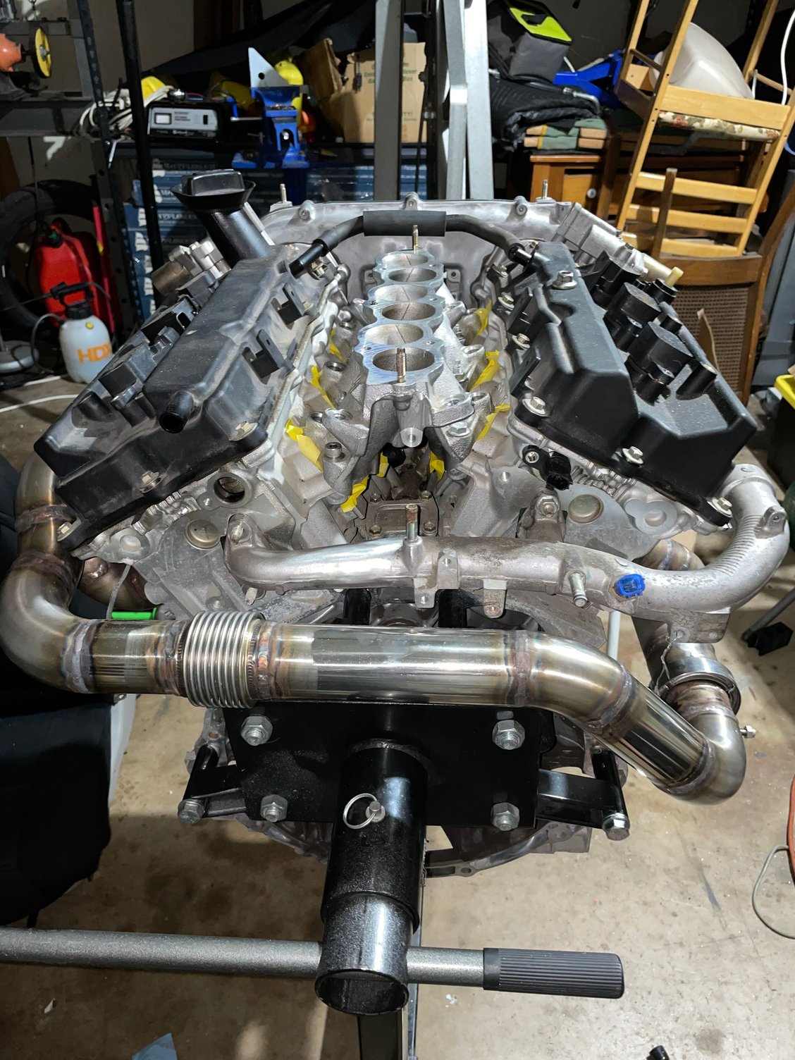

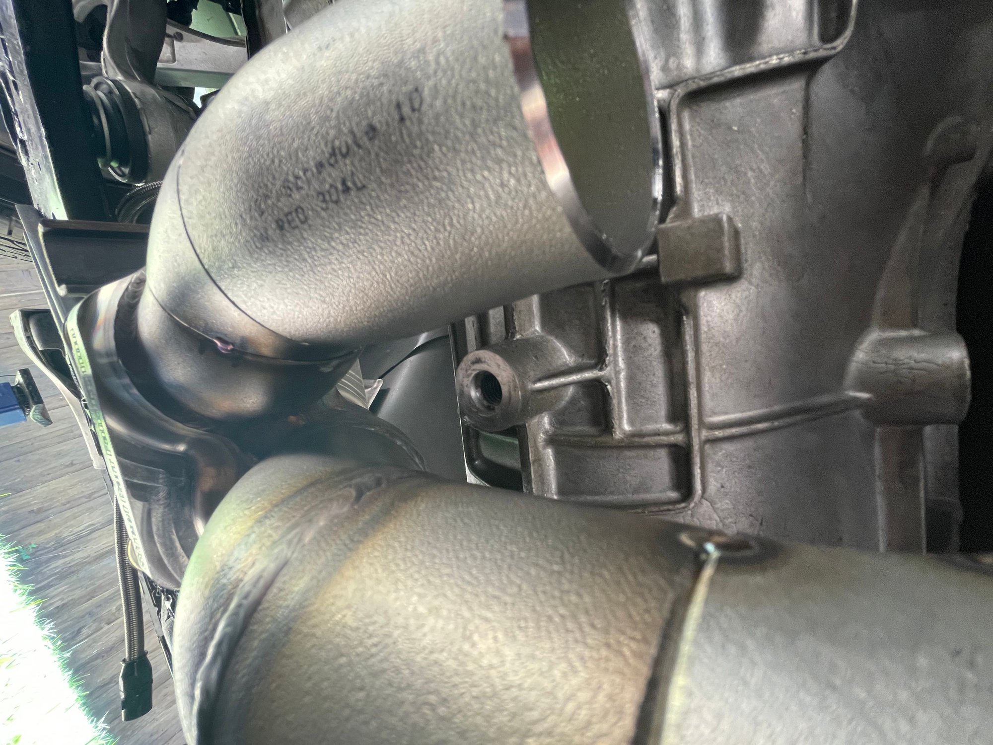

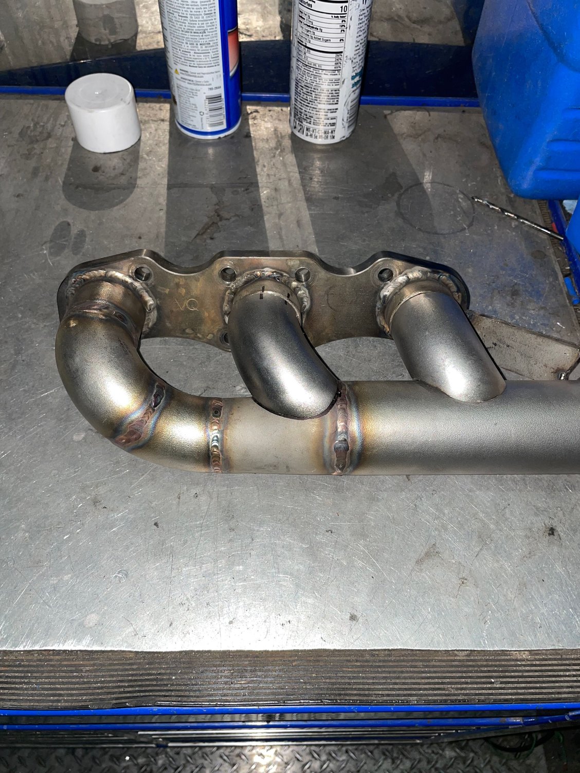

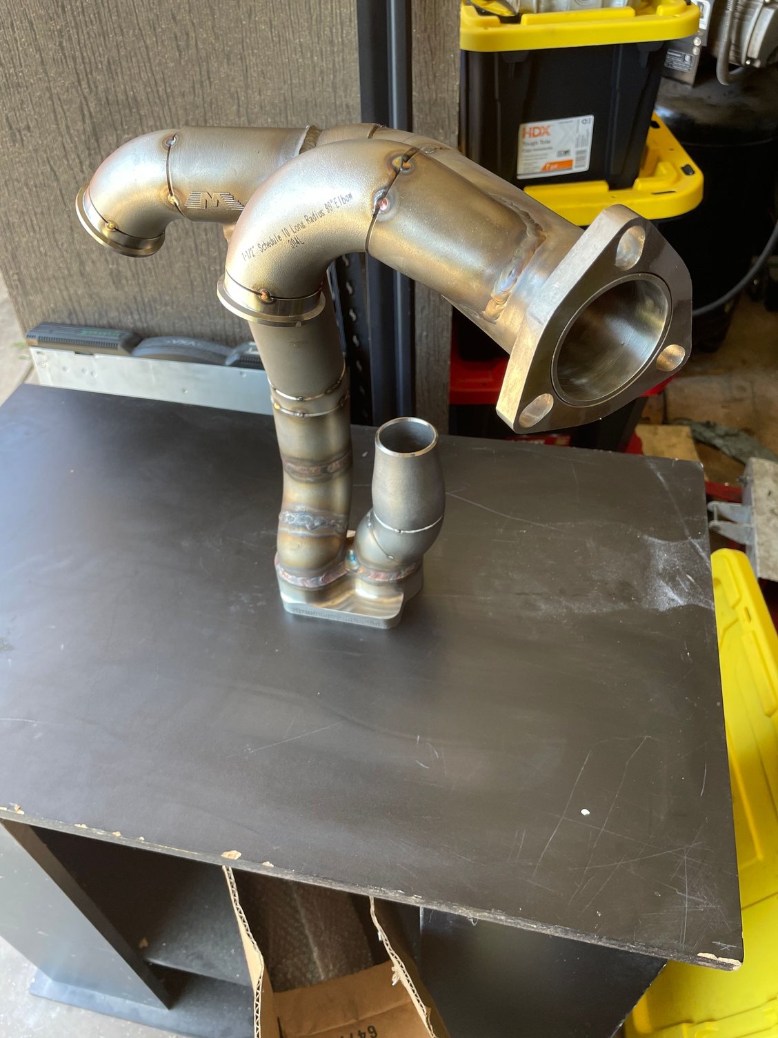

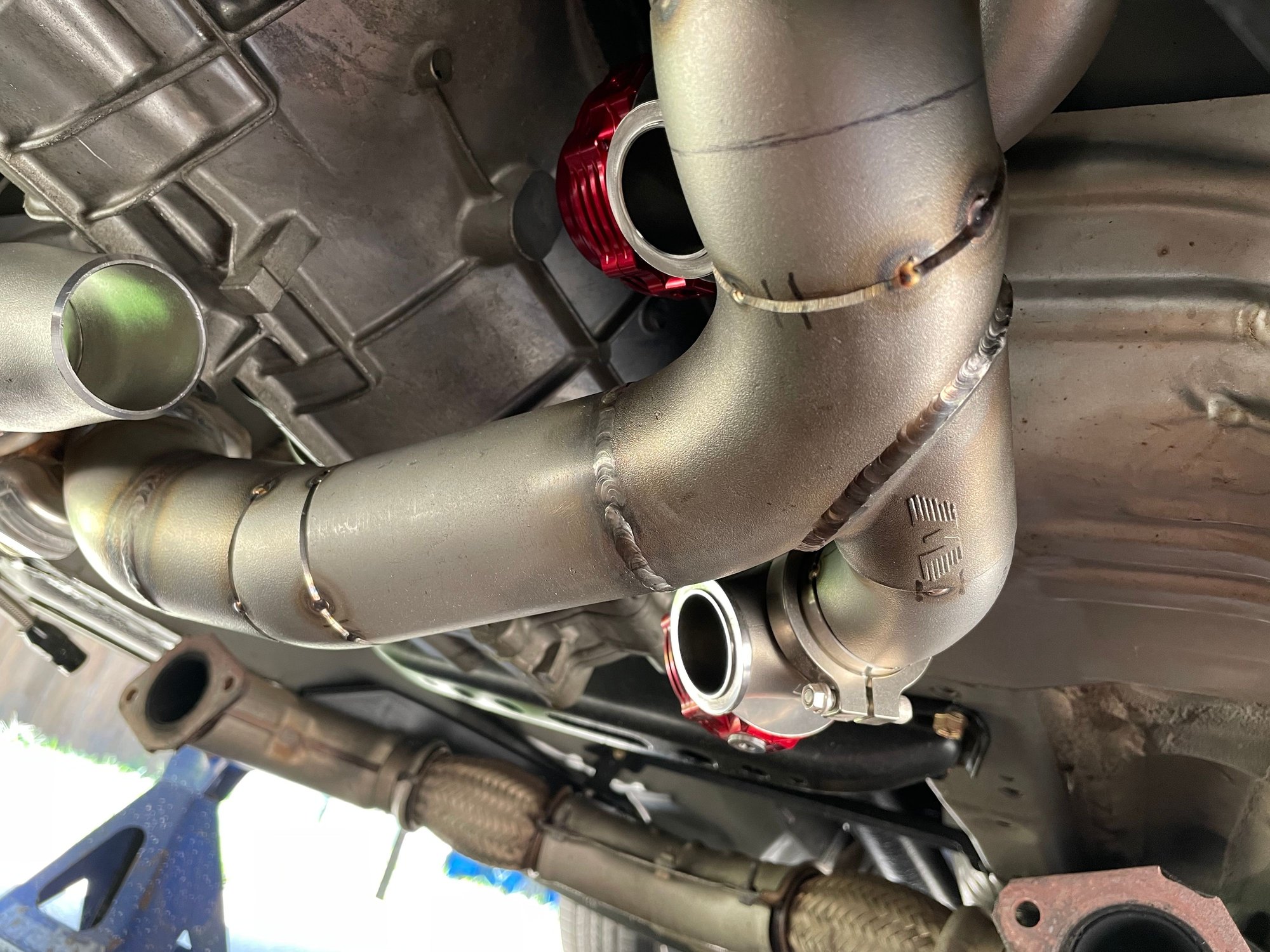

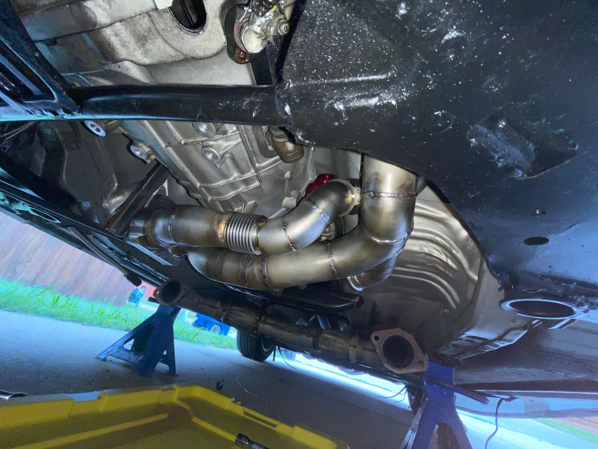

I rebuilt the passenger side manifold to pass out the rear and cross over the bell housing where it will merge with the outlet of the drivers side manifold before heading down next to the transmission. It might seam like a backwards way of doing it since the turbo will be on the passenger side but I need room for the wastegates, more on that in a second. this photo was taken in the early stages of fabrication and has changed a bit, in this picture it continues towards the front on the drivers side but was later revised to merge angling towards the rear
I completely scraped the driver’s side manifold and started with a new flange and angled everything towards the rear

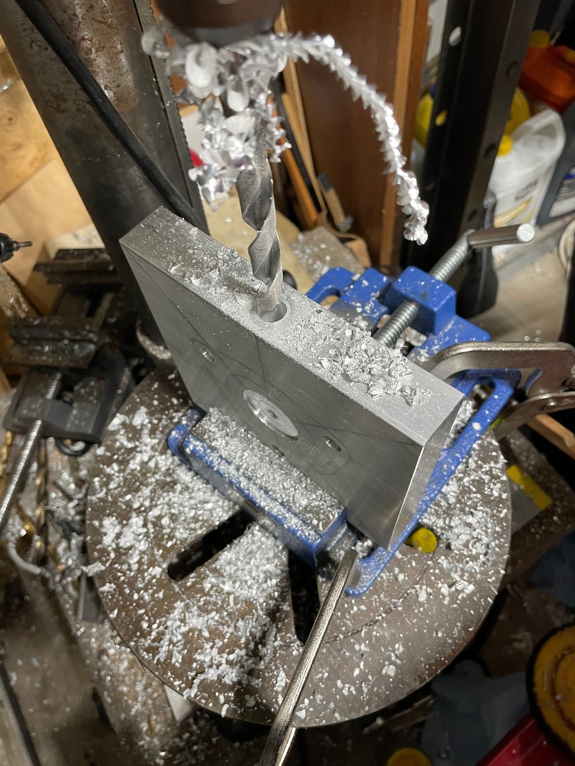

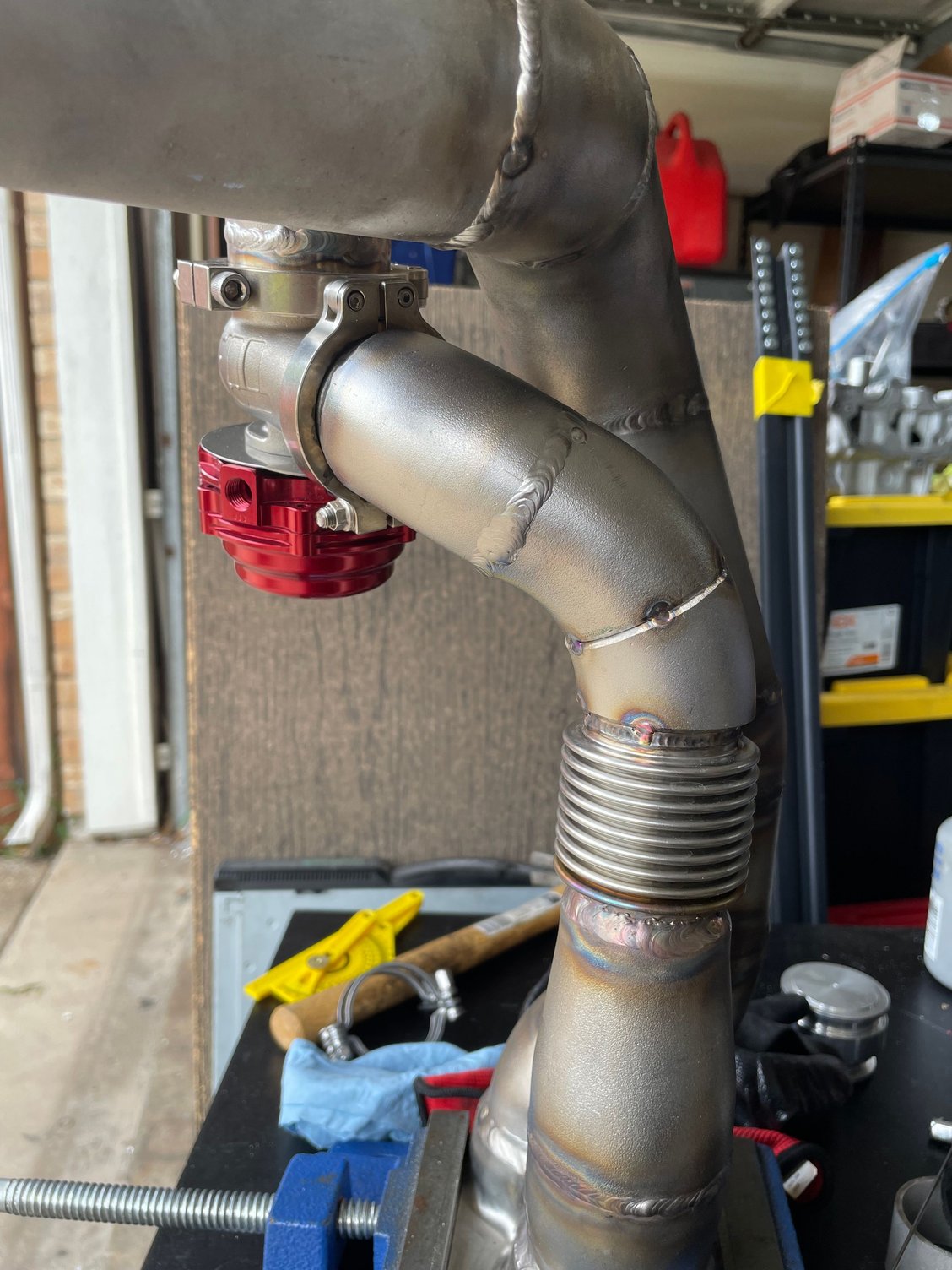

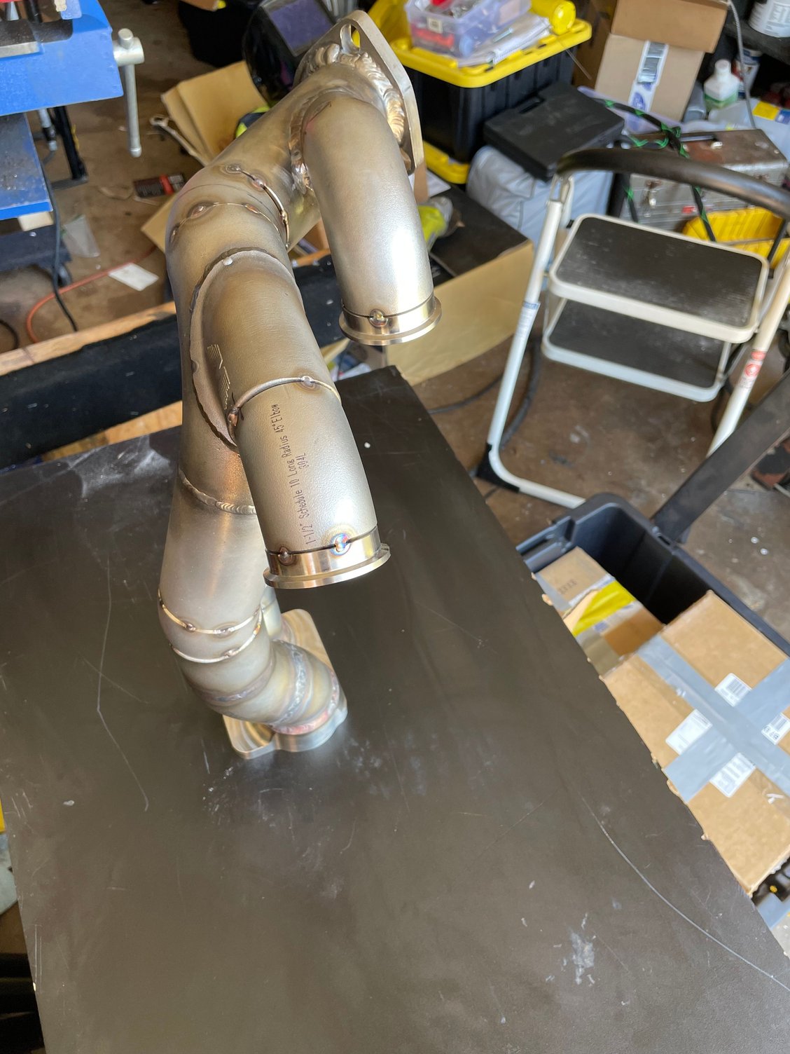

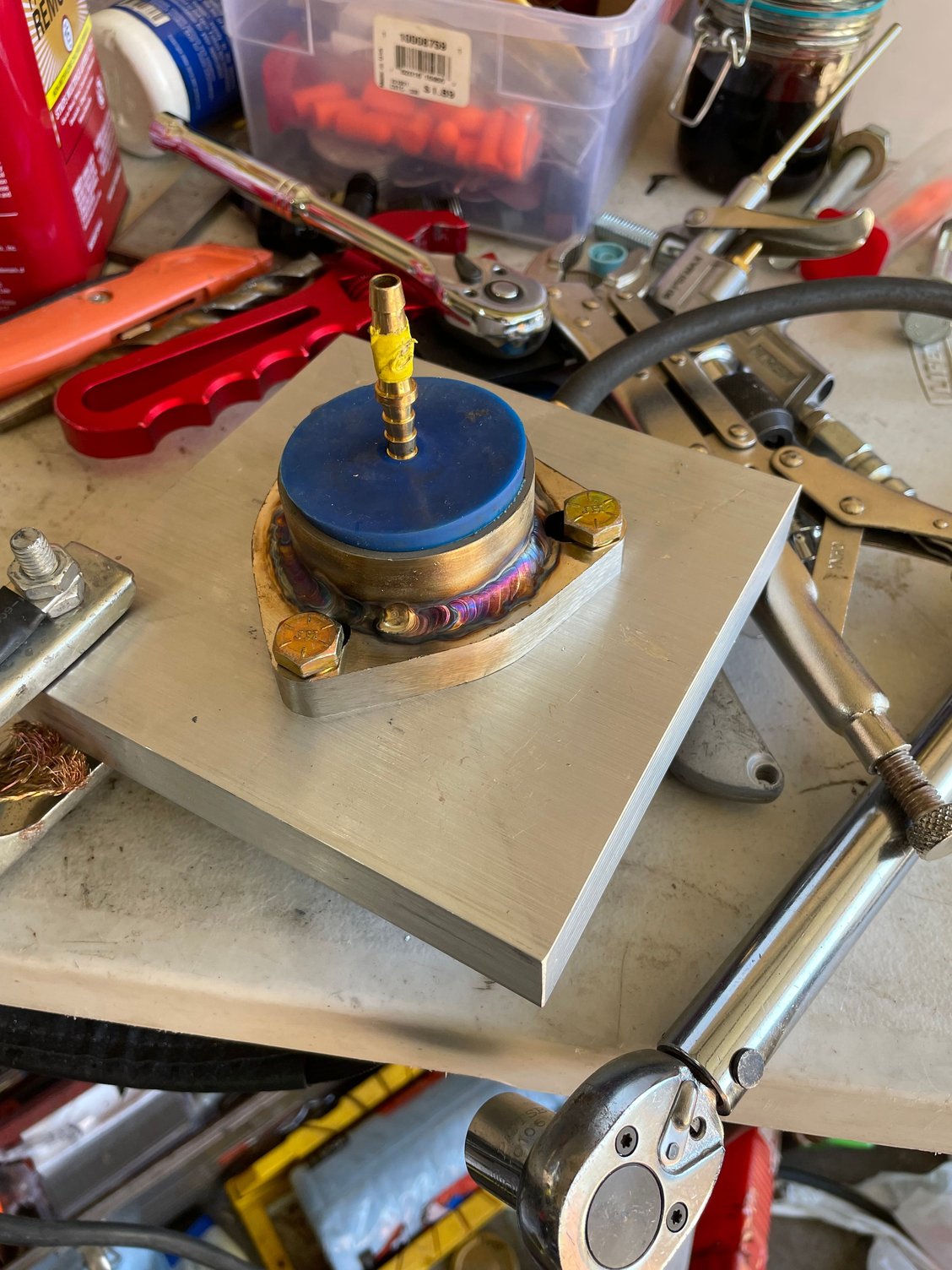

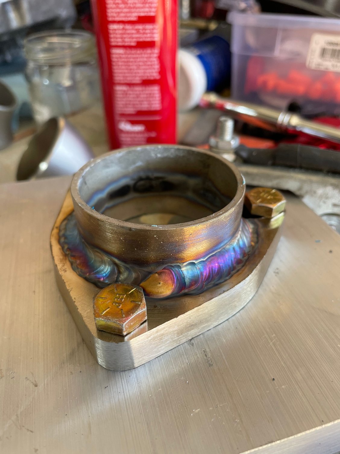

I knew I was going to need to have the lower part of the turbo piping be able to separate from the rest of the piping or it would be impossible to install so I opted for the 3 bolt flange from acereceparts and ordered a block of aluminum so I could make a purge block/heat sink

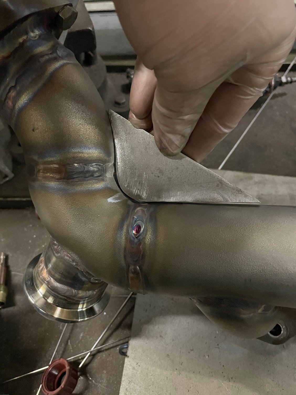

I drew out the flange drilled holes and milled it for gas flow out
It worked really well and kept the flange from warping
I welded the outlet flange, passenger merge, and a support bracket to the drivers manifold

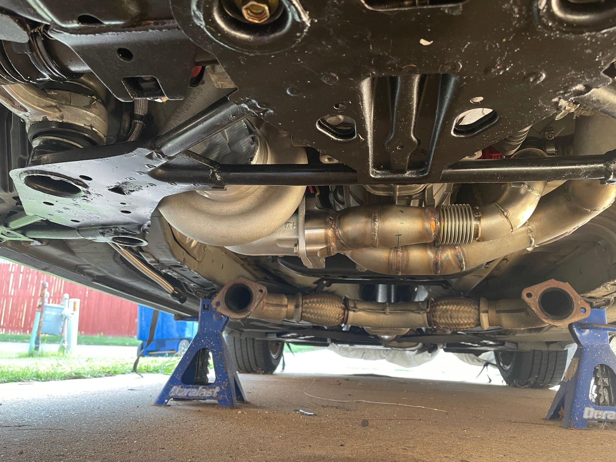

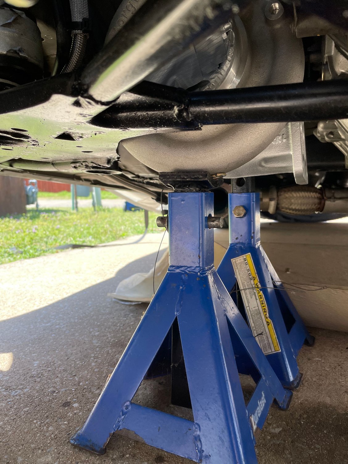

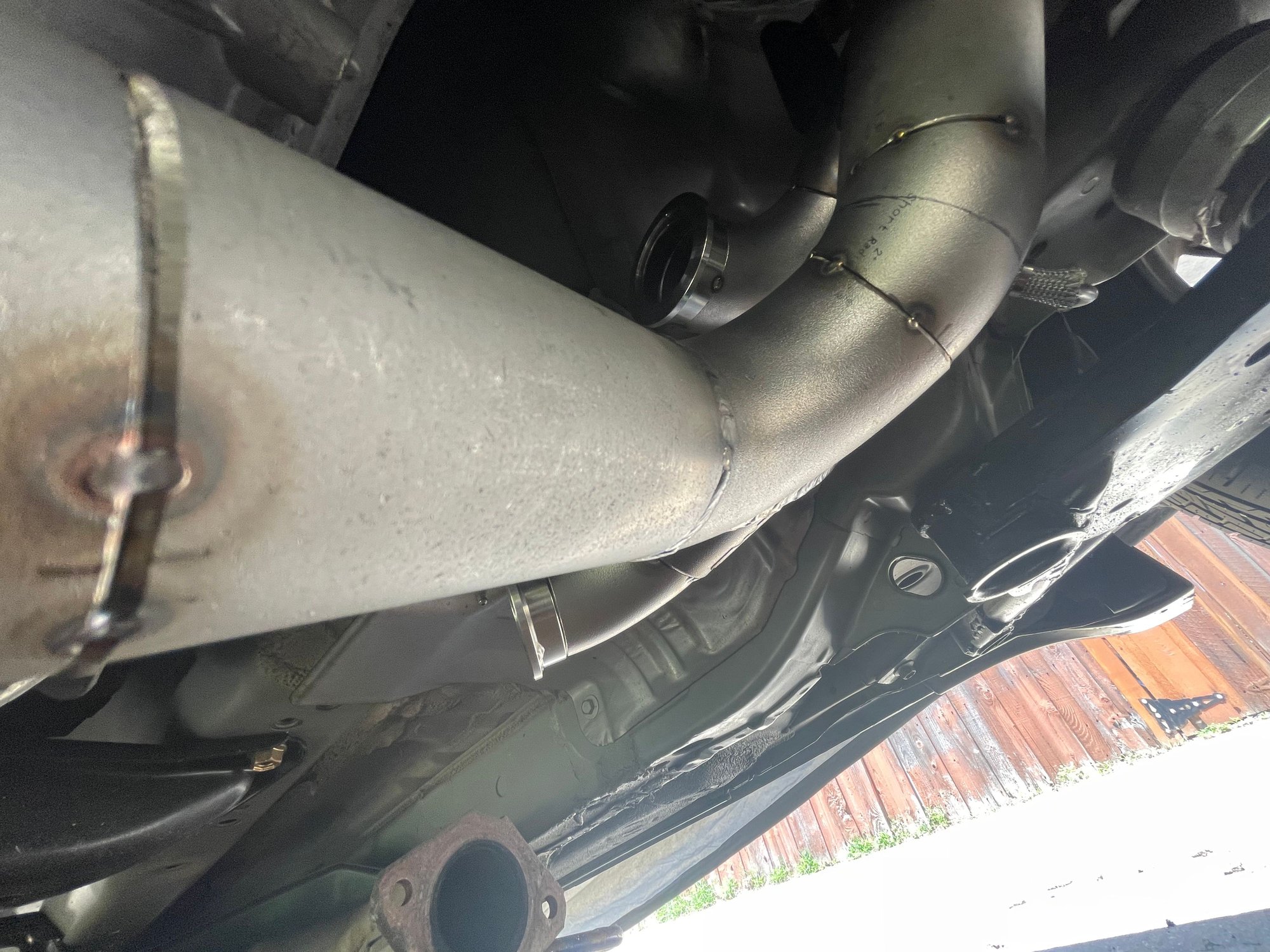

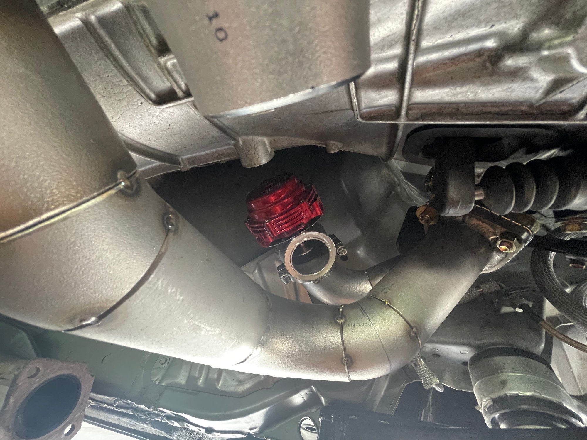

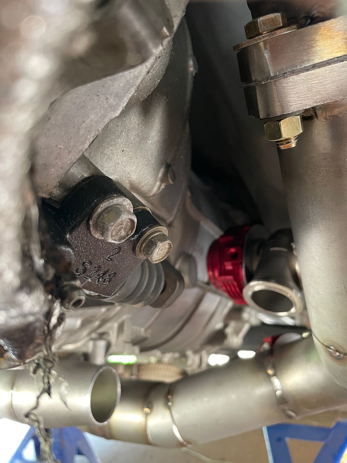

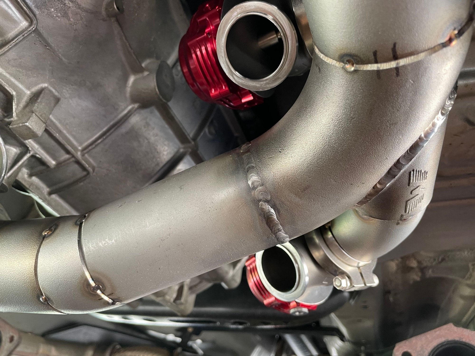

I build a jig for the turbo mount and fabricated most of the lower piping, I am still using both Tial wastegates however only one will be used for actual wastegating, the other is being used as a spool valve which will stay closed until the turbo is spooled forcing all the air initially into the small scroll of the turbo
Here are a few pictures of the lower piping fitup, the open port on the turbo flange is where the spool valve will feed into the turbo but I am waiting on a special flex coupler before I can complete the plumbing here
This is the position of the spool valve
Here you can see both wastegates in position

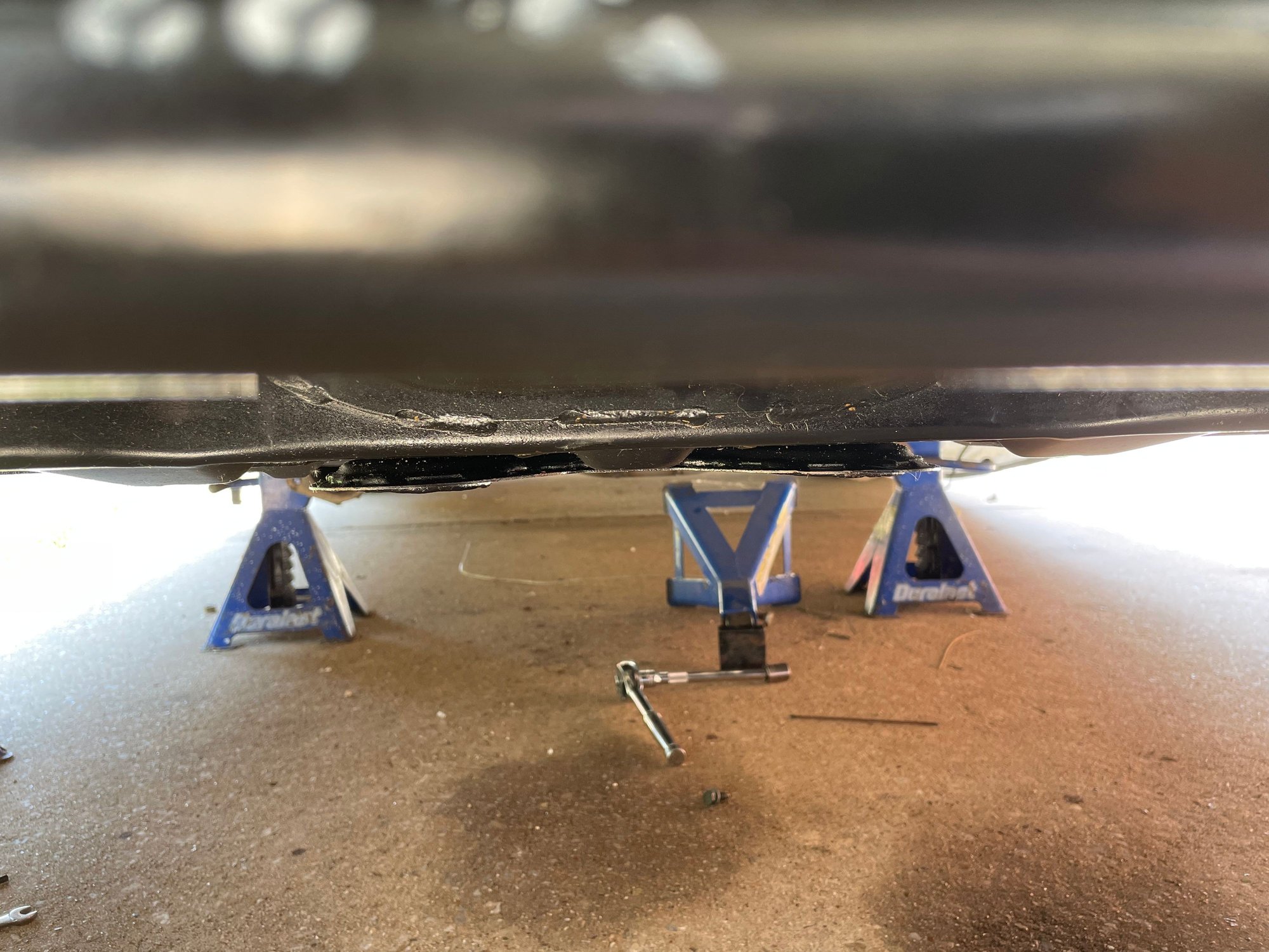

I plan on putting a support bracket here to help with the weight of the turbo and manifold but I’m going to wait until everything is welded up, it’s already tight in there and it can wait
This is an in-line view of the bottom of the car to show clearance you can see that the only part that drops below the chassis is the hump around the belly of the trans

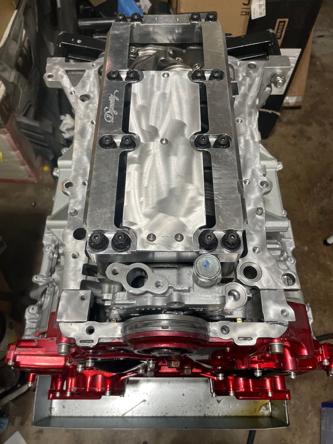

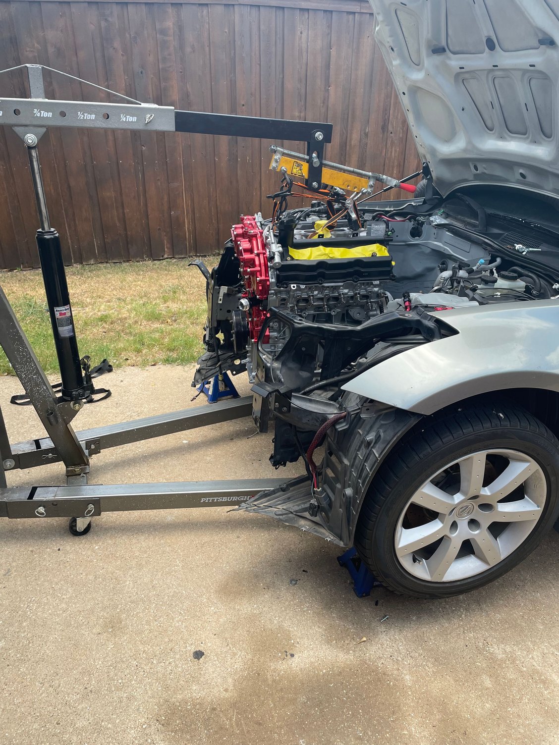

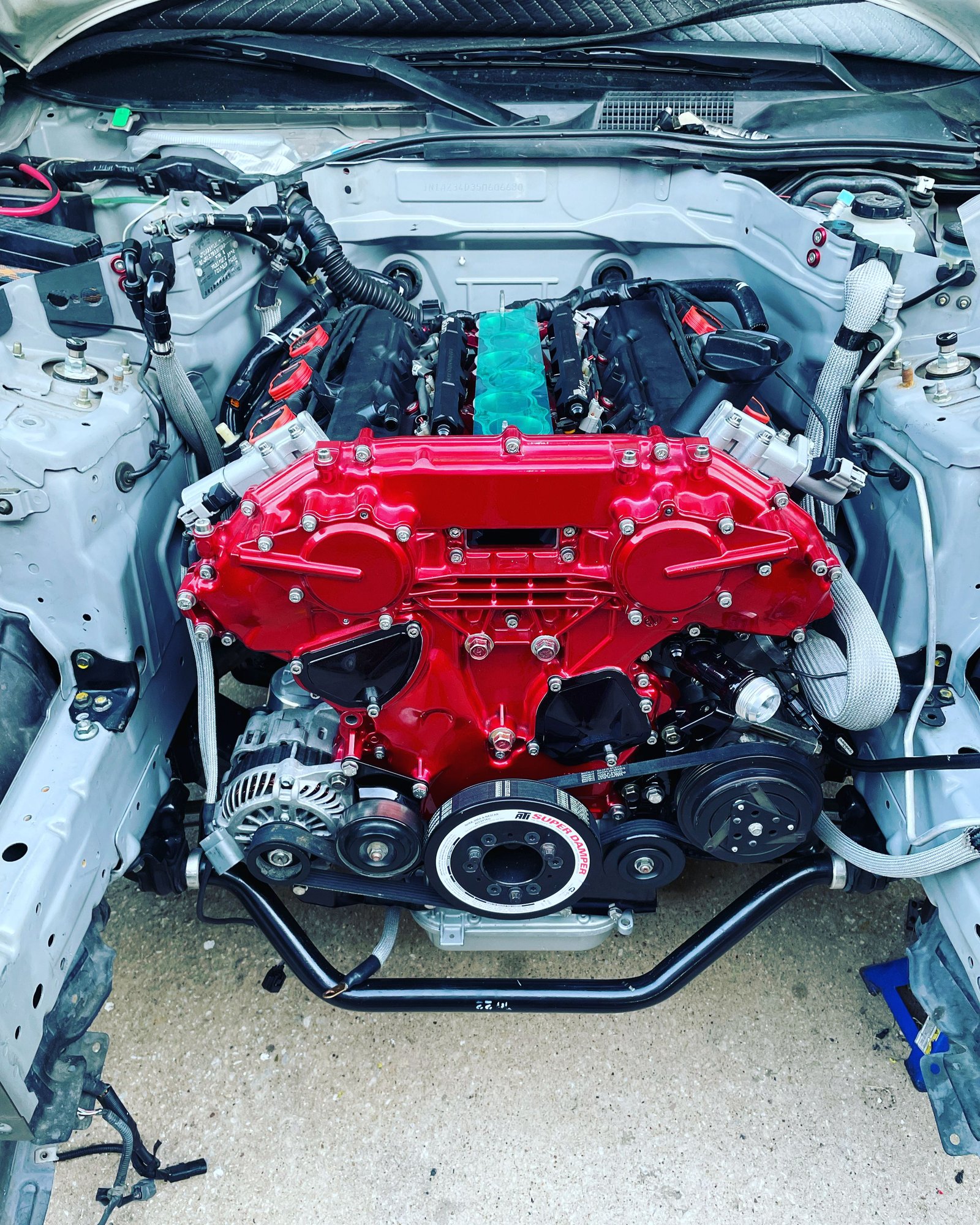

Took a brake from the turbo stuff for a bit as I finally got the new heads back from the machine and painted. Decided I wanted to get the engine assembled and back in the car and running before it gets too hot out
I did shorten the windage tray to only the first 4 cylinders, I was having clearance issues with the oil pan I wasn’t happy with
she still isn’t running yet but I hope to get her moving this weekend

I like the windage tray - thought about doing something similar but I didnt want to drill / tap the girdle but yours looks great!
Nice progress! Keep the updates coming!

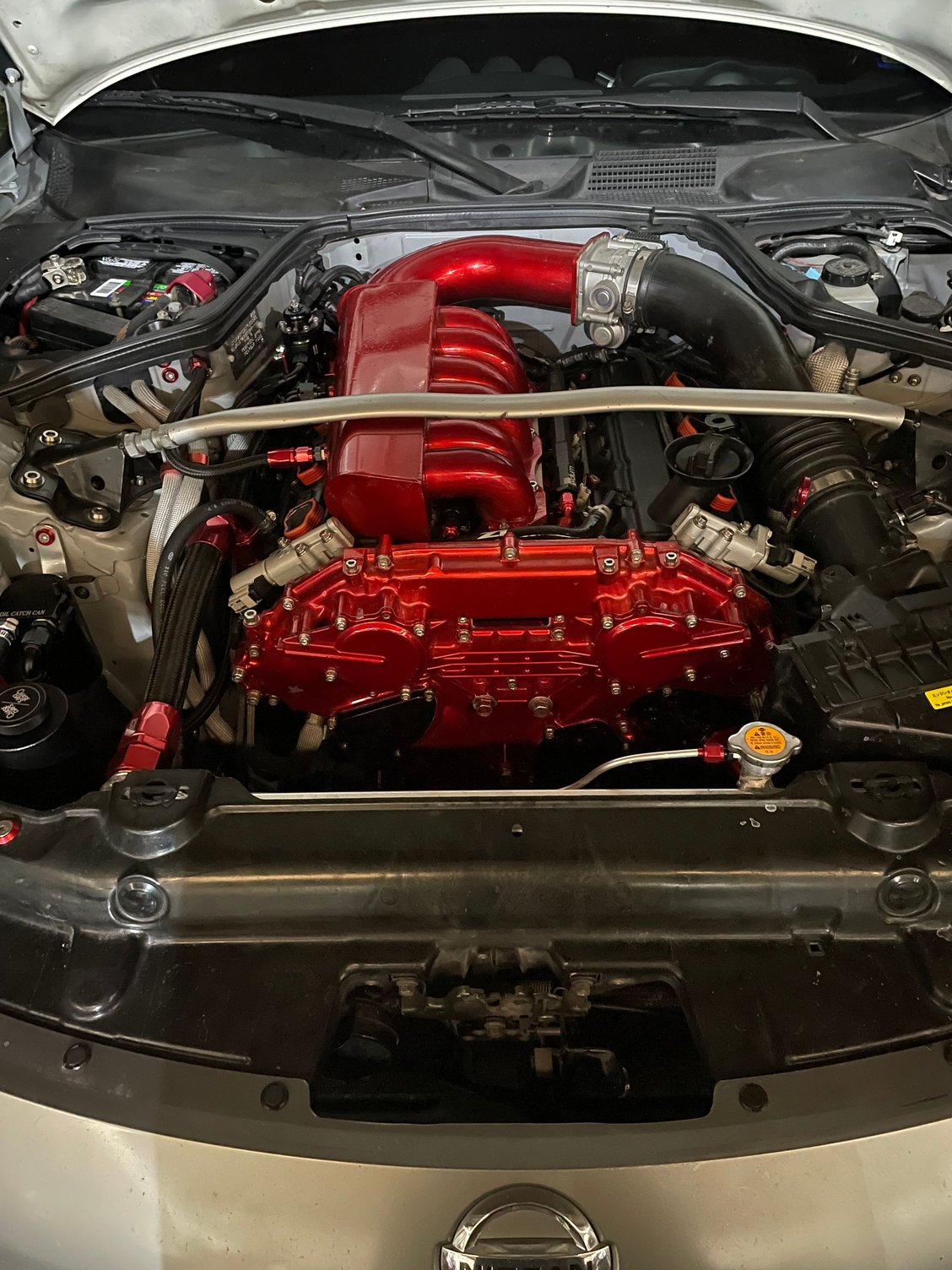

Engine is in and running but I’m still experiencing low oil pressure, at this point I don’t know what to think… looks like once it heats up its sitting at 10-15psi. it was never that low before the engine blew. I’m somewhere between buying an aftermarket gauge to verify or dumping the car at a used car lot

I should also note that I’m not using a standard oil pump. I’m using a boundary pumps blueprinted oil pump with a higher pressure setting
