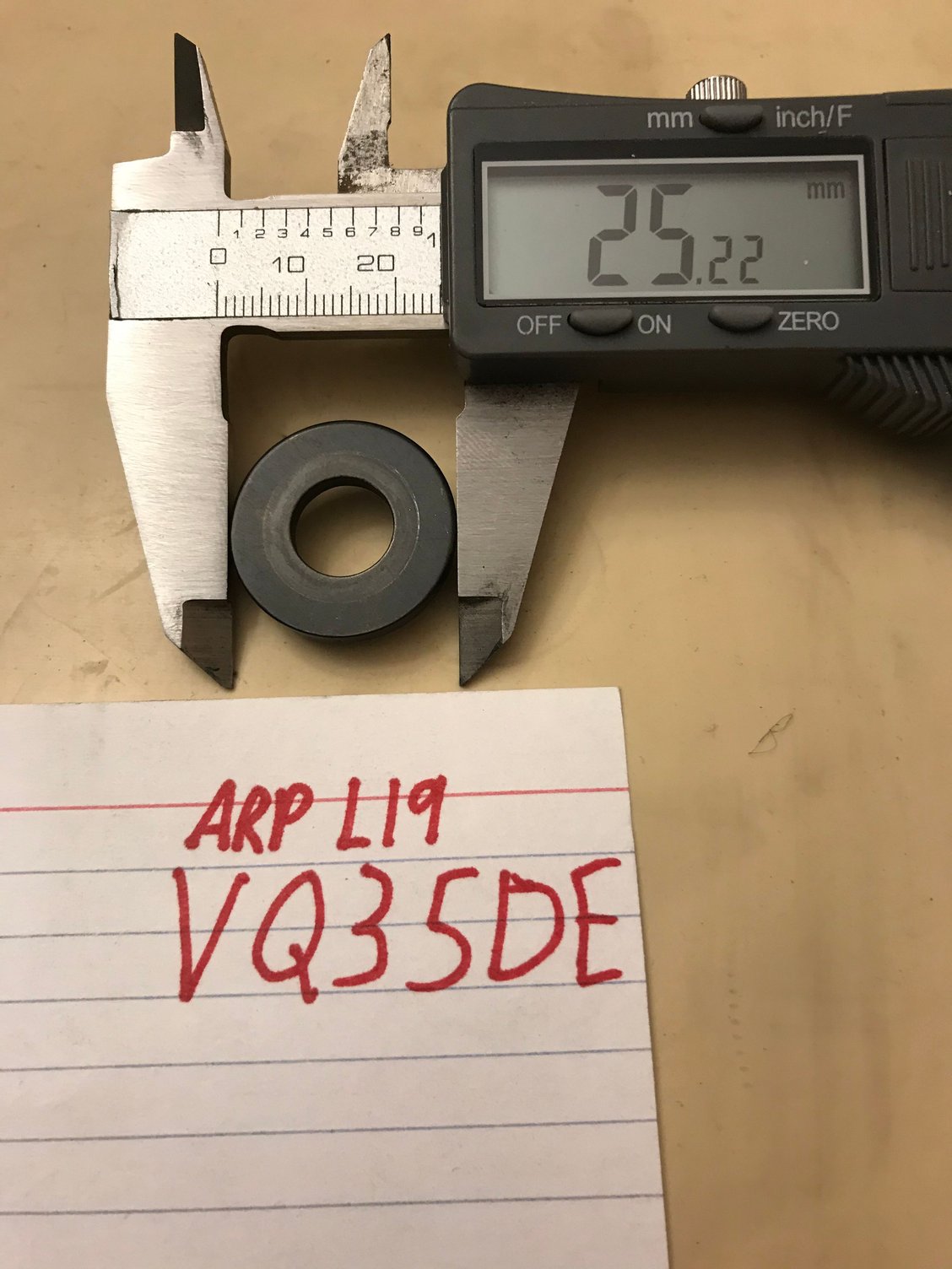

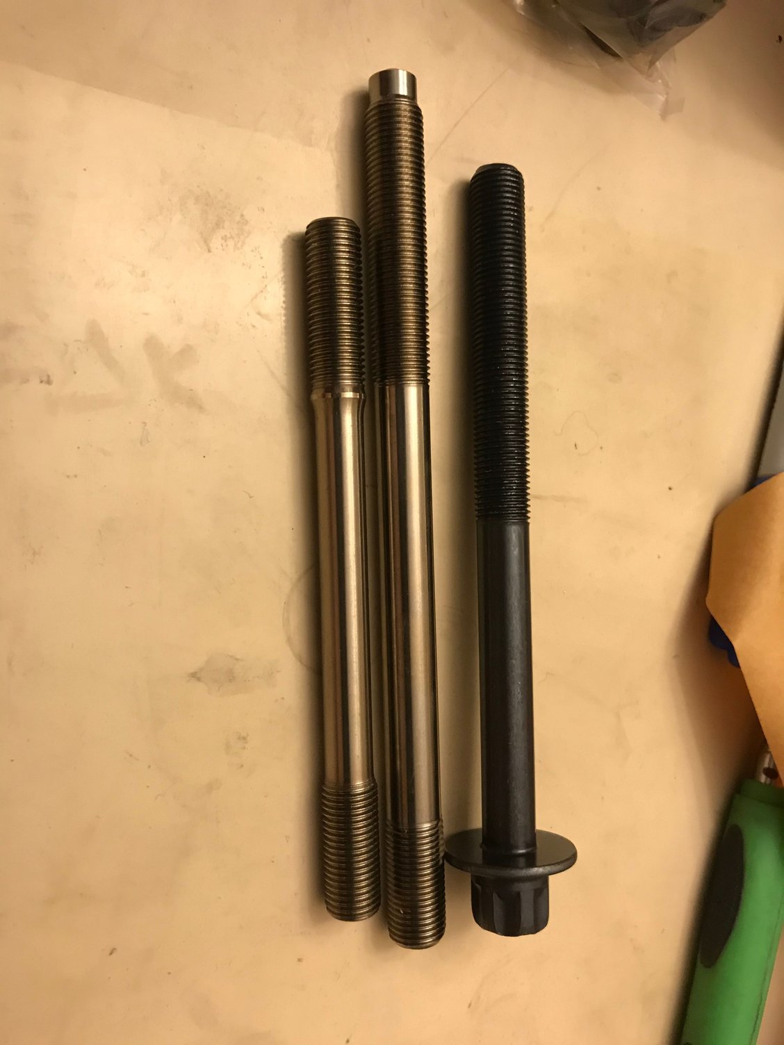

Ok it’s been a hot minute since I updated this and I’ve got some juicy stuff for all you high hp guys, the VR38DETT ARP L19 studs came in. To start off with I took some initial dimensional information as a comparison to the VQ35DE ARP L19 studs

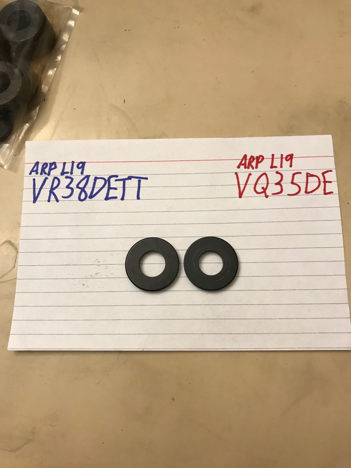

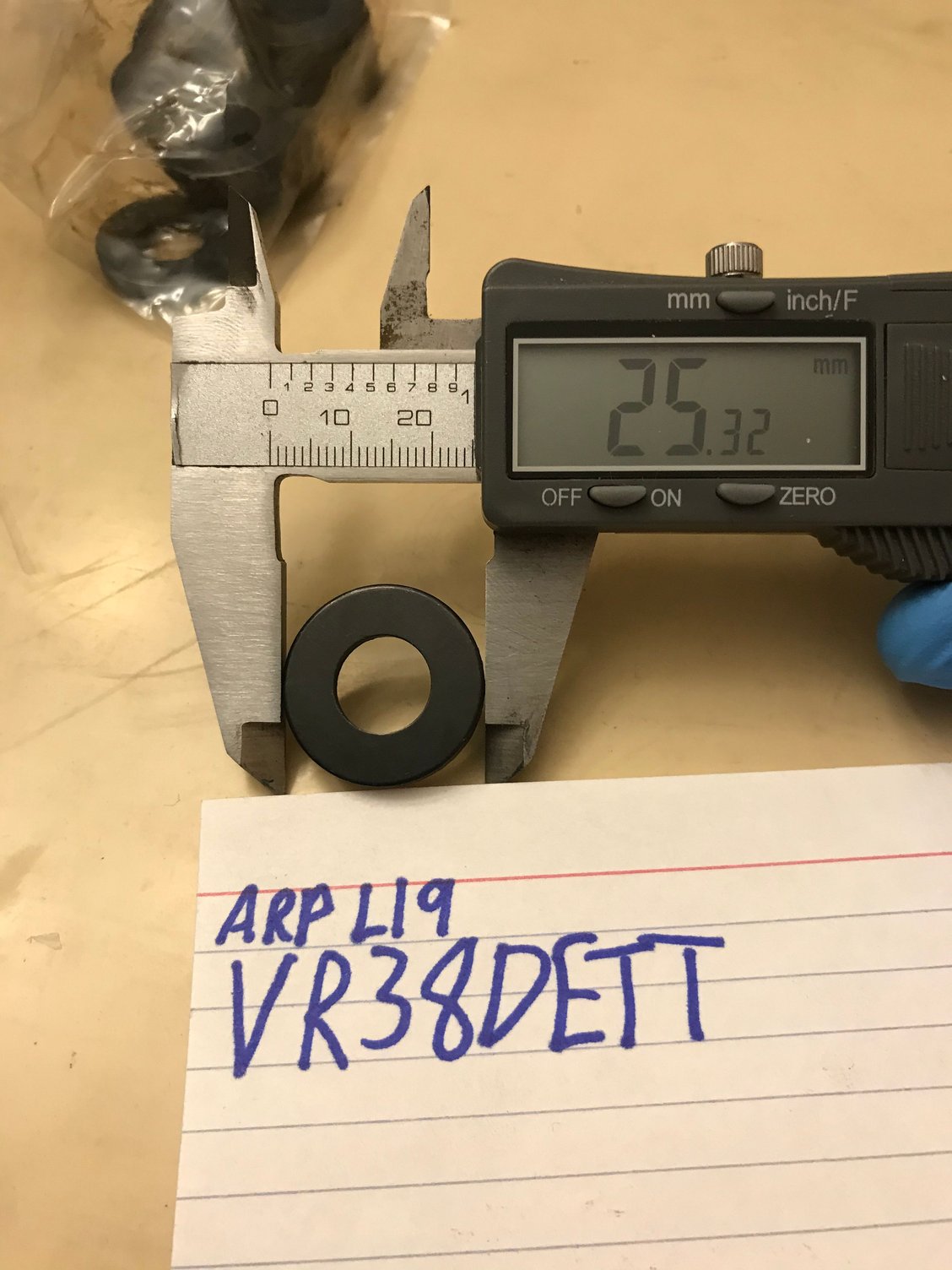

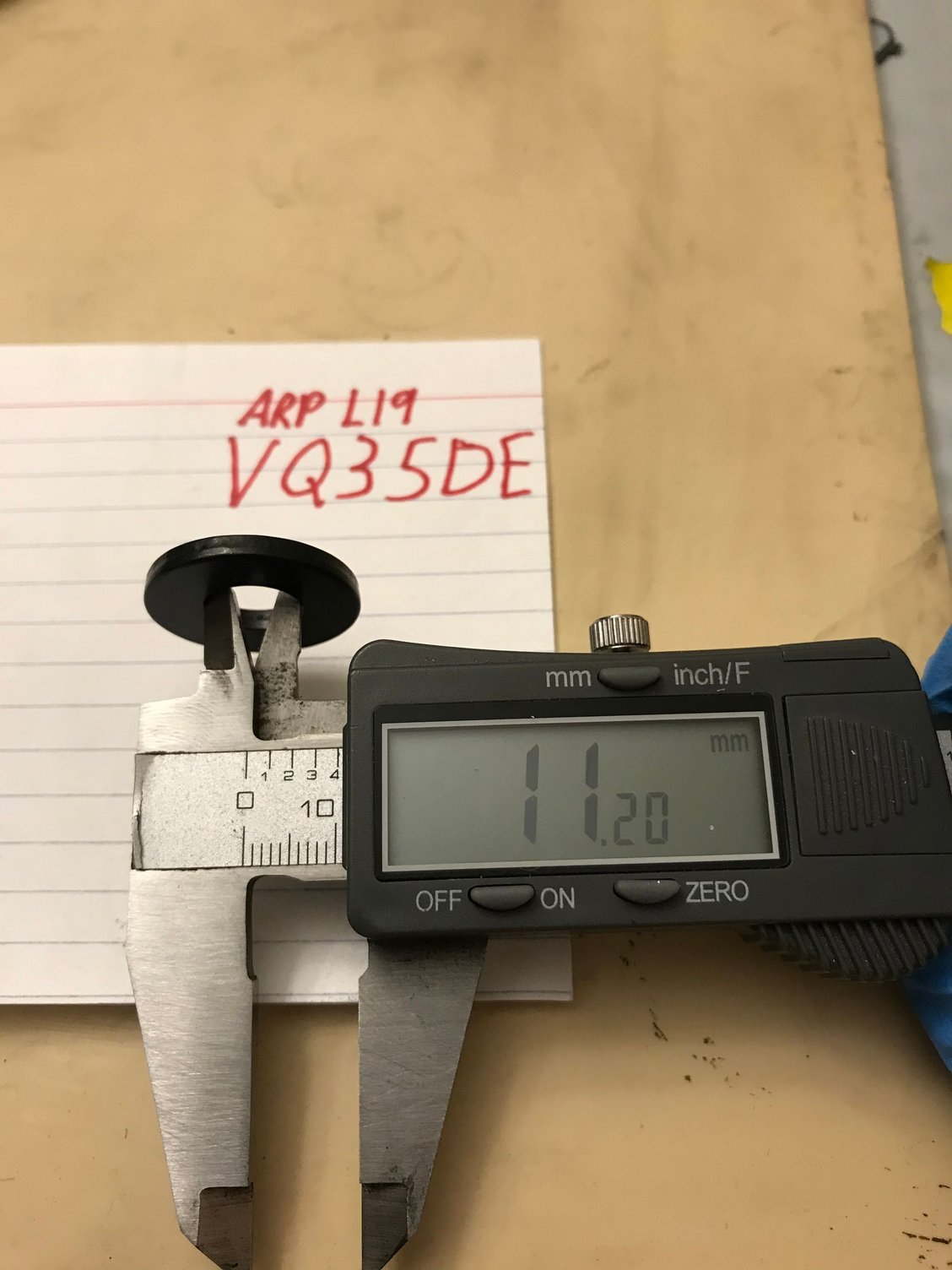

To start off here side by side visual comparison of the washers used in each kit
Their outside diameter is basically the same and the washers from the GTR kit will fit in the machined holes in the VQ35DE cylinder head no problem
Obviously the GTR stud is larger and so then is the washer inside diameter

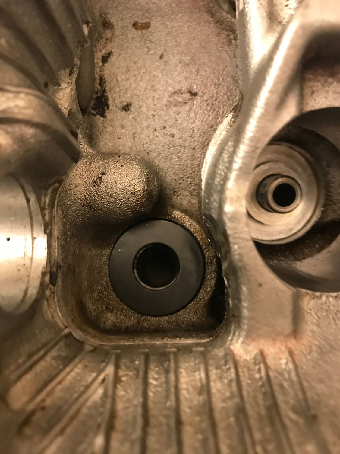

Washer from GTR L19 kit in place in the VQ35DE cylinder head, and you might be wondering why I would even check? And the answer is that the OEM GTR head bolt had a larger flanged neck which does not fit into the little machines spots in the head without flushing the surrounding area with the bolt surface. Also there is a little interference with the actual cylinder head casting that holds the lifter buckets that you would have to grind down if you decided to use them

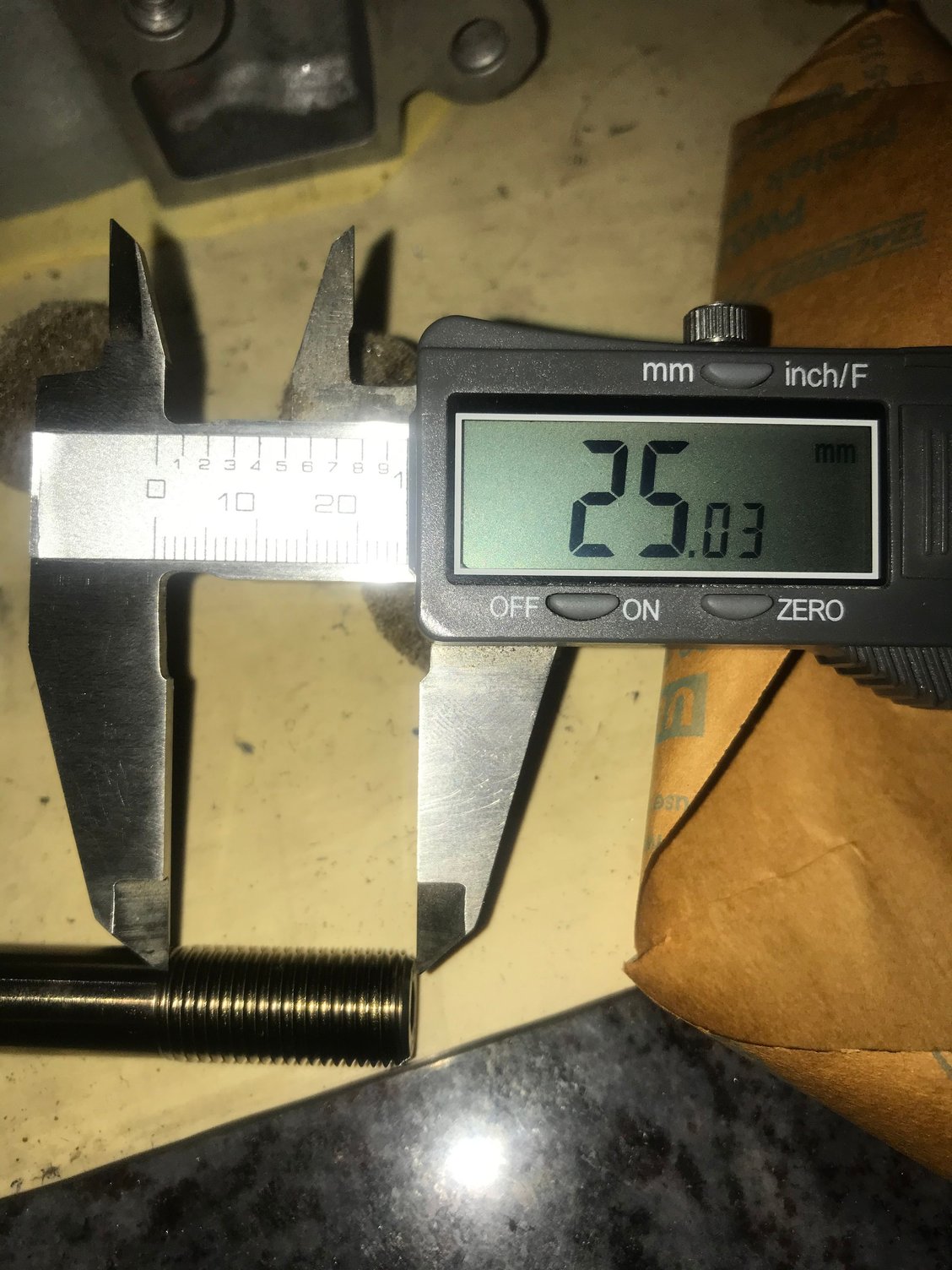

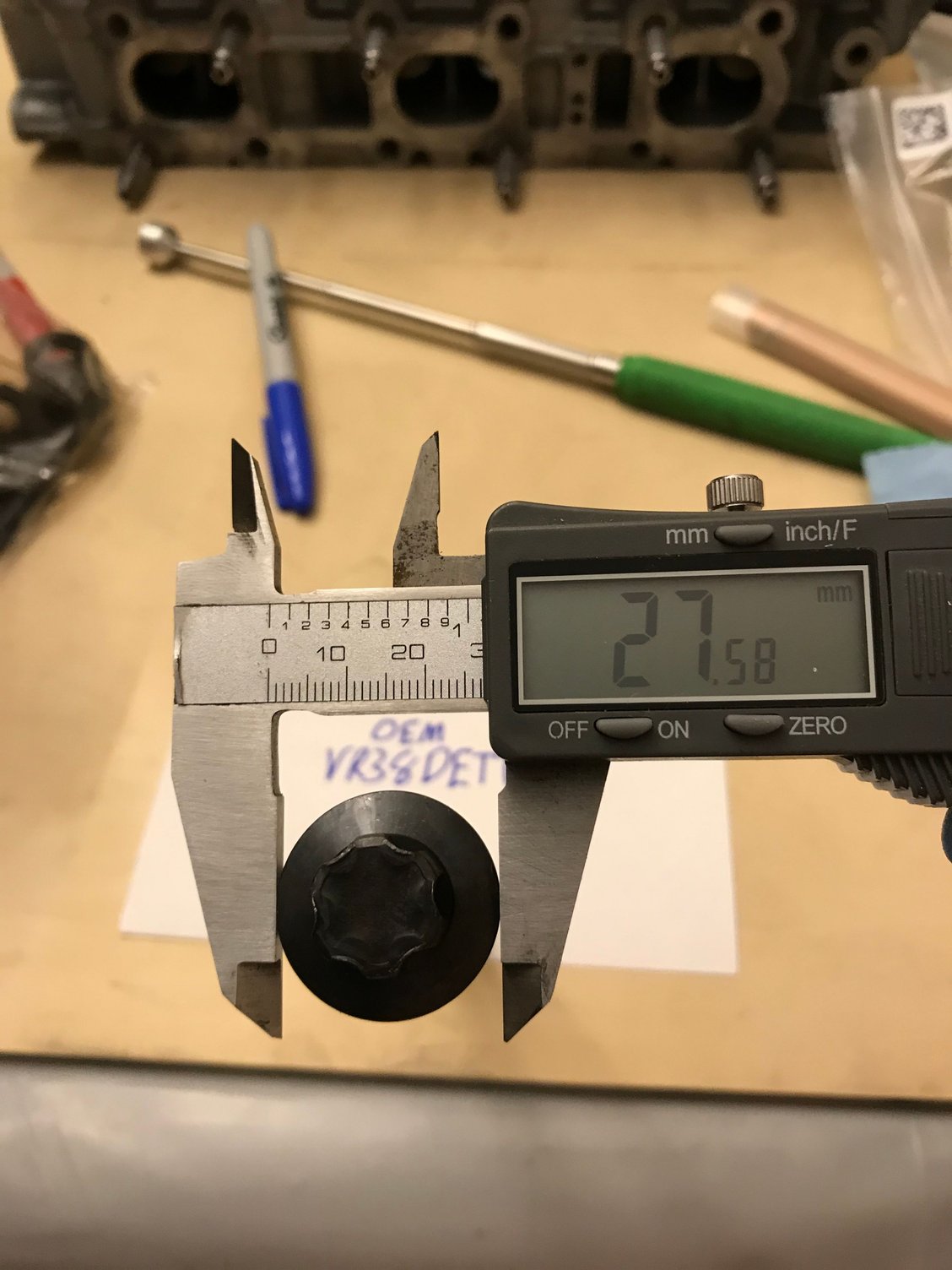

I happened to have a few unused GTR studs so Here is the head measurement and as you can see it’s only a few mm larger but because of how long the bolt is and how large the bolt head diameter is if you don’t mill out a little bit of the casting for the lifter guide around the bolt hole you won’t even be able to insert the bolt all the way

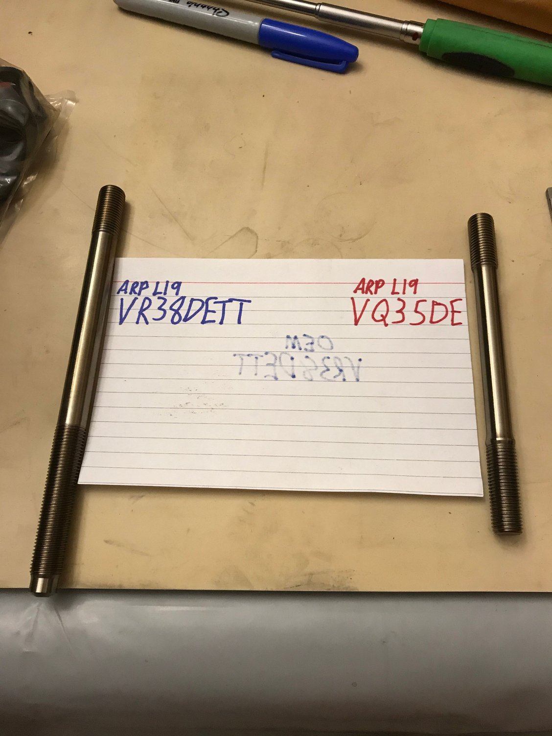

Side by side comparison of the VR38DETT and VQ35DE studs

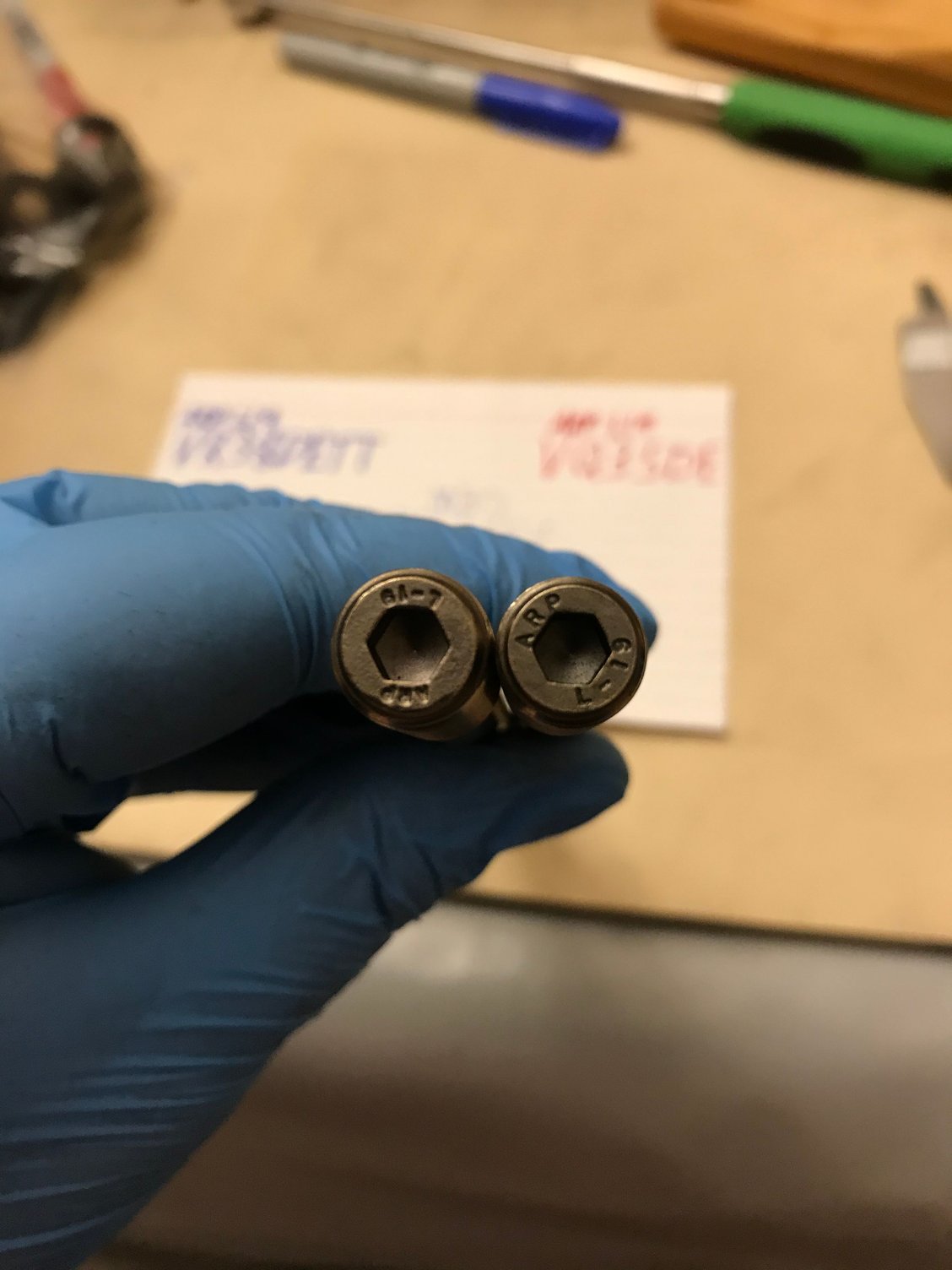

Compared the the VQ stud with the 3/16 Allen key The GTR stud hex is slightly larger and a 5mm Allen key is perfect for easy installation

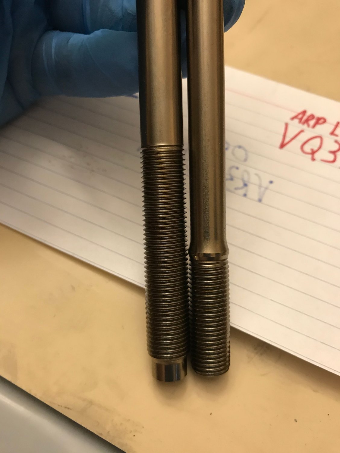

The GTR stud threads are longer than the VQ stud threads. This is the portion that threads into the block. the length of the GTR stud is significantly longer than the VQ stud, so at least the holes for the 2 front and 2 rear bolts for each head need to drilled 2-3mm deeper into the block to clear the camshafts and the holes must be threaded all the way to the bottom

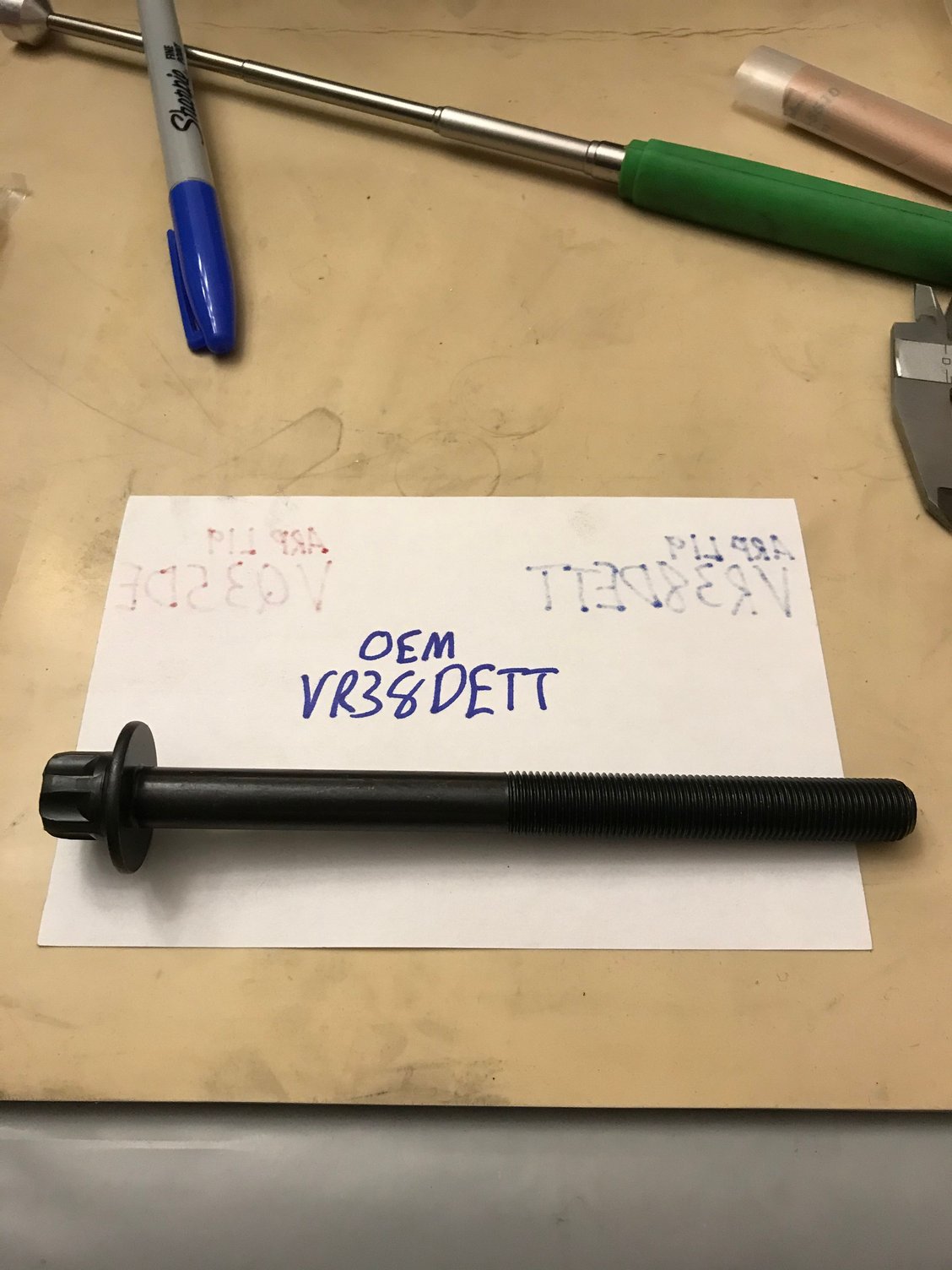

Side by side comparison of the VQ35DE L19,VR38DETT L19, and OEM GTR bolt

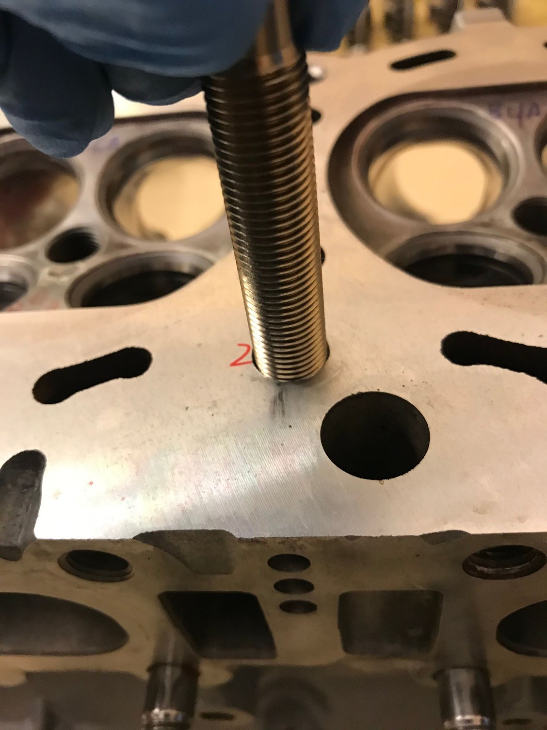

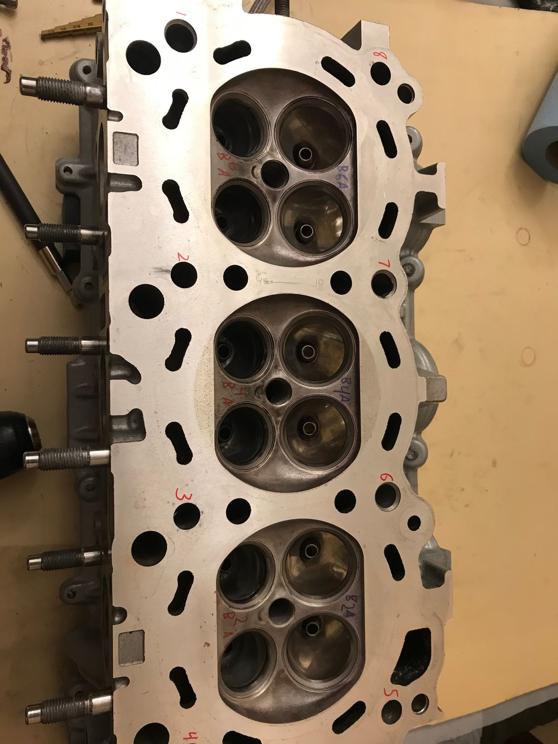

So the stud holes in the head are actually not large enough for the studs to fit through so they must be enlarged

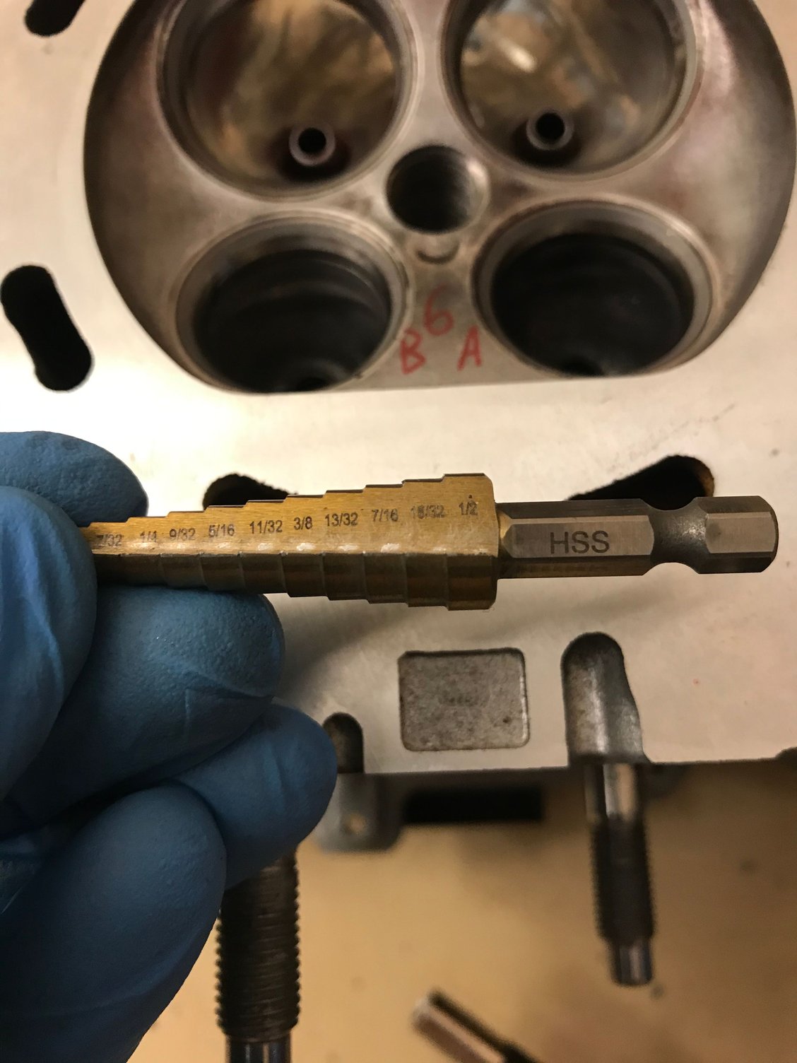

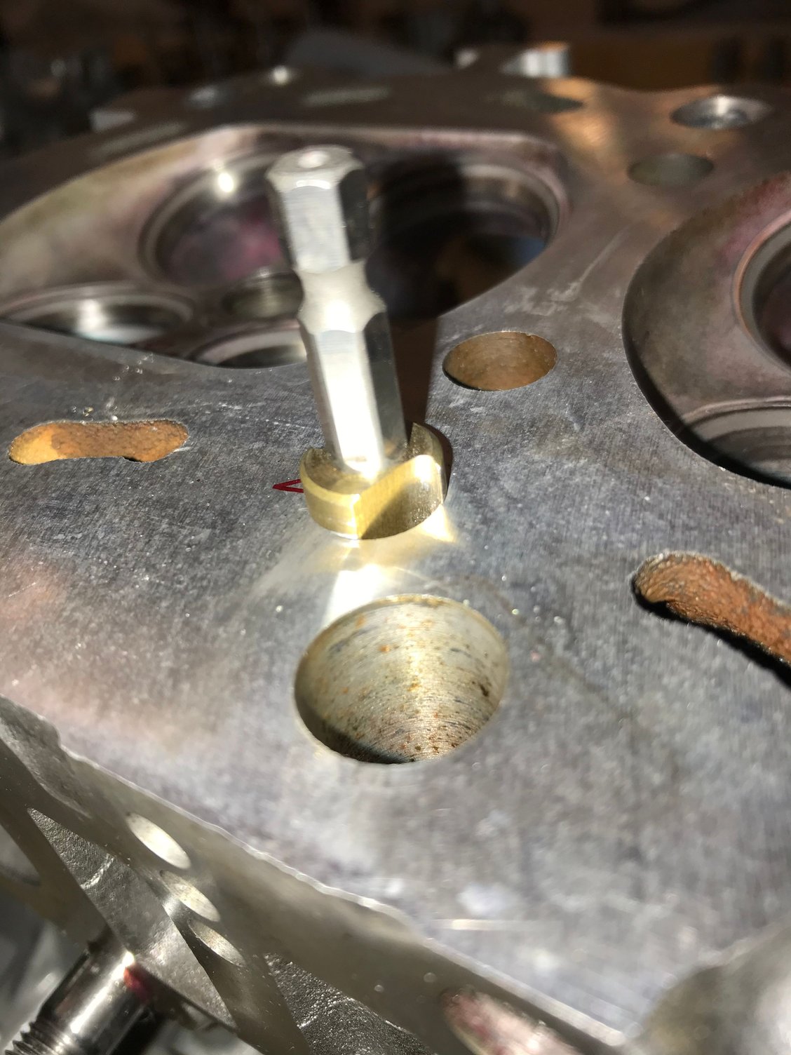

I decided to use this step bit and drill the holes very slowly by hand. The final step is 1/2” and the step right before it is the exact size of the OEM hole so it works like a guide
It’s a snug fit

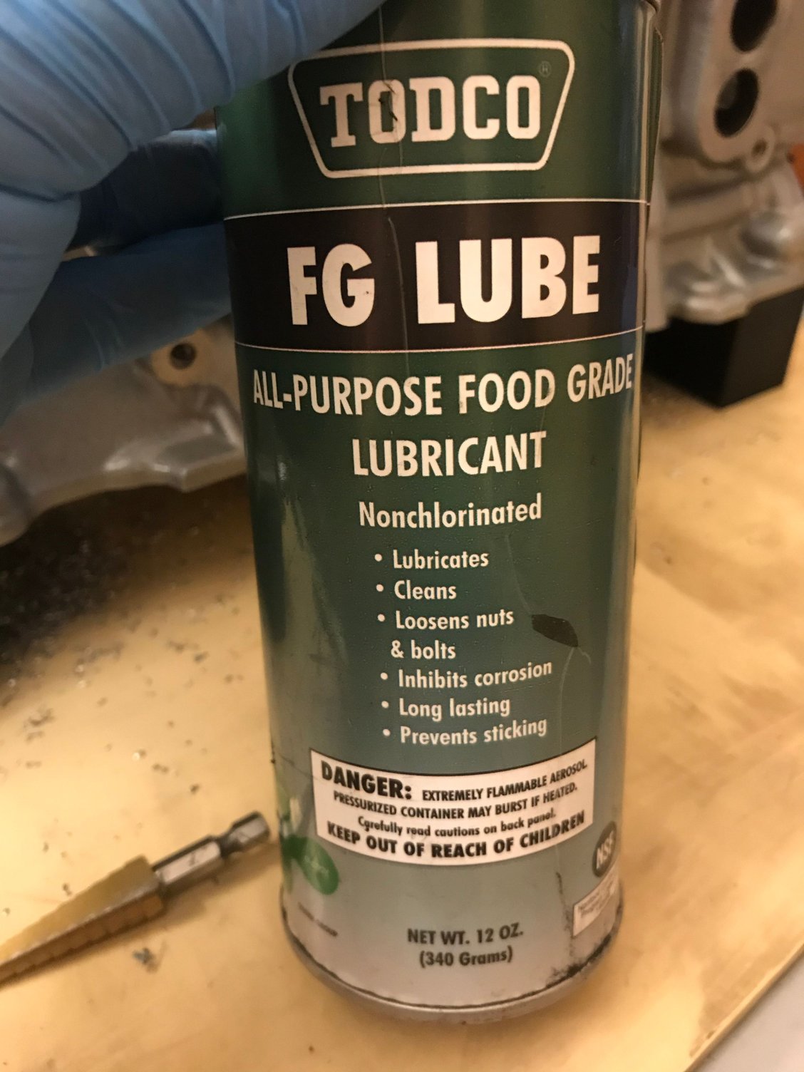

This is what I use in place of drilling or tapping oil. It works really well and is a spray with a straw like WD40

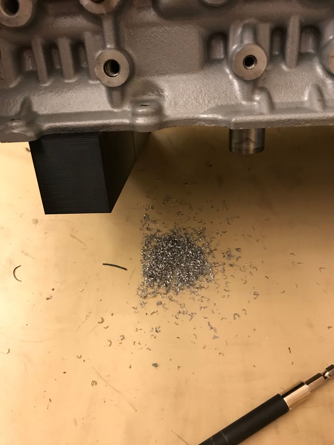

Drilling out the holes even just to the next size up produces a significant amount of shaving. I decided to complete disassemble the heads before doing this to ensure I wouldn’t have any lingering shavings later
1/2” hole is a perfect fit
Not a noticeable difference in size really but it will allow us to do what needs to be done

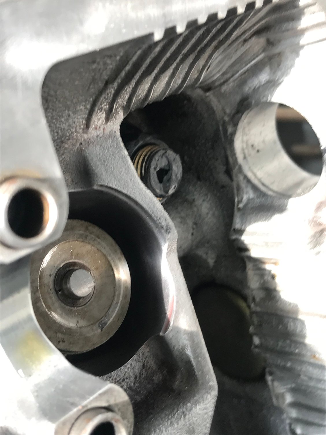

BTW the thread length portion of the GTR stud. Here is where things get messy, the GTR studs are much longer than the VQ35DE studs and although some of that length is taken up in threading the GTR studs all the way into the block the studs are not threaded far enough down to just insert them and go
There are 2 problems one is that the studs sit too high and will contact the camshaft unless the front 2 and rear 2 studs of each cylinder head are set 2-3mm deeper in the block that means that when you drill out the old threads in the block you need to increase the depth of the hole by 2-3 mm. It should be noted that if you go to far coy could drill into one of the oil lines in the block and you don’t want to do that

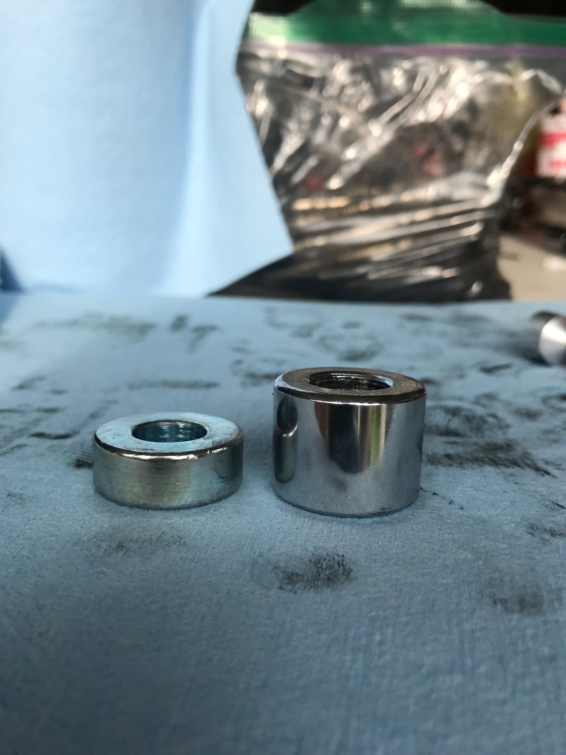

Problem 2 is that with the stud in place the threaded portion for the nut does not go all the way down to the bolt surface on the head, I’m getting around this by ordering 304ss bolt spacers that have a high enough hardness on the rockwall scale that they won’t deform in use
If this is the path you want to follow the dimensions of the spaces I used are 1”od 1/2” id 3/4” length and you can expect to get them for about $19-24 each and you will need 16

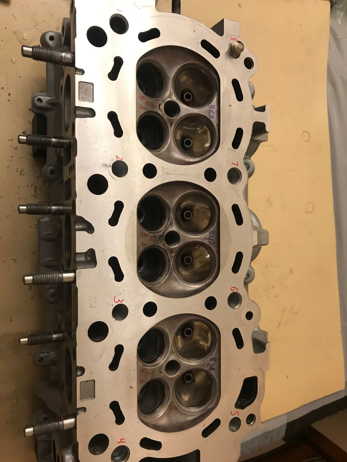

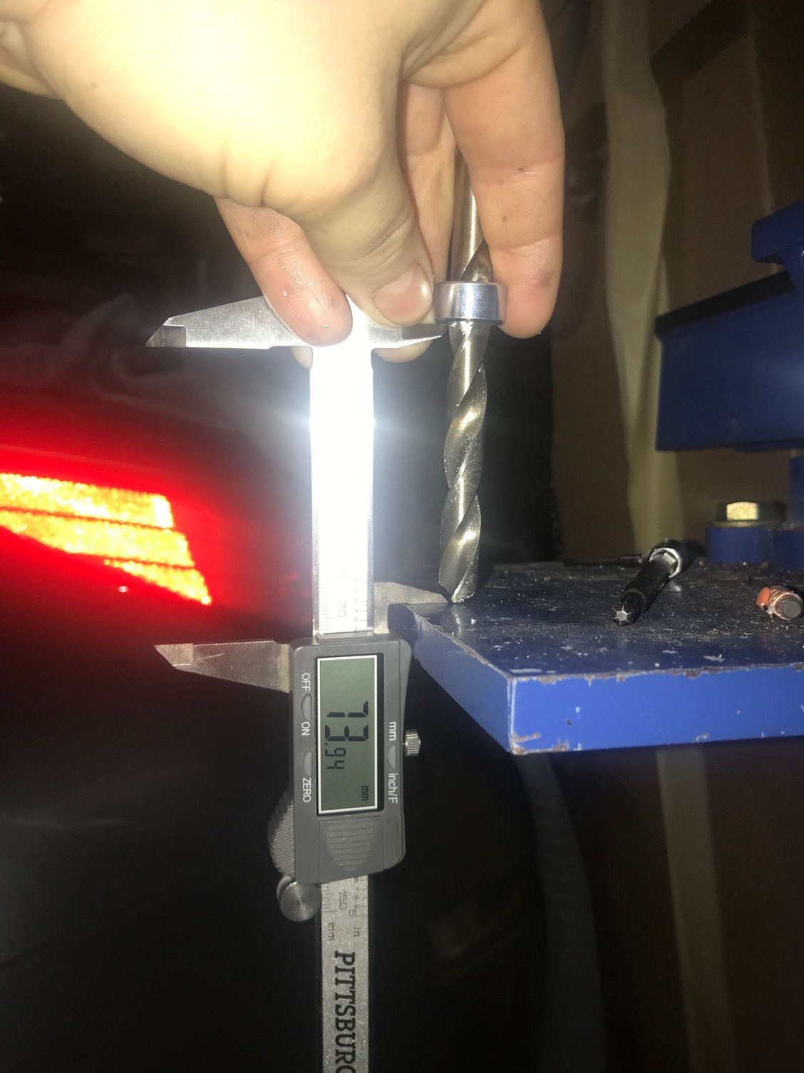

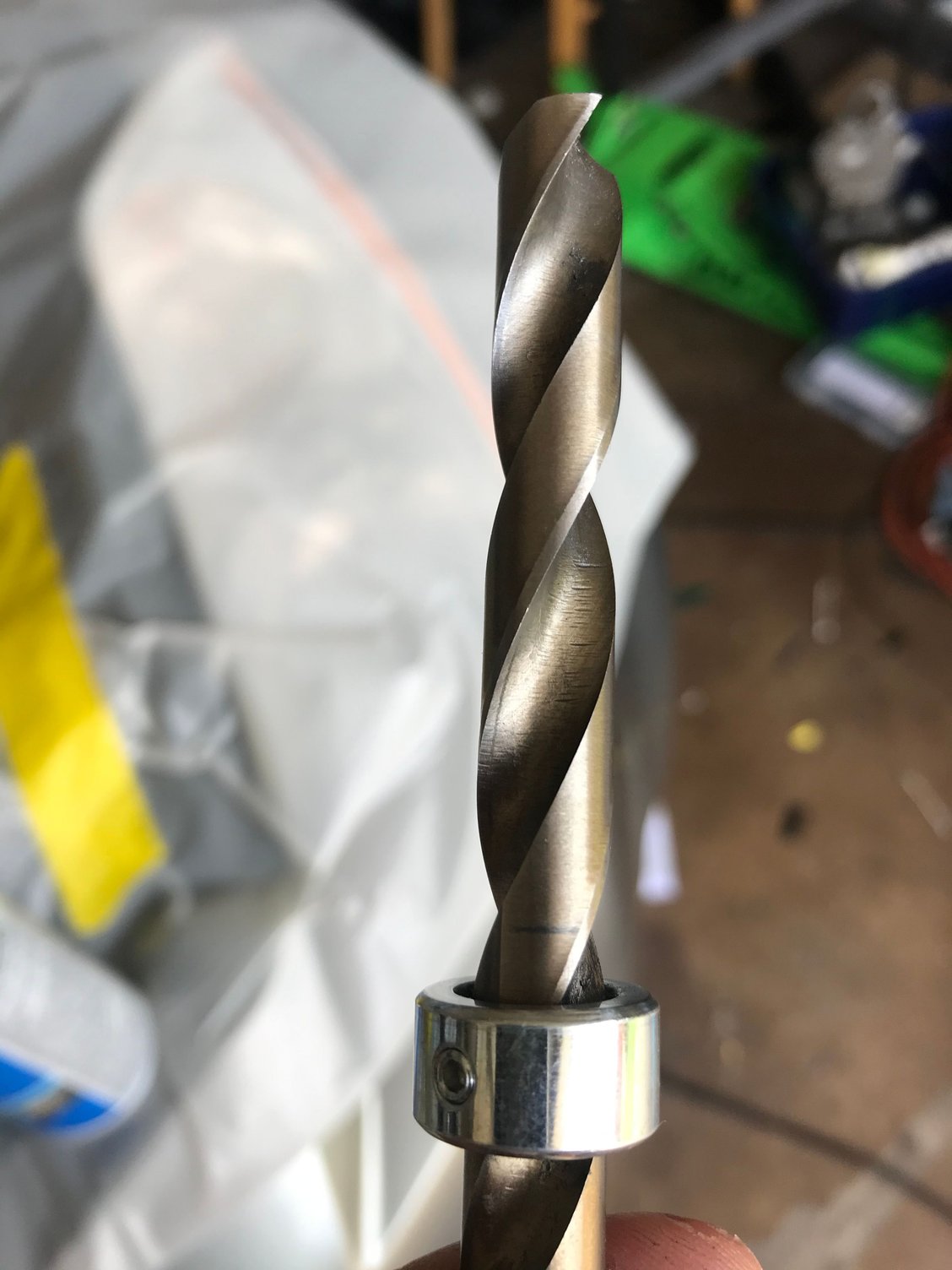

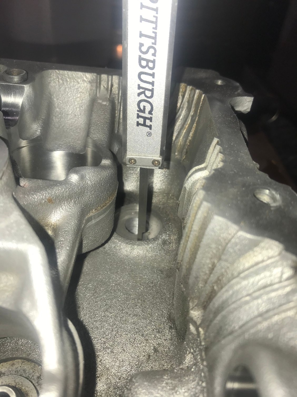

drilled out all the old threads from the stud holes and managed to drill deep enough to set the studs away from any valvetrain interference
I set the stop on the bit at 74mm but with the head gasket in place to protect the deck the hole depth is probably around 73mm
The small line just above the stop on the bit is how deep the hole is from the factory so you can see roughly how much deeper I’m drilling the holes

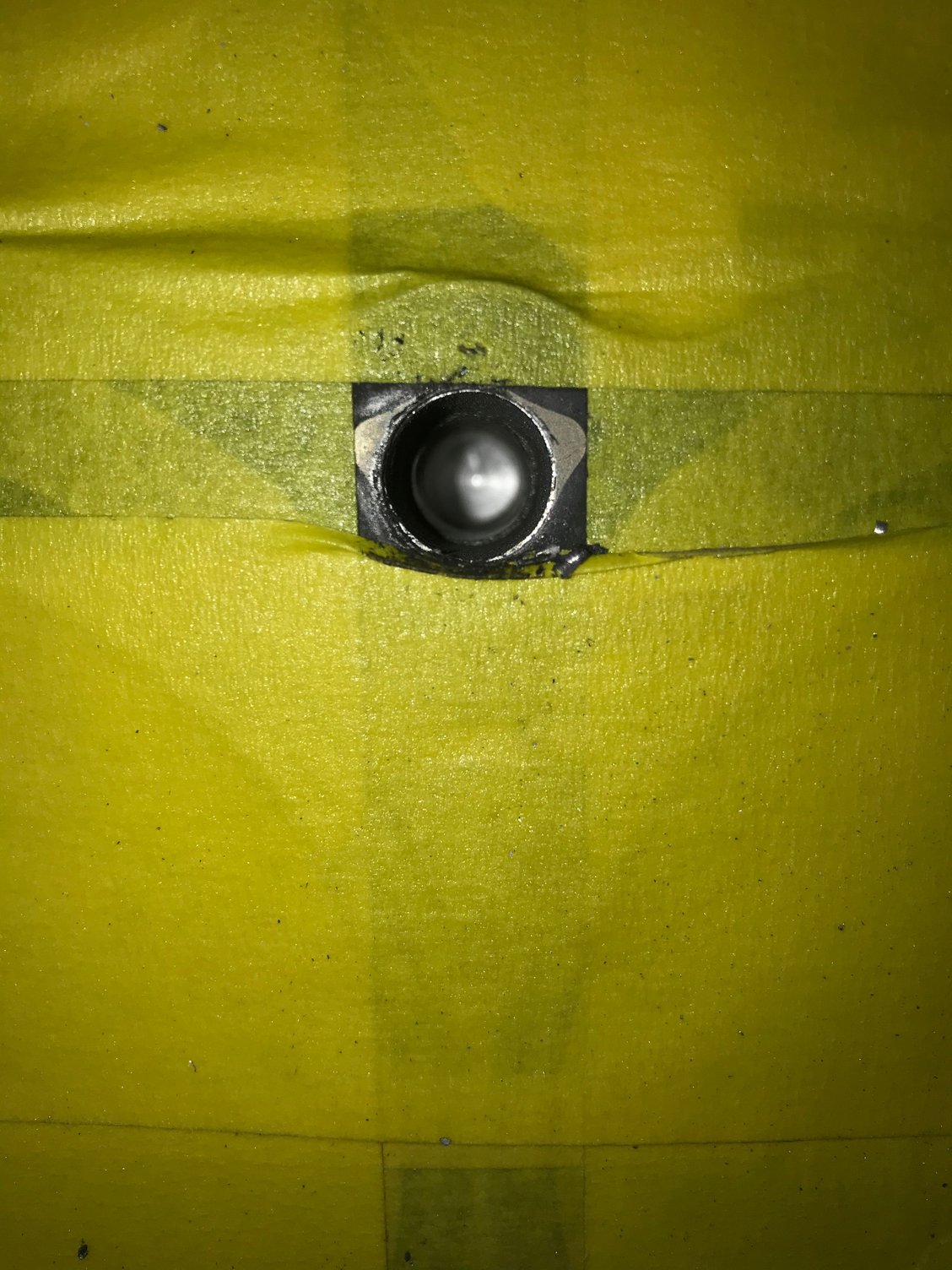

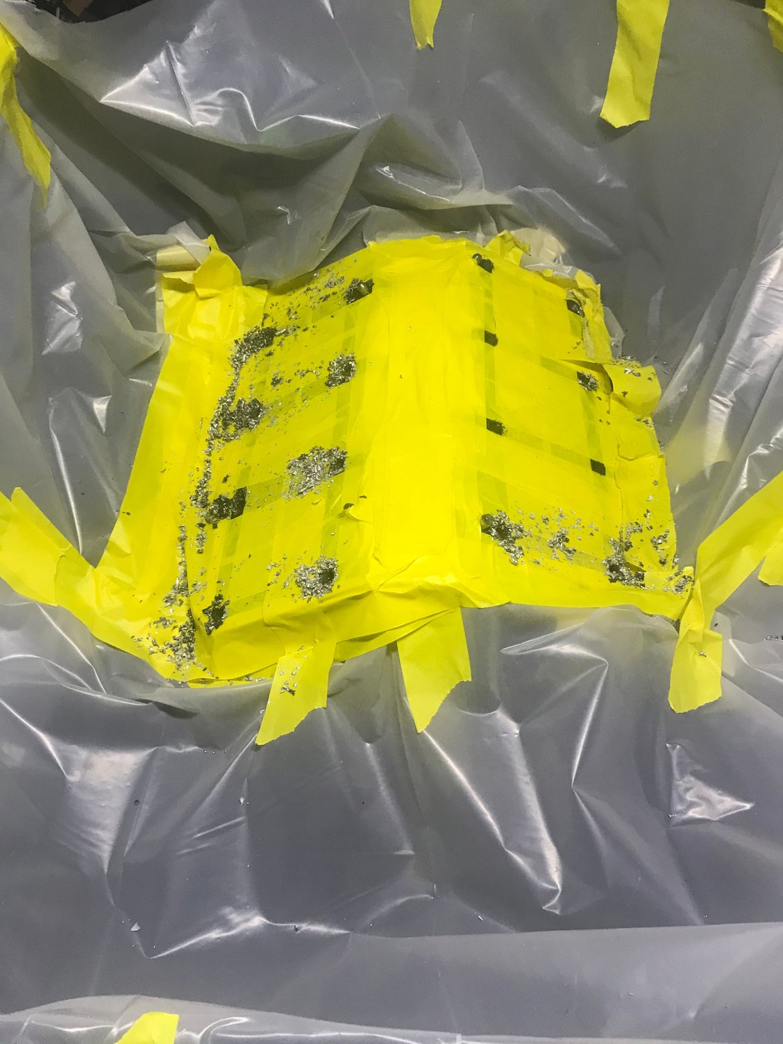

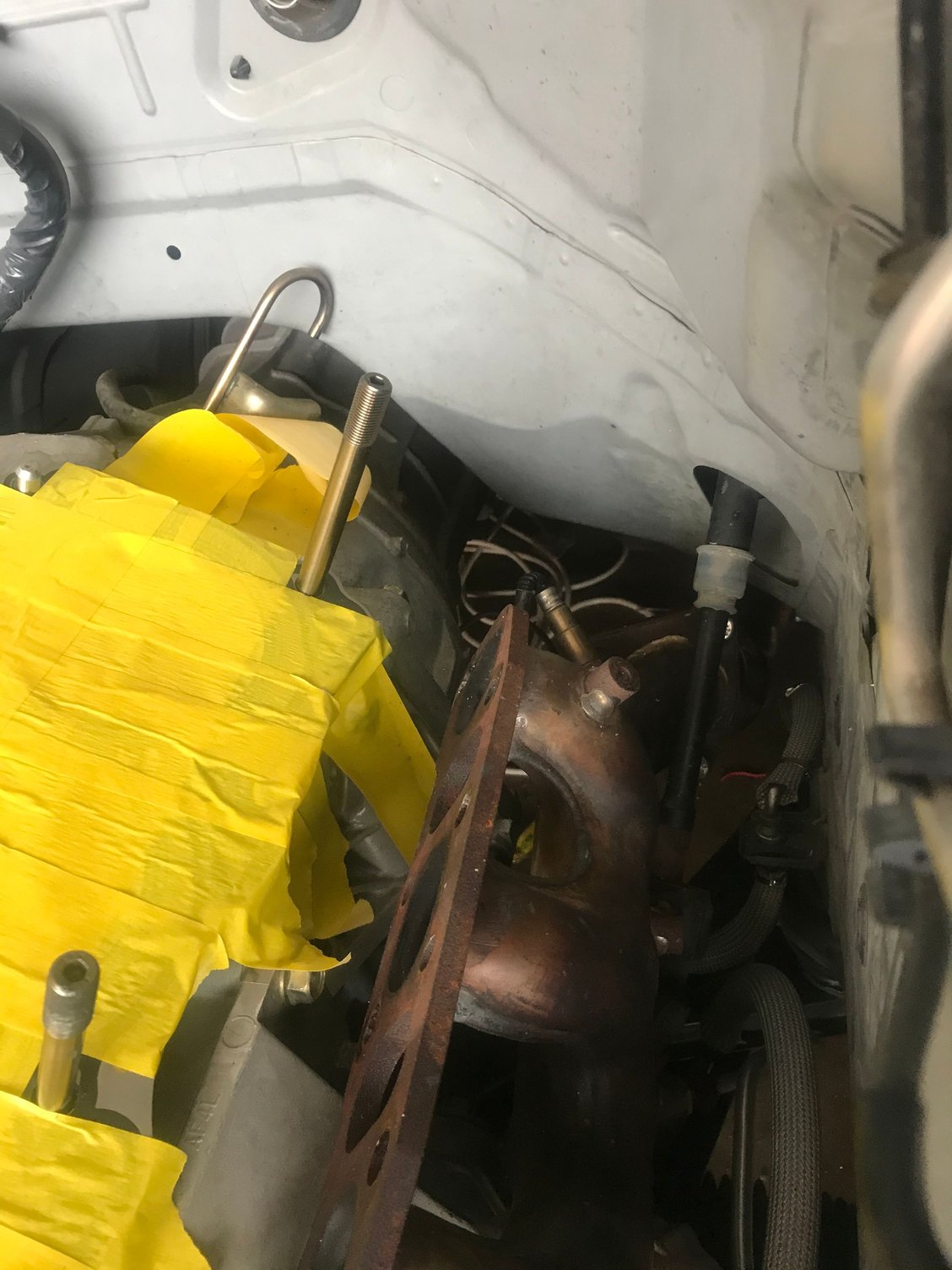

I masked off everything fairly well
All the holes came out perfectly
And here is why I masked everything off, just cutting out the old threads and enlarging the hole produced a lot of shaving
I’ll be taping the holes next then I can clean and start assembling

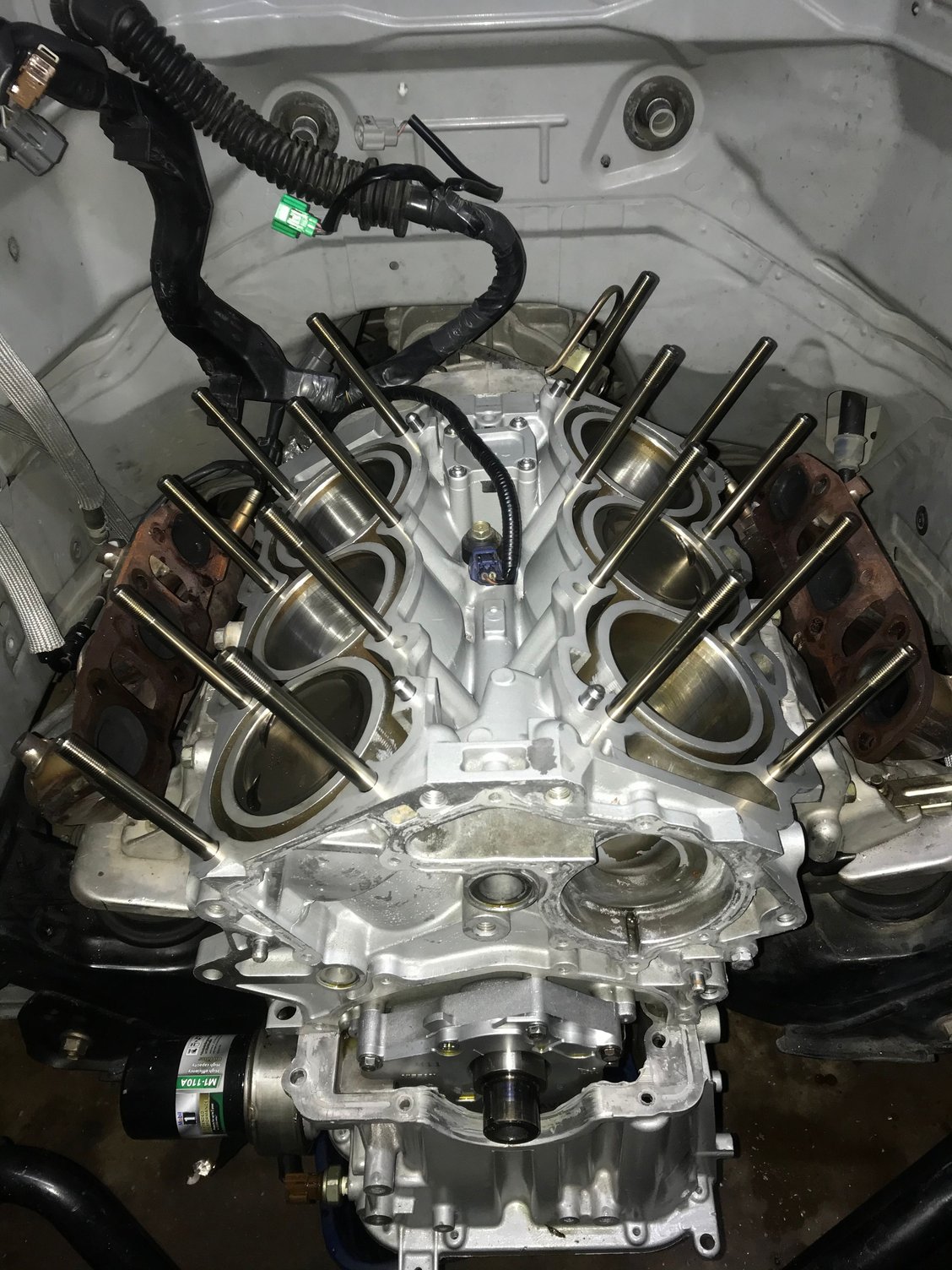

Holes are all taped and cleaned out, spent a little time after work inserting the GTR studs into the block, tomorrow I’ll start installing the cylinder heads

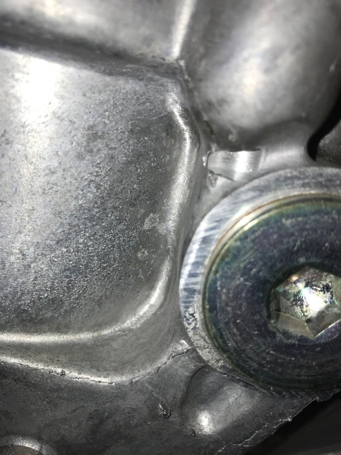

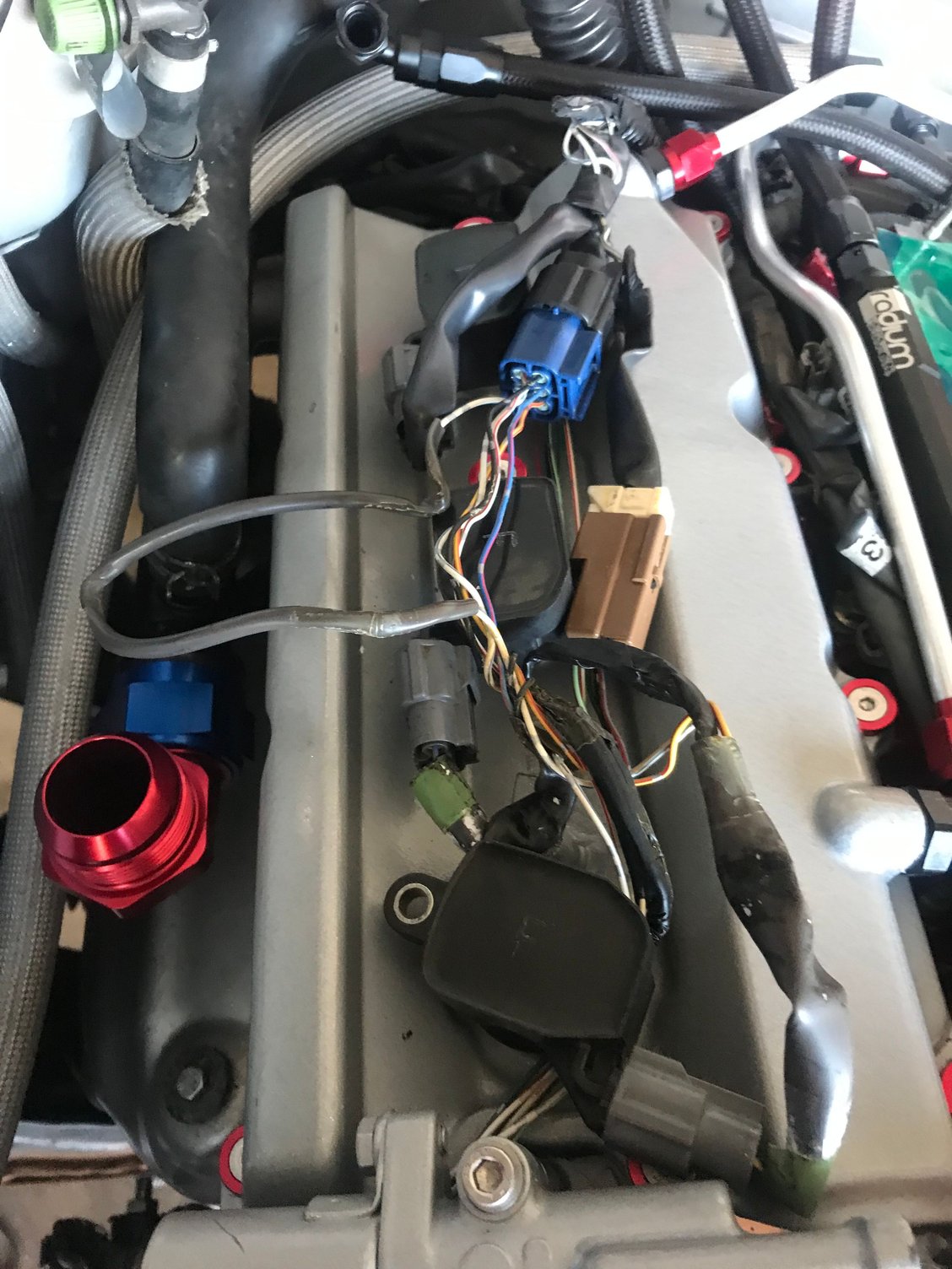

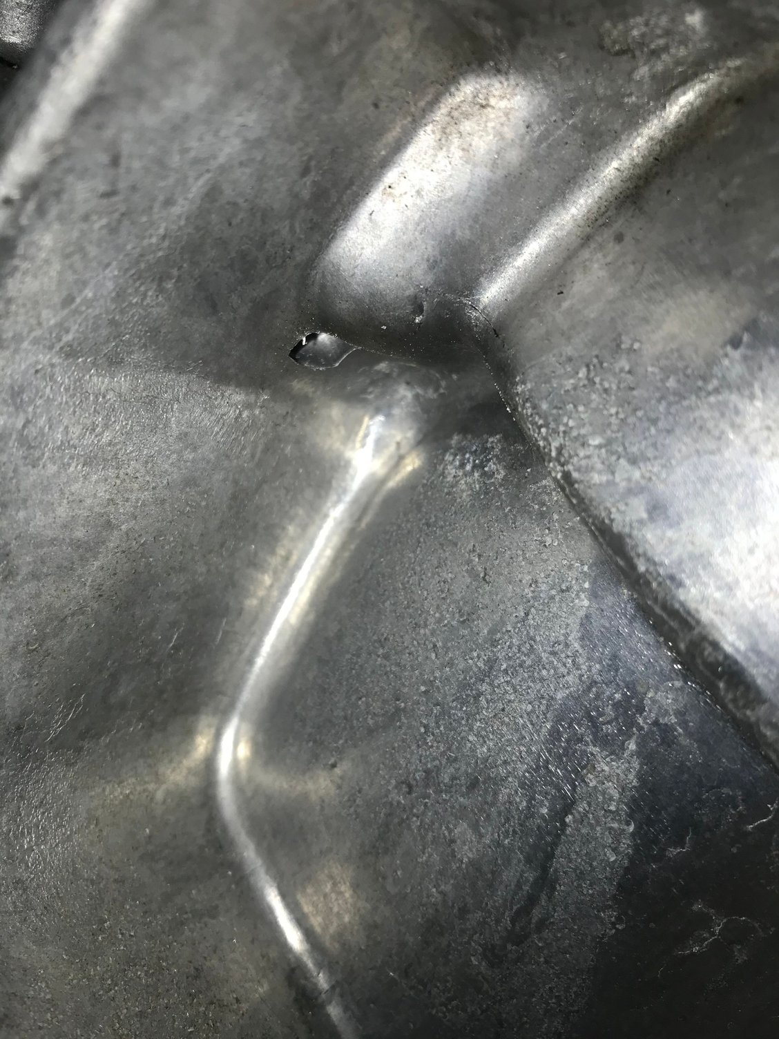

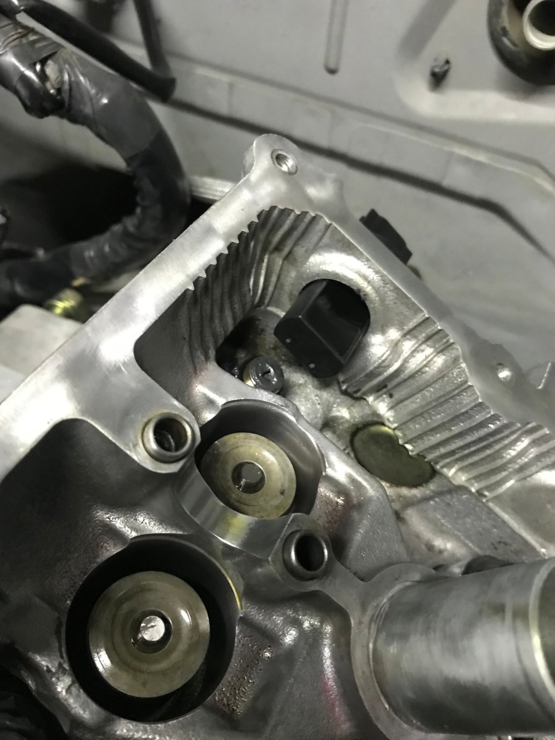

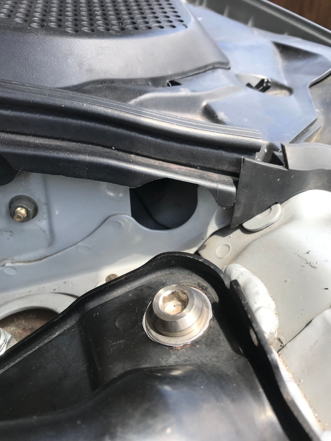

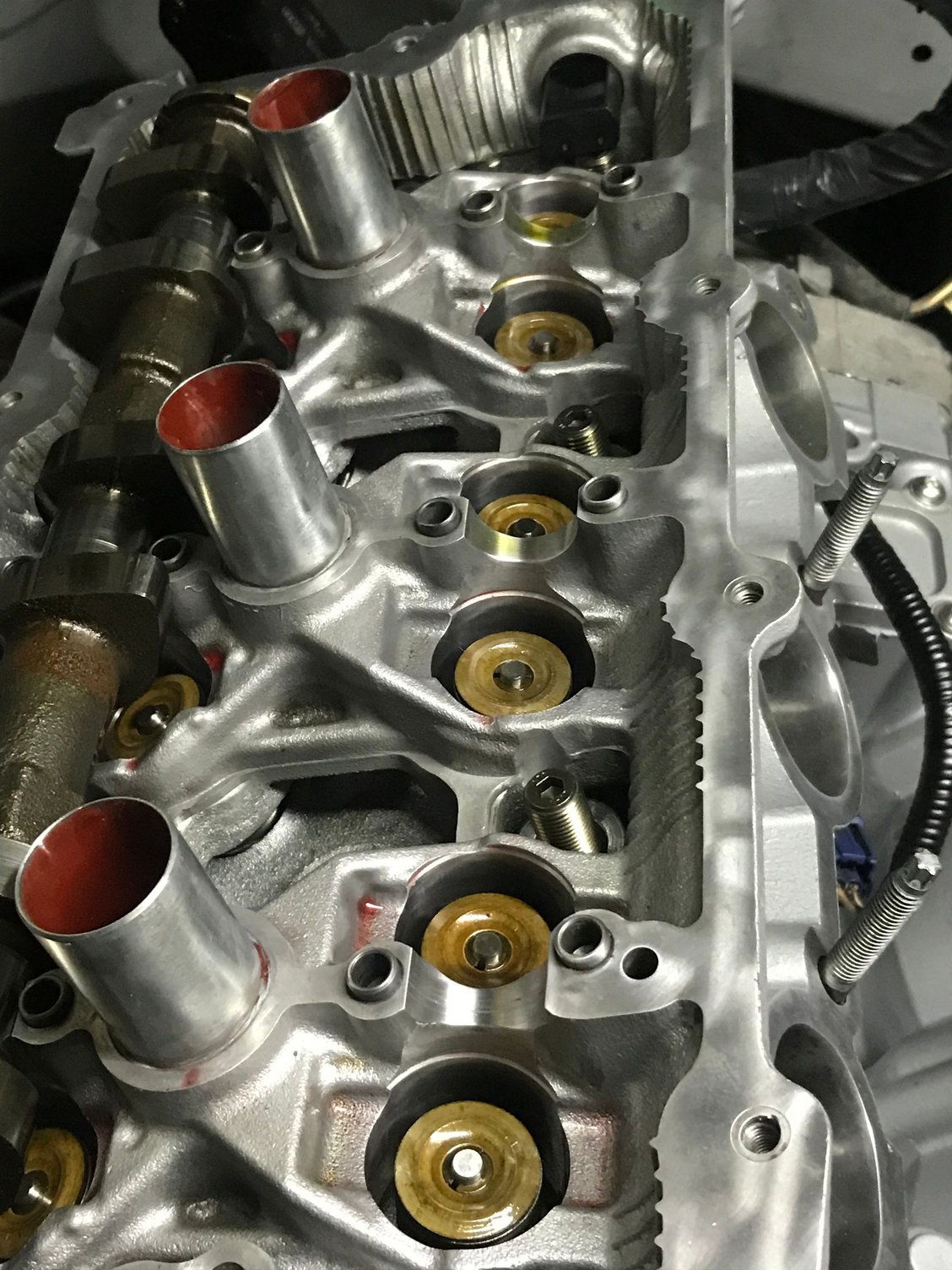

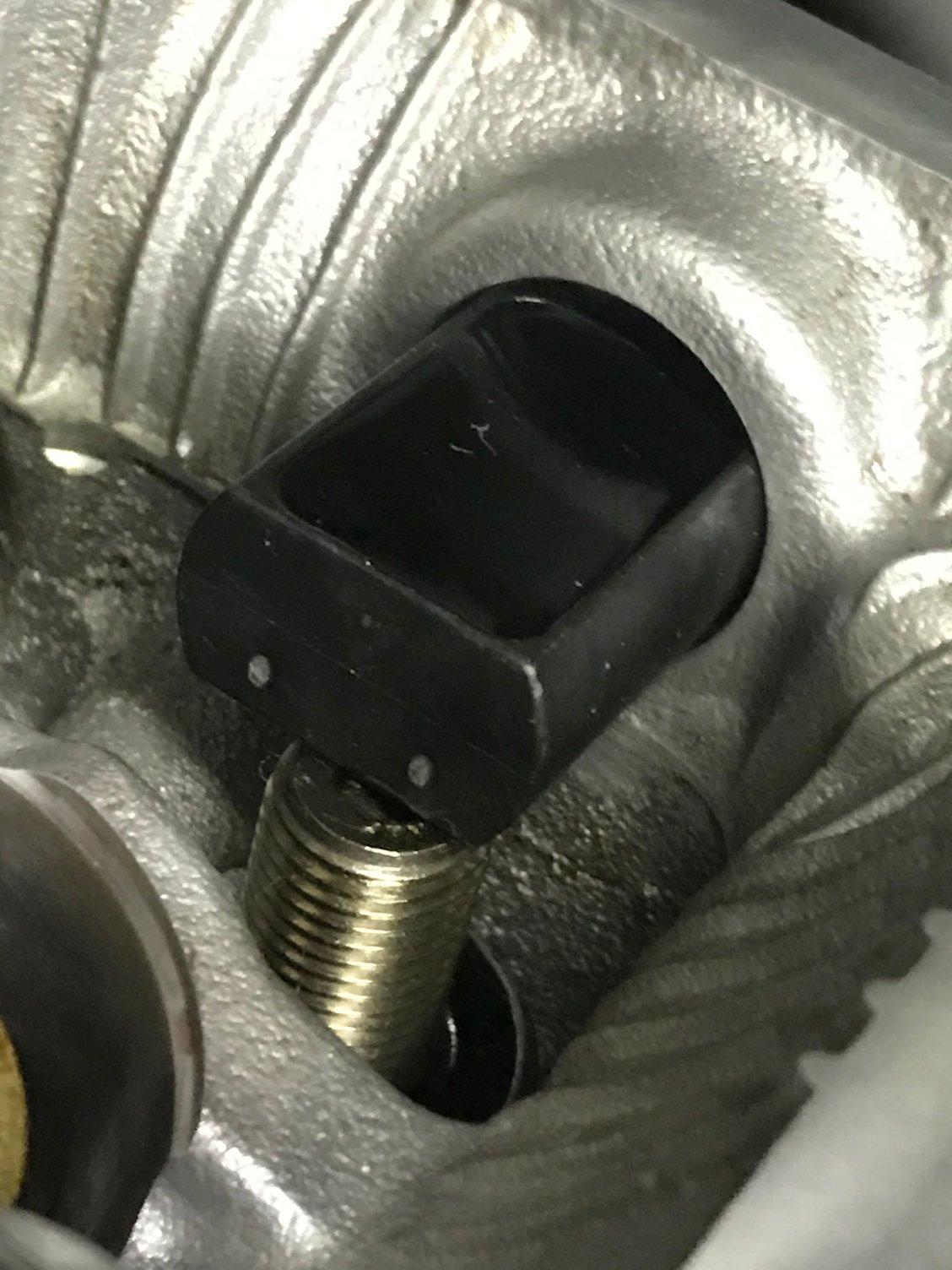

Well the heads did not go on today, ran into an unforeseen snag with the cam sensors. As you can see from the photo below the cam sensor is very close if not interfering with the stud. Action plan now it to figure out if I have another 2-3mm of depth I can drop the stud and if the stud that close to the sensor will cause the sensor to misread. I’ll keep you guys posted

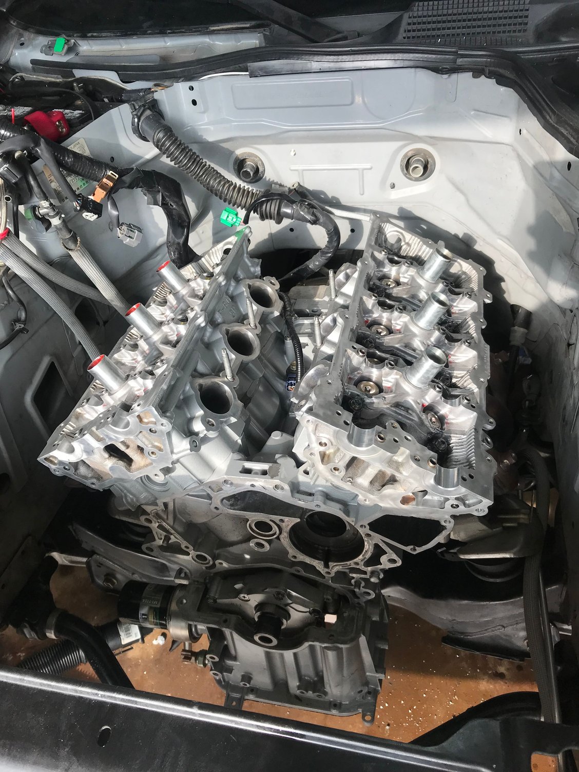

Little update, the heads are on and torqued down with no issues, when tightening the nuts you can definitely feel how much stronger the studs and threads are. It’s hard to explain but I felt like the GTR studs were significantly more solid when doing the final torque round, I am quite pleased 😃 the two bolts that sit directly under the cam sensors were recessed another few mm and do not interfere with the cam sensors anymore. All mods and repairs are done now all that’s left is to re-assemble everything
The deeper studs got 3/8 spacers (left) while the rest got the 3/4 long ones (right)

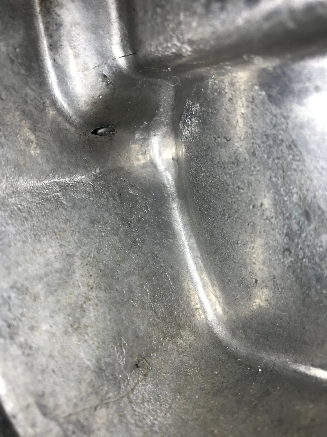

for those that are interested in the documentation, you can safely drill the rear studs to 80mm deep without penetrating into the coolant line that runs down the center of the block but it should be pointed out that the bottom of the stud holes in the casting is right there in fact you will partially brake through it. Below I will post some pictures I took of a test block I used to test drill depths on. At 76mm you will just barely open up the side of the casting that is adjacent to the flywheel 80mm is open a bit more but still not penetrating the coolant line
76mm deep driver’s side
76mm deep passenger side
80mm deep drivers side
80mm deep passenger side

Do you happen to know how far away your head stud is from your cam sensors? I would think because the cam sensor uses the front of the sensor you should not have any problems, also does not hurt that the cam and cam sensor are only a few MM away from each other. It's more of a out of curiosity question nothing special.
it’s about 4-5 mm away it’s hard to get a proper measurement tool in there to get an exact measurement but the cam sensors don’t even pick up the bolts where they are

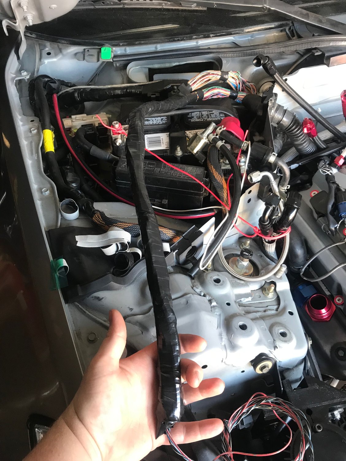

Weekend update, the long block is fully assembled now and I’ve moved on to everything else, I did end up doing another wire tuck but this time I didn’t cut anything, I unraveled the harness and pulled the extra wire length through the firewall to hide back behind
Still not sure what to do with this side of the ignition harness as the oem sub connector and ignition condenser makes it messy

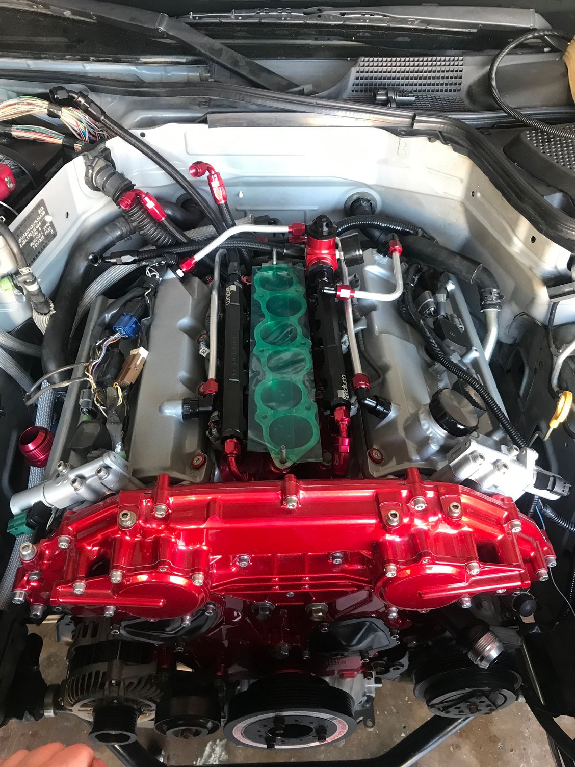

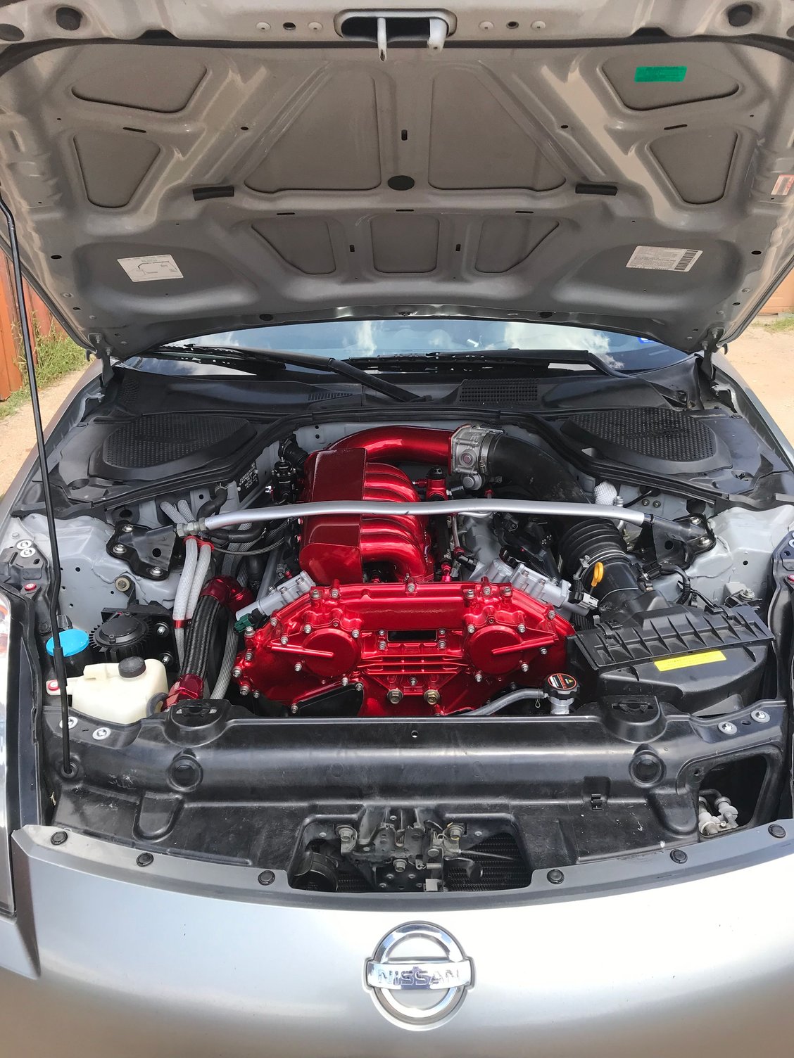

Here are some pictures
How she sits right now
The new plate for the alt wires and fuel signal line
Printing plates for the other harness grommets so I can get everything looking much cleaner
I do have a new cold air intake to replace the factory air box but I need to modify it and paint it before I can put it on and it’s not super important atm
